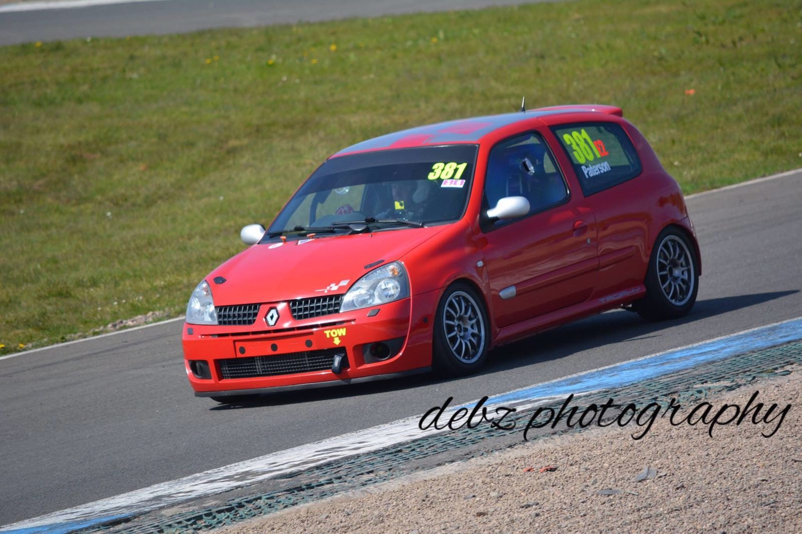

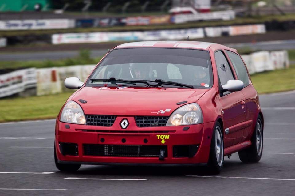

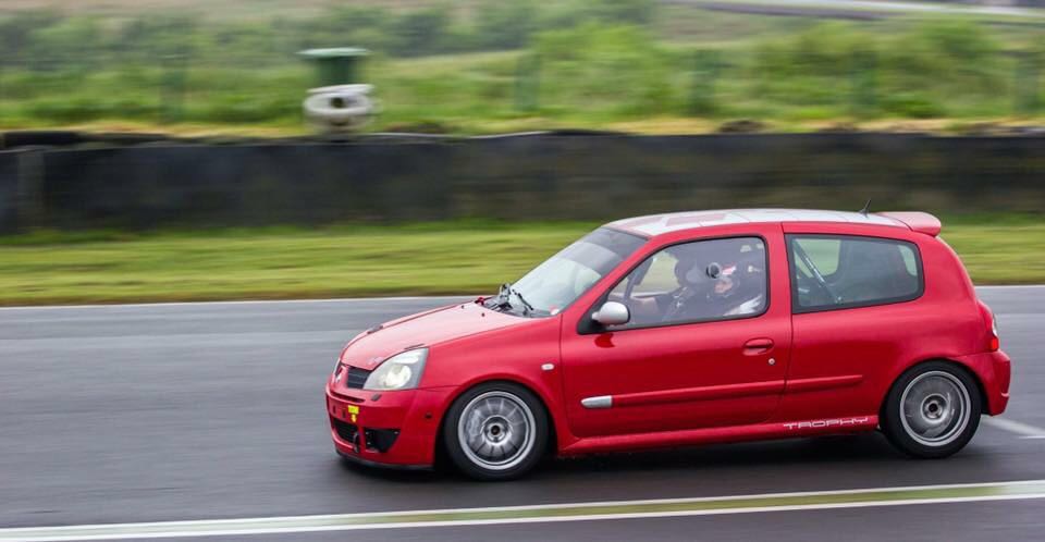

Well a little update today........... found one photo of it on track, still not a 100% convinced by the track decals...... in no rush right now to remove them though!

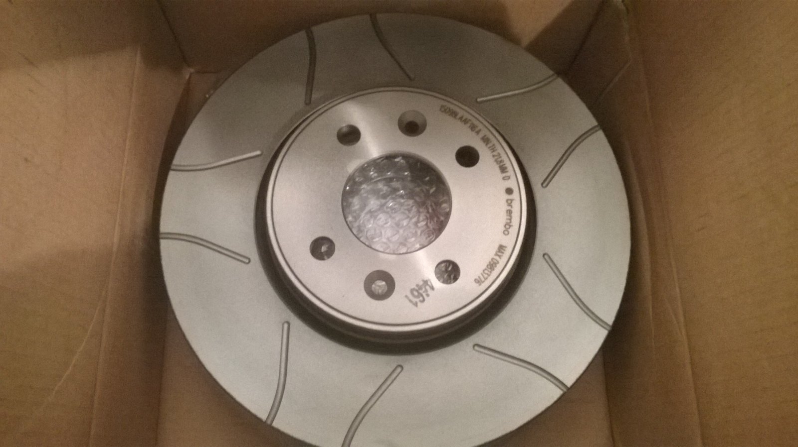

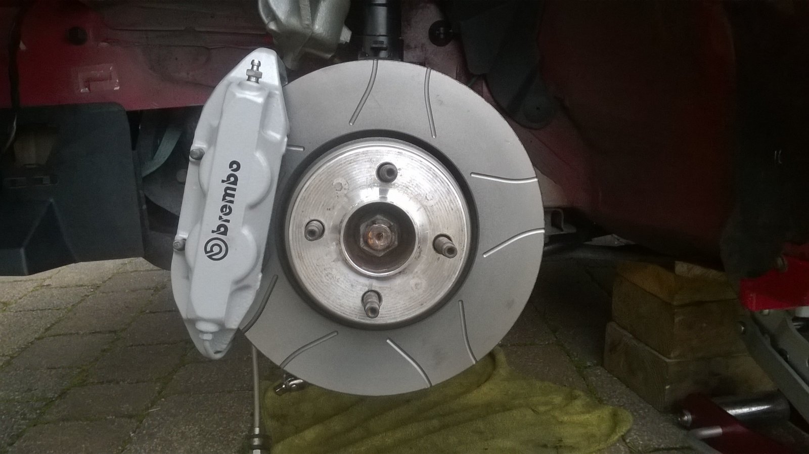

Anyway......... brake discs do seem to be warped, so new ones on order for delivery tomorrow. Opted to go for the HC Max disc this time so I'll see if they last a little longer, twice the price of the standard HC so hopefully I get some benefit! Couldn't really justify the £130 for the HC Xtra drilled discs, although they may have been the best option for the problem. Oh and these have arrived to help me direct the air flow to help keep thins cool (they are massive though!)

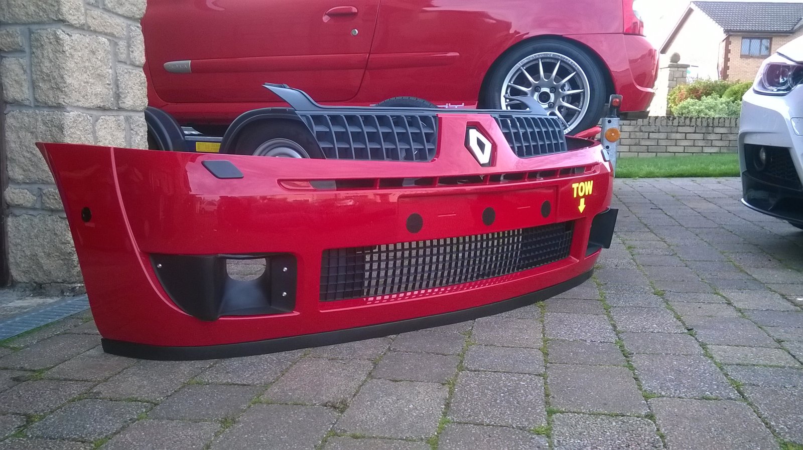

Not looking forward to butchering the front bumper but I think the trophy is kinda past ever being back on the road so may as well crack on 🙈 it should give it that more race car look as well. think I'll stick to the black colour, as subtle is maybe best with these :smile:.

LOL Andy. to be fair, the fogs removed seem to work fine. I had no issues in 3 years with discs warping when I ran Ferodo & CL RC6 pads, the RC8's just seem to be too harsh. It'll be the pads wearing the discs quicker, they're sintered (metallic based) and are quite harsh on discs so im not sure that these will help any. I was right place right time for a deal...... might have been easier to run the Ferodo DS1.11 as the are seemingly kinder on discs :wink:.......
  Supercharged AG 200
Where did you get them from? Let us know if they fit ok, some seem to be better than others!
They are the CM Composite ones mate. They do actually look quite good quality. the satin black look helps the as well. I'll be giving it a good bit of thought before I install them (if I do) as I hade cutting bits of the Clio up, even though its track its still got to be right

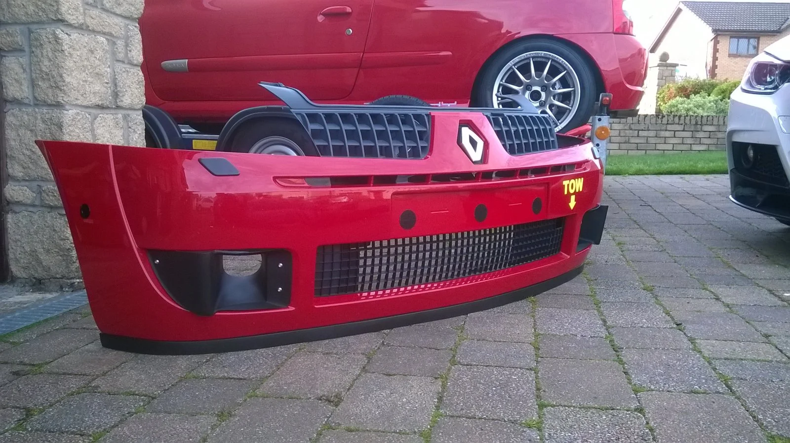

that looks great, kinda moving over to race car look.. also kinda cool the quick release bumper... is it just the x 2 top grill mounts.. and the two side mounts to take it off and put back on again? i did read the thread where you added them but couldn't work out how many other fixings you have to use...
  Supercharged AG 200
Hi Andy, yeah the top 2 in the grill mate, these are just push in plastic plugs which remove very quickly and then pop the two on the sides and lift off. Two minutes if that and its off :up:

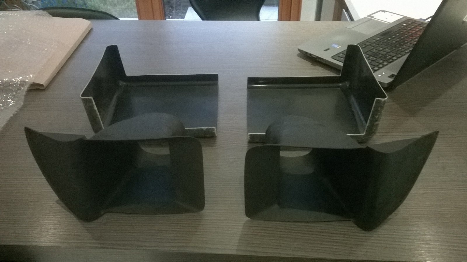

Well that's the ducts completed, will look at the defector plates at the weekend, they are huge!!
Had thought of painting the ducts silver, but I'm liking the subtlety of the satin black :)........ More exiting upgrades to follow soon. The addiction continues ;)

Yep deflector plates are huge, havent fitted mine yet but already started cutting them down!

Yeah, I'll have a look Saturday and figure out mounting / size / what they conflict with.... Lol, they are that big id worry they act as an air brake, couldn't believe it when they arrived !

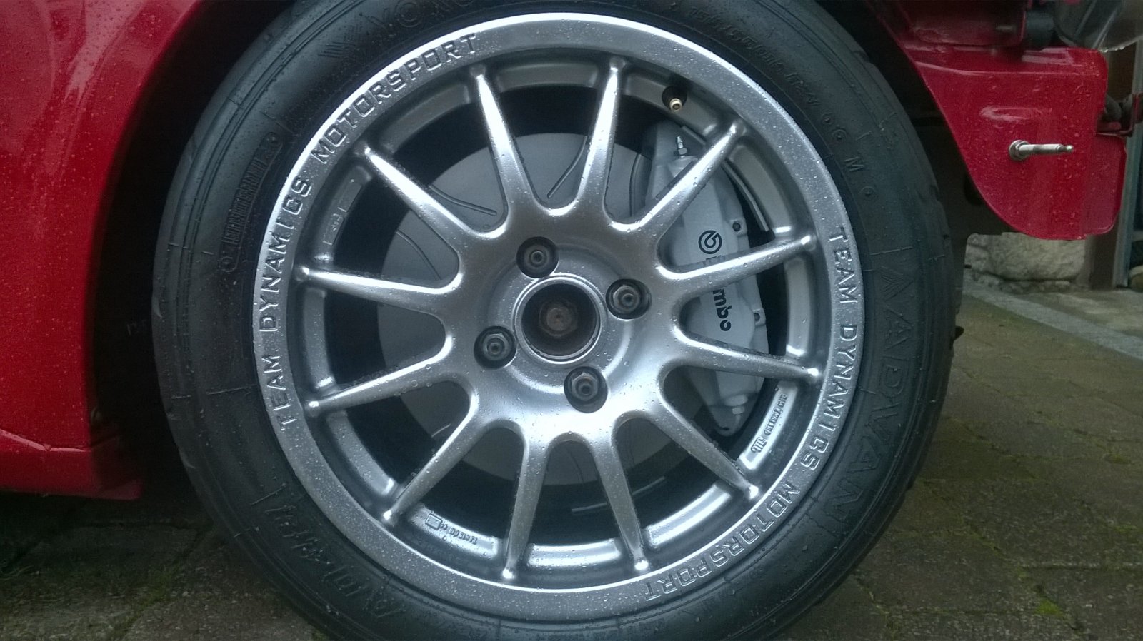

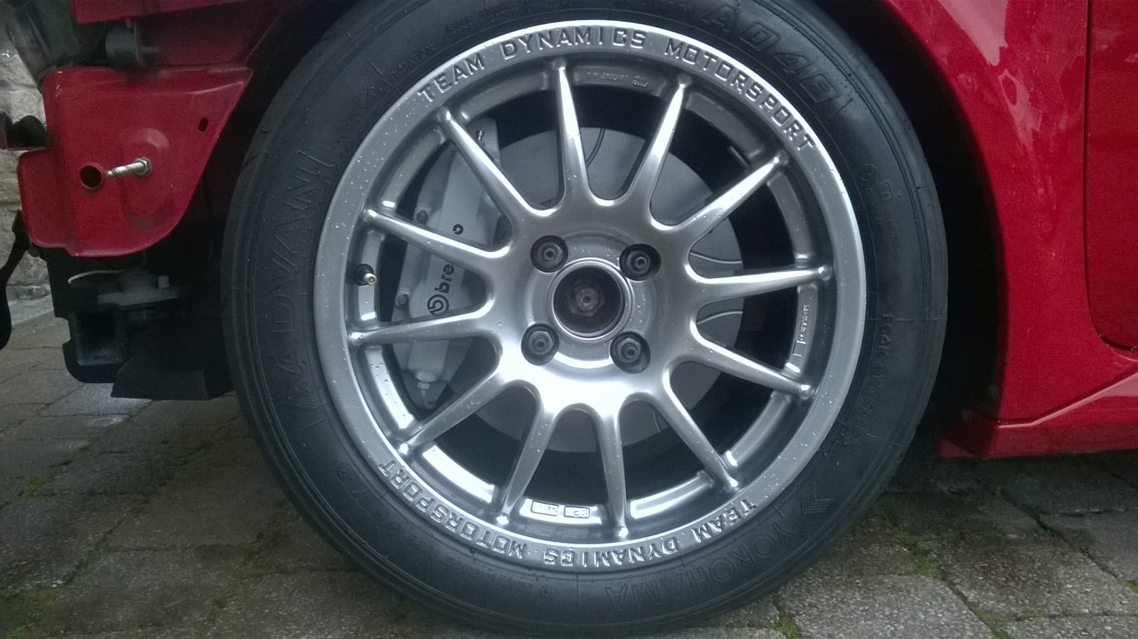

Well a little update.... Nothing more on the modification front, but we have managed two track nights since the brake modifications and it does feel good, unfortunately we couldn't get to try out the real stoping power of the Brembos or the DS 1.11s as surprise surprise it was wet..... Times suffered a lot due to the wet and the learning curve! But the peddle does feel good and the think there is a lot to be had from her...... I also need to set rid of the dreadful T1r tyres which give absolutely no feeling in the wet !! Anyway a few snaps of Thursday night, with the numbering removed as I like the the cleaner (more subtle lol) look :smile:
Next outing is the 3rd July so hopefully we will have a dry day and can get pushing on!!
  Supercharged AG 200
That is a tight squeeze between calliper and wheel. Cars looking good.
Yeah it looks worse than it is. I still have the balance weights on the inside and it clears so all good..... And if nothing else it looks pretty :up:

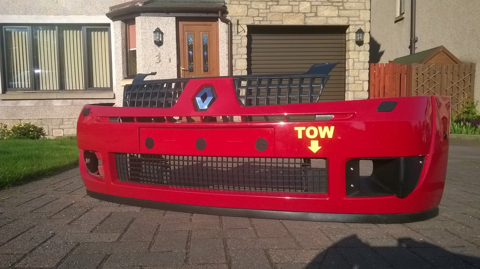

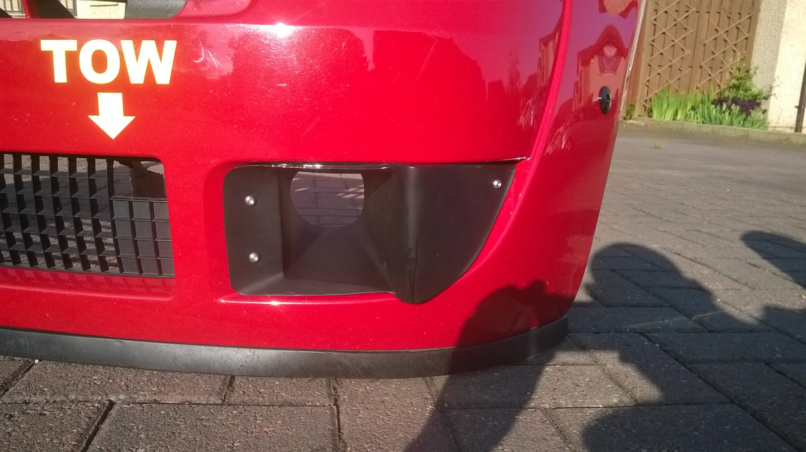

Had a spare hour tonight so I started to fit the cup racer air ducts...... There is just something wrong about cutting up a perfectly good bumper :'( but I think its turned out ok ( well this half has anyway fingers crossed doe the other side!
View attachment 156263 View attachment 156264
How good is the fitment in and around the fog light hole on these? the original cup racer ones were terrible fitting, never bothered to fit them again.
Car looks great mate.
Wouldn't be worried about things like the bumper/bonnet for aero catches. They're only standard mk2 items in a different colour after all. If you wanted to revert back to road spec it wouldn't be so hard, just cost a few bob.
They weren't a great fit to start with mate. I filed them down and spent ages getting them to line up. After that I have black flexible sealer, so a very fine bead along the top just to hide the little daylight gap at the top..... Didn't need it but I just like things neat :smile:

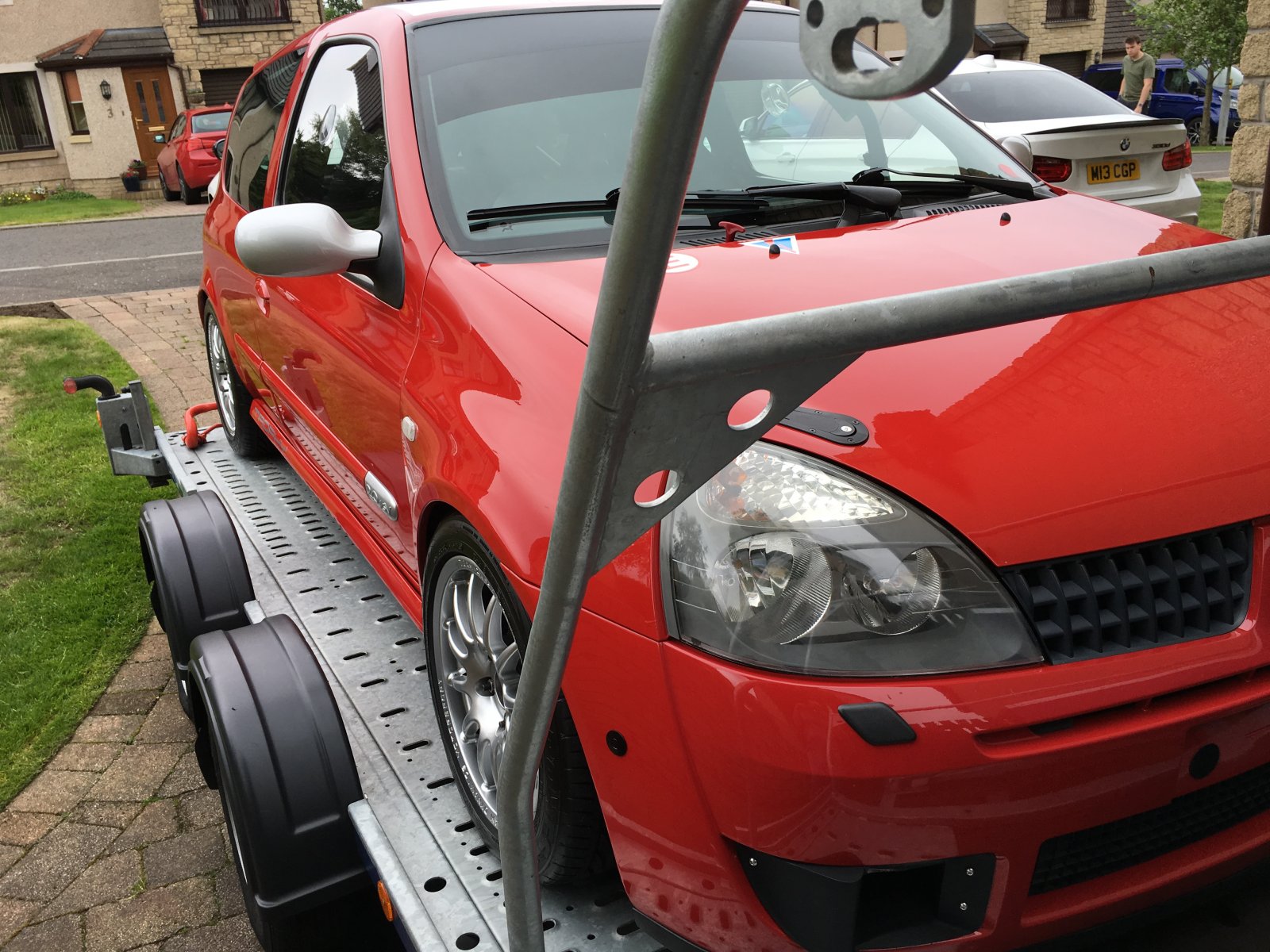

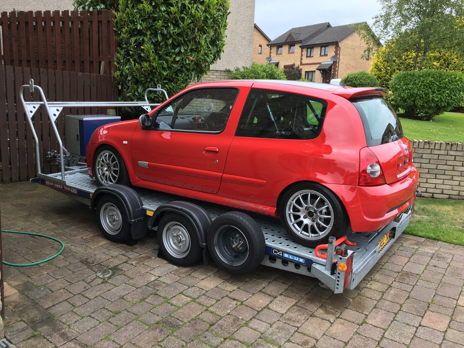

Well interesting weekend for the Trophy! Saturday track day, hour and a half and it was back on the trailer. Either a wheel bearing or n/s drive shaft bearings away do no risking explosion and new shaft and bearings will be ordered tomorrow, east of track money but possibly a bigger saving in the long run:up:
