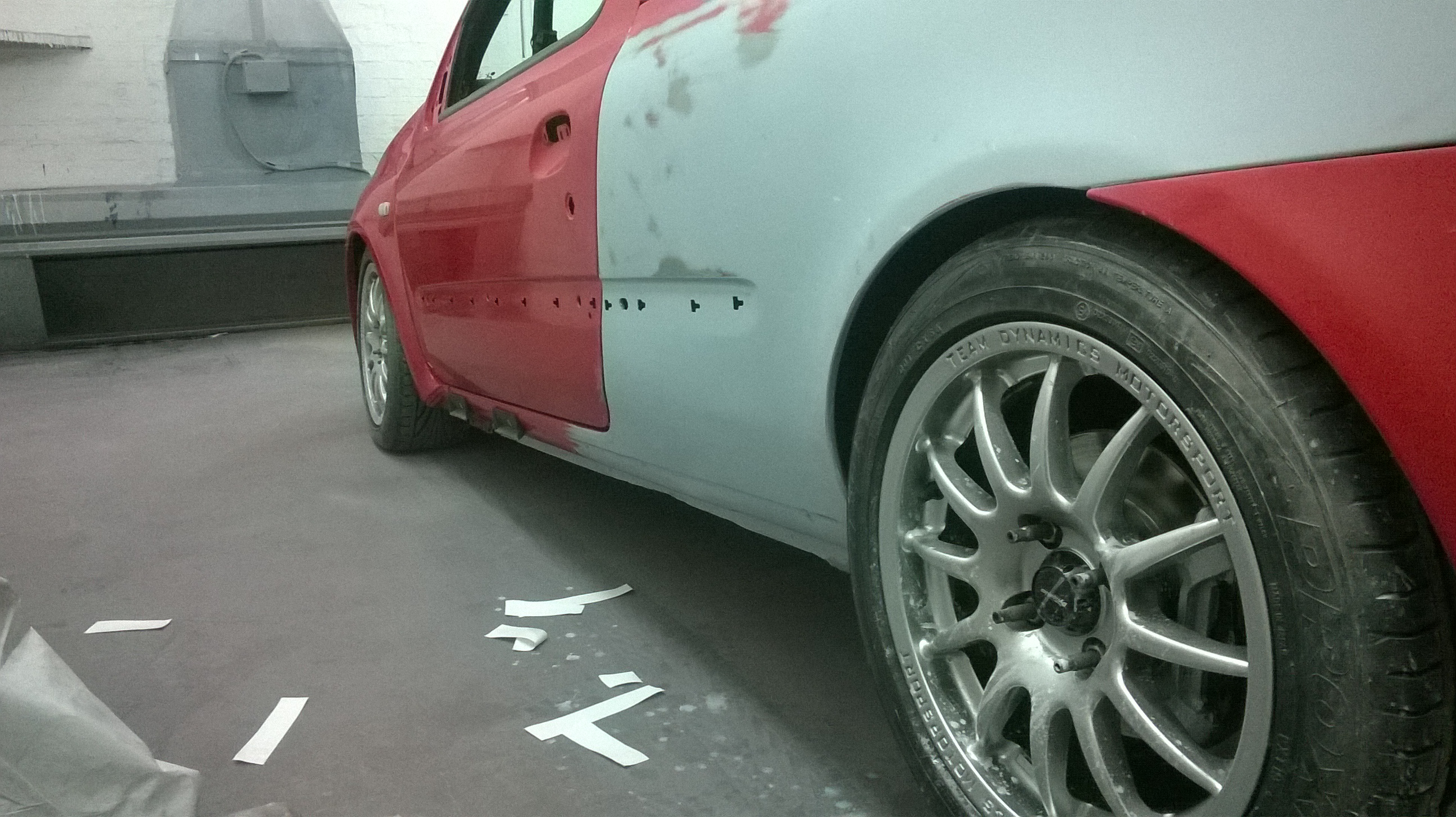

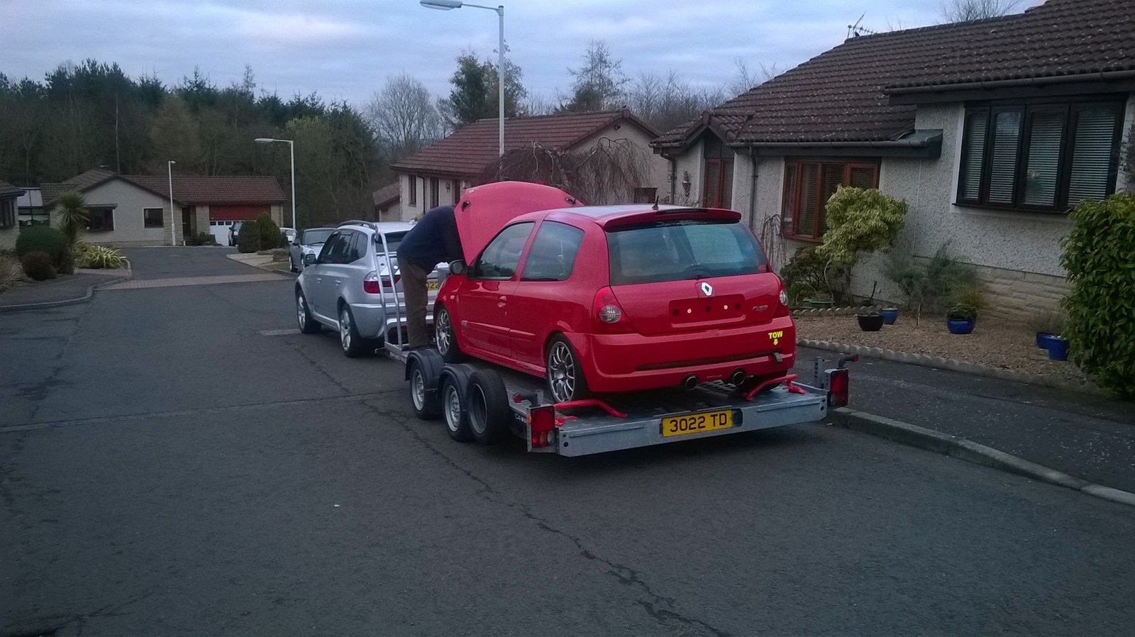

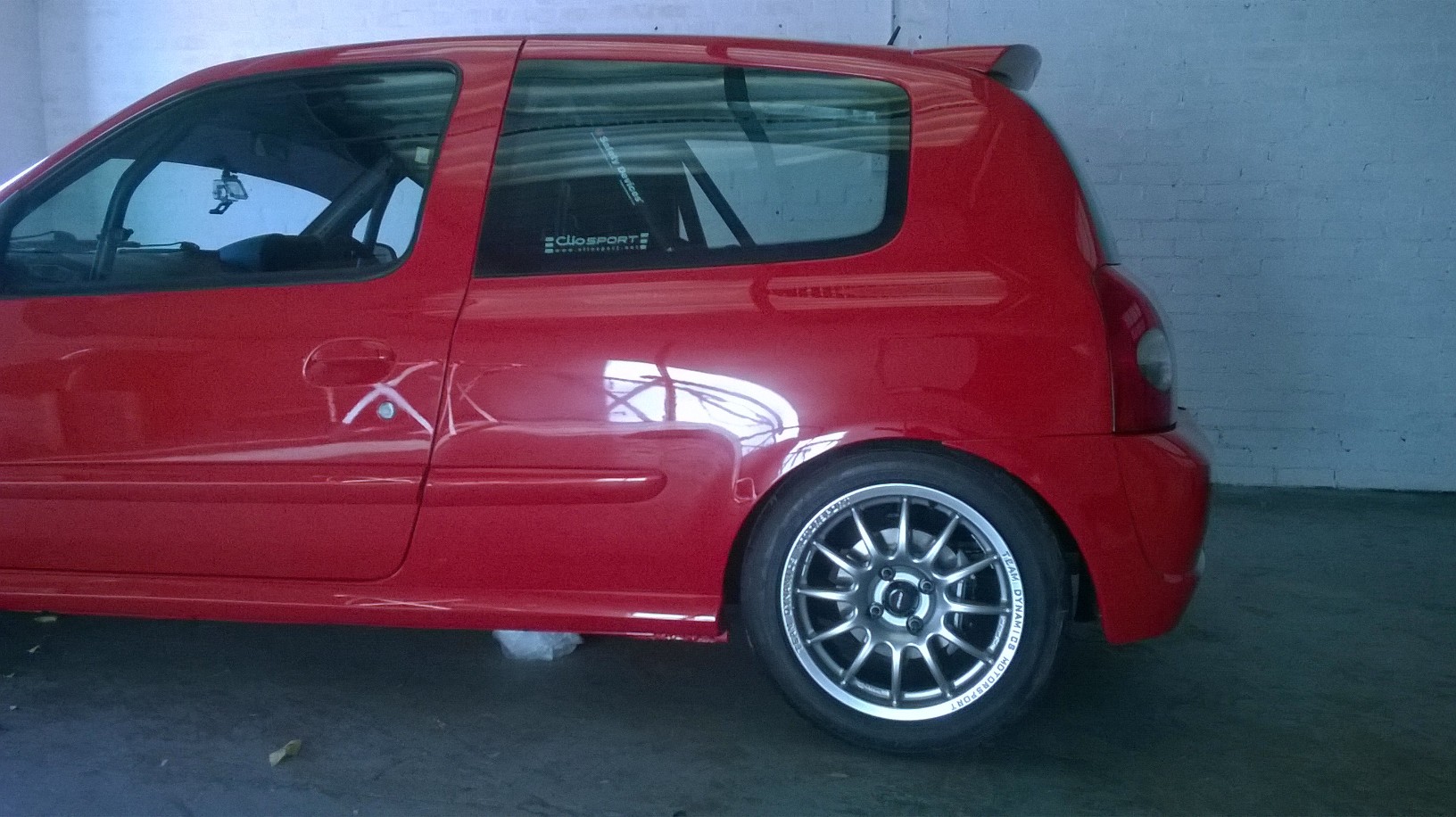

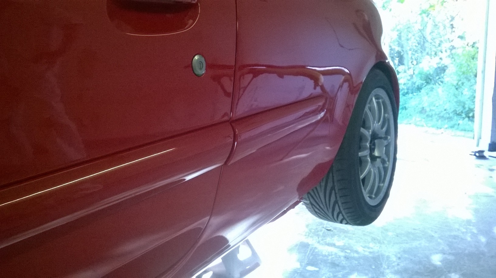

Well more progress, all straightened and being masked up ready for paint when I nipped in today..... Estimating Friday pm collection so looks like Sunday on track is going ahead as planned :)
More to follow.......
  Supercharged AG 200

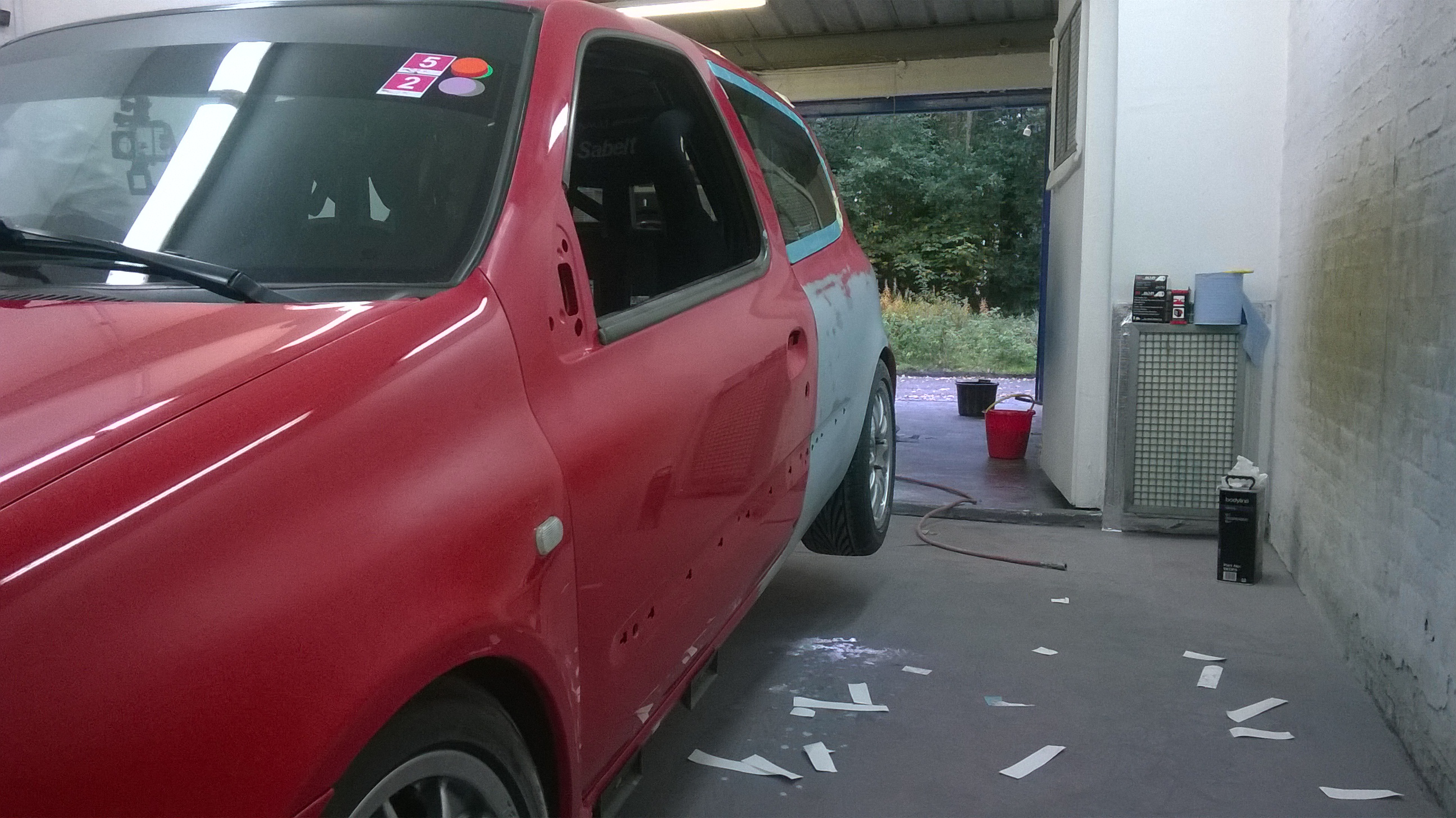

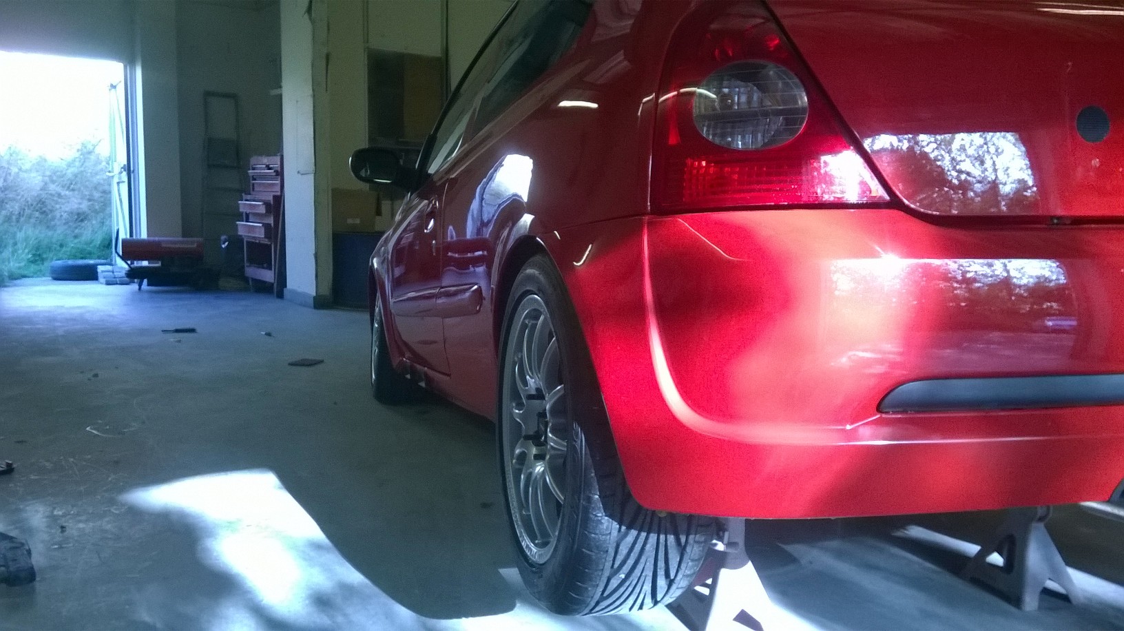

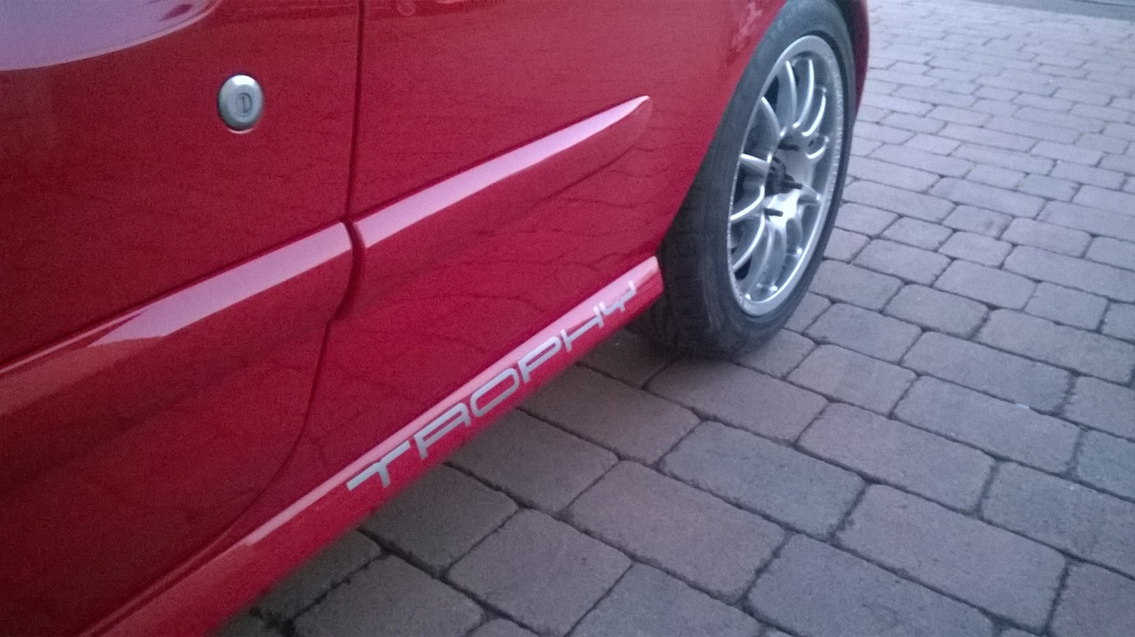

Next update, finished a day early :smile:, he was just riveting the side skirt brackets on and I collect it at 4 tonight so 2 days to polish and check over before Sundays outing :up:
will put the obligatory completion photo up once the side skirt & Trophy sticker are back in place :hearteyes:

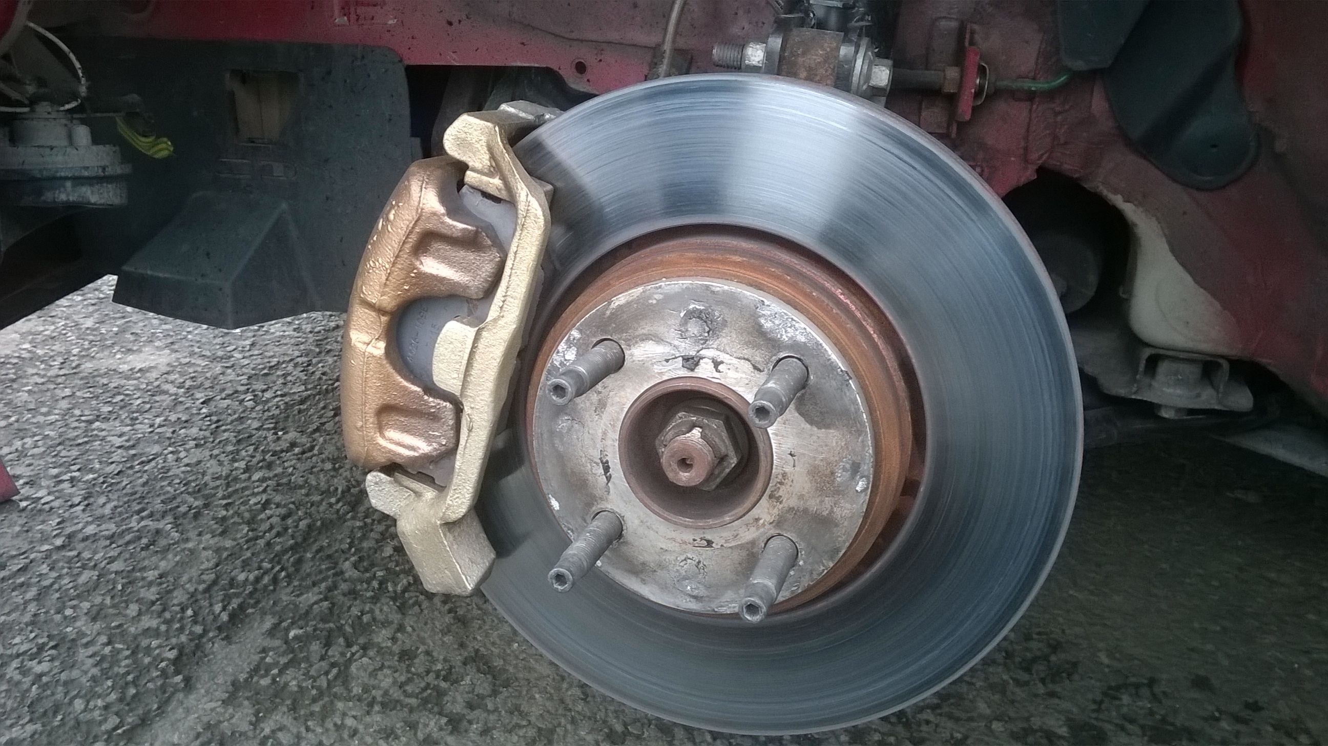

Oh noooooooooo! Colour-changing calipers 😧
Lol, I knew you It was going to happen, had it turn pink before bit surprised with the gold though :smile:
Pity there's no heat goes through the rears,I could have had a matching set..... I'll give them a coat of black or some high temp silver in the spring :up:

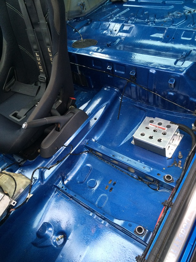

Well it feels like ages since I've been on here............ well updating anyways.
Its been a miserable and wet winter up here so all the plans made at the end of last season have not been taken any further! but the Trophy's now out of storage and looking as shiny as the day she went in :tongueclosed:.
Picked up at 6:30 last night........ its 6:30 am now and i'm away to start working on her. Neighbours must love Clio owners!! :smile:
To do list below (in no particular order) and I have 2 weeks before the first outing so all should be achievable, but i do remember saying that before!!
  • Remove air-con rad and blower motor from below scuttle (was meant to do this ages ago, but it just seemed a pain)
  • rub down front calipers and paint with high temp silver paint this time
  • new door cards to be installed to replace my hand made efforts thinking about relocating my mirror switch as i find the electric mirrros helpful for loading / unloading etc
  • Fit foot plates (have had these for a year or so now and have never been quite sure about them.... (alloy with holes in them, look pretty but cant see the point, so may have to review this. One of the other cars at Knockhill has them and do look good installed)
  • Fit Polycarb windows (front only) as i'm still unsure about these, so opted for easy swap over at this time! obviously remove associated runners & motors for weight etc.
  • cut bumper brackets off and modify front wheel wells to stop rubbing
  • fit aero catches to front bumper to stop the passengers side unclipping every outing
  • check engine bay bolts including ITB & a full check over underneath
  • lubricate throttle cable, electric cut off & fire extinguisher pull cables
  • remove battery & refurb battery tray. i have a light weight battery, but i've chosen to leave it under the bonnet as it weights 0.8kg, so the cables and wiring to relocate it inside would weigh more than the battery, hence the refurb of the battery tray (has to look pretty of course!!)
  • Oil & filter change (i change it every 3 to 4 outings, seems a little daft changing oil that still looks new but new mind)
  • change gear box oil. (not quite as bad with this it gets changed start of every year)
  • lubricate all suspension adjusters
  • change spark plugs
  • fit safety devices cage insulation
  • Think about spraying the inside, this was meant to be a winter project but as the weather was so damp & wet i could never get around to it despite having all the materials !!)
so short list, but i'm sure there will be a another 100 things to do along the way!
Hope to catch up with some of you at Knockhill soon :up:
