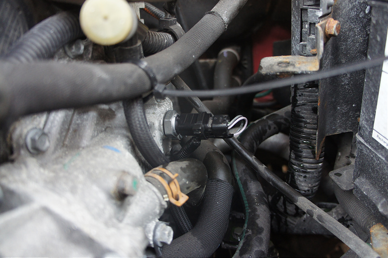

Coolant Temperature Issue
Typical, week before I was due to go to interviews little red had started to develop an issue with coolant temp. Basically if left idling all was ok but as soon as you started moving the temperature would drop slightly (not to the point where the cold map would kick in as it drove fine) Pretty certain this was the Thermostat not closing properly as the temperature gauge seemed fine so sensor fault was unlikely but got onto phone with Colin at Wests Renault, £44.64 lighter and few days later I had brand new thermostat and temperature sensor along with some Type D coolant I ordered from an ebay seller. Many thanks to Colin for such quick service.
DSC02927 by KeithRoberts185, on Flickr
Temperature Sensor
DSC02930 by KeithRoberts185, on Flickr
Had look on here to study and familiarise myself with where all was and then a Sunday afternoon I got onto changing them both. Had renault type D coolant in there already so didn't need to flush out which saved a lot of hassle.
Let engine cool down and then out with the airbox and got the temperature sensor out and new one in without any issues

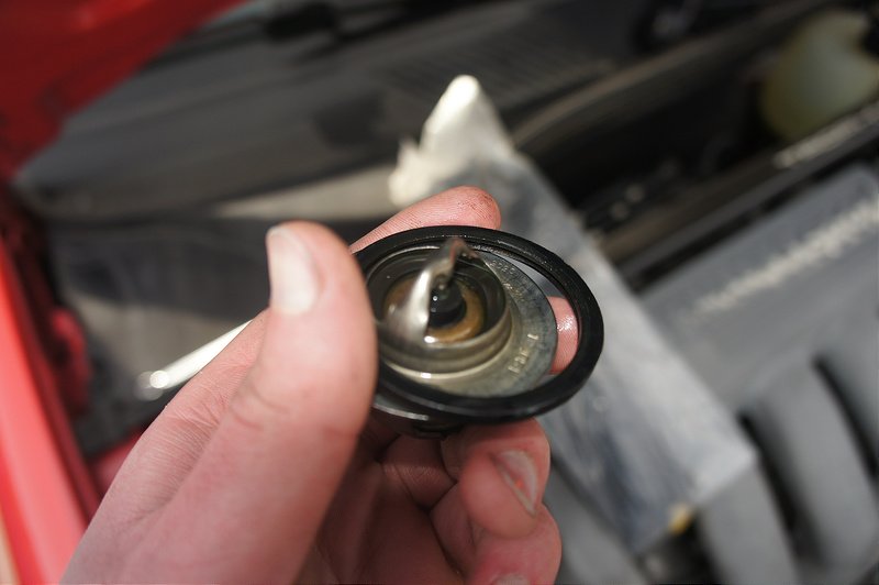

Next onto the Thermostat, which I was expecting a lot of coolant to go everywhere so pair of scissors to and icecream tub
DSC02937 by KeithRoberts185, on Flickr
Didn't loose 1/4 as much coolant as I was expecting with myself and one of my brothers working like a well oile team ;) Greeted to what I was expecting with the inner seal slightly distorted and not sealing properly.
DSC02936 by KeithRoberts185, on Flickr
Glad I found something so tightened all up, topped coolant back up, ran engine up to temp and bled the system. Jobs a good 'un. All sorted for the critical week that lay ahead of me.

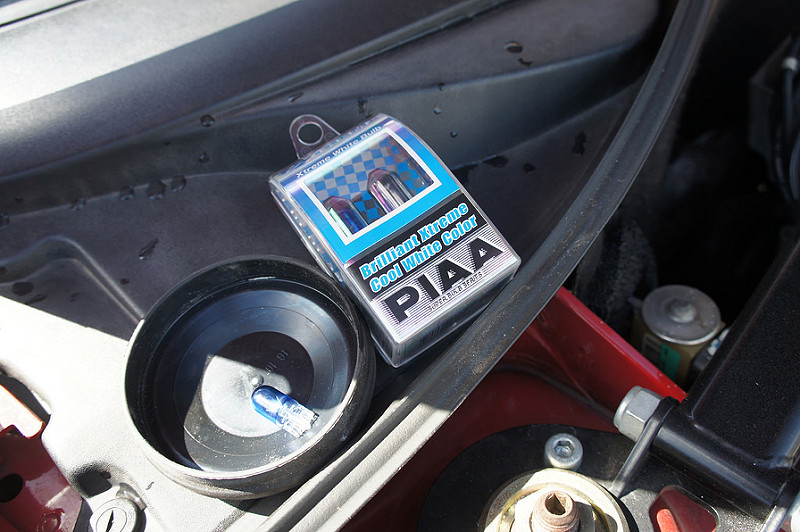

Sidelight replaced
One of my 'not so long ago fitted' sidelights had gone, was dreading id have to take whole bumper off again but thankfully didn't have to. Wasn't impressed by fact it lasted so short a period but have had PIAA stuff before and always lasted years so i've put this down to a single unlucky occurrence.

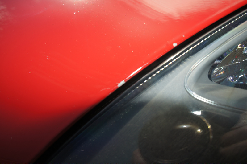

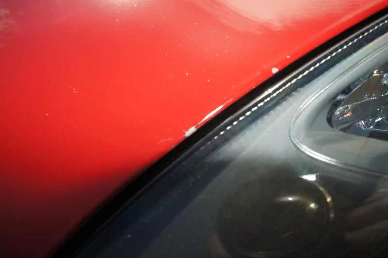

After a hard winter finally got chance to see to the stone chips on the front of the Trophy.
DSC03148 by KeithRoberts185, on Flickr
DSC03150 by KeithRoberts185, on Flickr

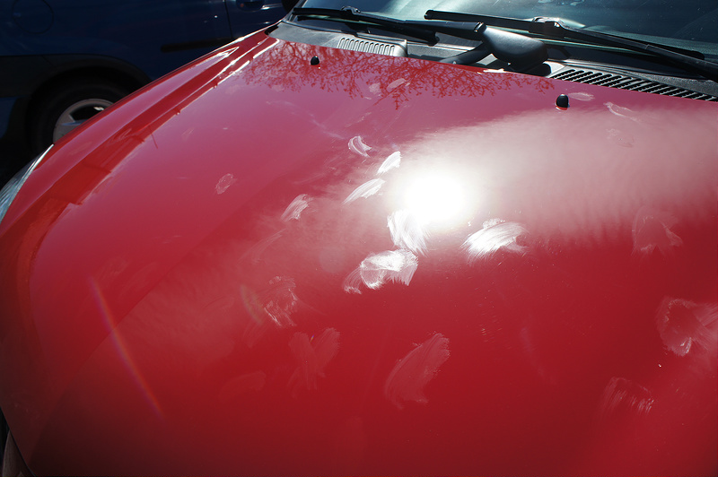

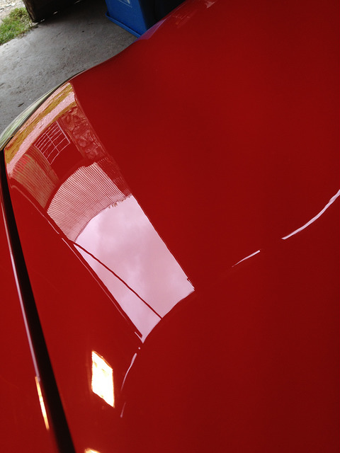

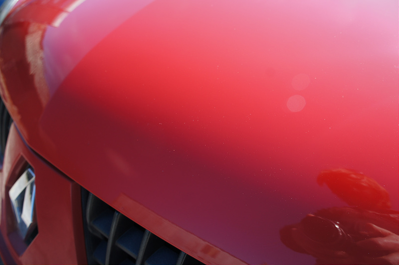

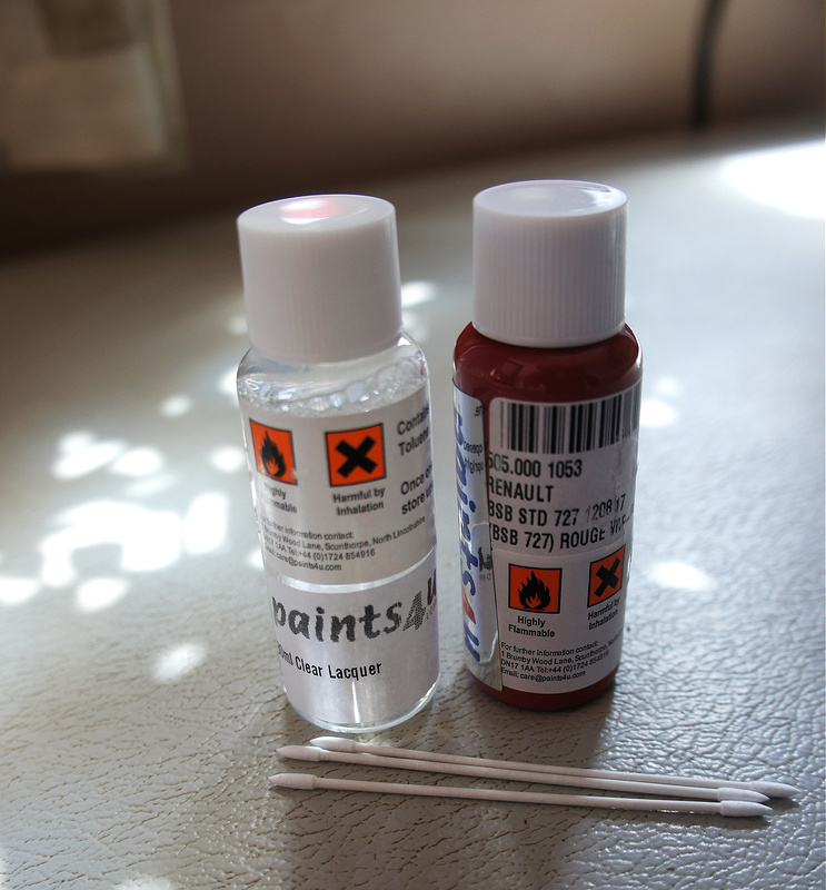

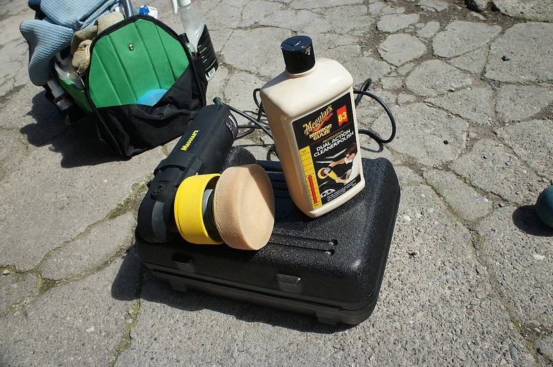

Having read on detailing world about a technique (Similar to Dr Colourchips road rash kit instructions) I wanted to try this, bought some touchup kit and mixing both the colour and clear together in equal parts, using a lighter fluid coated cloth I smeared the paint over and across the chips trying to be as neat as possible.
DSC03154 by KeithRoberts185, on Flickr

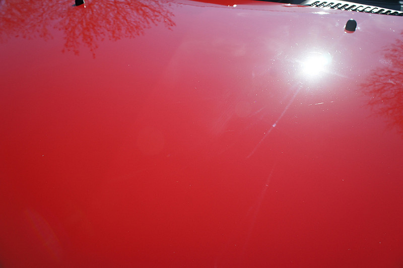

Bonnet left looking like this which was a bit daunting haha.
DSC03160 by KeithRoberts185, on Flickr
DSC03165 by KeithRoberts185, on Flickr

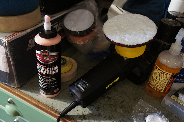

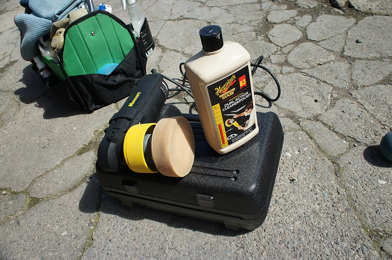

Out with the DA (should have borrowed brothers Rotary)
DSC03164 by KeithRoberts185, on Flickr
Eventually was left with this, still some work to do on the paintwork in general but the chips are pretty much gone now.
DSC03168 by KeithRoberts185, on Flickr
DSC03167 by KeithRoberts185, on Flickr
The marks in photo above are dust/polish.

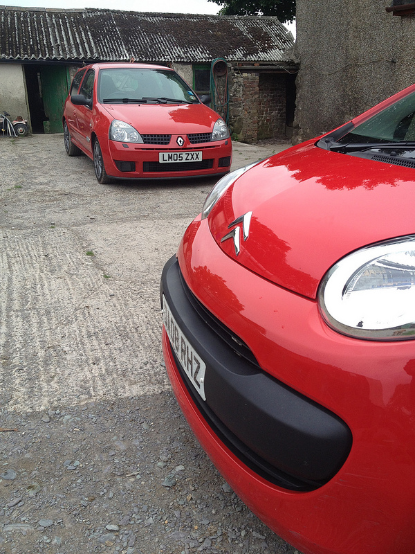

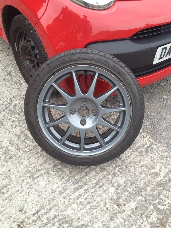

With myself currently having to do a 100+ mile a day commute to my new work and clocking up the miles on little red. I needed to 1. move closer but this was a pain with lack of houses for rent and cost or/and 2. buy a cheaper to run car to eat the miles up. Having failed at plan 1 I moved onto plan 2 and after looking at various cars from old BMW's to diesel clios to brand new cars I decided on a Citroen C1. Having driven a fair few miles behind wheel of these as local garage has them as courtesy cars. £20 a year tax, insurance group 1, 60+mpg, cheap servicing and running costs, relatively reliable (bar clutches) all for less than £3000. Several sold cars later and viewings I bought a 1.0l rhythm (middle of range), few dings and scrapes, filthy interior but mechanically honest and having had clutch done recently, I was happy enough.
IMG_4334 by KeithRoberts185, on Flickr
IMG_4332 by KeithRoberts185, on Flickr
New chapter
Little red will become more of a weekend and track car while the C1 will be mileage munching. Will be changing little red to a limited mileage policy to save some £££ and with the petrol saving alone the C1 will have paid for itself within 12 months. This will then in turn allow me to spend some money and time on little red and tweak it a bit more than I ever could as a daily driver and genaerally get it looking better than new as I wont have to do all work within a weekend.
The plans have always been a 'dream plan' but now will become reality hopefully and be to basically keep the Trophy a Trophy and not a modified Clio but will be even more special ;)

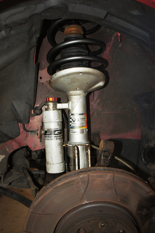

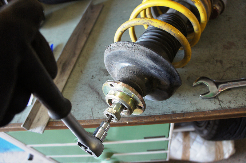

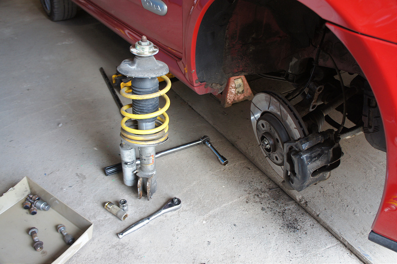

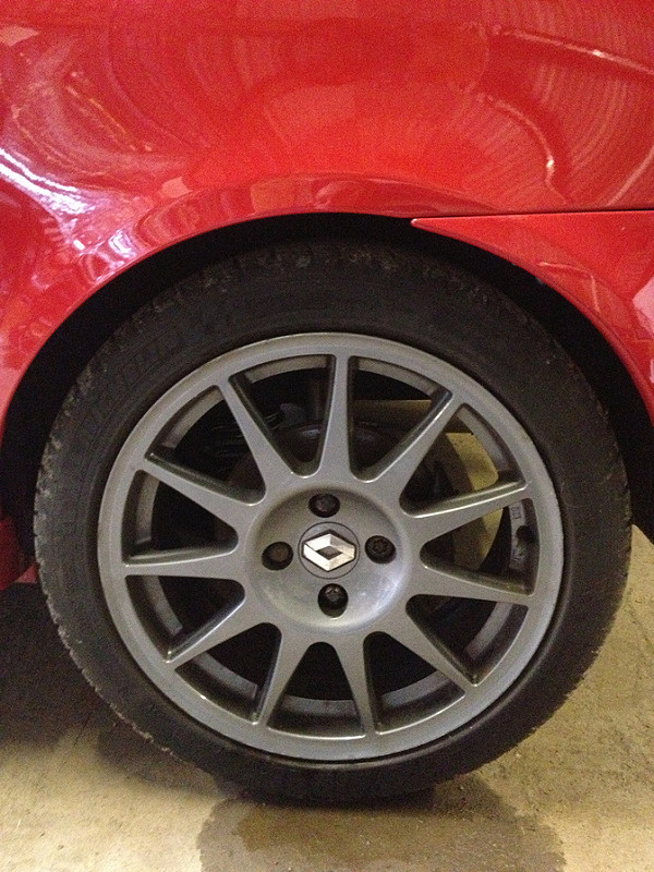

With my new plans, the first step was to get the 2/3 year old standard Trophy eibach springs off to keep for 1 so that I'll have a good set of standards and 2 to replace them with something a bit stiffer and slightly more tack focused.
Without going fully custom and to retain the Sachs I narrowed it down to two sets of springs. Cooksport and Eibach Sportline. Didn't want it to look like a Cup racer but a lower riding car would cosmetically look so much better . . . still unsure one morning I was on here, knew about the stock levels of cooksports, saw post that they were in stock and few min later I impulsively bought a set of cooksport springs.
A day or two later I had them. Took me a fair few weeks to actually fit them (Jesus on here will probably agree I took few weeks too much ;) Having cleared the garage out now I have somewhere to do work in shelter.
DSC03592 by KeithRoberts185, on Flickr

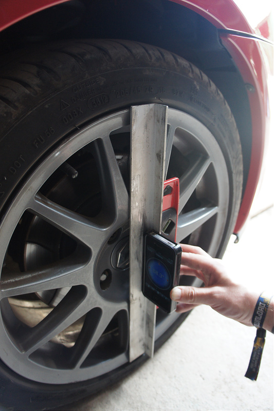

First job was to measure the camber on the ground and then later directly onto the hub/disc. Quick iphone app and a straight edge and i got some values that would allow me to set the camber bolts back up to once I refitted them. Doesn't allow me to set up obviously but good enough to get them set back up.
DSC03598 by KeithRoberts185, on Flickr

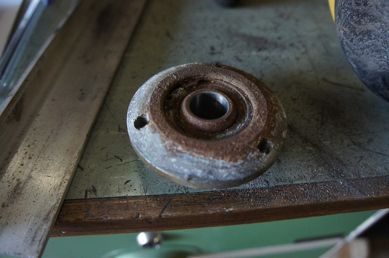

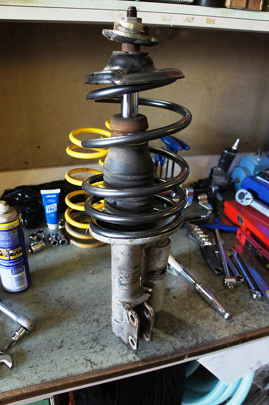

Dampers off and yet again I'm surprised by the rust on them. Winter roads and the grit hammer them. And they really gave my topmounts a hard time. These will be getting stripped down, bearings replaced and bodies coated in near future.
DSC03606 by KeithRoberts185, on Flickr
DSC03608 by KeithRoberts185, on Flickr
DSC03609 by KeithRoberts185, on Flickr
All went well and in 30/45 min I had the corner back on and looking very different with non-yellow springs lol.

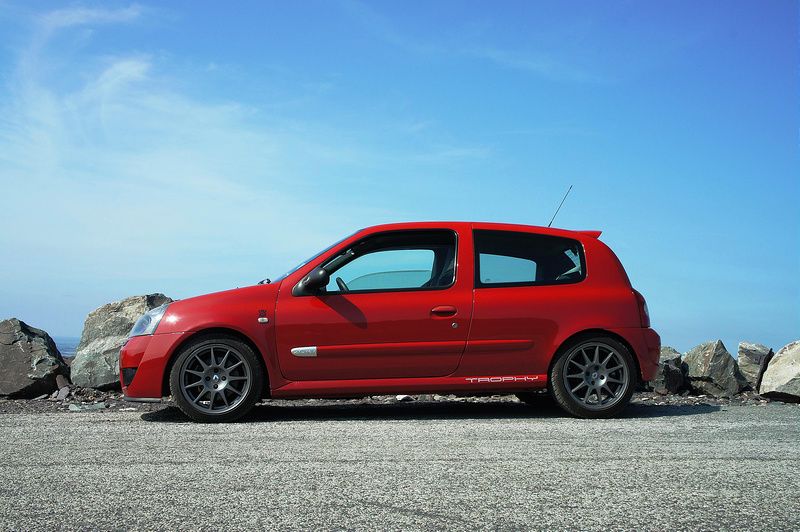

All torqued up and out for a quick drive. All felt nice and tight and I'd say slightly firmer, but nothing major over the standard Trophy setup tbh. More noticeable on the rear though. Overall very impressed with the ride. Although the ride height at rear I wasn't sure about at all but was going to see how it went over following few weeks.
DSC03632 by KeithRoberts185, on Flickr
DSC03645 by KeithRoberts185, on Flickr

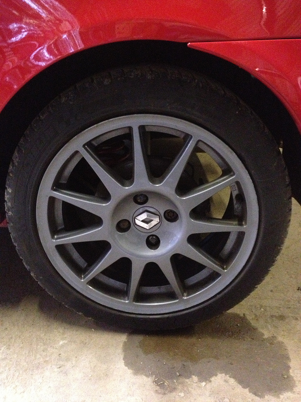

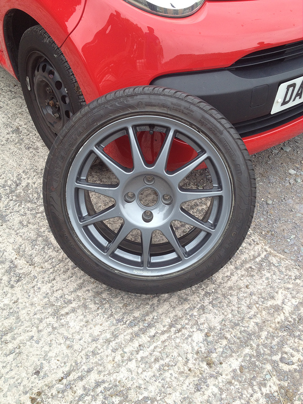

For Jamie (Jesus) I got a photo of the Cooksports with my track 2118's on. Not best photo due to the wheels and tires being so dusty.
DSC03650 by KeithRoberts185, on Flickr

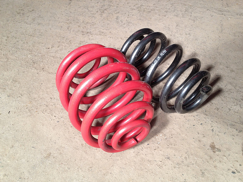

Difference in the way the springs are wound clear to see.
IMG_5072 by KeithRoberts185, on Flickr

The difference between the Cooksport rears and Sportlines rears are very minimal if any. Maybe the Sportlines are a bit softer than the Cooksports maybe. I'm very happy with the results now and my new setup (Ride and stance)
Next plans are Koni rear dampers and then some fine tuning of the rear beam.

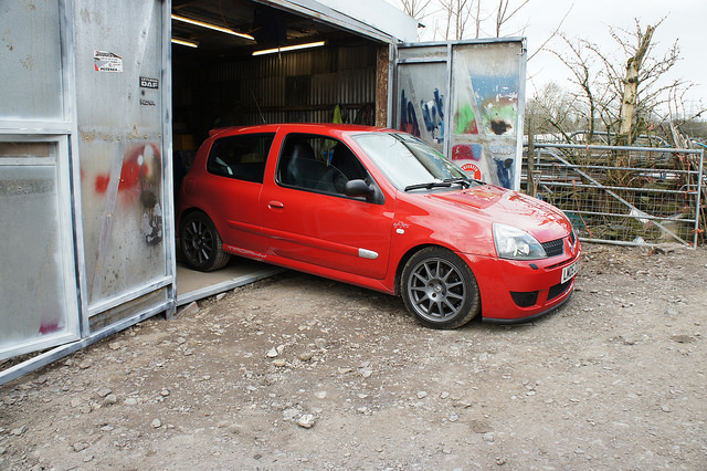

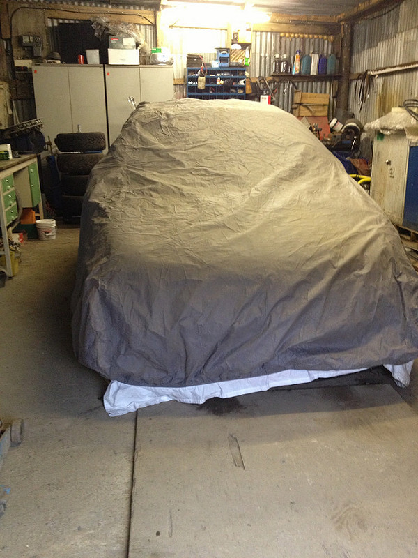

Not much has been happening other than my workhorse of a Trophy become a bit of a Garage Queen with me using another car to do all my commuting.
The Trophy being all tucked up on the farm in the garage.

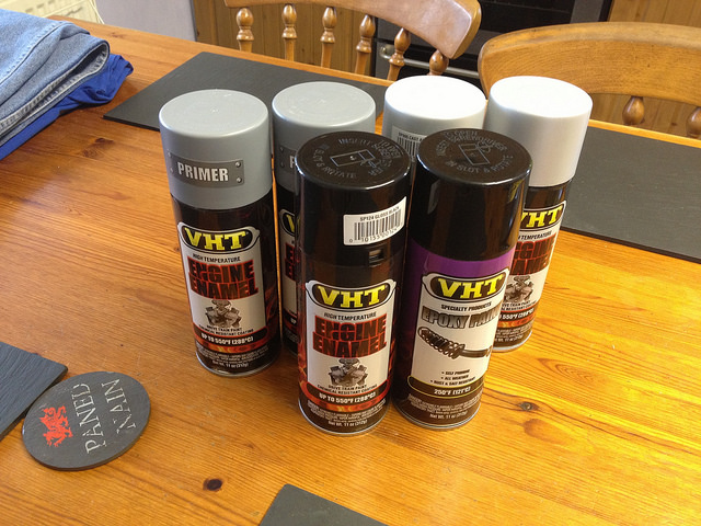

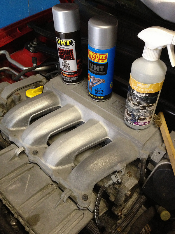

Had some paint bought over a year ago but saw VHT had some 'cast aluminium engine enamel' paint, so bought a some as the previous high temerature aluminium paint I'd bought had a too much of a painted silver look to it rather than the bare cast OE look I wanted (without the oxidisation) the VHT paint imo has exactly that.
Far inlet is the VHT paint, the middle two are the Hycote and the near inlet is just cleaned with Race Glaze stuff and brass wire brush.
My new collection of VHT paints for the engine bay, I can't praise this stuff enough, good quality paint with the best spray pattern I've seen from an aerosol.
Once the engine bay is done (as best as I can with engine in sittu) then I'll move onto the underneath and then a trip to Birchdown for the guys to give little red a service.

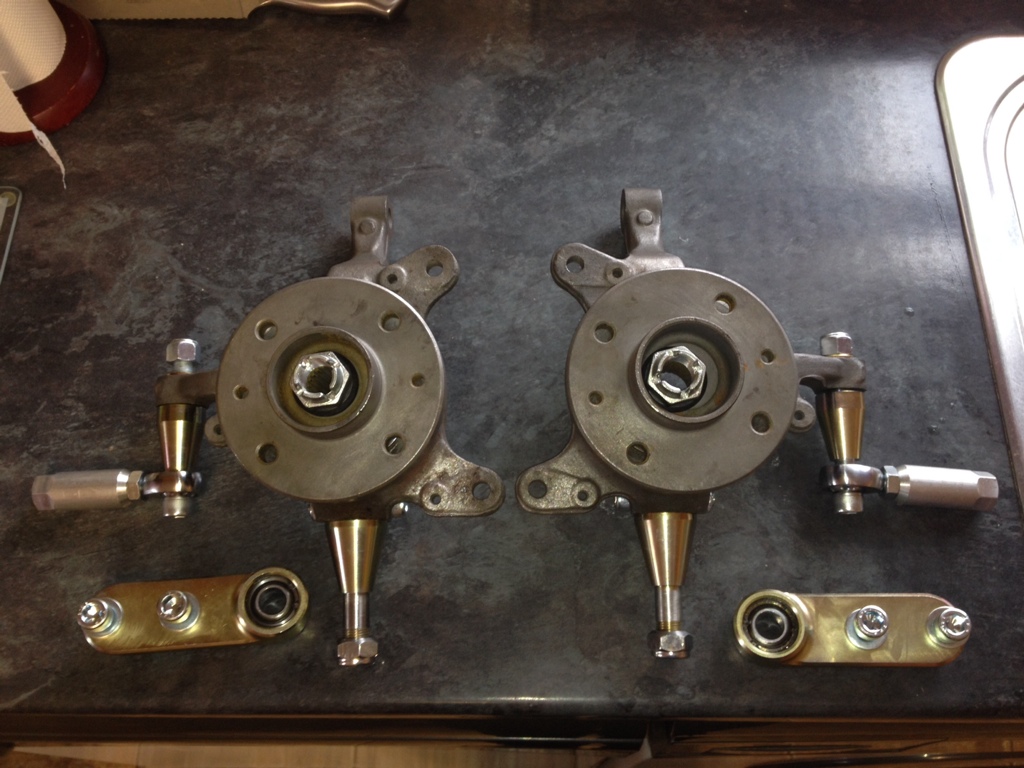

Hopefully will be buying the Roll center/bump steer correction hubs too from Mark and James :)

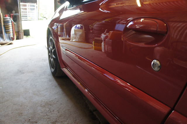

With car being in garage I thought this was perfect opportunity to finally sort out the bodywork properly, had bought meguaiar's microfiber correction stuff probably 18 months previously to try out as I could barely correct any marks with foam pads on the Trophy with a DA.
So washed, clayed and cracked on with the cutting compound, glazed and finished with some Zaino sealant to try to prevent pink-ing ;)
Took several weekends to get it sorted but end results were these.

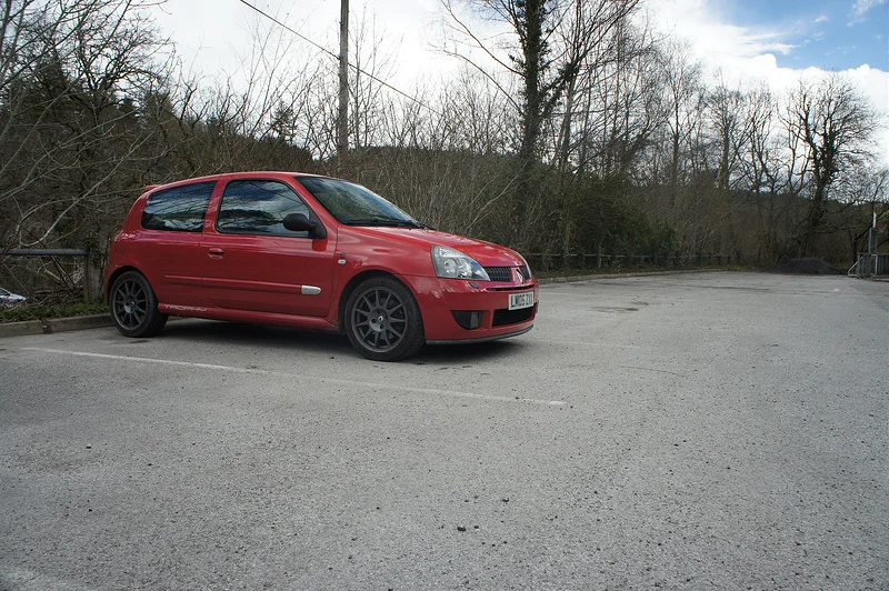

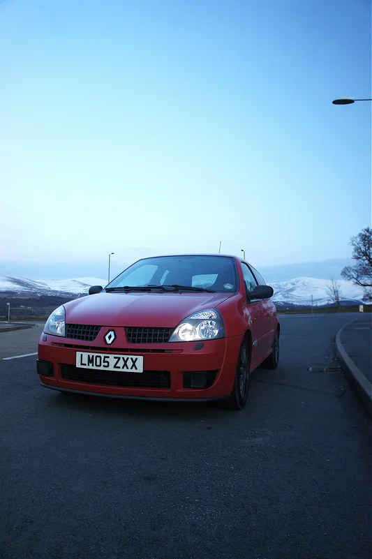

Sun was out today and what better excuse to get my little red Trophy out for a drive through the Welsh countryside.
Along with a few opportunities to take a few photos, didn't have much time to play around rather be driving and didn't have much charge on camera so sorry about the photos themselves.
And over the winter had taken the brake ducts off to re paint them. Had done a quick job on them almost 3 years ago and they needed a skim of filler and fresh paint. Ordered some pro-bolt screws and nuts (had to use cheap and nasty 'ebay rust solid and round head off after few months specials' last time due to needing them quickly and pro-bolt had no stock of length I needed)

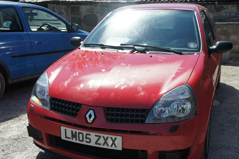

SharkyUK
Nicely done, Keith - the paintwork has come up beautifully. Capsicum Red is often criticised by folks but it looks fantastic when it's got that deep, glossy shine. It's great to see that you were able to get out and have a drive, too. :)
Keith185
Thanks Andy. Made up with it tbh, it needed to be done for years tbh. Miss driving it so much, almost 7 years on and still puts a smile on my face :)
