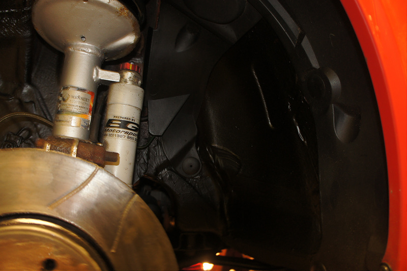

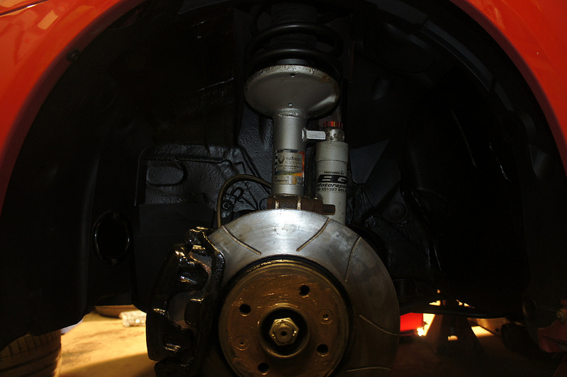

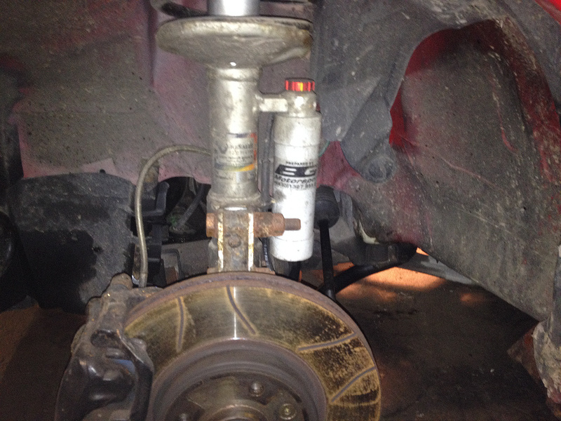

Keith, the driver's side damper failed (and put me in a grumpy mood, for which I apologise!) :eek: Zero damping and a very crashy ride (with a fair bit of knocking). When getting them refurbished (and prior to refitting them) I would definitely recommend taking some extra time and care to treat them with your favourite life-prolonging products. I can't say what caused the failure but it wouldn't hurt to protect them against the elements. :)
Mikey, the variation in miles between rebuilds can vary greatly from what I've seen. From memory, I managed to get to 80,000+ miles before having to get mine done for the first time! And that was with hard driving and a liberal sprinkling of track days throw in over the years... Hopefully you will see similarly lengthy periods of health for your Sachs! (Ooer, that sounds dodgy...)
Balls, not good to hear. Id deffinately recomend getting a pair of cup dampers to throw on, if youre (im assuming ;) planning on keeping car long its a deffinate investment in my opinion and even new I don't think theyre more than £50-60 each. I've got second hand set of them for mine. If you're in trouble with them let me know I can always send my set down to tie you over while you get something/yours sorted.
Thanks for the advice and offer, Keith. Thankfully a friend local to me rolled up yesterday with a spare set of Cup dampers and they are now on the car. They will keep me going for a while and - yes - I may well invest in a pair sometime soon as well. :)
Keith185
Thats good news, have fun seeig the difference between the cup and sachs, differance is staggering tbh. Need anything anytime just let me know.

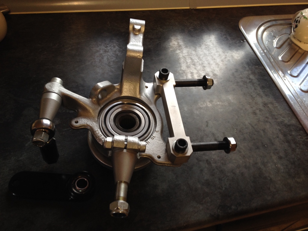

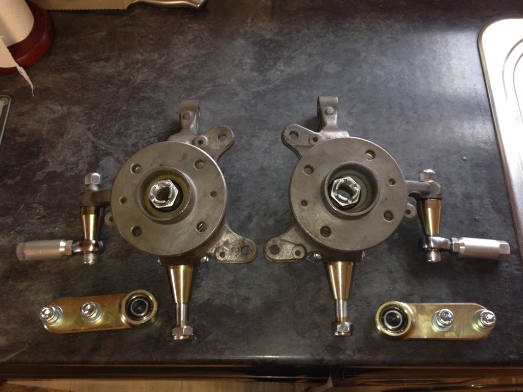

Is this the bump steer that northloopcup is doing . Looks amazing. is that what the zinc coating looks like on the hub?
oh and is that the brembo 4 pot adapter too?
NorthloopCup
It most certainly is mate. The hubs were sent to me already shot blasted and cleaned up - made such an improvement! They impressed me that much, I sent a picture to James and got him to upload it on here when they'd been done!! The machined parts are zinc plated mate, but not the hub.
Keith185
Yeah that's the ones from Mark. All exposed parts have been spray painted on the hubs along with some of the zinc coated parts for extra durability from rust and to give an OEM look.
And yeah those are the 280mm brembo brackets from Chris.

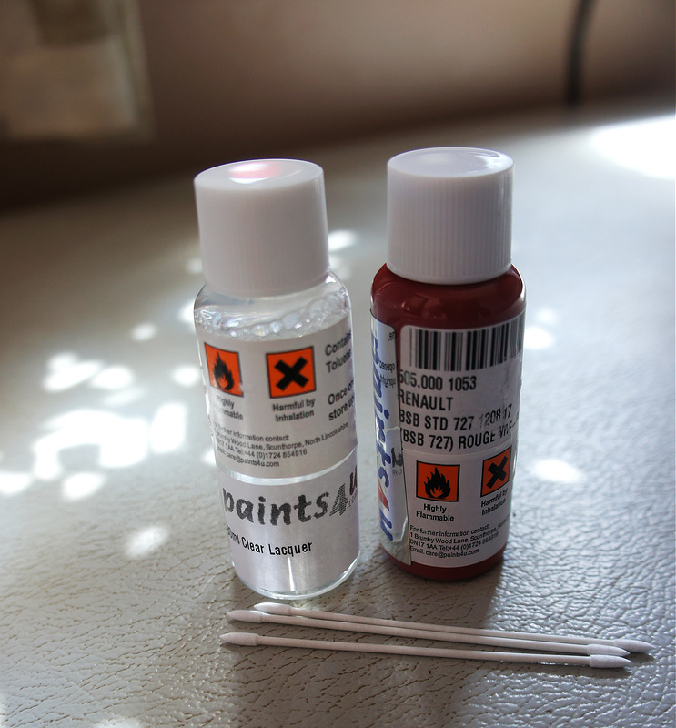

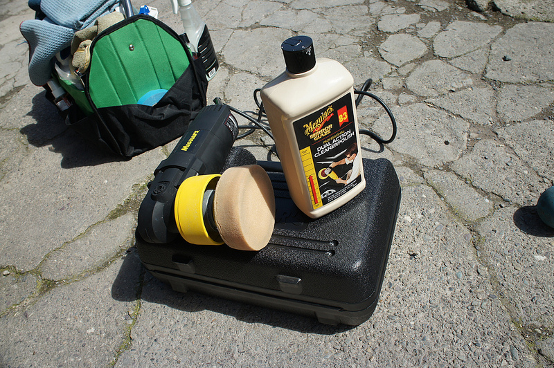

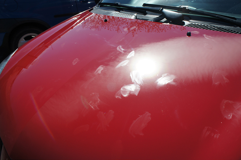

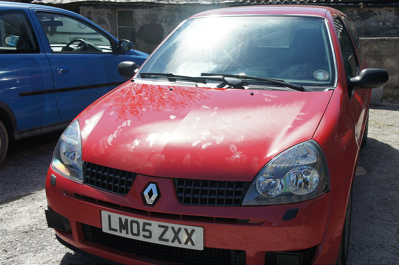

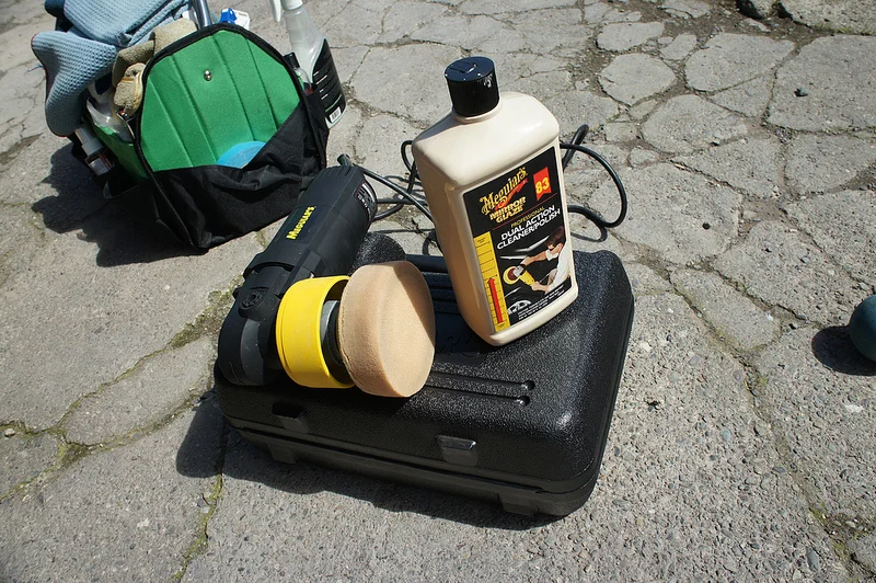

Having read on detailing world about a technique (Similar to Dr Colourchips road rash kit instructions) I wanted to try this, bought some touchup kit and mixing both the colour and clear together in equal parts, using a lighter fluid coated cloth I smeared the paint over and across the chips trying to be as neat as possible.
DSC03154
by KeithRoberts185, on Flickr
Bonnet left looking like this which was a bit daunting haha.
DSC03160
DSC03165
Out with the DA (should have borrowed brothers Rotary)
DSC03164

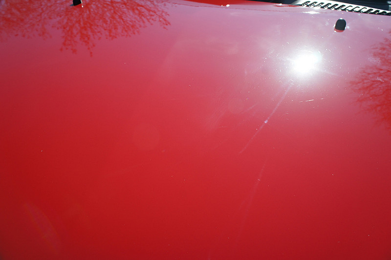

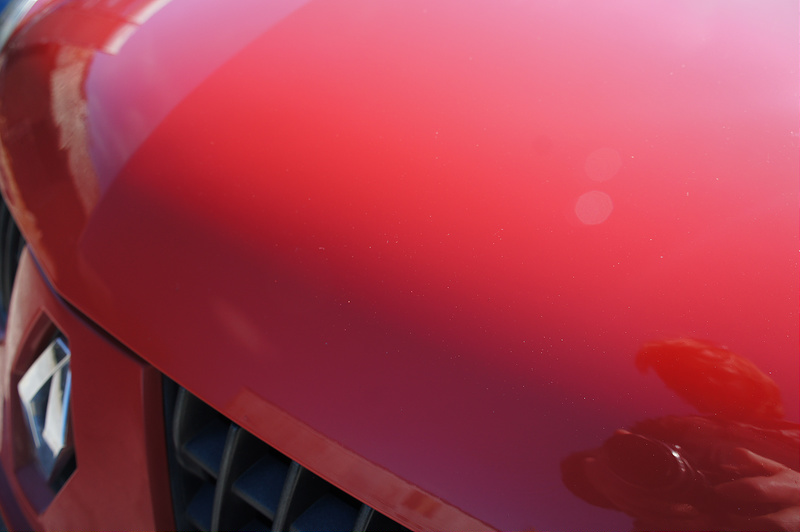

Eventually was left with this, still some work to do on the paintwork in general but the chips are pretty much gone now.
DSC03168
DSC03167
The marks in photo above are dust/polish.

Cheers Keith, Had found them eventually last night.
How did you find the Paints4U paint?
Found it a perfect match. Used the touch up kit in my Clio and used an aerosol on little brothers car where I had to spray only bumper and looked perfectly matched.
I'd recommend them Jamie.

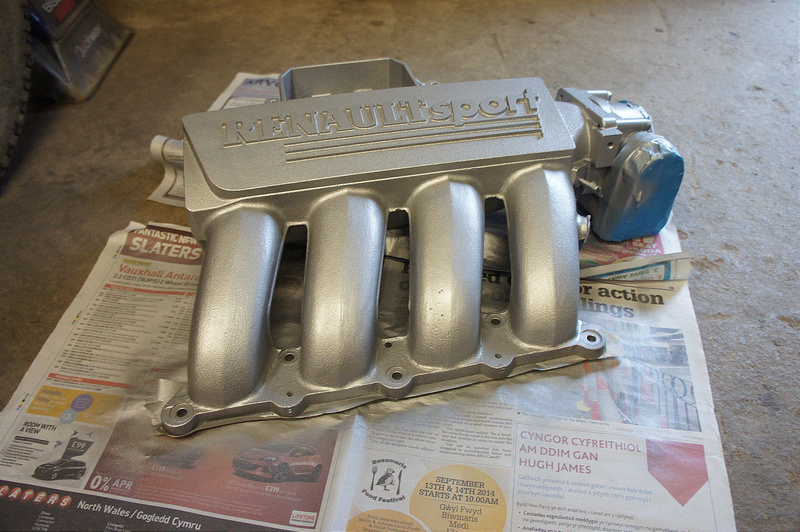

ENGINE BAY

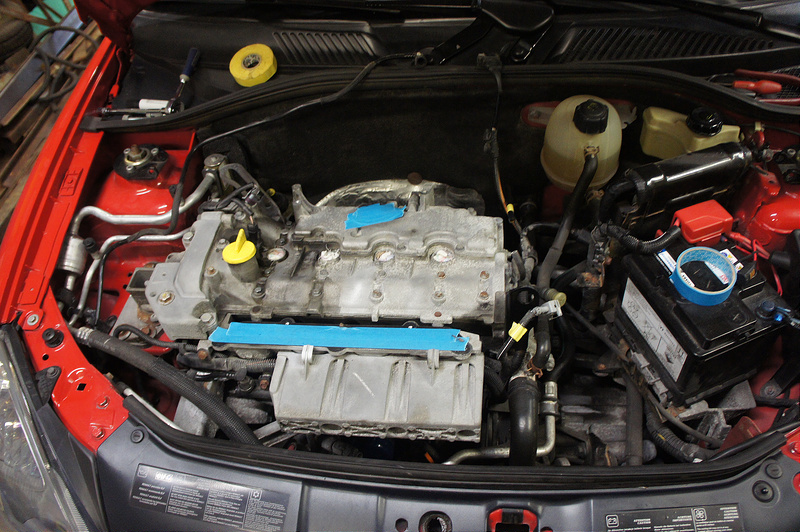

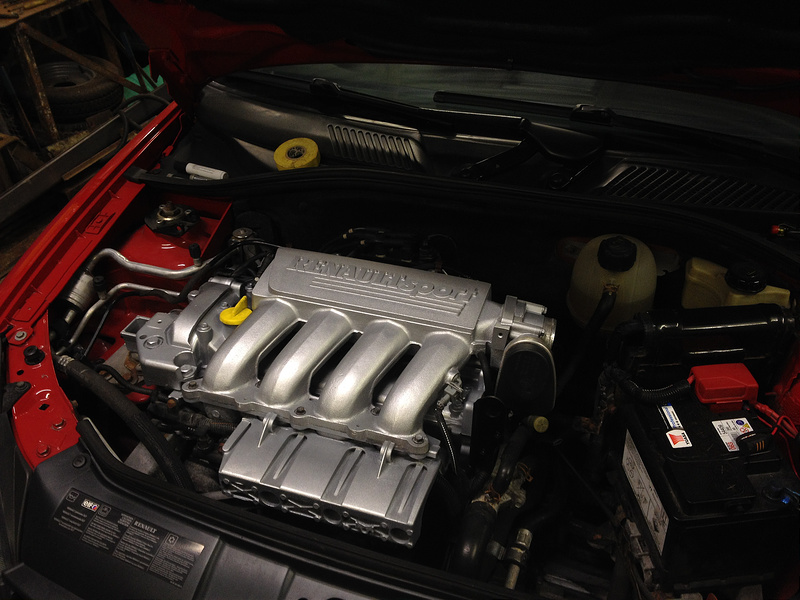

With me not using it every day anymore oxidisation of the bare aluminium parts was even more apparent than it has been. With me having bought all the paints 6+ months ago I got on with finally getting the upper engine bay painted. Paint of choice was my favorite VHT paints engine enamel in aluminium colour.
Extent of oxidistation
DSC04230 by KeithRoberts185, on Flickr
Prep work
Using various Brass wire brushes and RaceGlaze Aluminium cleaner.
DSC04236 by KeithRoberts185, on Flickr

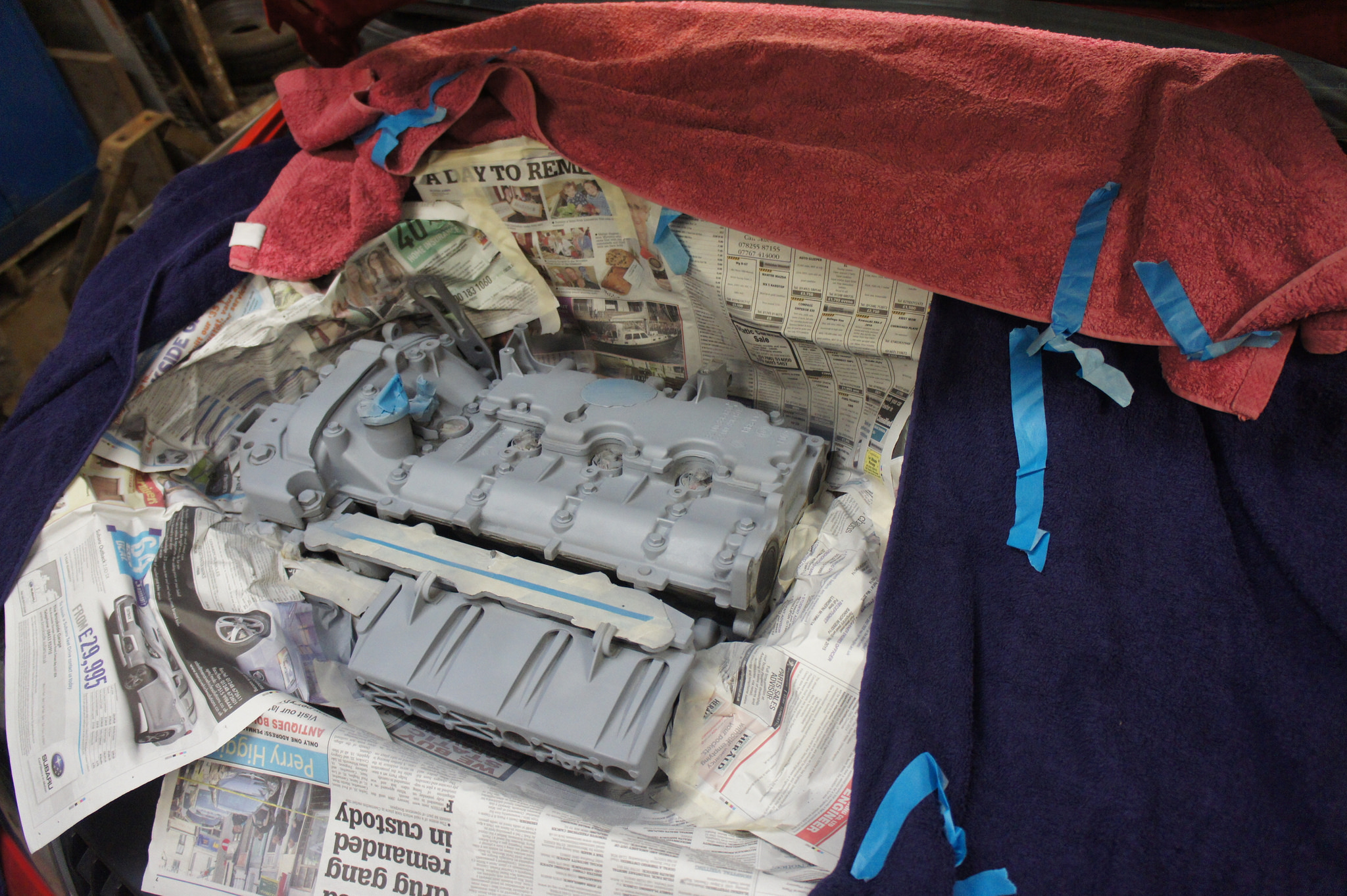

Primed
DSC04240 by KeithRoberts185, on Flickr
DSC04242 by KeithRoberts185, on Flickr

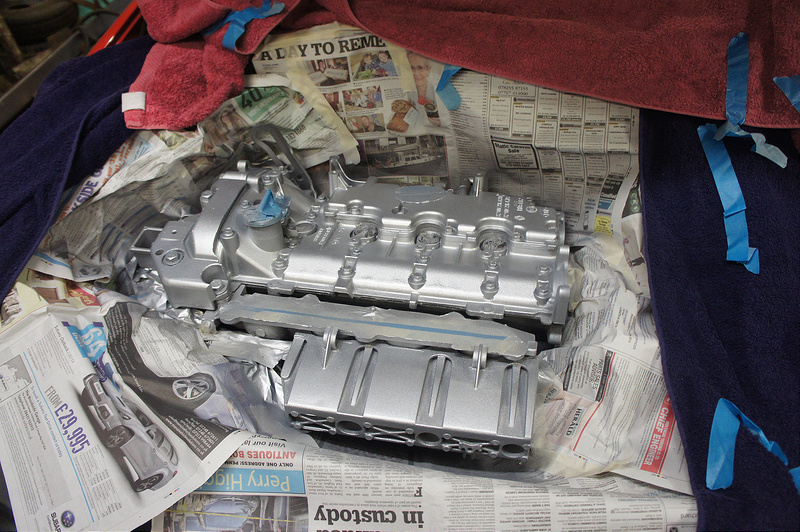

Top Coat
DSC04244 by KeithRoberts185, on Flickr
DSC04246 by KeithRoberts185, on Flickr
Finished

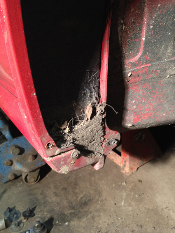

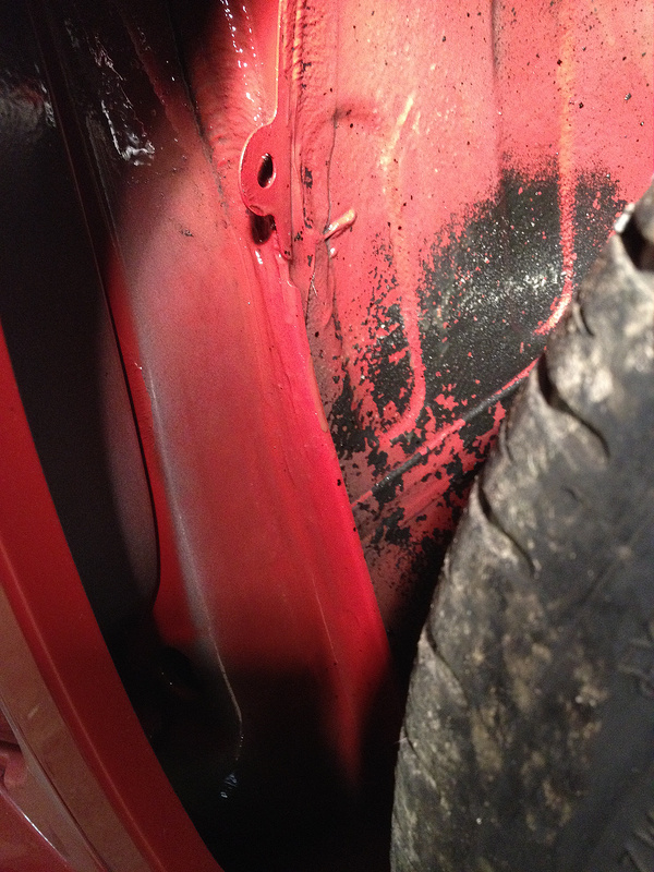

First time the rear part of the front arches had been off and wasn't too bad considering the cars been living on a ffarm most of it's life. Used Bilt-Hamber's range of underseals due to the great reviews and not having to mess around with spray guns. Again as is the trend with me I had had these last autumn but didnt get round to undersealing.
IMG_8095 by KeithRoberts185, on Flickr
Was using Bilt-Hamber's UB and UC range for the arches. Using the UC (Clear stuff) for anywhere that didn't have any underseal from factor and the UB (Dark brown/Black stuff) for anywhere that had been undersealed by Renault as I was trying to protect the underside but not make it look un-original wanted to retain the factory finish where I can.

A quick before and after of the arches. Sorry for some of the photo quality, work was done over a week and sometimes had my dslr othertimes just phone.
Before
IMG_8113 by KeithRoberts185, on Flickr
After
DSC04278 by KeithRoberts185, on Flickr
Really happy with finish, was worried the UB would have a brown finish but looked black to me.

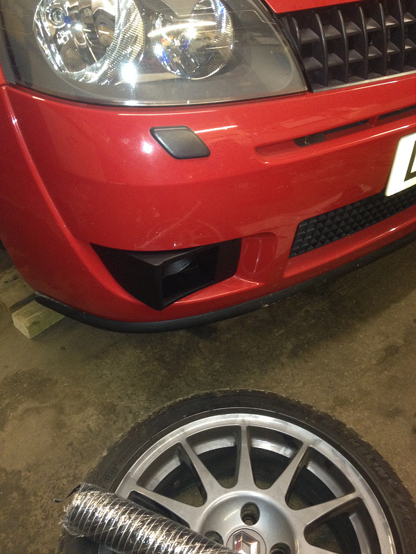

BRAKE DUCTS

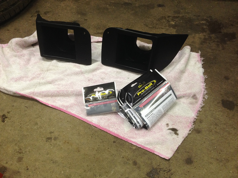

Following taking these off the car to repaint them quite a few months ago . . . :3 Finally got around to refitting them with nice new pro bolt fixings and new ducting.
IMG_8128 by KeithRoberts185, on Flickr
IMG_8131 by KeithRoberts185, on Flickr

What brake ducts are they?
Look neat.
They're ones guy on here, Damien (cant' remember his username) made in a group buy here 3-4 years ago. He used the genuine cup racer ducts design but mouleded them onto standard foglamp surrounds so they fit tidyer than the cup racer ones and needed minimal cutting of the bumper. The original fixing points for foglamps and the surrounds are retained.

Hi Keith, do you know what paint was used to paint the hubs as well as any primer. Also did you remove the bearings when you had it shot blasted.
Keith185
I used VHT Paints range of engine enamels to prime and top coat the hubs but have tried other products and Hycote Aluminium Paint is very similar for lot less cost, think they've got their own range of engine enamels too.
http://www.vhtpaint.com/products/engineenamel/
http://www.eurocarparts.com/ecp/p/c...aints-and-primers/paints/?552776141&0&cc5_159
The hubs were cleaned up using Bilt-Hamber Deox C anti rust bath, i cleaned them up with old bearing still on but only because i was getting them replaced same time as the machine work, otherwise I'd have removed them before hand.
http://www.bilthamber.com/corrosion-treatments/deox-c
