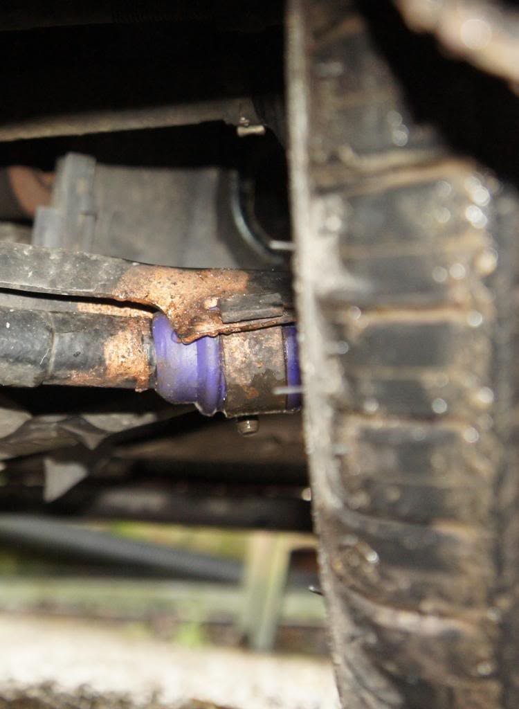

3. Fit Replacment outer ARB bushes

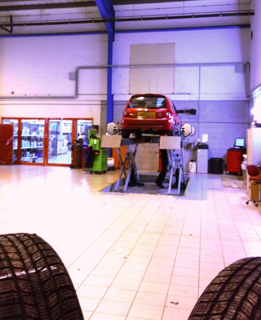

6. Full front Alignment.

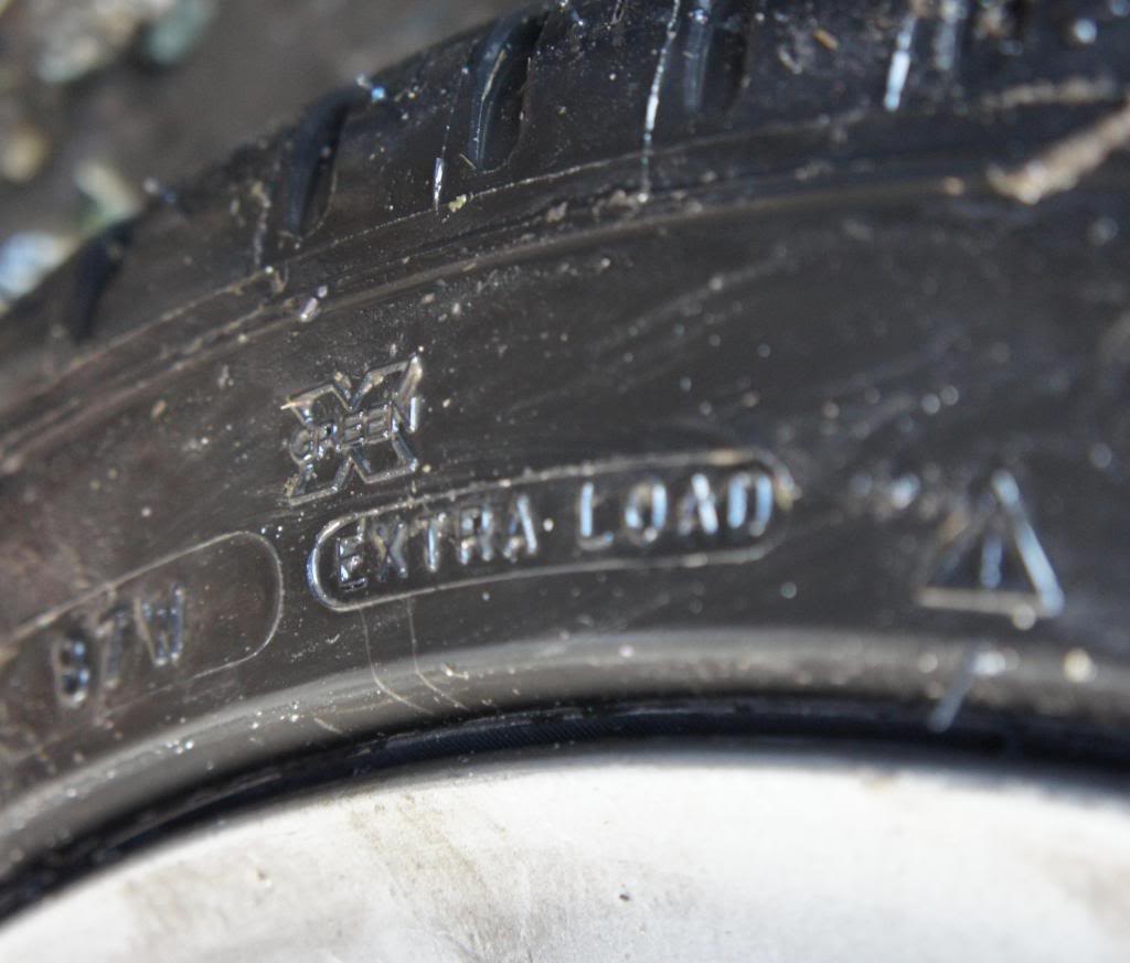

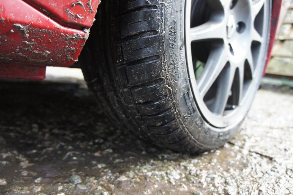

Car feels so much better now. The Extra load version of the PS3's have given a lot more feedback to the front end that I had lost with the normal PS3's compared to the Exaltos. Cant recommend fitting these over the normal rated ones enough.
Had allignment put back to how it was couple years ago. Basically toe at parallel and camber set at -1.5 deg. Found this to be best comprimise for Daily and few track days a year.

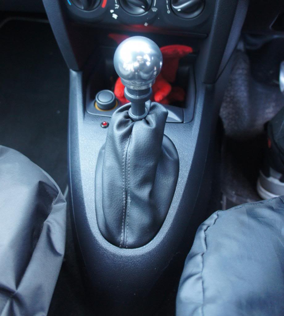

The Yanoo stiff shift kit is awesome. And out of the 3 elements of the kit (Metal housing, pivot ball insert and lower linkage bush) I only needed/was able to fit one, being the metal housing but what a change it's done to the feel of the gear stick movement.
Best comparison I can describe is that it's much closer to the feel of the RS200 ive driven. Sloppyness is gone and feels more direct and positive. Whether the actual gearknob had contributed aswell to feel with it being metal fixed right onto the metal shaft of gearshift who knows but I'm more than chuffed with it. Kicking myself that it took me about 3 years to actually decide to fit it.
Big thanks again to Steve and Andy for the work and Powerflex for their awesome customer service.
I'm always saying this! The W rating makes all the difference!

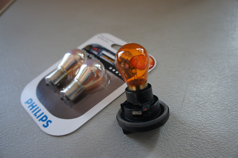

Just a small update, years on here have subconsciously twisted my arm to change the indicator lamps from the standard orange ones to some Phillips Silver Vision ones lol.
Before
DSC02896 by KeithRoberts185, on Flickr
The Phillip ones didn't seem to have as thick a silver coating as similar ones i've used on other cars and had 'E' approval.
DSC02911 by KeithRoberts185, on Flickr
After
DSC02926 by KeithRoberts185, on Flickr
DSC02925 by KeithRoberts185, on Flickr
Such a small change and cleans up the front and rear end. And these have to be the esiest lamps to change on a Clio, why can't all the lamps be as easy to change as these.

Was wondering whether you can remember how you fitted the gearknob? I am looking at gearknobs, but I am clueless as to whether there is a thread on it or not!
Also, how are you finding the stiff shift, worth it?

The gear knob I have is just a grub screw holding it. The old one was pressed/glued on and a right pain to remove intact. I ended up cuting it off as I bought a spare complete gear mechanism that I fitted the stiff shift kit onto and swapped it all over and still have original one if I ever refit.
The kit is brilliant and worth every penny. If you go onto their website their guides show a lot of detail as to the fitting process and getting knob off. I tried but gave up as wasn't bothered about keeping the knob off the spare lol
