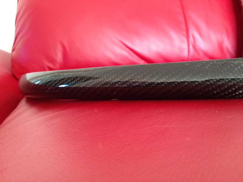

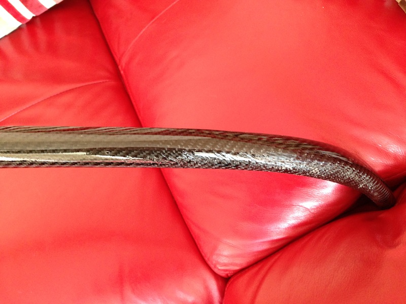

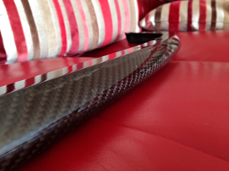

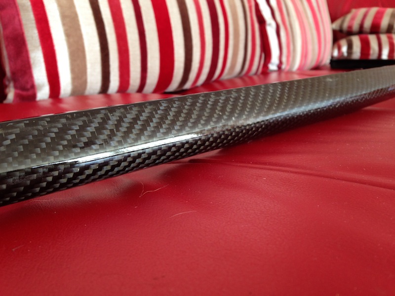

Well got my bargain splitter back.
Bought this for a grand total of £40, took it to work and rubbed it down and then got it lacquered today.
The splitter is badly damaged at one side and the scuff will not come out as its too deep.
Damaged Corner Below

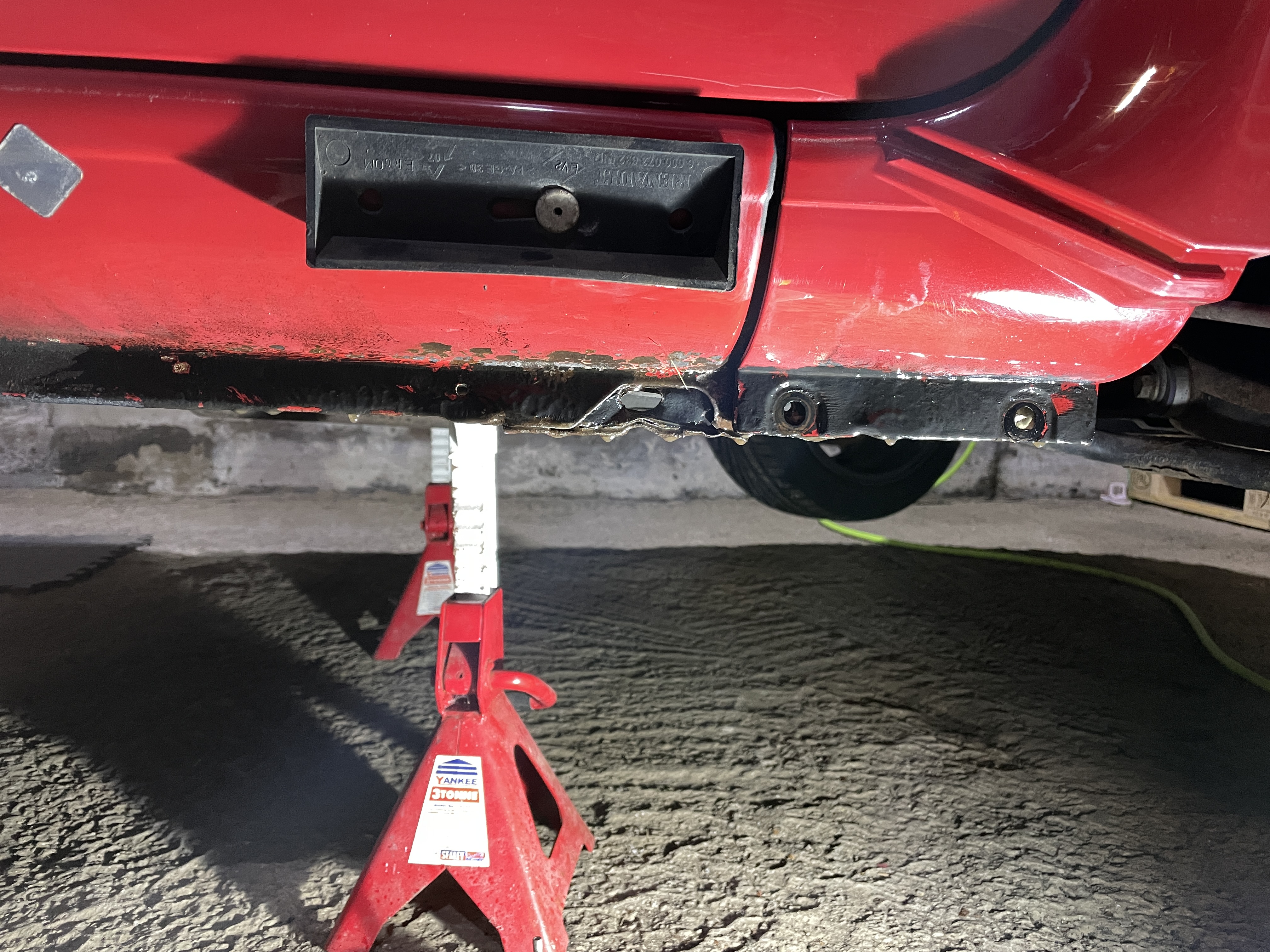

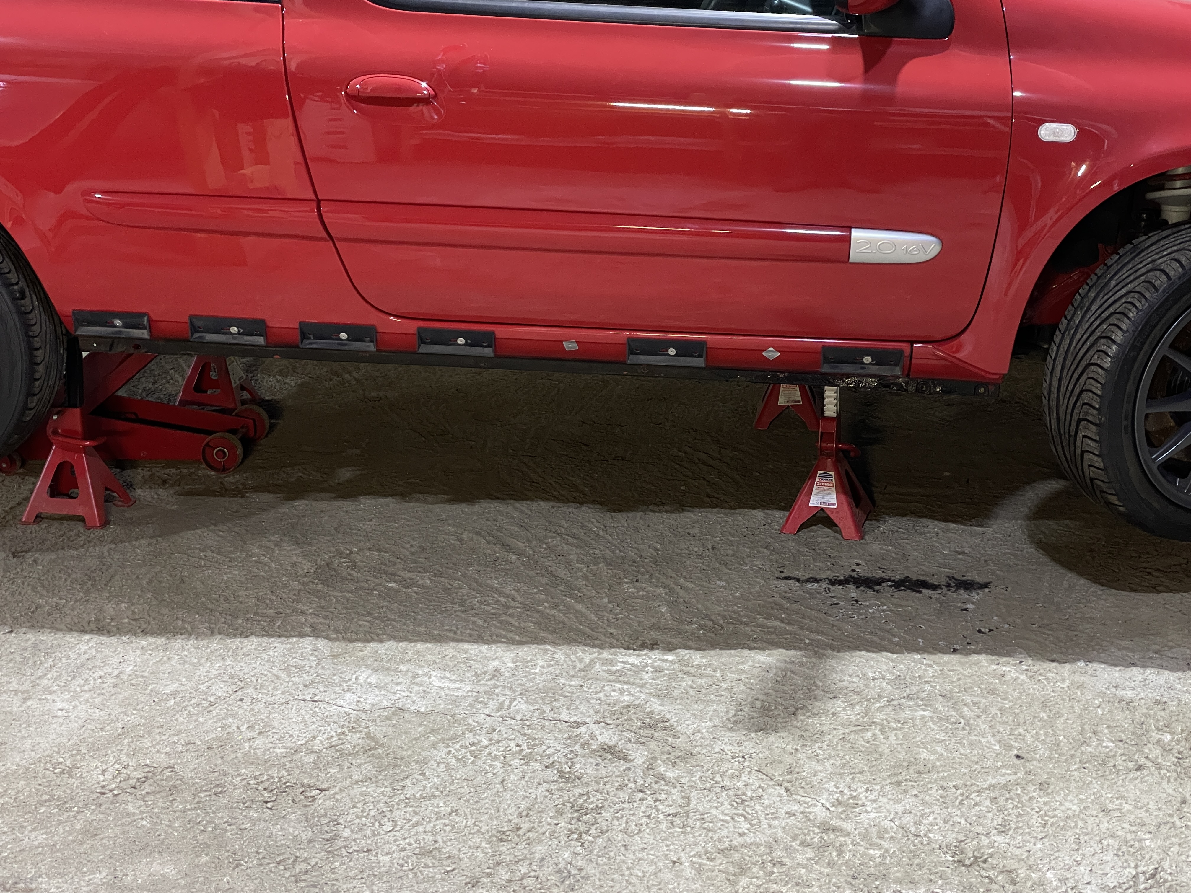

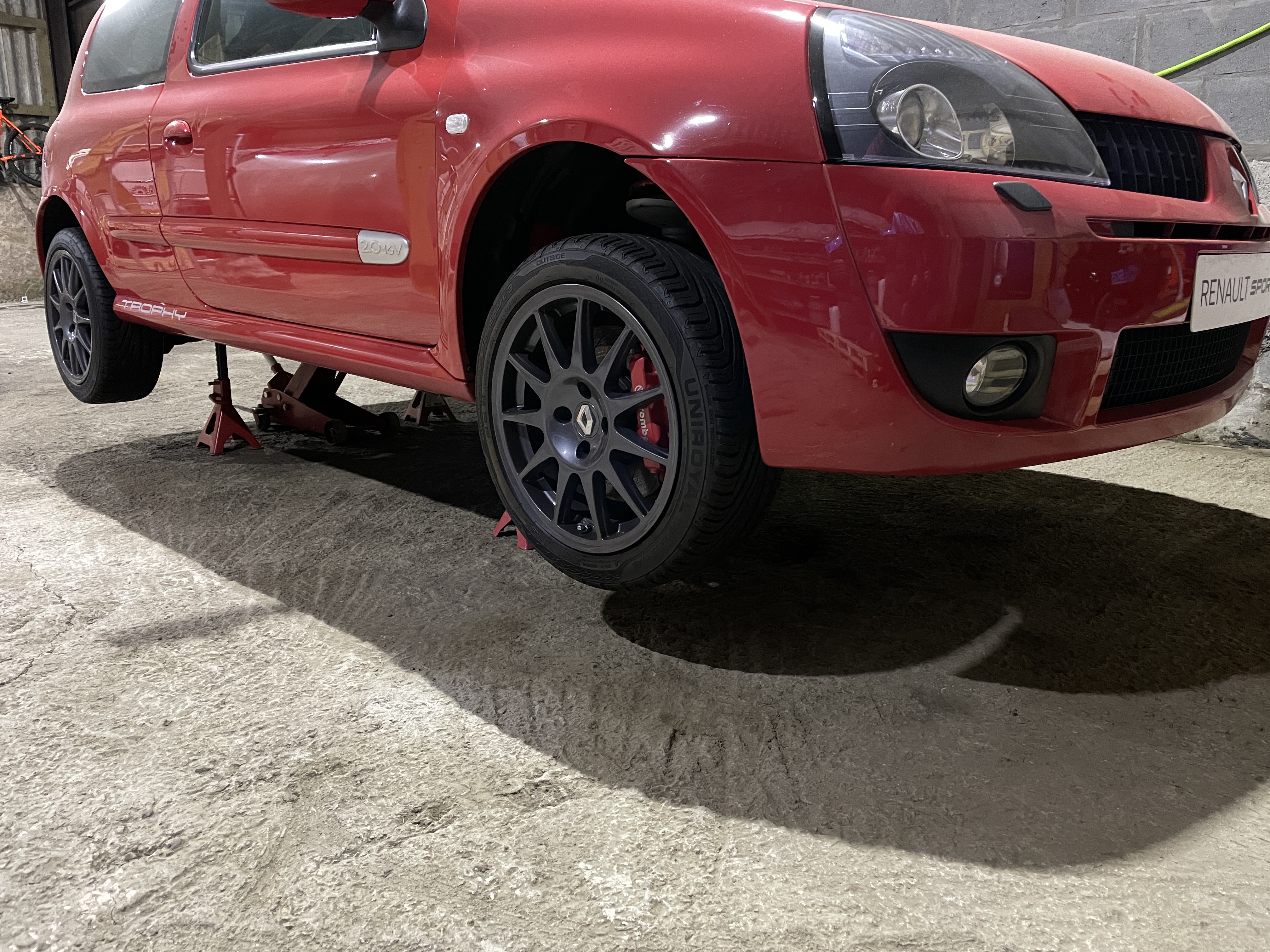

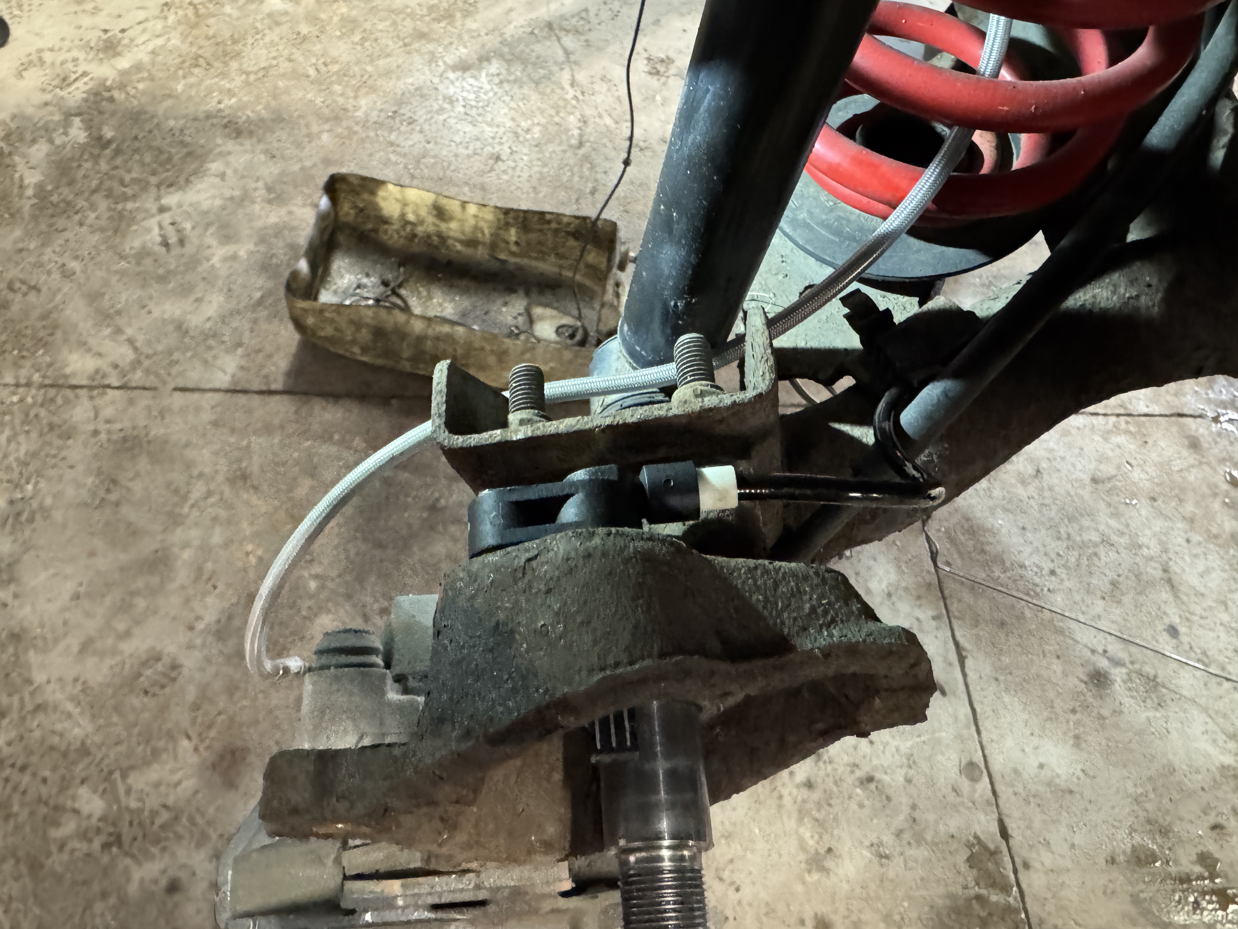

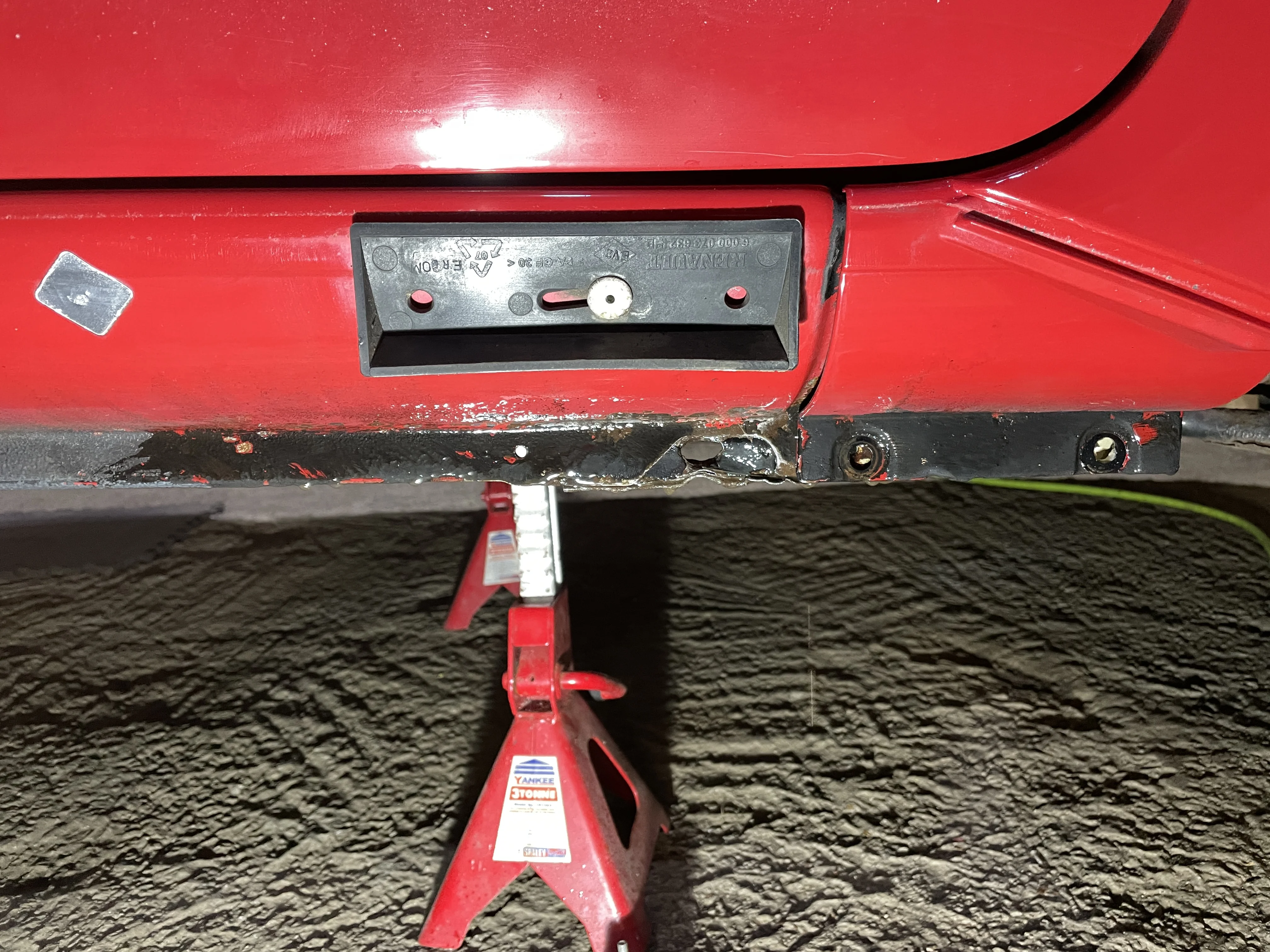

Been a very very long time since any of this was updated but decided to bend back some badly crushed jacking points.

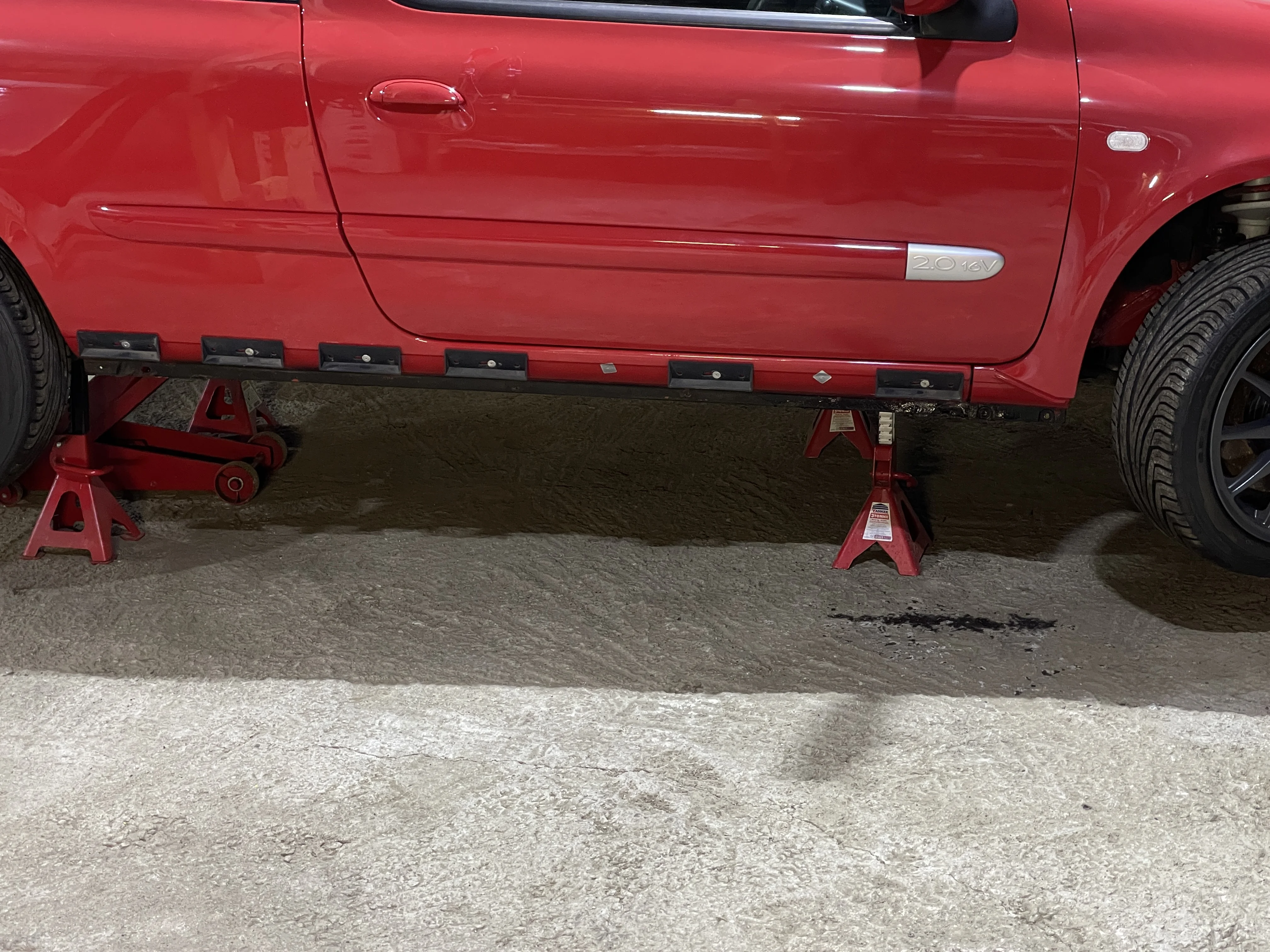

Todays jobs where to get the car jacked up, Get the side skirts drilled out and off.
Then it was a case of using a wire wheel & brush to brush as much as I could to remove any rust build up.
Managed to bend the front wing back and get in there also.
Was then given two heavy coats of rust treatment and left to dry and cure.
Going to be getting some underseal back on the sills under the side skirts and then take it from there.

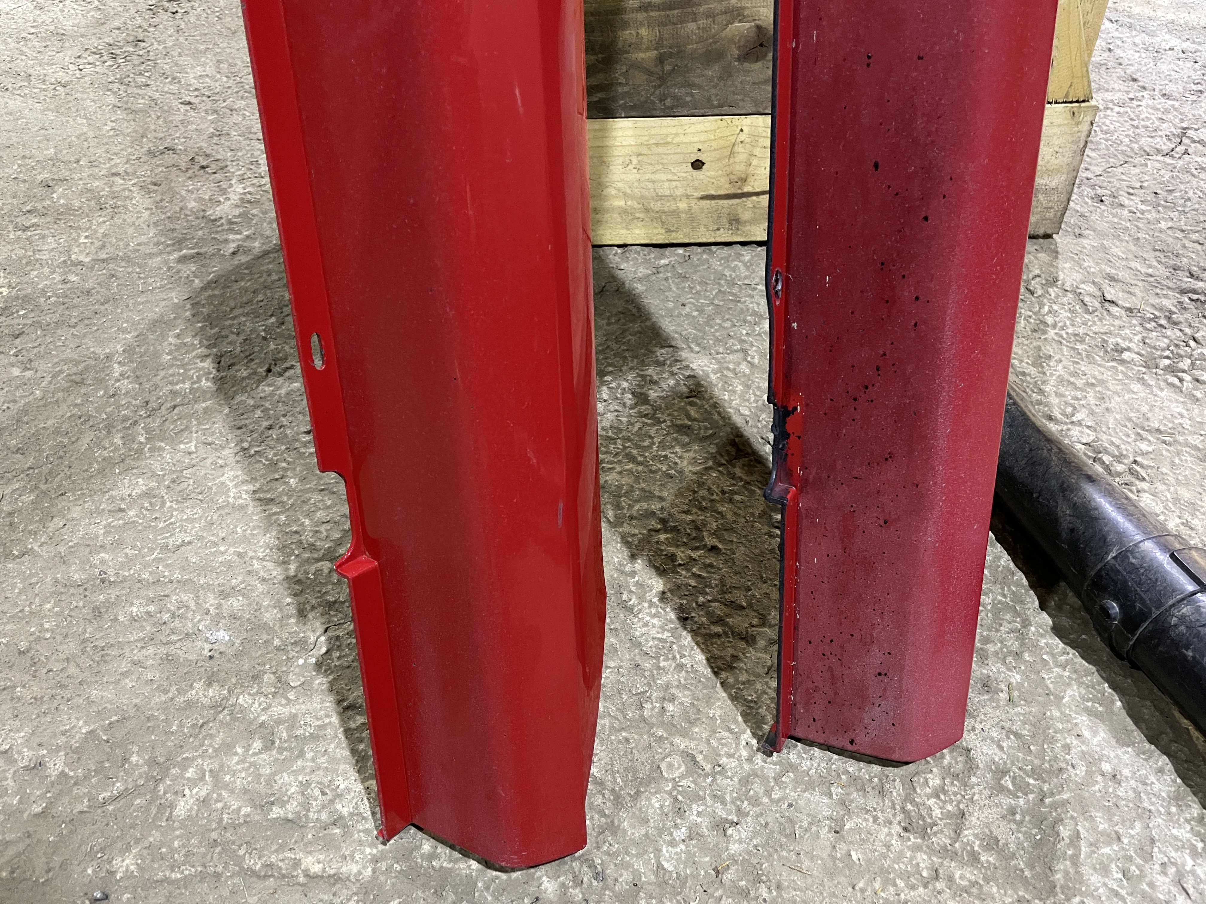

I have two sets of sills and as you can see one is in far better condition than the other.
Im looking to get the spare set fully rubbed down and painted correctly with new trophy logo.

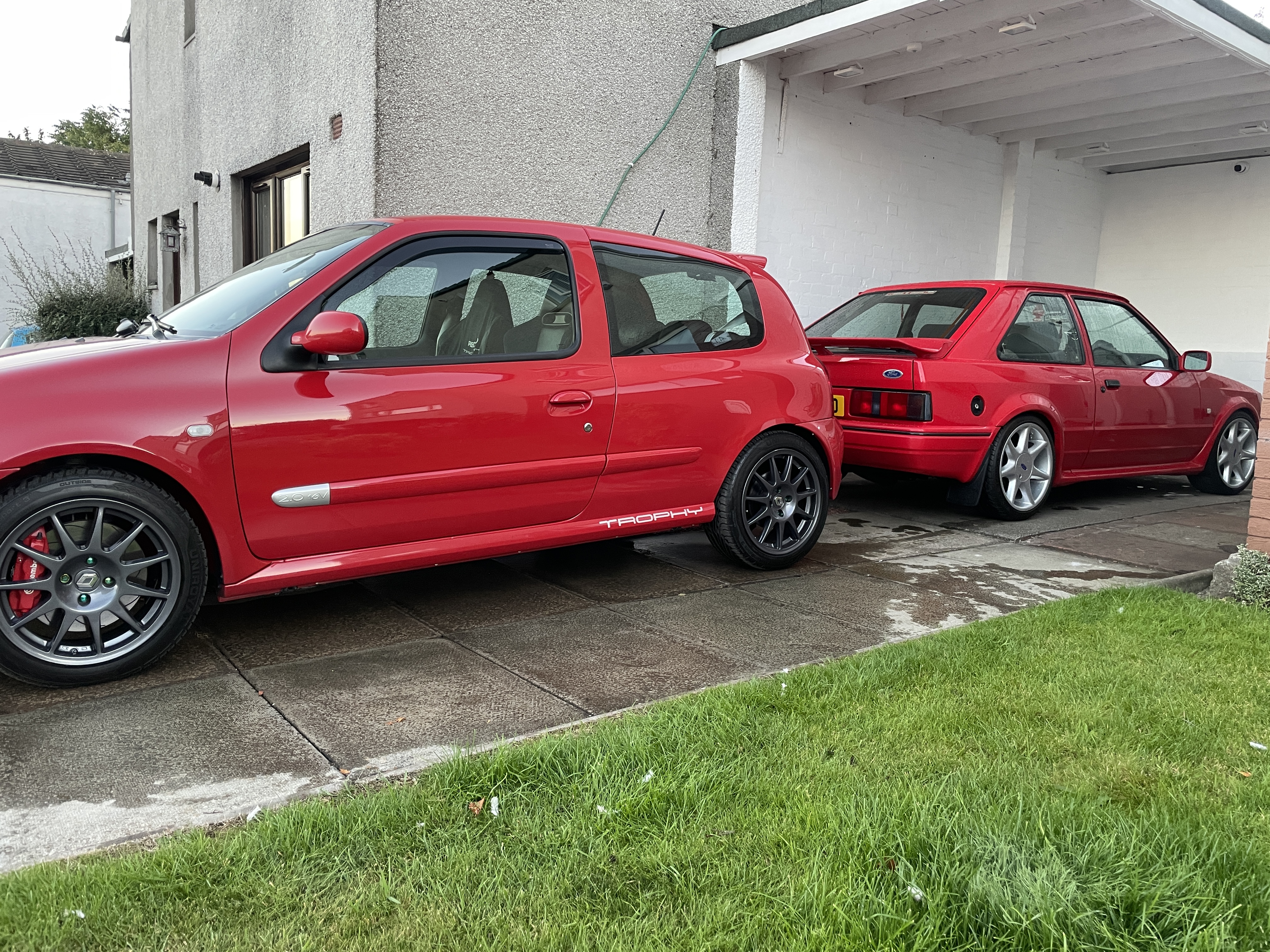

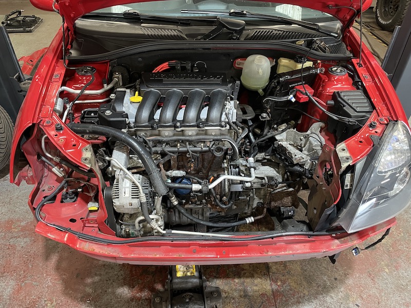

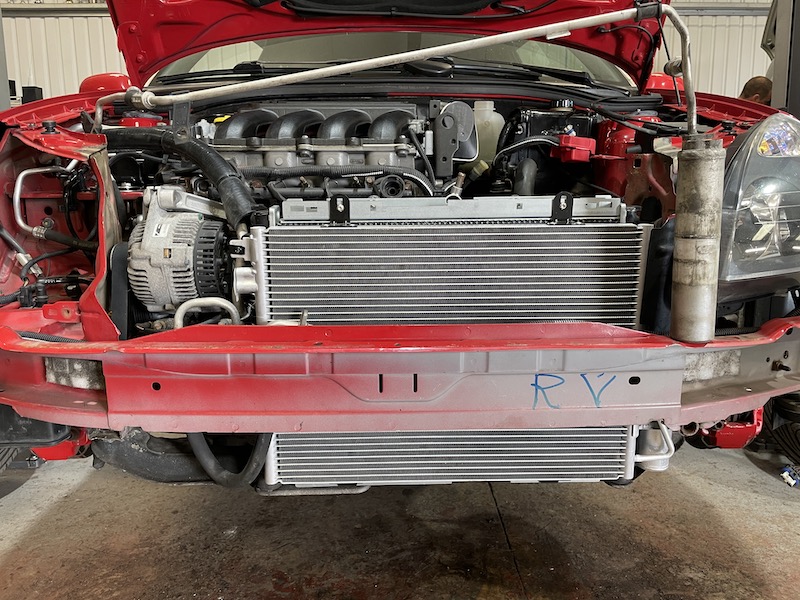

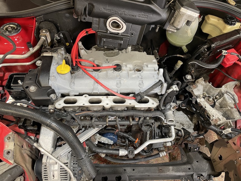

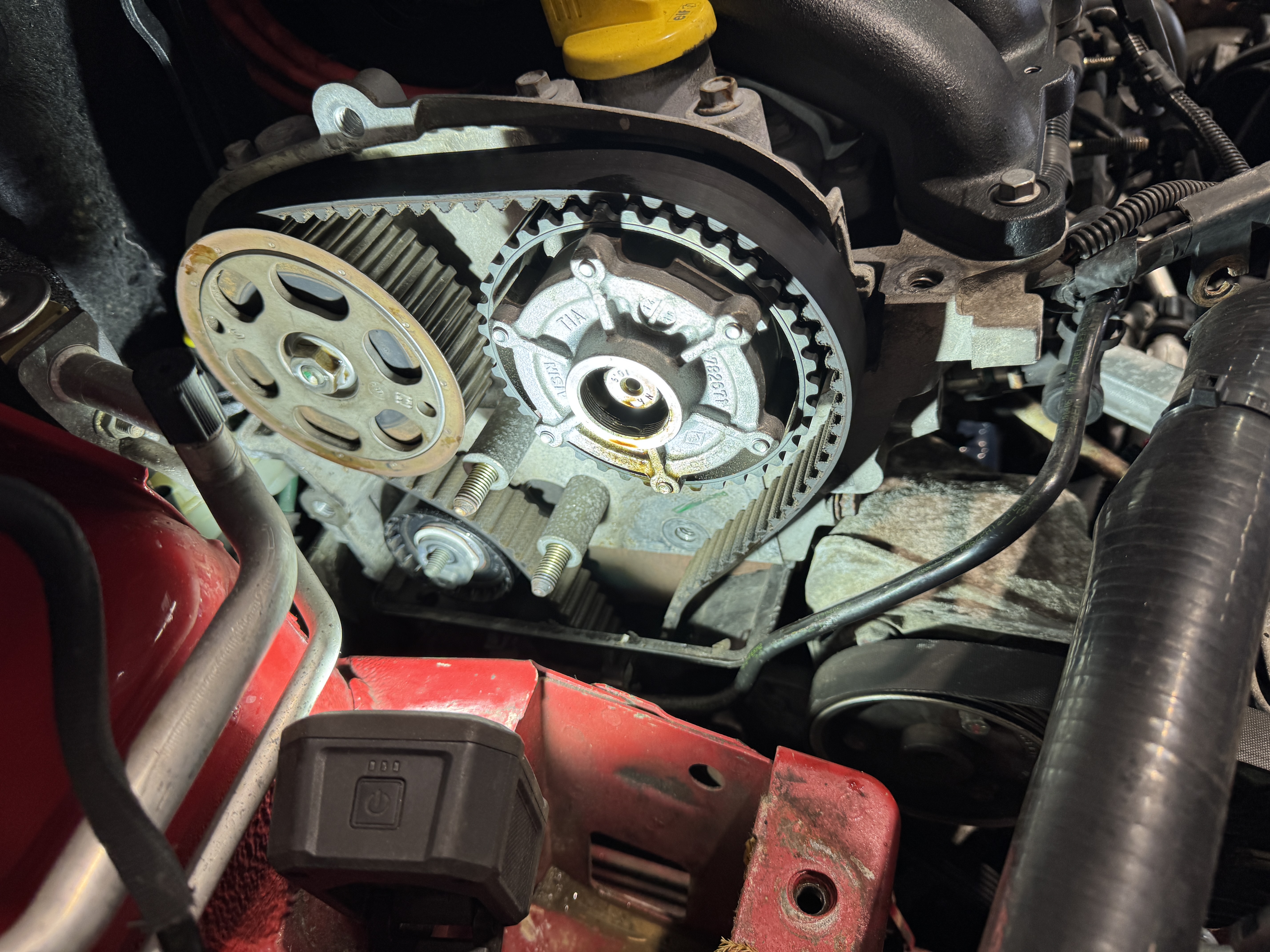

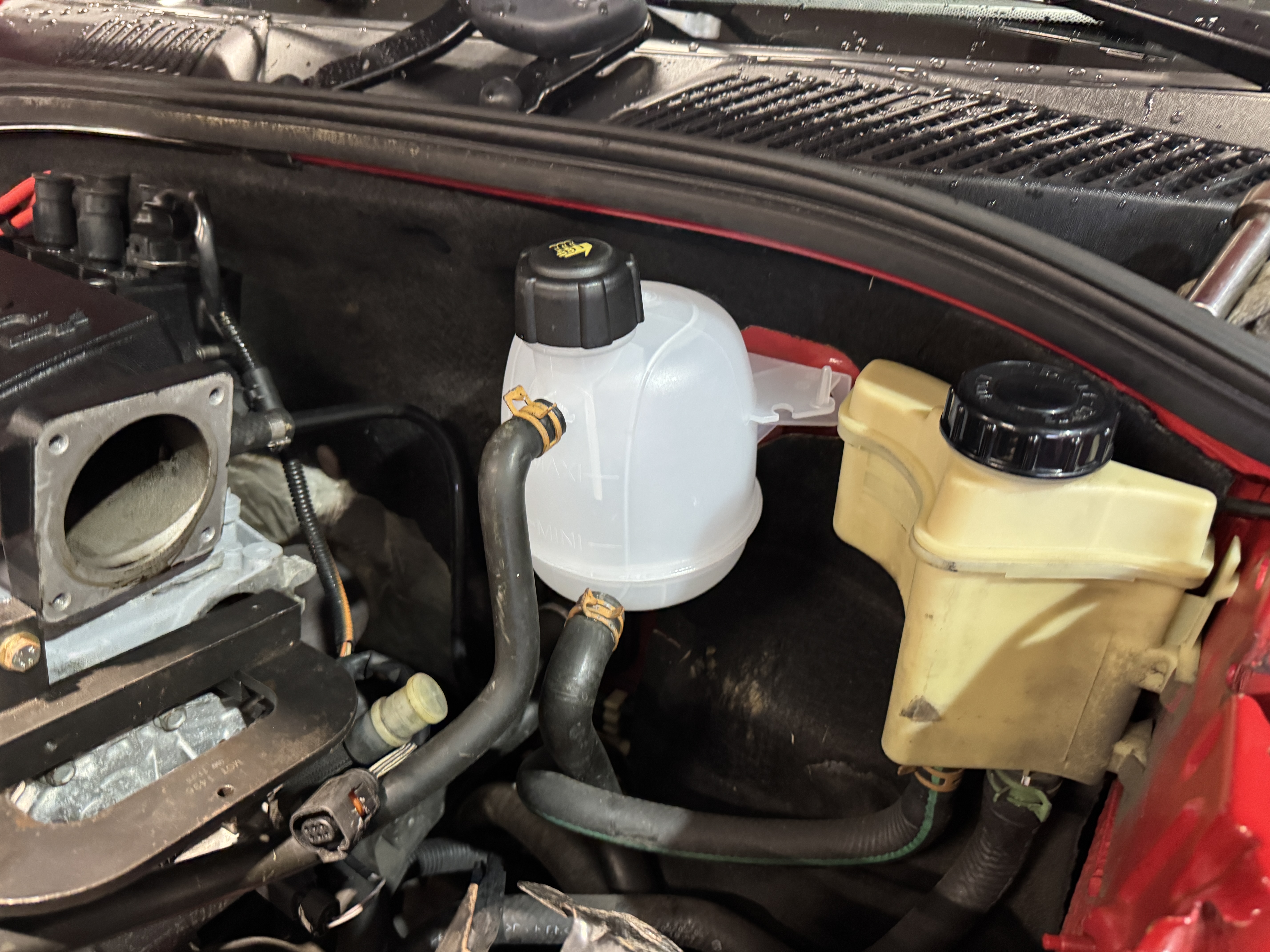

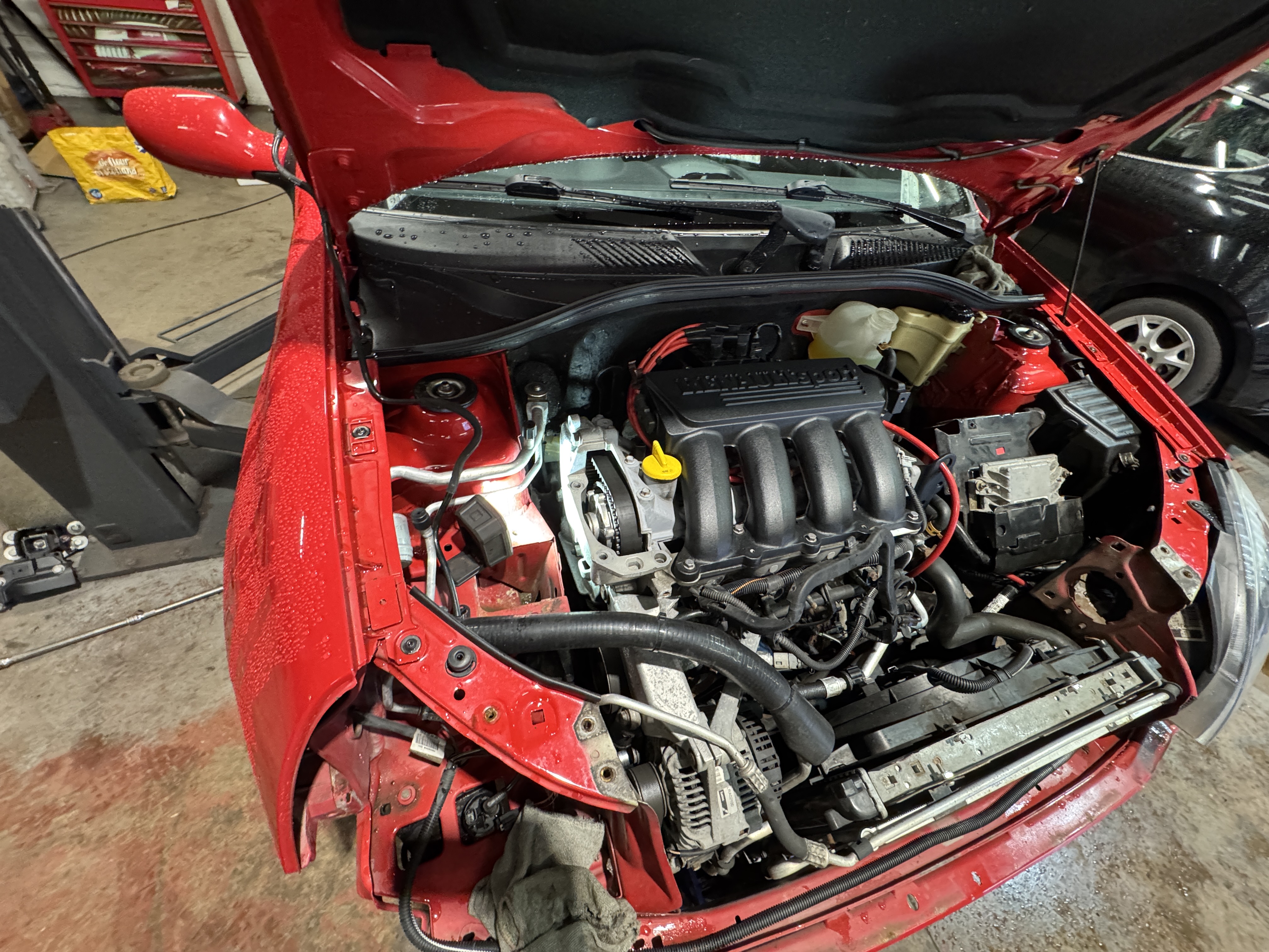

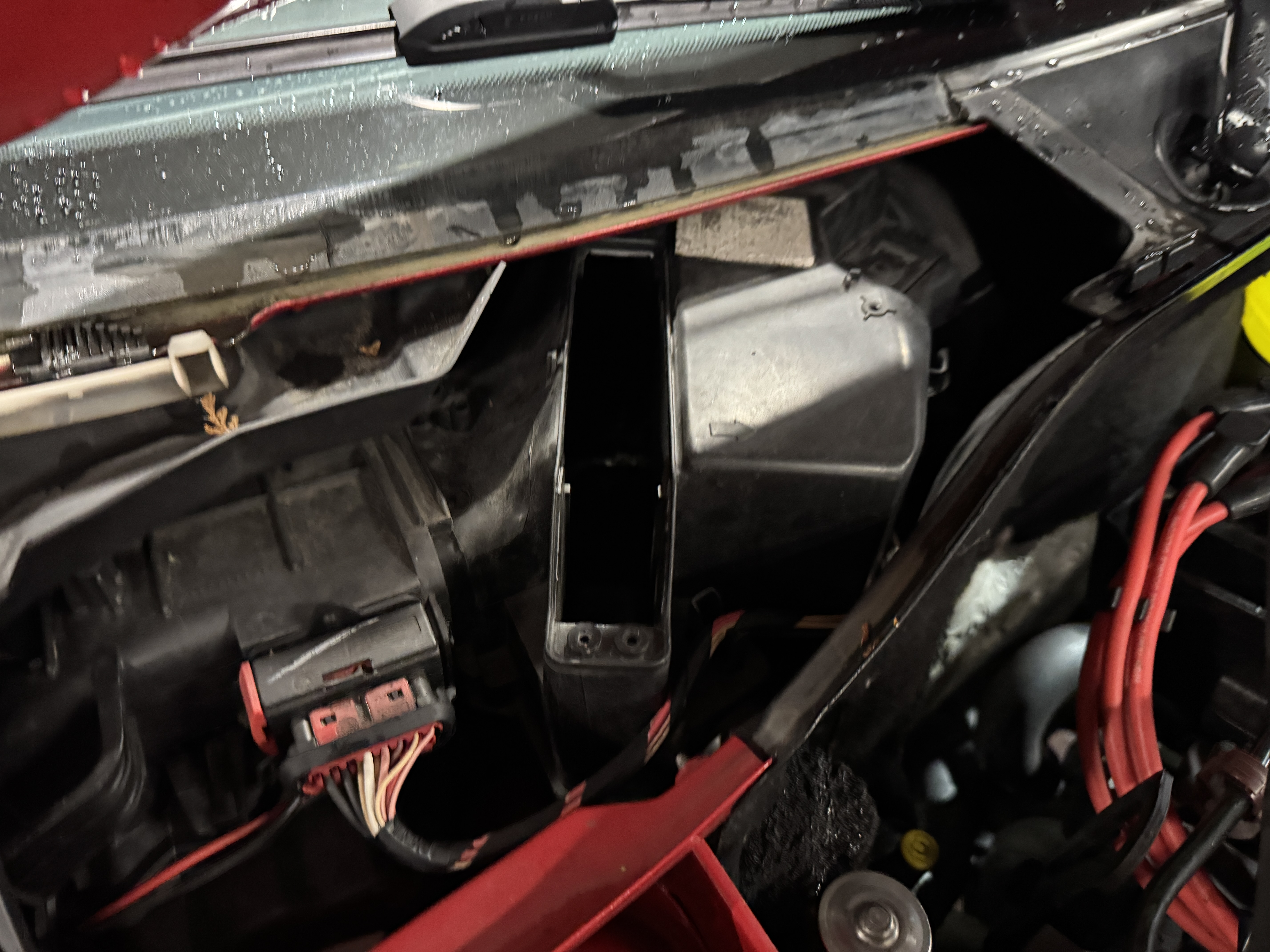

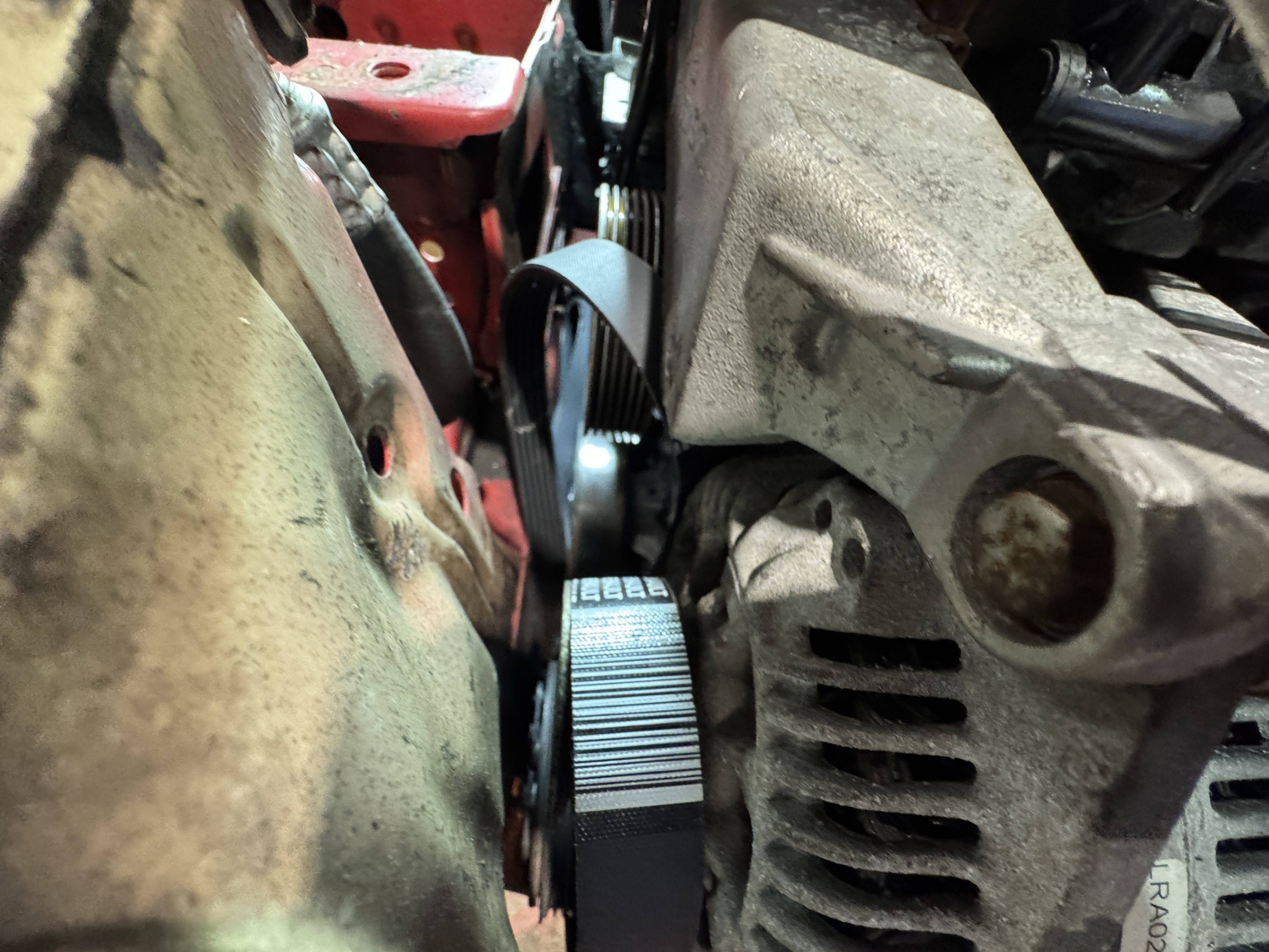

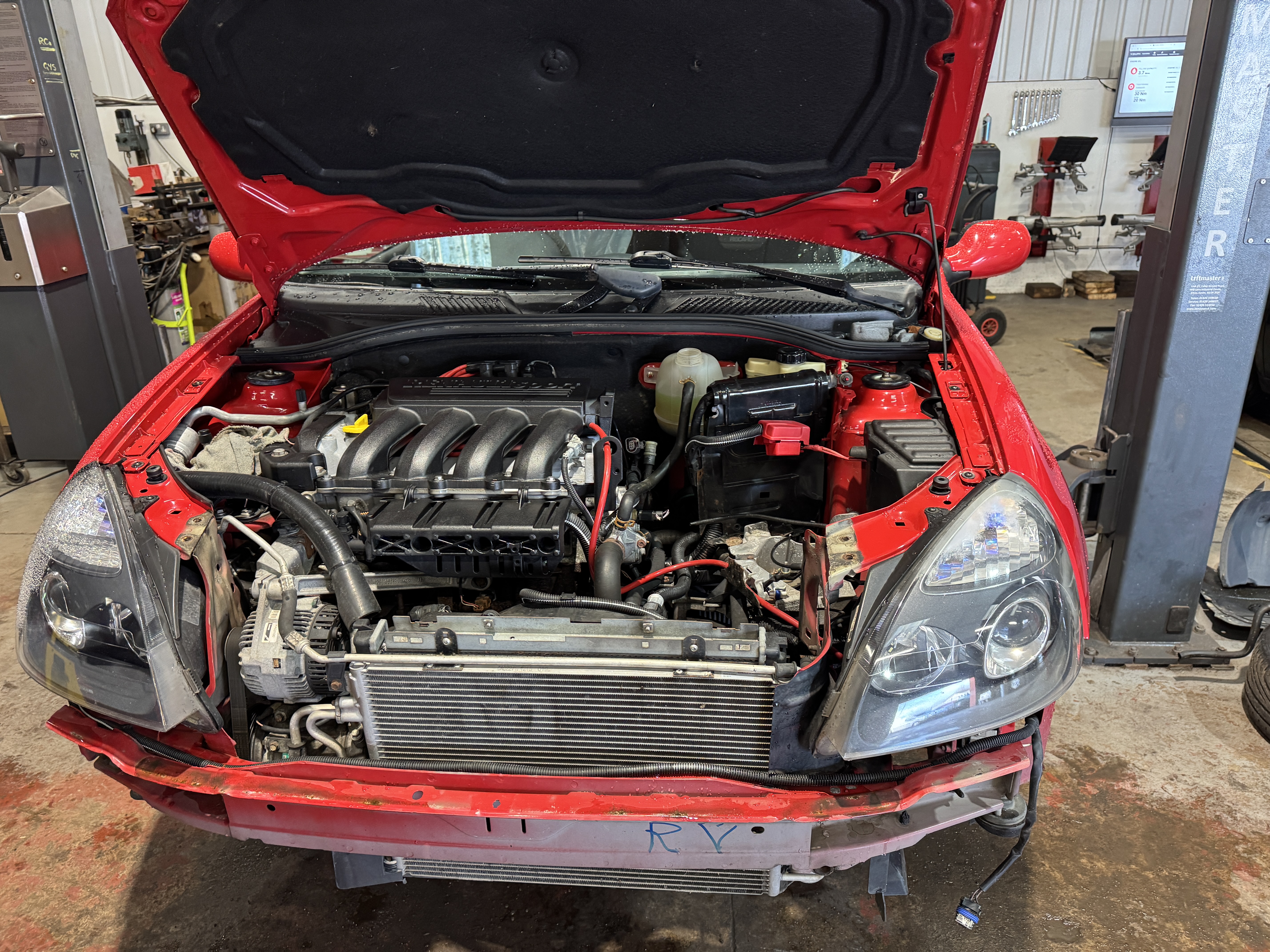

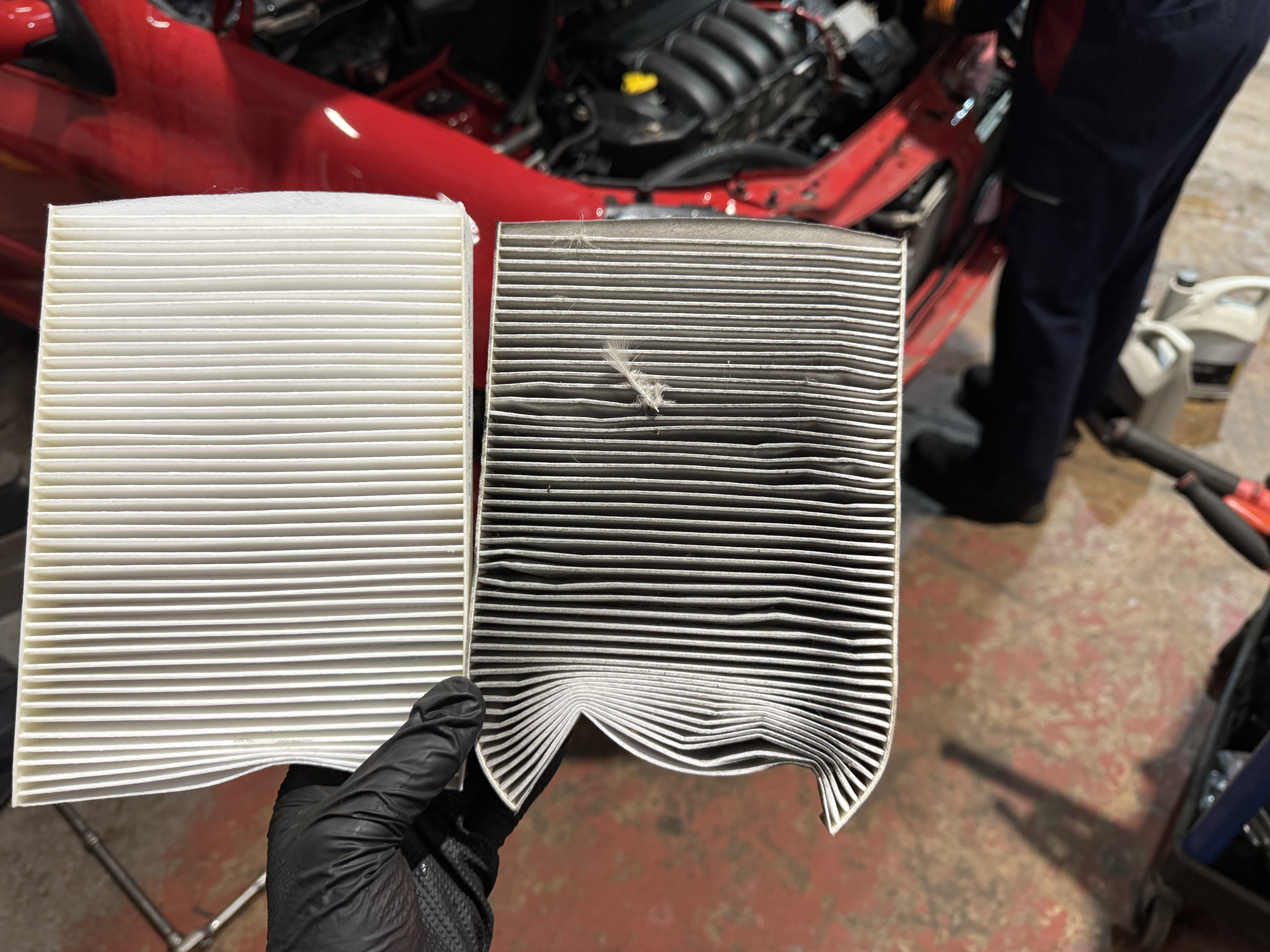

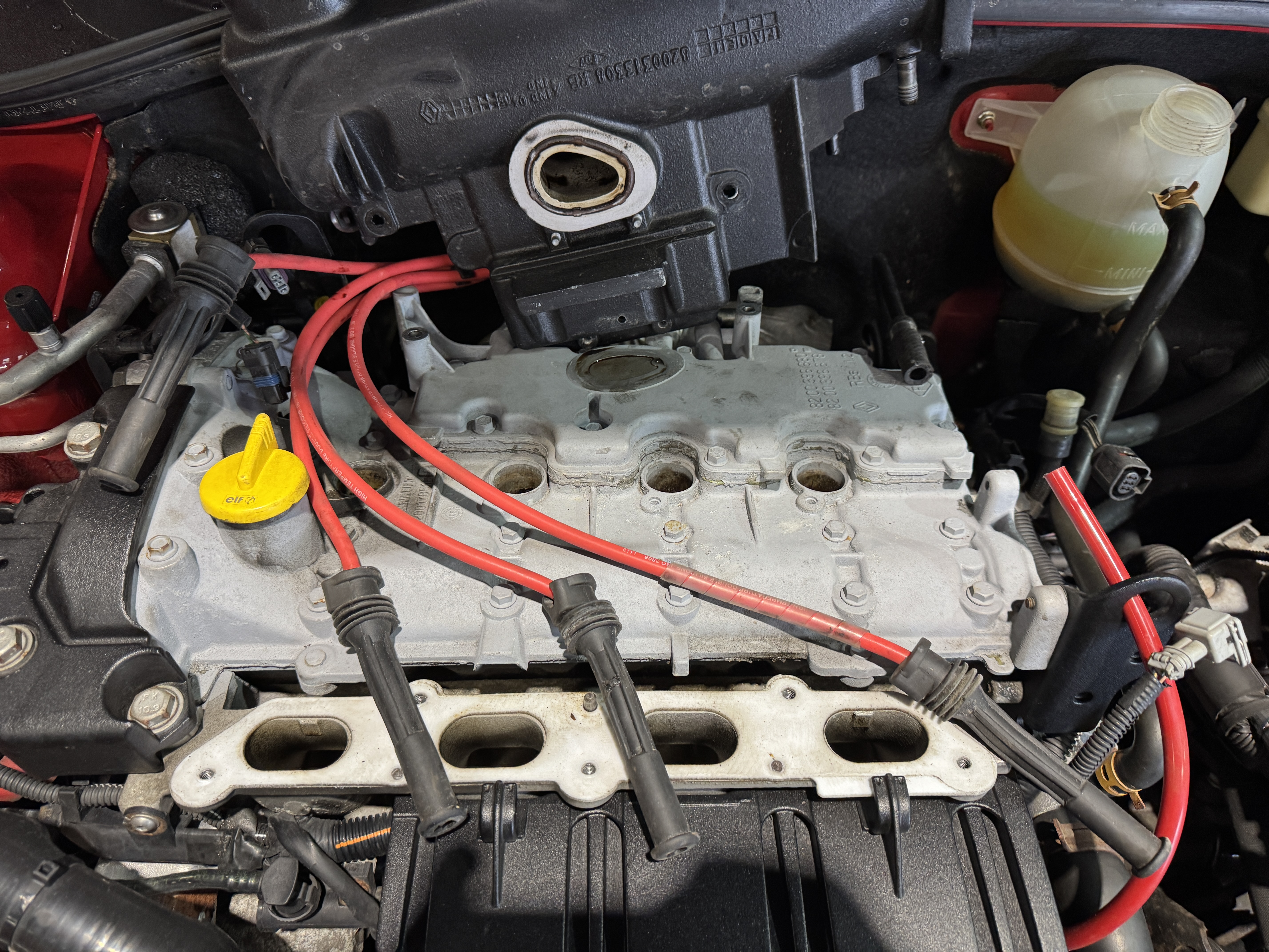

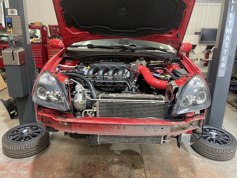

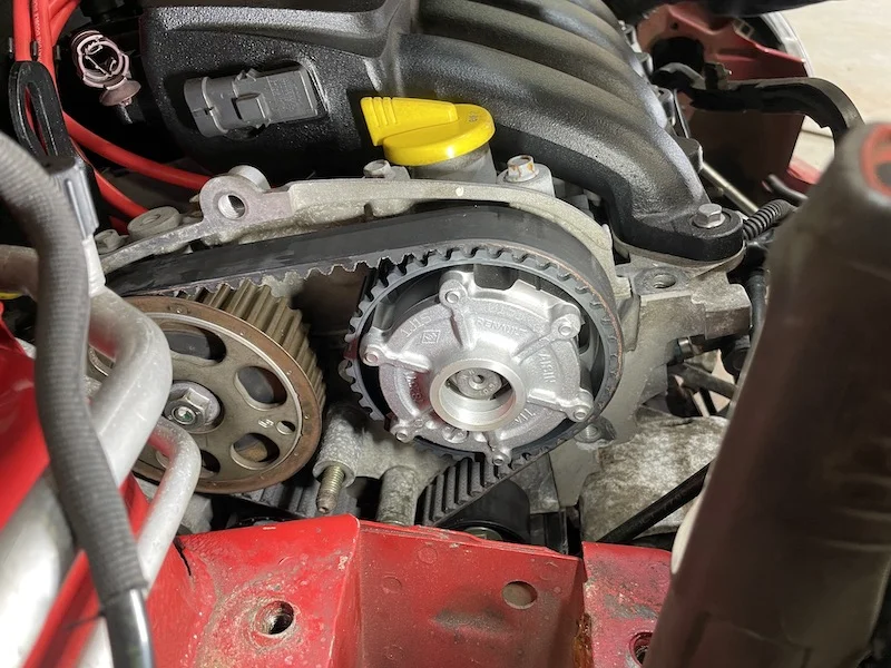

so once again a long overdue update but X amount later the car is running like a dream.
I can't believe how good it is having really cold A/C in the Clio.
The parts alone was a scary amount and then fell off my seat when the labour was on for 2 days work.
1 x Timing Belt Kit - 130C12131R
1 x Dephaser Pully - 8200782671
1 x Water Pump - 210107370R
1 x Aux Belt Kit – 7701477519
1 x Crank Shaft Bolt - 8200608653
1 x Crankshaft Pully – 8200386460
4 x Spark Plugs - 8200239321
1 x 6L Oil - 7711943691 (5L) / 7711943689 (1L)
3 x Gearbox Oil Change NFX 75w – 7711945721
1 x Gearbox Sump Plug – 7703075347
1 x 5Th Plate Cover – 7700111166
1 x 5Th Plate Cover Seal - 8200117602
1 x Lower Gearbox Mount - 7700795688
1 x A/C Seal Kit - 7701207465
1 x Oil Filter - 8200768913
1 x Sump Plug – 7703075347
1 x Sump Plug Washer - 110265505R
1 x Pollen Filter - 8671012063
2 x Coolant TYPE D - 7711428130
2 x Front 60mm Wheel Bearings - 770120677
1 x New Front Radiator - 8660000436
1 x Front Engine Mount – 6000073669
4 x M10 Screw - 7703019198
1 x Thermostat Housing Gasket - 7700104129
1 x Thermostat & Seal – 8200772985
1 x Coolant Temperature Sensor - 226306024R
1 x Thermostat Housing - 8200934203
1 x Front Brake Pads & Fitting Kit - 7701208218 / NBPF1848
1 x Rear Brake Pads & Fitting Kit – 8660006348 / 7701202141
1 x Fit Rear Arch Liners – 6000073752 / 6000073751 (Clip 7703081056)
2 x Front ABS Sensors – 7700411747
1 x Front AC Radiator – 7700414103
1 x Front AC Tank Dryer - 7700836314
2 x Front Lower Ball Joint - FEB22410
1 x Replace Full Coolant Hose’s & OE Clips.
1 x A/C Regas
1 x Full Tacking / Wheel Alignment

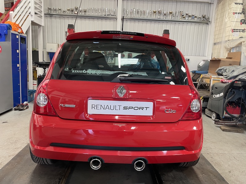

Car booked for its MOT tomorrow and then ready to drive.
can’t wait to actually drive it properly again
