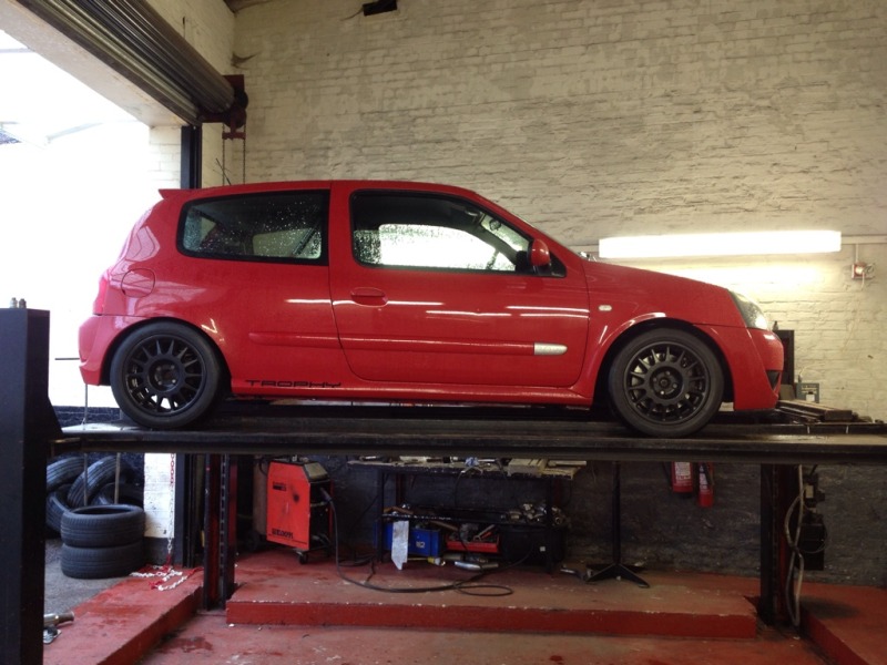

Behind as always with the updates, a few pictures to catch up on.

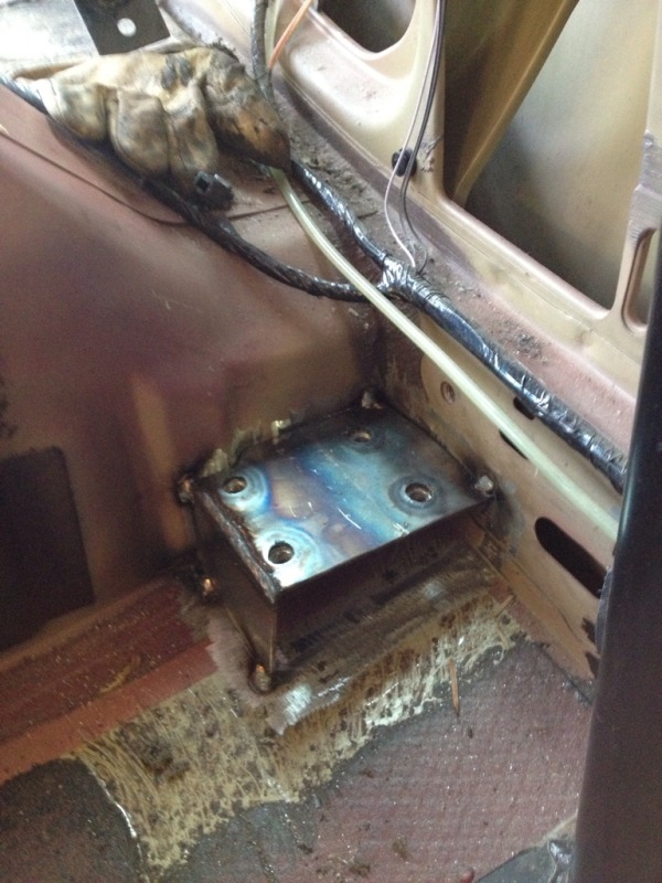

car has been in this week to a friends to have the cage feet fabricated and welded into place, followed by a rear strut brace welded in between the turrets to also double up as a harness bar.

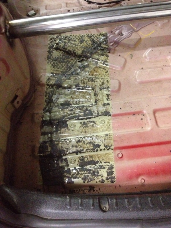

today I've set about removing all of the sound deadening which is a PITA to remove, but slowly getting there :)

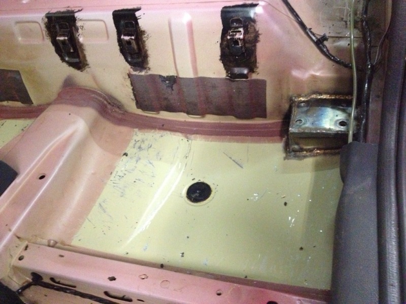

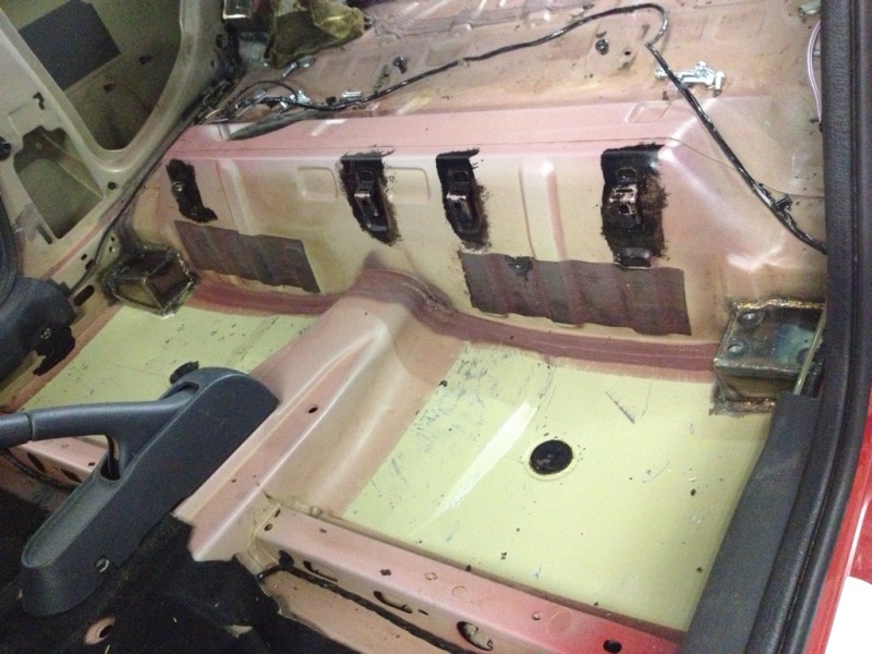

attached the back end of the car today with the angle grinder, cut off all seat mounting points and hooks, along with any bracket that wasn't flush.
tomorrow to grind them all down as smooth as possible and aim to give a light dusting of paint over the weekend.

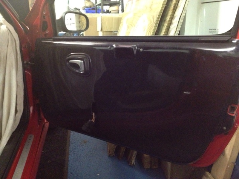

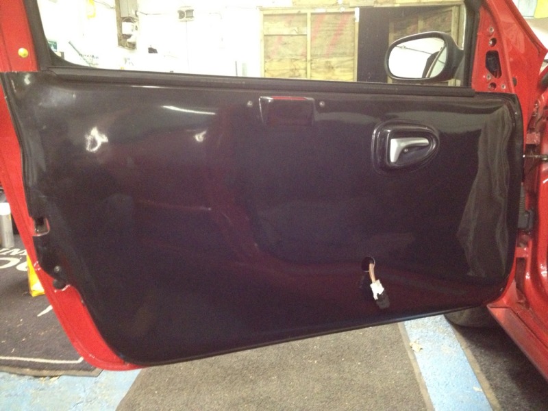

Polycarbonate door panels fitted, few more fixings required once the rivnut tool comes back from a mate.
wiring just dropped through the door cards for now until another mate can mould in a decent mount for the switches, but they will do for now :)

all the cut of seat mount brackets and random lugs in the cars floor have now been ground down so they are smooth and flush with the main panels and then given a quick dusting in primer ahead of the weekends tasks, pics to follow tomorrow.

Mark, don't ask, it's one of those 'K-Tec' things.
For some daft reason the panels are moulded that way, and the handle sections don't even line up properly as the moulded sections are about 3/4" further forward than the factory position :(
a bit of jiggery pokery with the dremel to elongate the mounting hole, and a gentle but of manipulation to the panel to allow the handle to fit to suit the panels, but you have to use the handles from the opposite sides then turned upside down.
all a bit peculiar but it will do the task thats required.

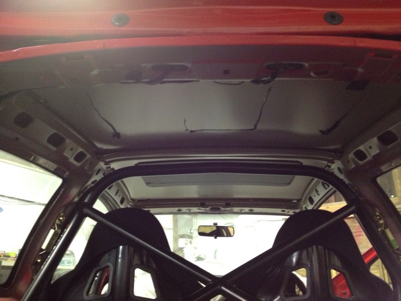

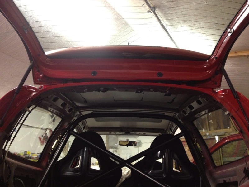

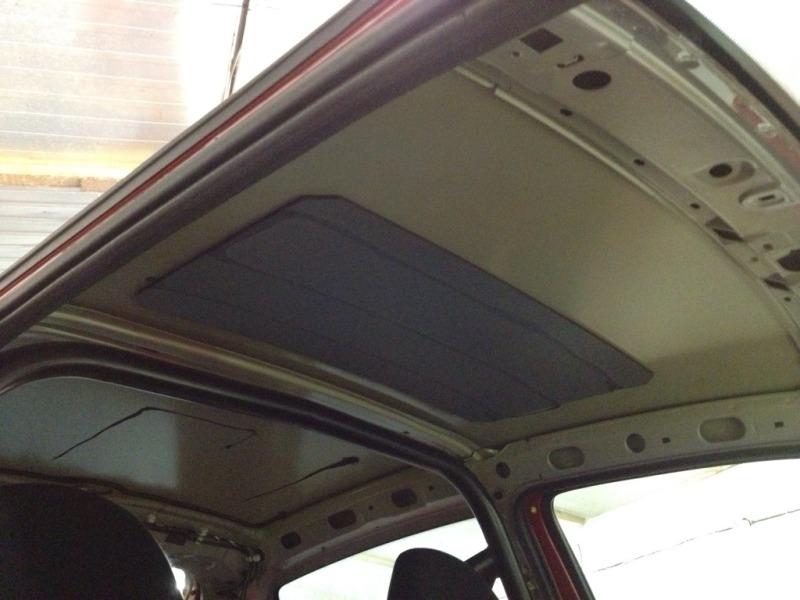

Today, after a big if running around picking up the trailer and then dropping the Escort off for its new straight cut box and GT30, we finally set a couple of hours aside for the clio.
roof lining now gone, a few cables re-routed, cage finally bolted back in properly.
