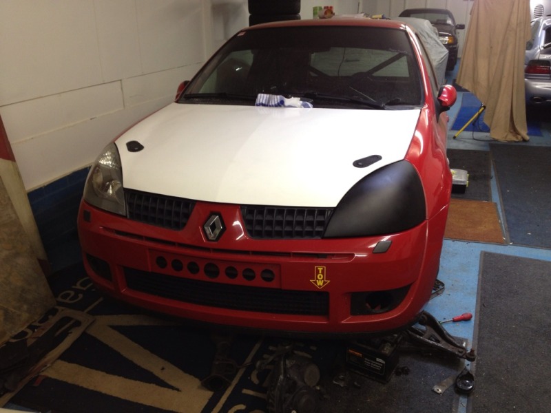

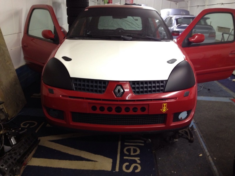

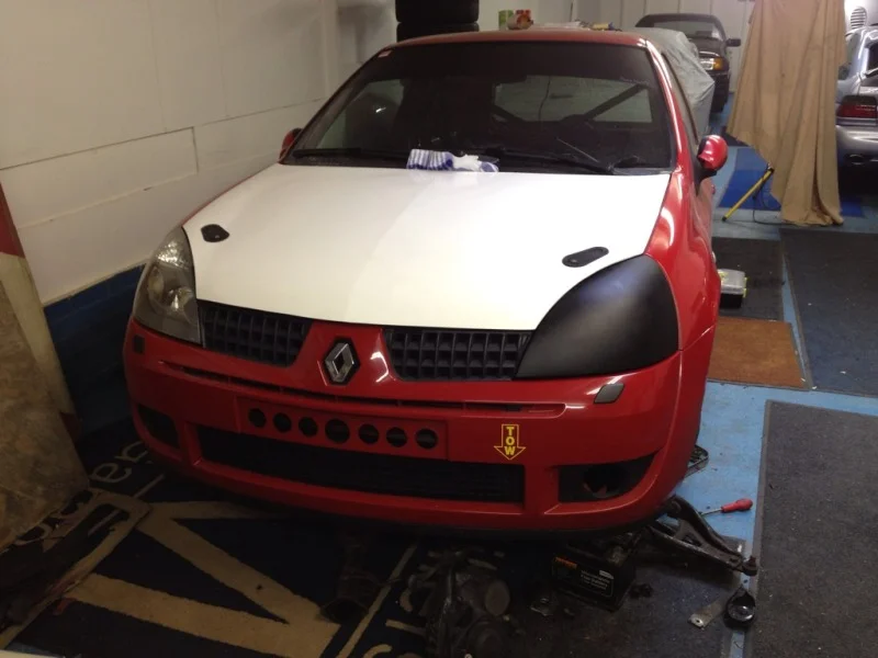

spare pair of headlights sourced, completely stripped of everything bar the lense plastic fixing points.
given a light dusting in black, needs a couple of coats more but popped in to place to get an idea if its worth continuing.

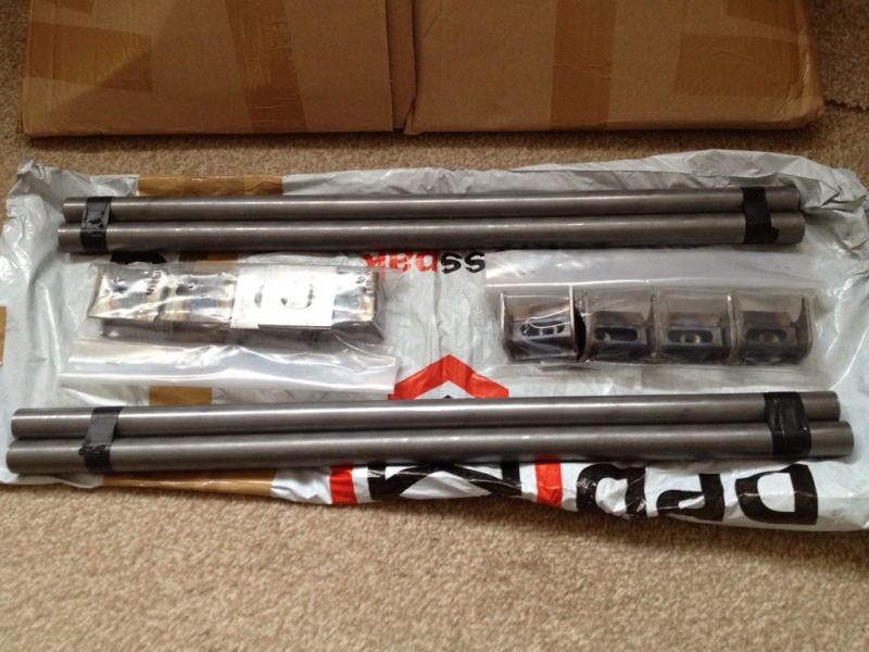

Loving this Kelv. Where are the seat braces from and what did you pay?
He got them from Motorsport tools. Circa £50 and one of the best kits I have seen with the sliding captive nuts. I fitted them to my racecar.
  XC90, 330d, Trophy’s
As Morgan (Swede Cup) has mentioned seat rails came from Motorsport Tools, £39.95 per set, and £10.98 for delivery.

Nice idea the captives. So the rails are welded straight to the floor, then the side mounts bolt straight to the new rails.

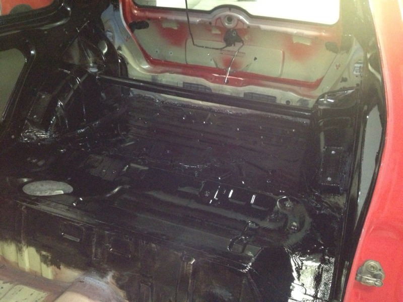

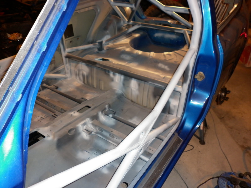

and while the back of the car is bare given it its first light coat of satin black paint.
and finished the headlights, now fitted :)

started to paint the back of the car black

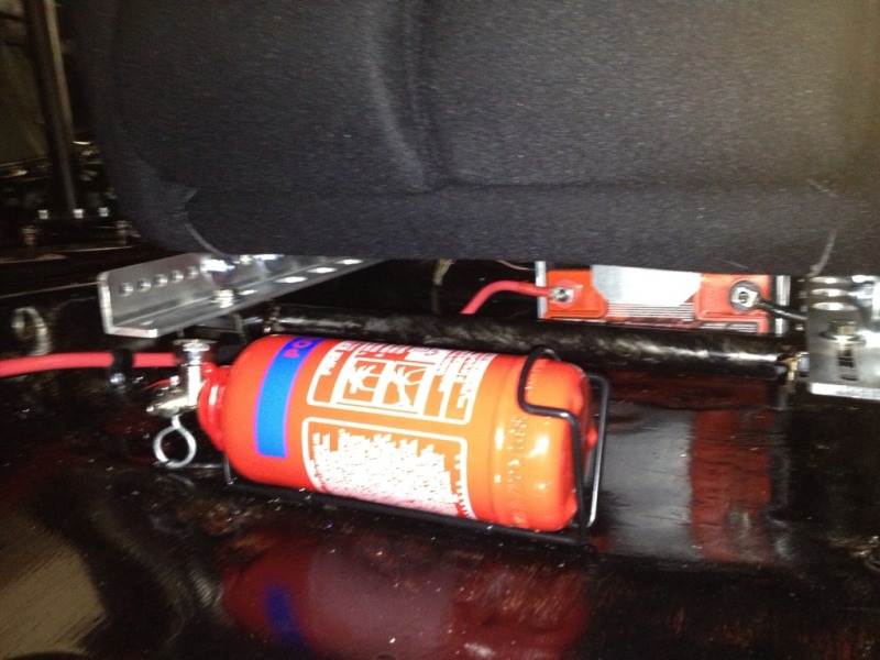

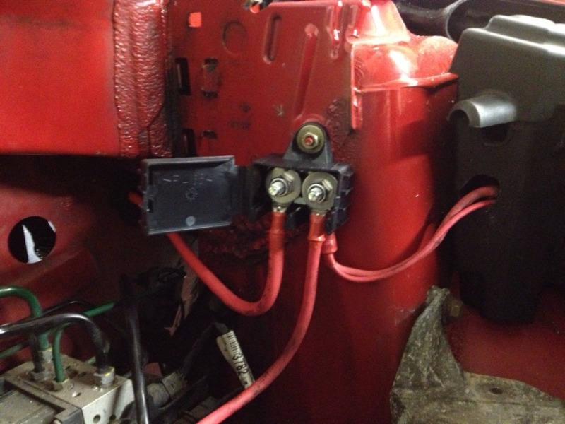

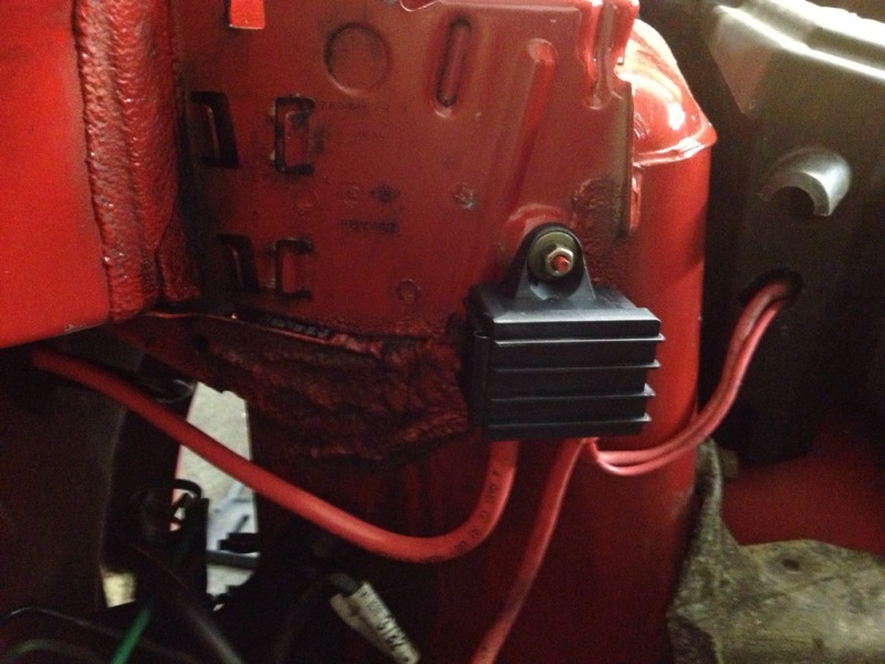

first steps of battery relocation, black box is a little wonky in the pic but is now straight and neat.
mock up for the battery isolation switch position

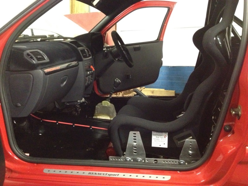

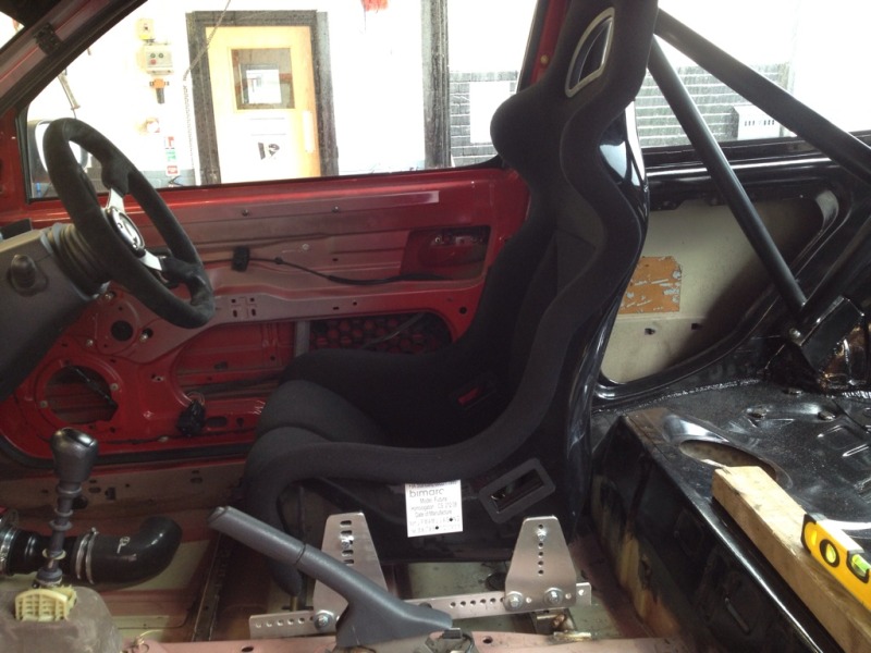

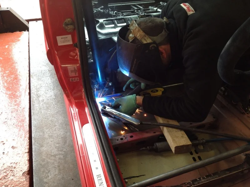

next it was off to a mates to have the seat bars welded into place, along with a brake fluid flush and geo reset again.
seat dummy fitted while the work was taking place, seats now changed to Bimarco Futura's and 3 piece fully adjustable side mounts :)

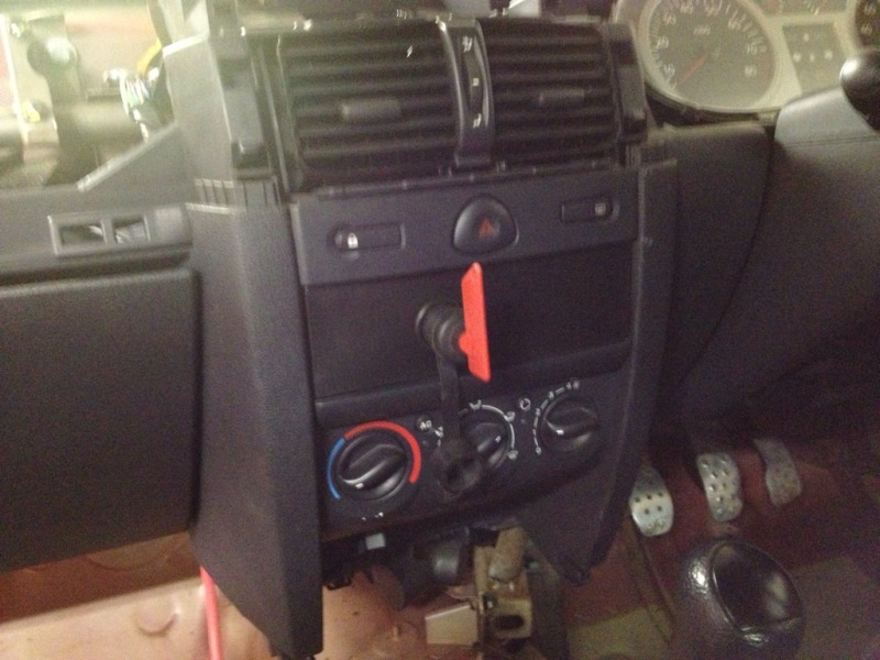

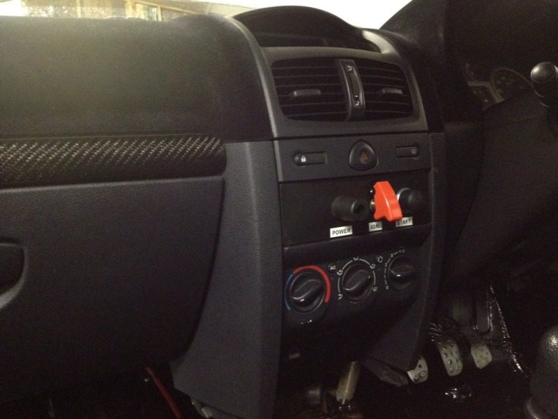

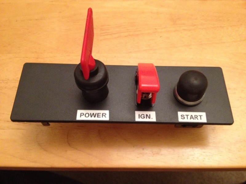

while the car was there, I finished off making my new control panel
the past few days since the car has been back has consisted of painting the rest of the cars floor, running the power cables to/from the isolation switch and securing them to the new battery position.

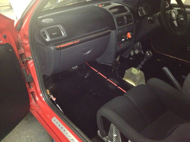

dash is now refitted after all of the other wiring alterations.

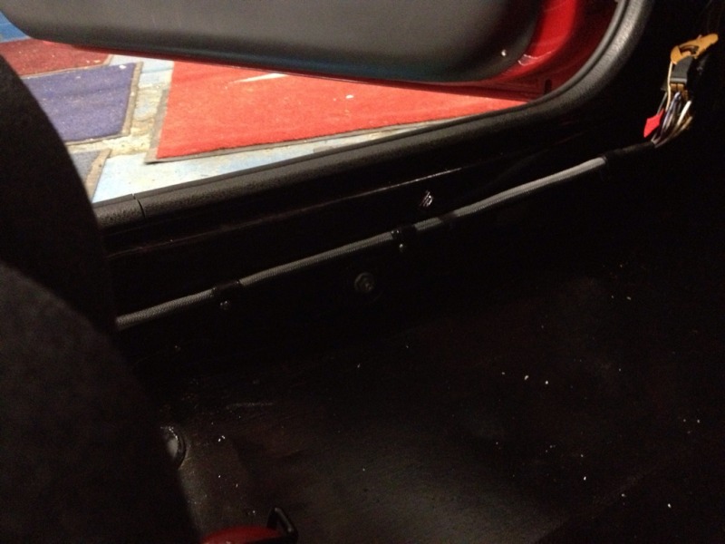

with the internal car loom removed, and everything towards the back of the car removed from the loom (reverse lights, fog lights, boot locks etc) i traced the wiring back up to the main plug, and while it was in pieces I set about covering the loom along the kick sill in a protective braid to give it more protection from clumsy feet climbing in and out of the car.
poor picture tho :(

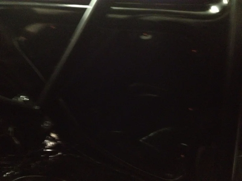

rear qtr trim panels fitted with some small anodised red head bolts.

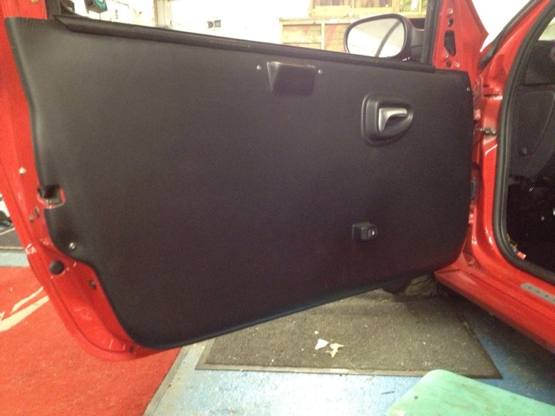

picked up the door cards after having the electric window switches moulded in for a comfortable position when in the buck seat, and then dusted over in a satin black.
Finally, how it was when I left to come home this evening.

What door cards is that you have too?

Sonny/Morgan, its just an old stereo blanking panel, I just used my step drill bit to get the holes to the right size after measuring up for each individual switch location, and I have my own labelling machine for the wording under each switch.
the panel itself was pretty secure when clipped in to place, but I have put a little double sided tape in each corner to give it that bit more stability.
actually, with the 2 power cables coming to the isolation switch, and how they are secured behind the dash, that also helps to hold the panel perfectly in its position.
the door cards are a 4 piece kit, originally a K-Tec bit of kit but purchased off another forum user when he changed his plans, still brand new and unused when I got them.
did a little mock up for the switch positioning and then give them to a good mate to have the switches moulded in to place, and blown over with the satin black finish.

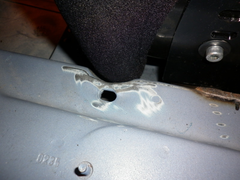

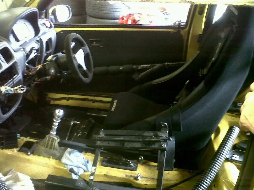

Quick pic of how I done my seat bars, not the best pic.
careful with seat position to as I had to dent the tunnel to fit how I wanted.

am I correct in thinking what you have done is weld two bars next to the original seat mounts then then added holes for seat location?

Rich, if you look at Swede's first picture, you will see the little plates that attach to the bar, these have a floating nut within them that you fix the seat side mounts to.
the original seat bars in mine gave been removed, leaving only the new seat bars in the position that is required.
currently, I have left my seats a couple of notches higher than where I plan to have them long term, reason being is i have my next trackday in 3 days time, still have a fair amount to achieve on the car and won't have time to look at adjusting the steering wheel height, when I do I shall lower the seats to suit.
