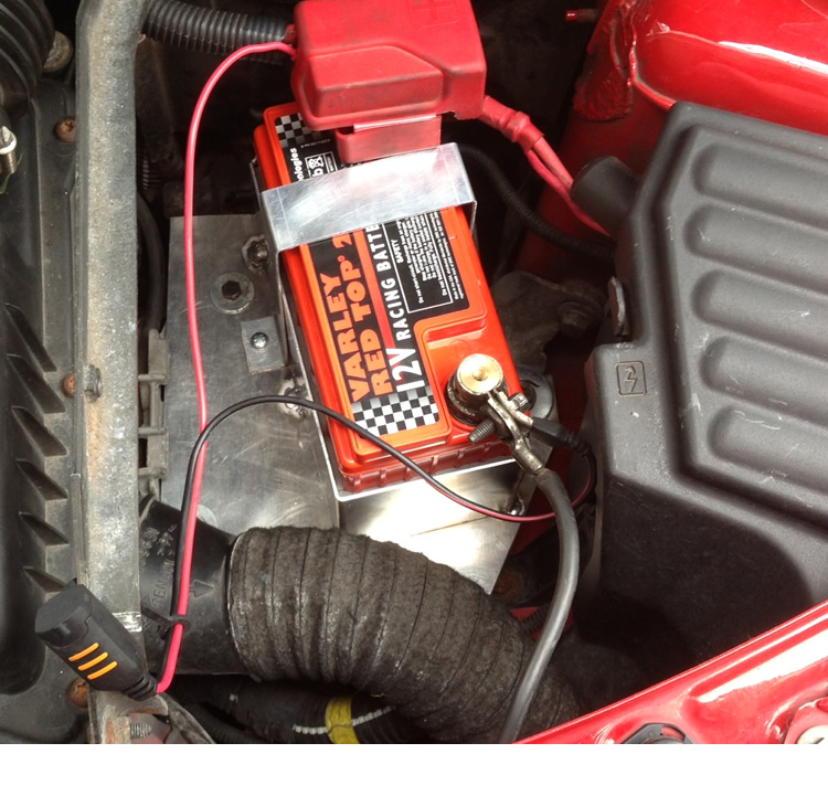

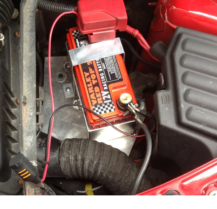

Red Top 20 smaller battery with custom made battery box and charger socket.

The lightweight battery with a custom made aluminium battery box and the obligatory trickle charger socket on a flylead :

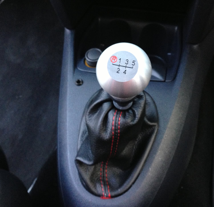

Richbrook Slant Top Gearknob and an ebay gaiter with red stitching which looks quite sweet:

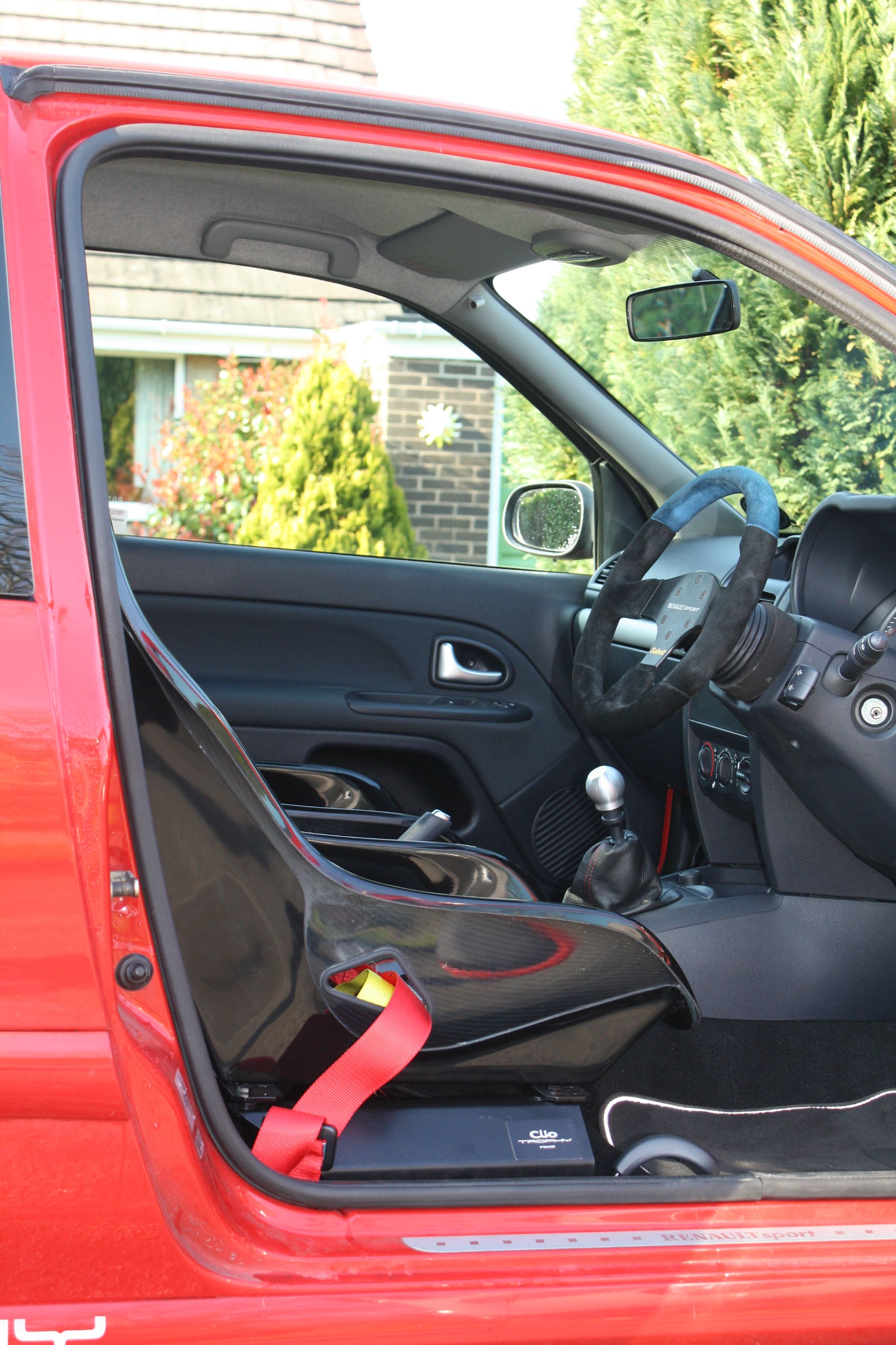

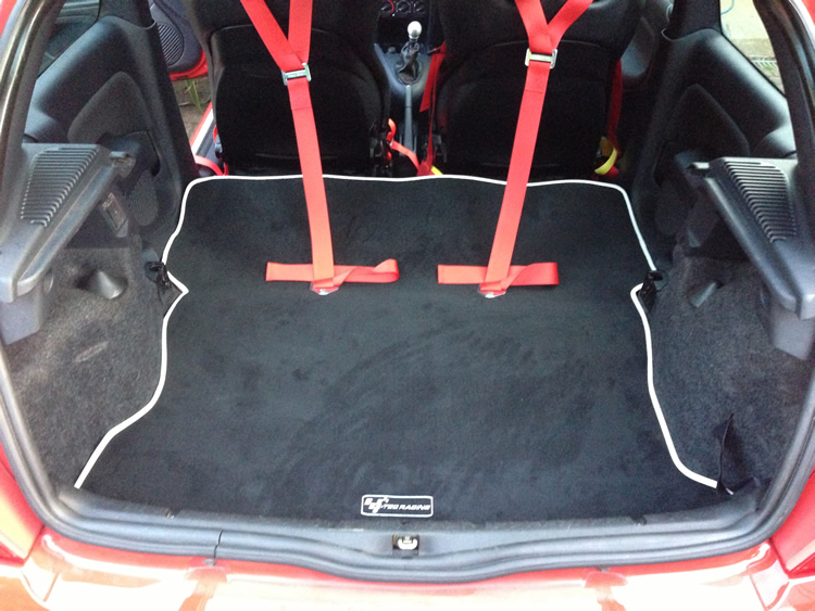

Sabelt harnesses with K Tec rear mat finishing things off nicely :

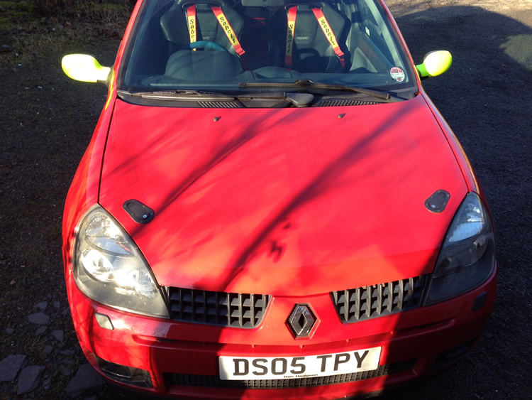

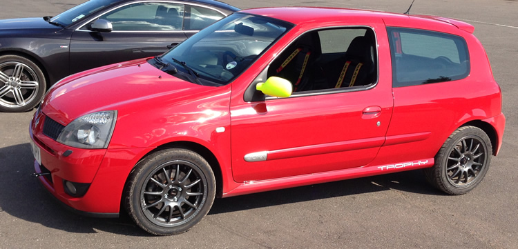

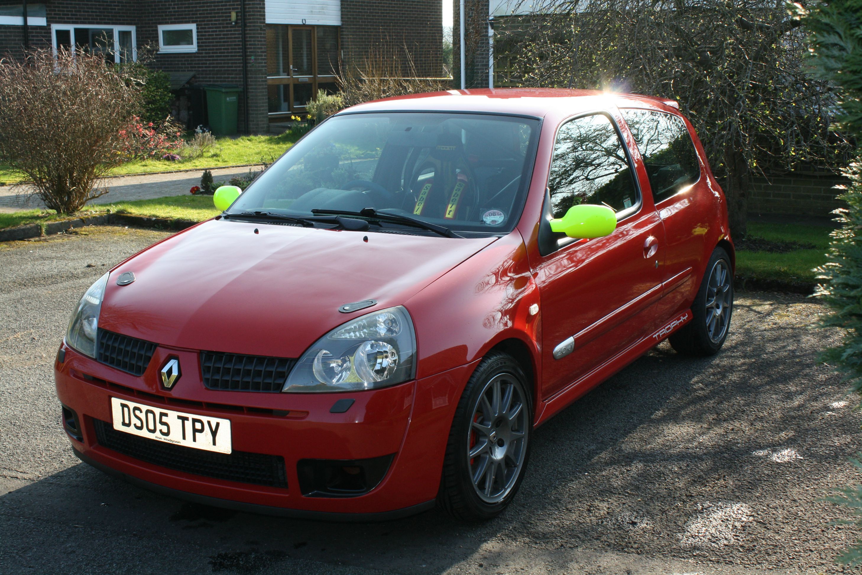

The car dressed in its trackday wheels and tyres and fluorescent mirror casings:

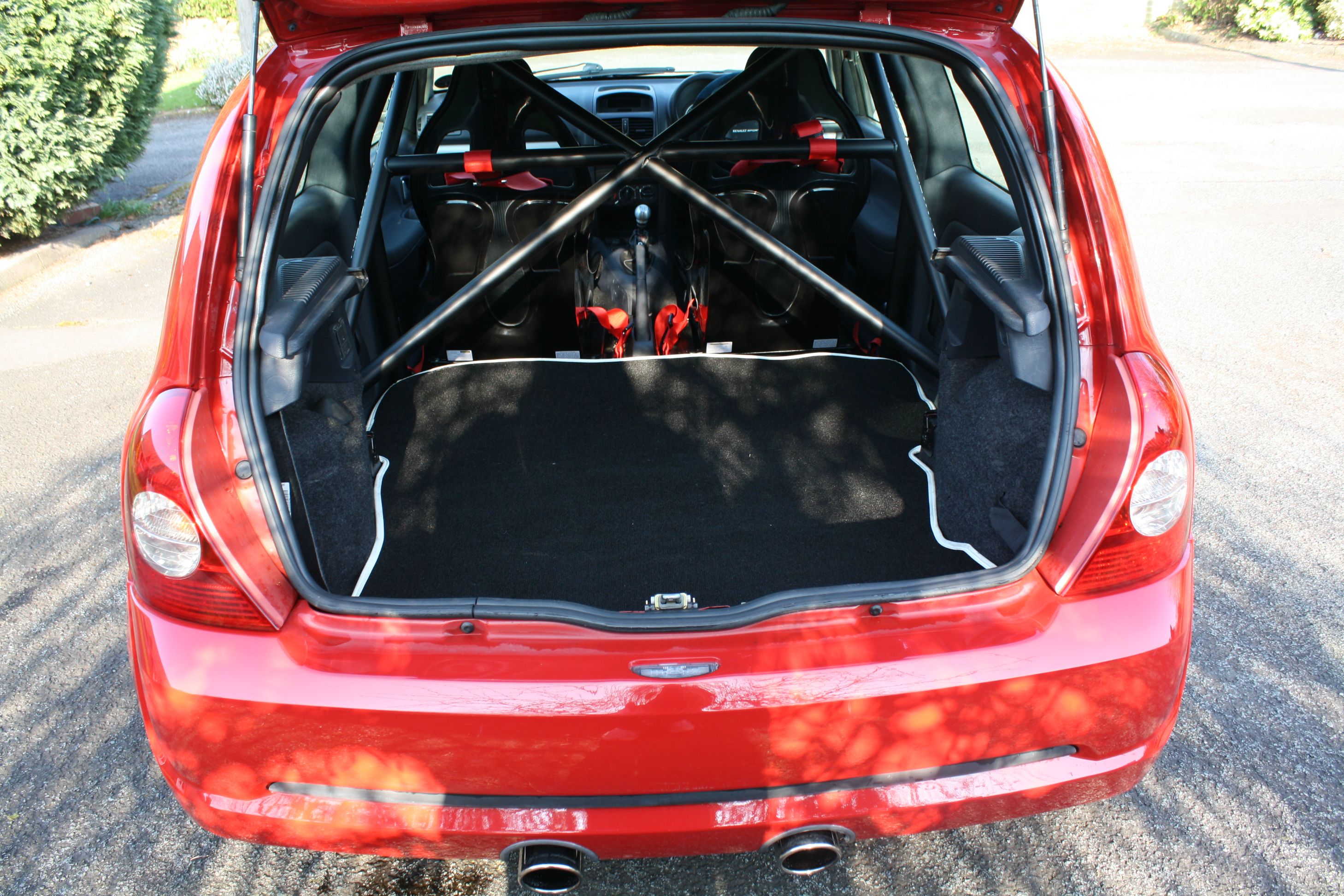

The only thing I'm less than happy with is the angle of the belts to the rear fixings which is too steep to be safe - and to remedy this the next item on the list is a Safety Devices rear cage with harness bar- and perhaps some more weight saving measures to counteract the additional weight of the cage,

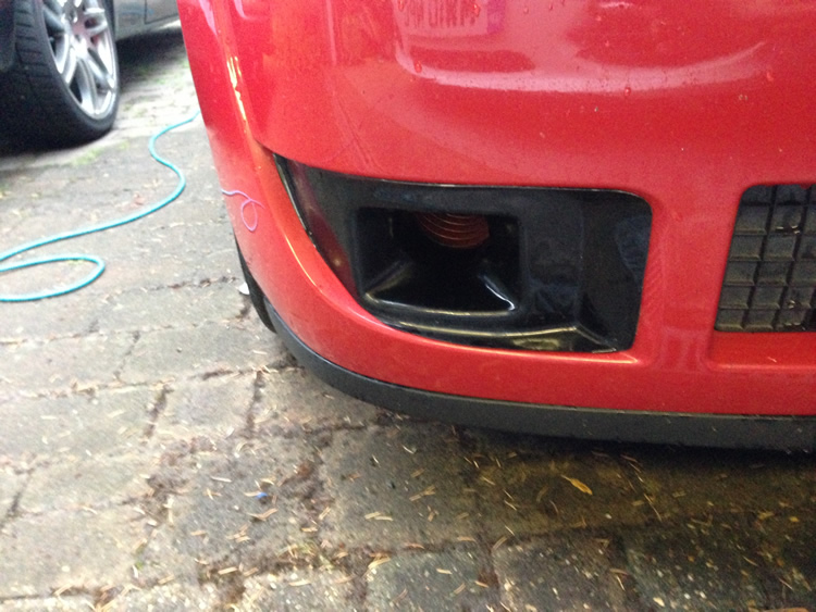

In an attempt to keep the brakes cooler we fitted some cooling ducts with deflectors:

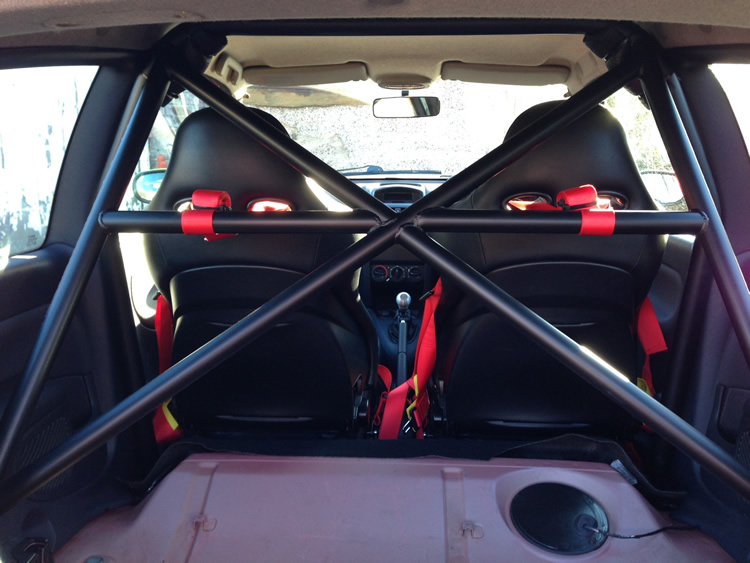

Bought a Safety Devices rear cage and got it fitted by Mark Fish

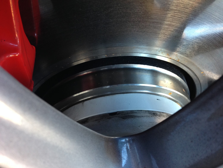

The Brembo HC discs with Pagid Blue pads didn't really stand up to two of us hammering it round the track so after a set of warped discs we decided to bite the bullet and try and solve the problem with some goodies courtesy of Chris Powell:

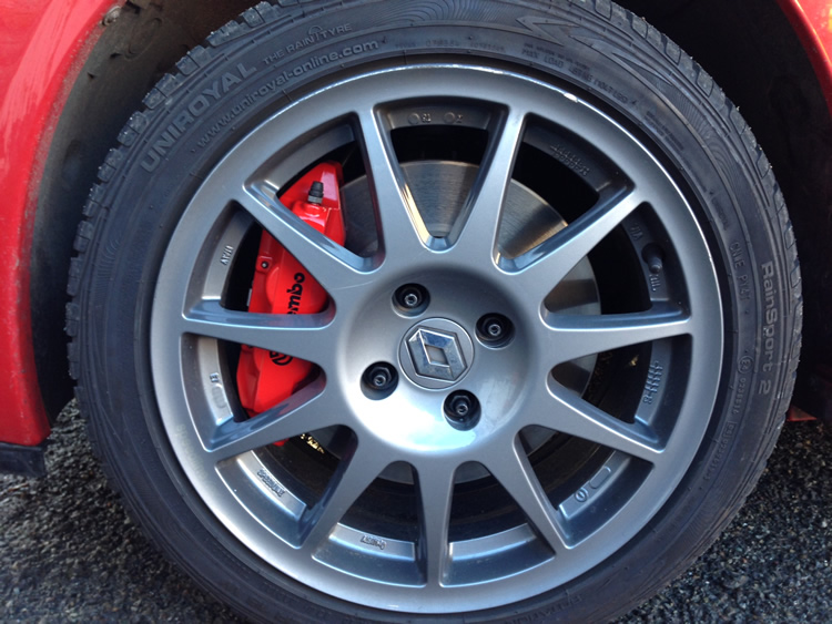

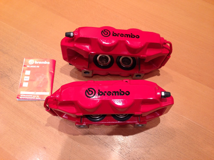

New 197 cup 4 pot Brembo calipers with adapter kit (not shown)

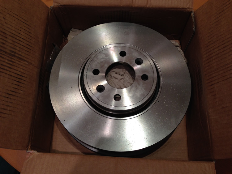

300mm Brembo HC front discs

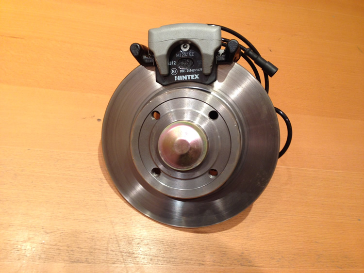

197 rear calipers and pads with custom made disc and hub assembly

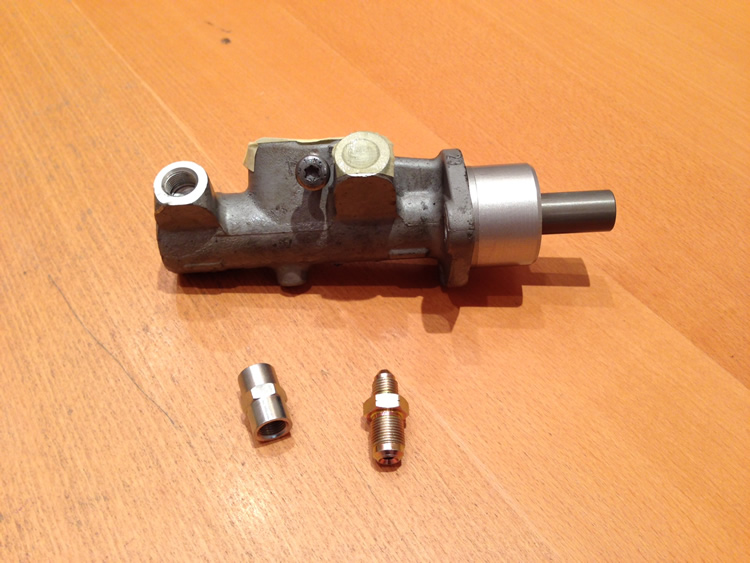

197 larger master cylinder
The end result looks quite good and the calipers just about fit inside the 16 inch wheels which are now fitted with studs.
Gone for Ferodo DS2500 pads.

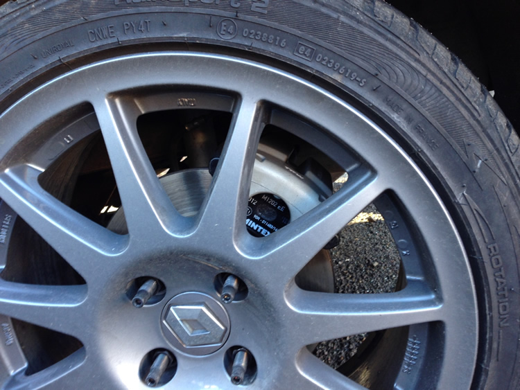

Needed a 15mm Eibach hubcentric spacer to clear the Turini's, although the Team Dynamics Pro Race 1.2 Wheels have greater clearance.
The rear brakes from a 197 have a same diameter disc as standard but the caliper and pad is bigger and in a different location.
In theory this will give us a more balanced braking system. Standard 197 Mintex pads fitted.

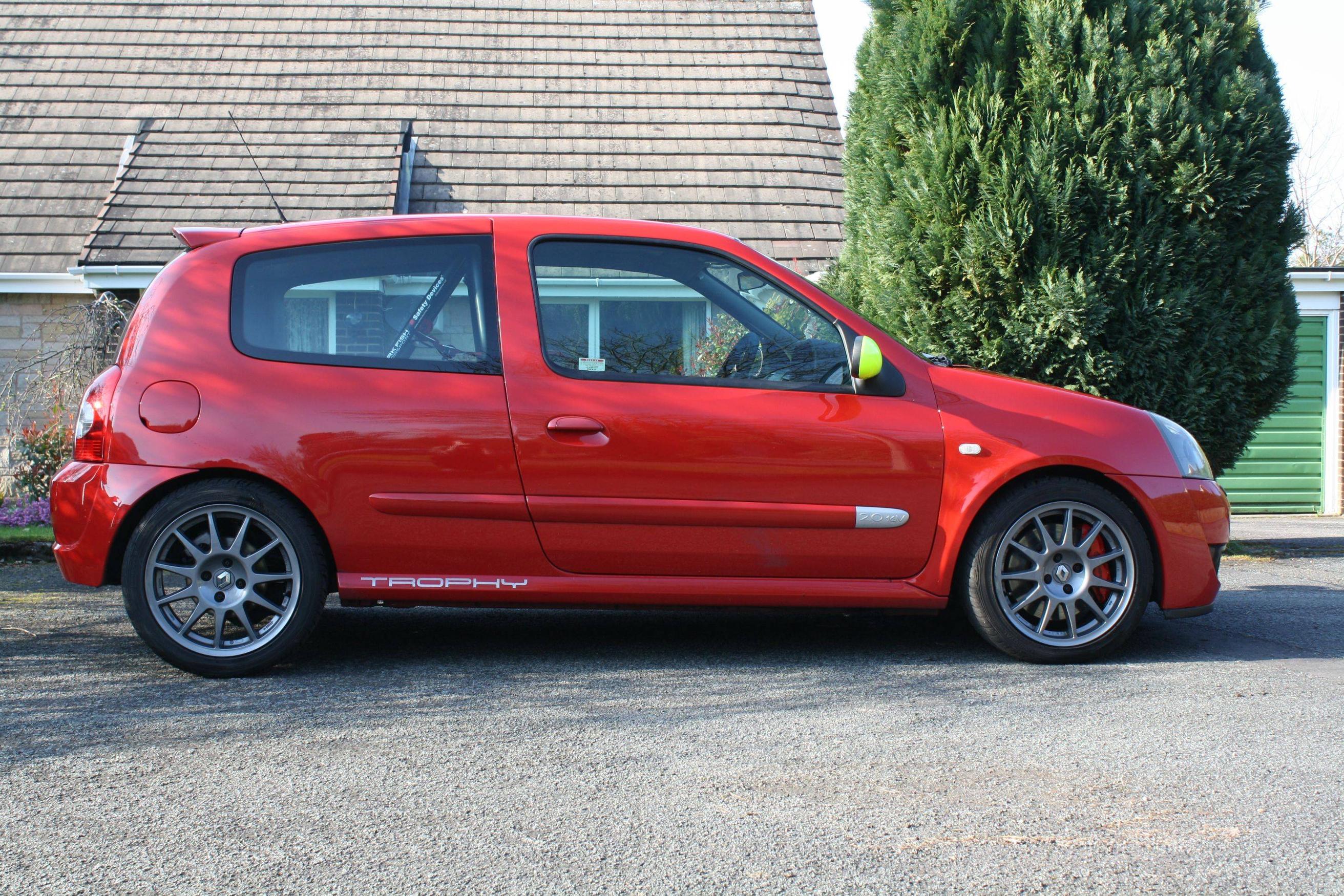

current spec + pics:

Clio 197 front 4 pot 300mm brembos
Clio 197 rear calipers and pads with custom made disc and hub assembly
Clio 197 Larger master cylinder

Rear KTR Bootmat

Safety devices half roll cage

well, the problem was that it's near impossible to remove the existing gearknob!
I had to hacksaw it apart to get the b*****d thing off!
but it was easy to fit once it'd been removed :smile:
Worth it then? Is it bonded on? You aren't giving much away!
They might be bonded but think it's just a very tight fight and the shaft is knurled. When doing mine I had the gearshift assembly out on bench with gland/waterpump pliers on it, stillson, strap wrenches and I gave up as I felt like I was going to bend something. Resorted like Will to a hacksaw in end too. Fitted mine onto a spare assembly so still have original, would be best option if you're wanting to keep original.
Did you remove the rear door cards prior to cage fitment? I can't seem to get mine back in! :/
