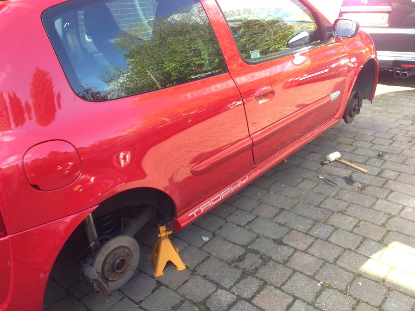

got the suspension back from BG and fitted it, improved thing lots!
checked the psi of the tyres and they were all over the place, 55 at the front, set them all correctly and now the car is absolutely sublime, just like how a trophy is supposed to be, so so nice!

What did bg say about the condition of them when you sent them down?
I want a go lol.
they were absolutely fucked, pissing out oil etc needed a new reservoir and loads of other stuff, cost me £600! one of the rear gaz dampers was leaking too :<

The Gaz dampers are still under warranty mate so get in contact with them
I wonder if it being lowered has resulted in them leaking more fluid out? Anyway I'm glad its sorted mate :)
I've still not refurbed my fronts, the cars stupid bouncy just now! Can't wait to get mine done, how tricky was it removing and fitting the dampers? Cheers.
