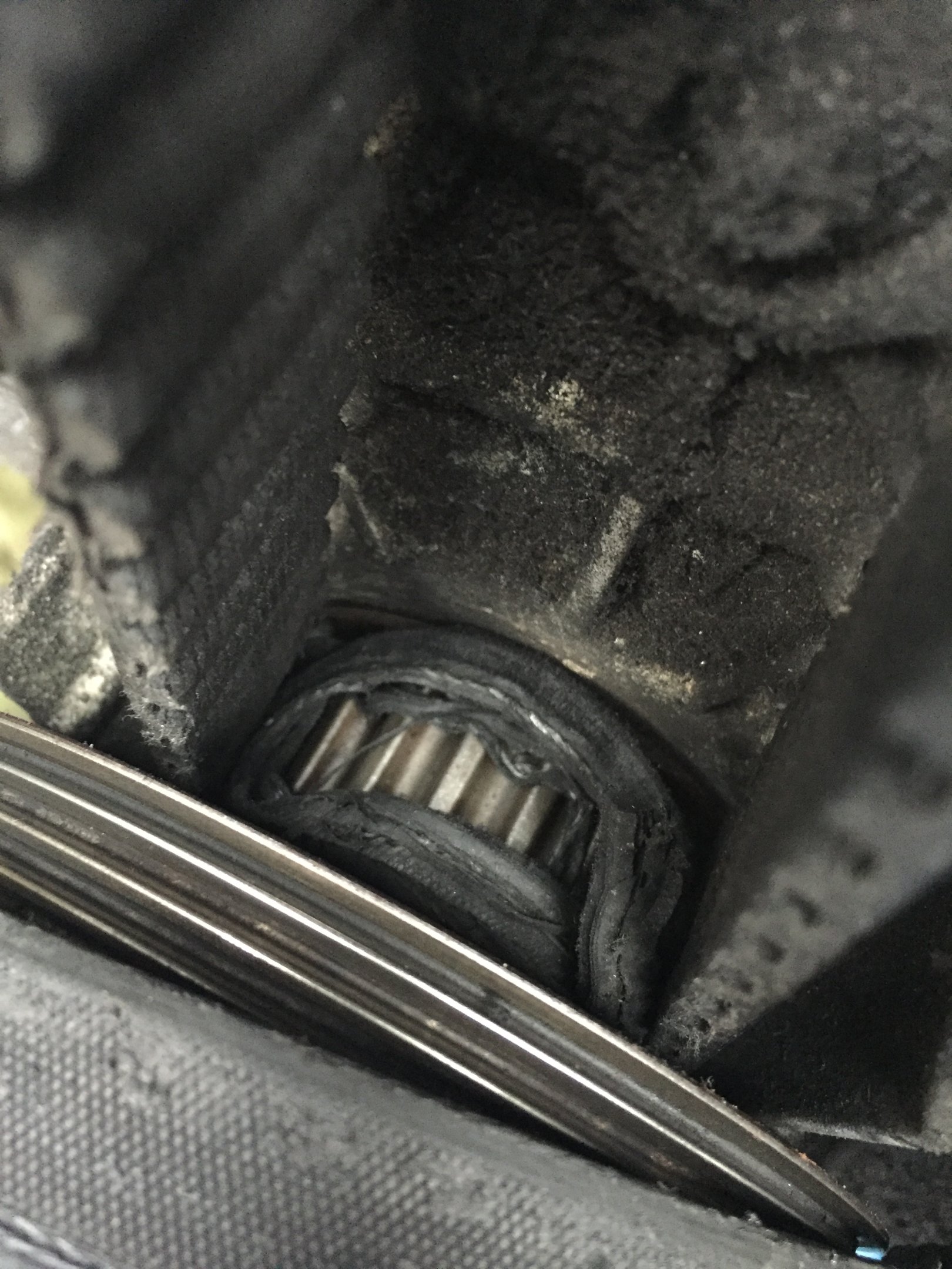

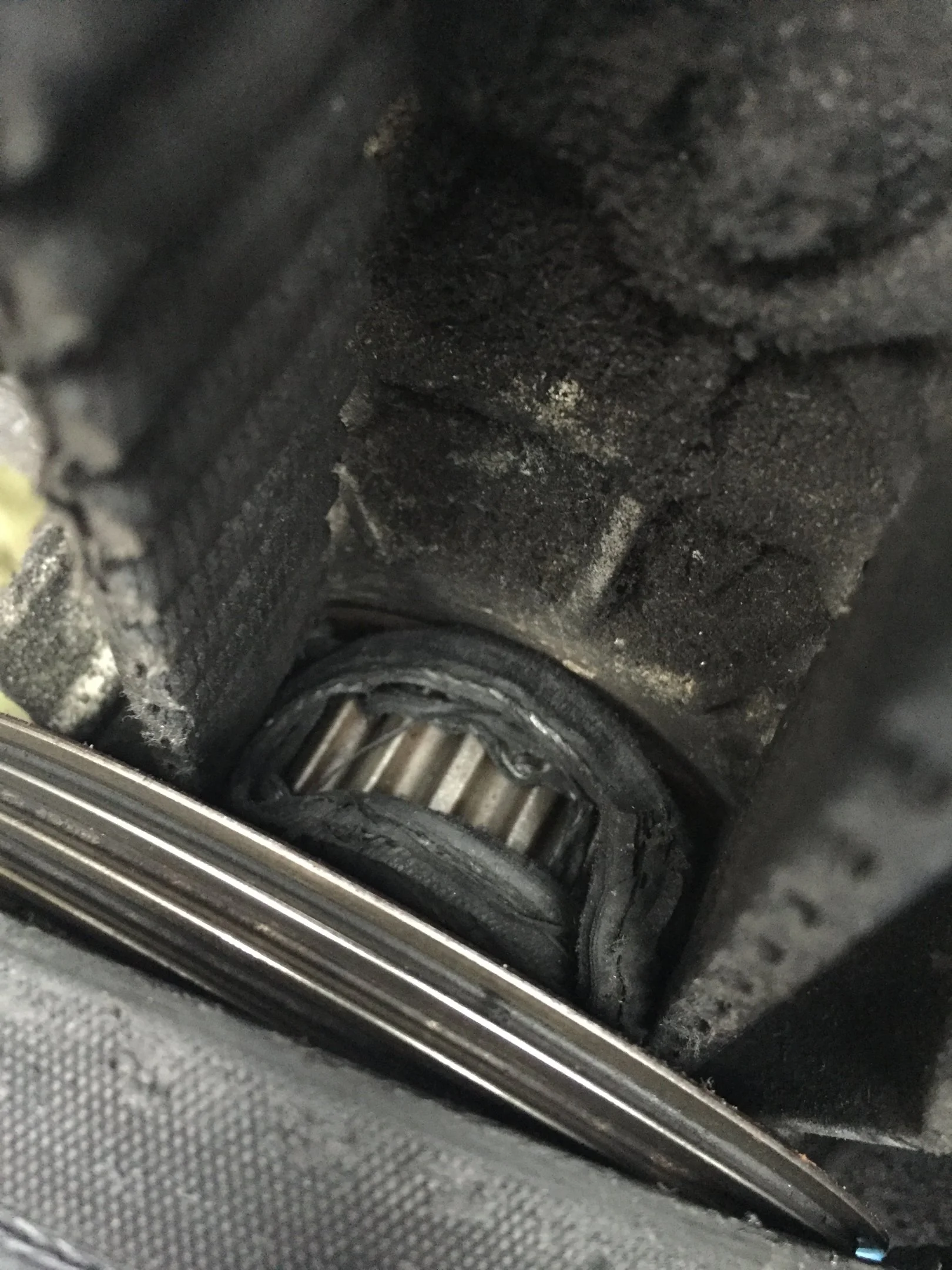

On further investigation, the alternator belt is frayed with strands hanging down below the pulley but the timing belt is still on. When rotating the engine by hand, all 3 visible pulleys move however the engine does lock at a specific point.
Is it possible that one of the pulleys has moved causing the valves to meet their neighbours? I’ve had a timing belt go before and this has the same characteristics but the belt appears to still be round all the correct pulleys!
If anyone could offer any advice that would be great, I’m just in the process of getting the head off.
Never had a pulley fail which is annoying! Belt is still tight aswell.
Need to source a new head sharpish!
Aux belt strand has probably found its way behind the bottom pulley , jumped the belt a tooth and smashed a valve ( or more )

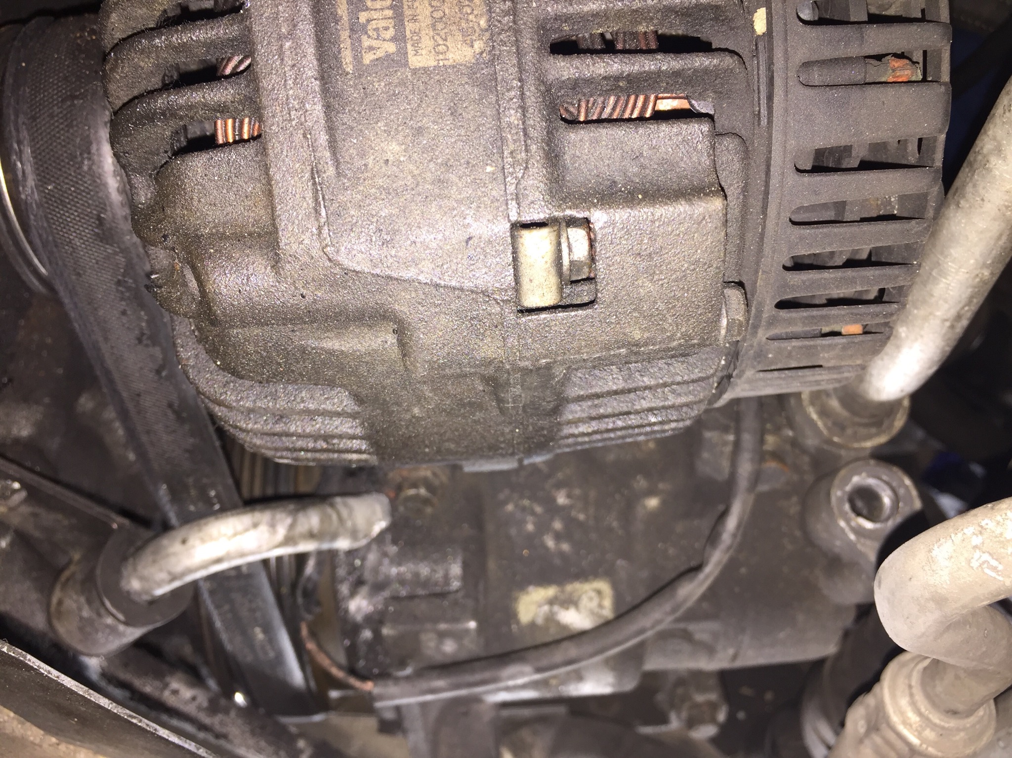

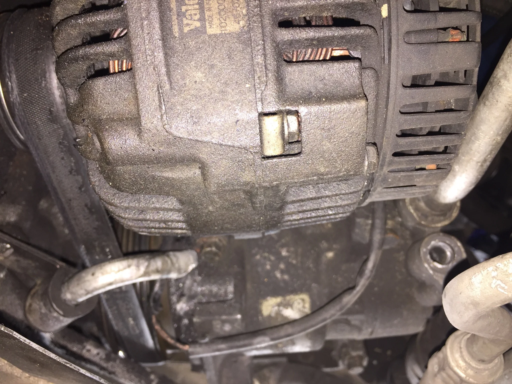

Spent the last couple of days stripping the car down to take the engine out as it’s clearly loads cheaper to get a complete unit than a head!
Part way through and I’ve found the cause of the shredded alternator belt... a sheared air con pipe. I think it’s been snapped by my radiator which is very loose, how exactly should it be secured?!
Anyway... least I know now...
