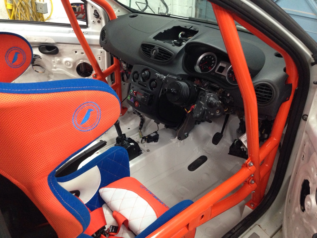

Starting to look like a proper race car.
Got the dash back in which was a total nightmare. Just got some wiring to finish before I can refit some of the panels.

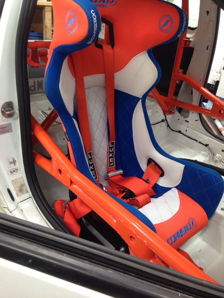

Drivers seat and harness fitted as well + steering wheel boss and quick release hub.
Should have the inside all finished at the weekend then just the brakes/suspension bits to sort.

Seat is a bit loud for my taste but looks great otherwise. Will be very interesting to see how this goes compared to the 1*2s.

Both seats fitted
