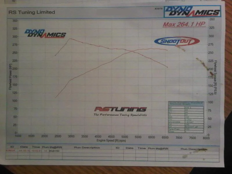

I would be heading north to have Paul at RSTuning doing it though. He knows what he's doing and will keep to a decent timescale.

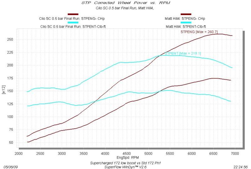

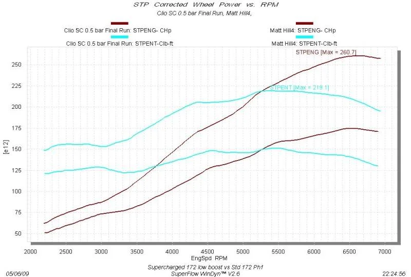

well comparing standard to supercharged, there's a pretty substantial torque difference
The curve is a different shape to using a turbo, but the delivery is smoother and less likely to break things (something you should be interested in Mr. Greer ;) )

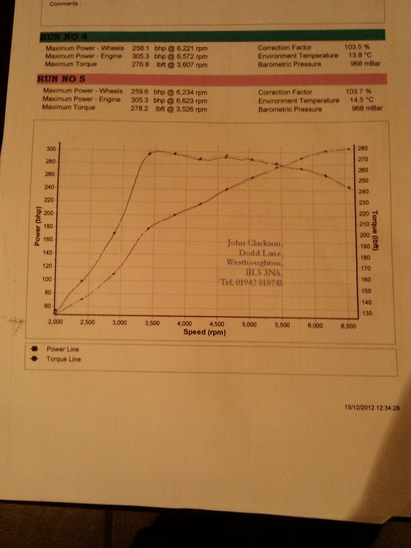

Chips will cost £11k if someone is building it for you. I know, as I spent all weds night chatting through the build with him and Mike from MWM. It's not just the turbo, ancillaries and forged bits, you need clutch, decent mapping, LSD and brakes. Luckily I have an LSD, but I was still looking at £10k. The reason chips turbo is so good, is not the top end figures, but the setup is good the power delivery is smooth and virtually like an N/A car. I hate badly set up turbos.
Nothing.....nothing....BBOOOOOSSSSSTTT....nothing. Chips is nothing like that, just pulls and pulls and pulls with great throttle control.

Graph looks pretty smooth admititly
