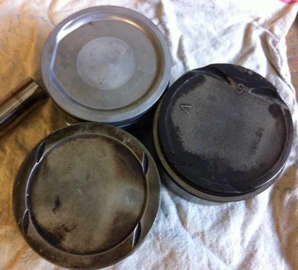

Lets hope so based on those images that you put up showing the difference in pocket size, presumably cause the megane has no dephasor? (and poss slightly milder cams)
Bingo.
No VVT on the Megane 225 / r26 and the cams are milder.

Megane piston is top left, other two are the 172 and williams ones:
Was tutuur not laine I was tihnking of that posted them.

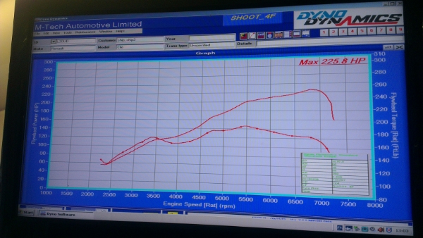

You havent ever been in a decent turbo car yet thats all mate, but TBH neither have most people!
Nearly all turbo cars do exactly what you are saying so I dont blame you for thinking it has to be that way, but it doesnt.
Mine on low boost for example:
(and that was a very quick map where I just quickly popped by own car on the rollers between two other cars I was mapping that day, I literally only had about half an hour in total, it could be even smoother than that with a little more time)
