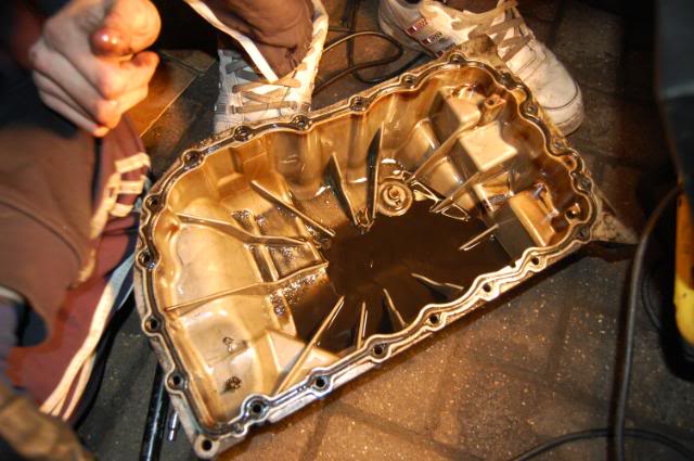

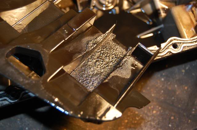

Found what the problem is. Cylinder one shell has melted over heated and melted the plastic cover thats in the sump. The rest of the pistons are ok so sub frame off in a min then tomorrow gearbox will be coming off and crank.
  Racing blue 182 turbo :-)

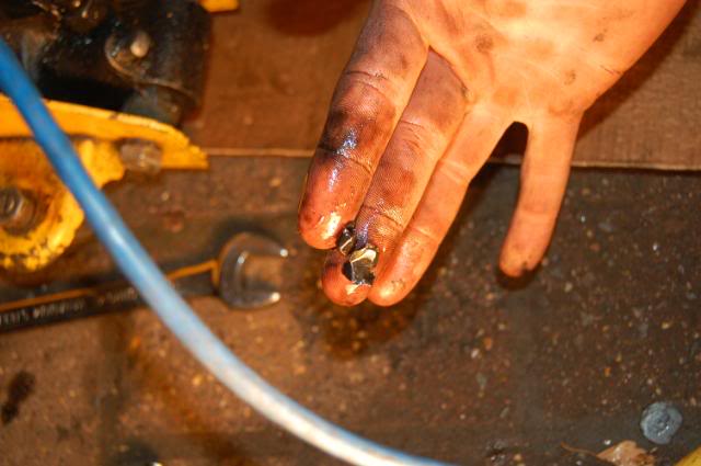

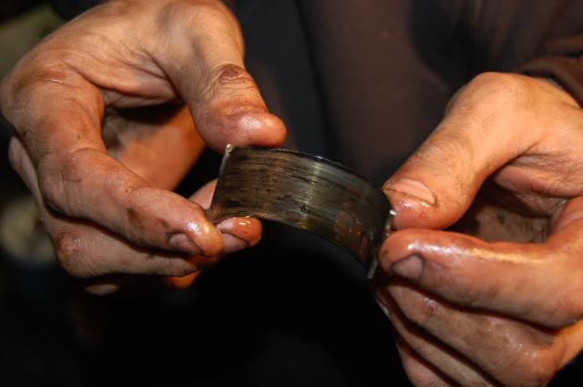

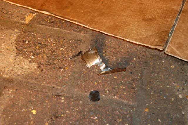

Got some pics of the damage :s
Melted :s
changed colour coz of the heat

Ryan - what do the mains look like then if the big ends are that mullered!!??

it'll need heat treating to re-temper it due to the heat it's sustained it will have weakened.

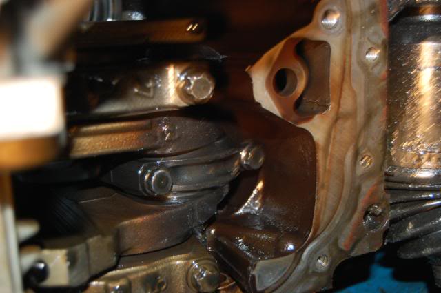

right big ends are fine iv had them off and no damage at all the turbo is fine too. 7 of the lifters have collapsed. As for me doing the job im still glad i did it coz fixing car has cost me nothing it was a burst hose on the oil cooler nothing to do with the conversion. As for rushing the job nick it took 2 weeks it takes k-tec 2 weeks to do the work so does that mean they rush it.
but on an earlier note, you said they were ok as you had them off?

the crank may also require re-hardening as the hardening processes used don't penetrate, they are just on the surface.
I'd just go for a new crank, as difficult as it may be to source.
That or give it to a really good engineering company WITH your rods and shells and have them check THE LOT.

I'd check the oil pump too, if it's been starved of oil, that'll look similar to that shell :(
