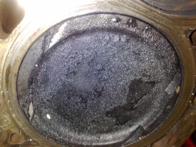

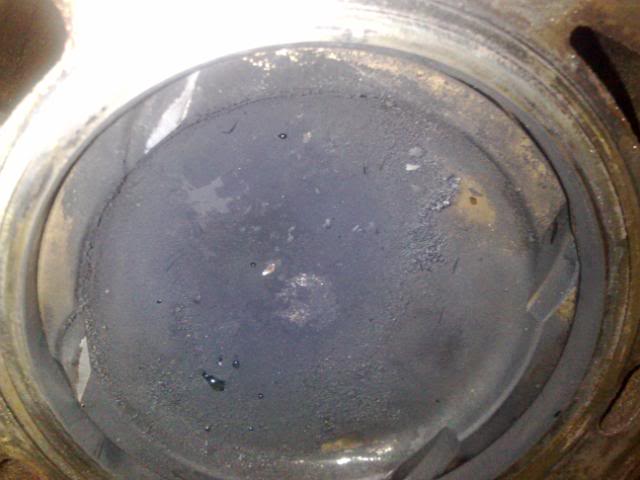

some pics.
That piston smells very very strong of fuel.

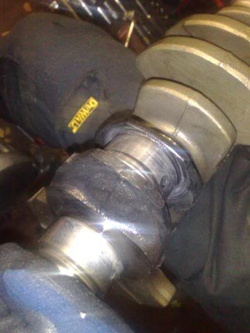

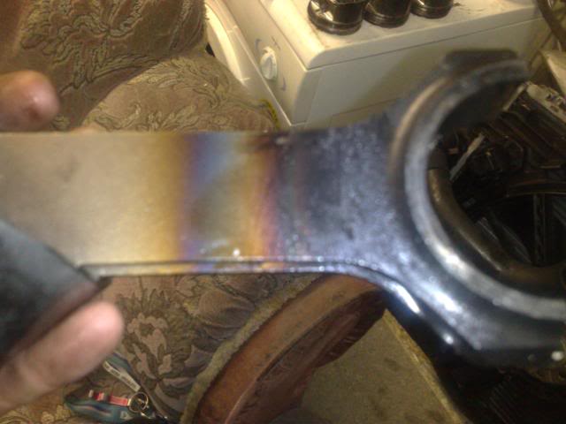

yeah that rod was fubared. make sure you get the crank properly heat treated and the re-ground journals surface hardened

Its a engine company doing it. They said they will give it me back ready to go back in.

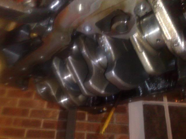

Had crank checked its scrap its shrunk to much they said need to get a new one now
I seriously don't know why you didn't just go for a new engine like everyone said, or at least a new crank in the first place.
But anyway, at least the new one will have 4 good journals on it :)

PMSL @ that rod though! Good effort!
Have you got the number??? that rod dont look like that now looks same as the others that engine place has sorted it for me :)
