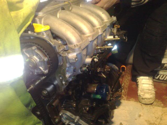

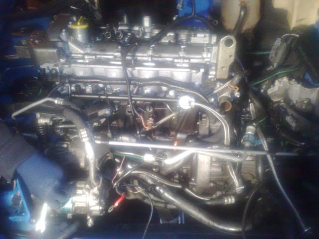

Whoo the new engine is in car and running :):) trying to sort a air leak but other than that its great :) Runs like a dream. picked up the engine 4 yesterday and worked on putting it in car till 4am this morning. Runs better than the other one ever did
  Racing blue 182 turbo :-)
Some pics i got
Only got them all the rest dint come out right because i used my phone to take them as i dont have a cam
Just been out in car its running fine now it just had air in the fuel line well pleased with it.
