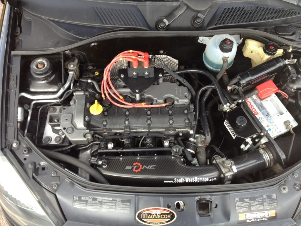

You considered an RS2? They look pretty epic, this is my mrs show/trackday car for example:

Yeah if you like surprising people you would love it, mine properly messes with peoples heads TBH, I get the "what the hell have you done to that" thing off people every trackday I do.
