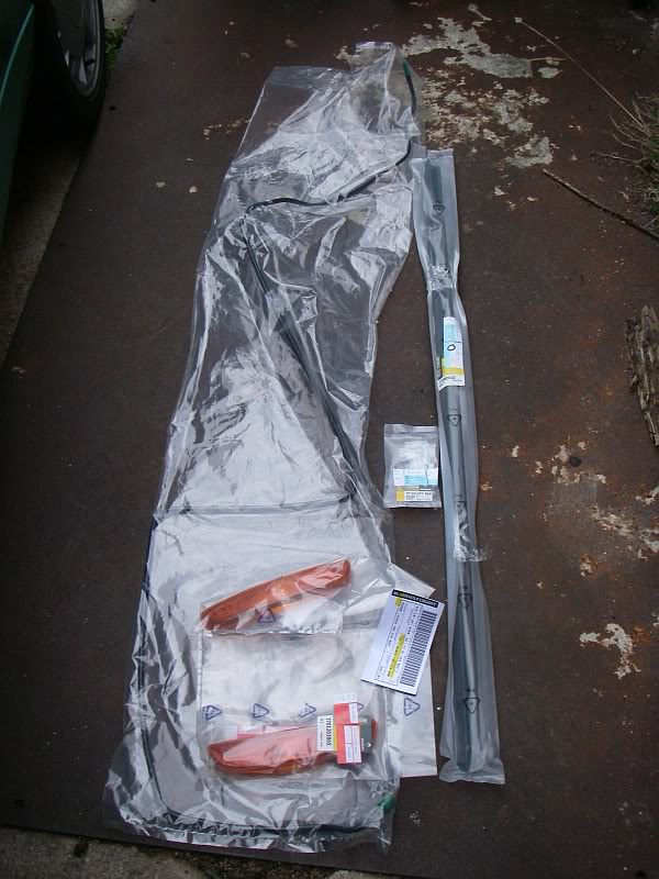

I've had a few bits on order from Renault, and finally managed to pick them up yesterday
that's a pair of front indicator lenses, a pair of window seals, some clips for the roof strips and a new fuel pipe. I'd also ordered a throttle body gasket, when I got there it was one of those packed in a plastic coated piece of cardboard jobs. Having been caught out before with a water pump gasket that fell apart whilst being extracted from it packaging I asked the spares guy to remove it from the packaging, true to form it didn't survive the experience, so I left it with him :)

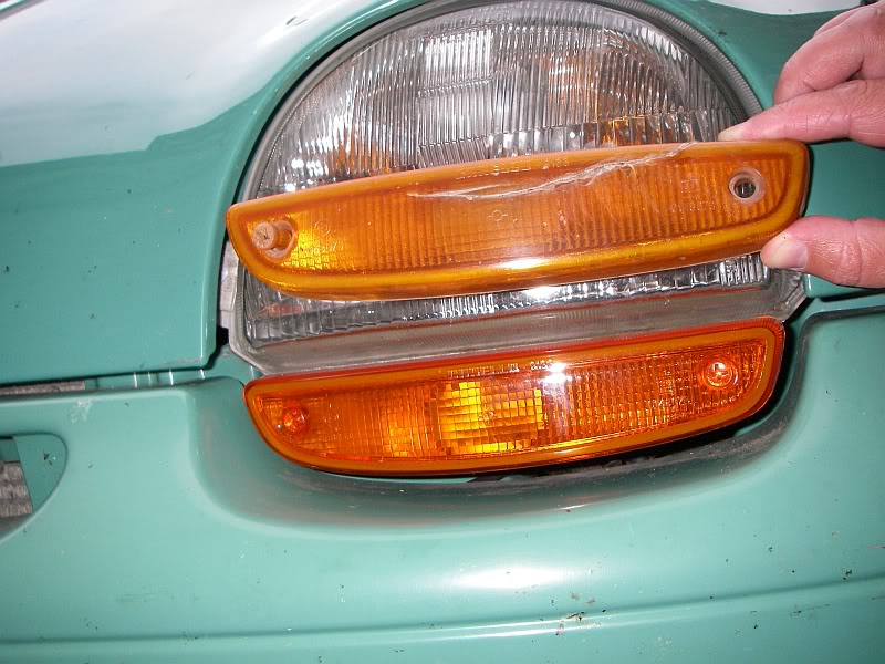

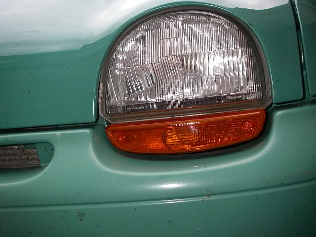

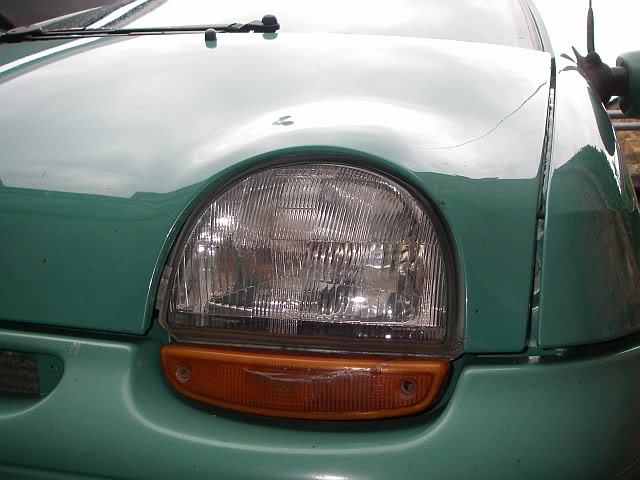

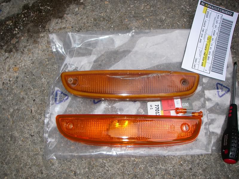

Anyway, I bought the indicator lenses as the drivers side one had been cracked and repaired, and they were both cloudy.
Before:
during:
After:
and a final comparison before binning the old one:

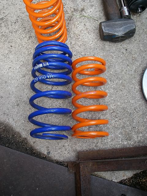

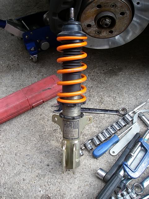

the spring saga continues. After a week of general disappointment in my quest for some new springs, I've finally had some success. I emailed Curtis at AST this morning to see whether he had any springs in the range I was looking for. The man is a star, no only did he have stocks of everything I was considering he was also going to be working a bit late today, so I had time to drive over to Tewkesbury and pick a pair of springs. I was sort of hoping that he'd only have one of the many options I was thinking about as that would save me having to decide which. I'd narrowed the rate down to either 40N/mm or 50N/mm, I think the 40s would work better, but the twingo has very little suspension travel, and no anti roll bar, so even though I believe the 40s to be a better rate I went for the 50s. Curtis was very patient as I ummed and arred, and went through all the numbers I'd written down one more time. I came away with a pair of 50N/mm 170mm long springs.
The blue spring is the H+R progressive one and the orange the new one. It was a relief to see the marking on the H+R springs that confirmed that they had been going coil bound.
I'd estimated that the new springs wanted about 10mm of preload to give the same rideheight as before. That worked out to be spot on.
So, good news, the new springs fit, sit the car at a sensible rideheight, and won't go coilbound. It just remains to be seen how well they work on the road, will I be smashing through the bumpstops or bounce all over the road?
I'm going to try and measure the original springs at work, it'll be useful to know at what load they go coilbound.

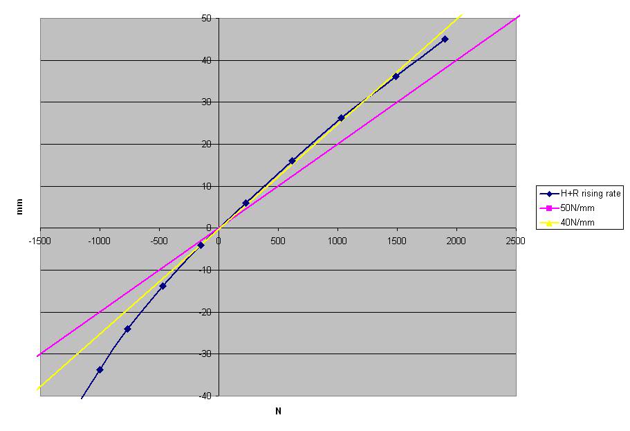

I did something today which would have been useful to have done before buying new springs, but being a daily driver I couldn't be without it for a day. I measured the rising rate springs that came with the H+R kit. A plot first, then I'll explain what's what.
The plot is spring travel in mm against load in Newtons, I've zeroed everything so that 0mm is static ride height and 0N is with the 2150N of static load removed. As you go up the vertical axis you're going into bump, and down droop. There is only 33mm of droop available, and at 27mm of bump you start to get into the bump rubbers. Ideally I'd have removed a bump rubber to measure that too.
Looking at the rising rate spring first, at 45mm of bump it goes coilbound, the suspension was getting this far on mid corner potholes and banging most horribly. This is still 18mm into the bump rubber.
Then the 40N/mm linear spring, this is the kind of rate you'd expect on a tarmac rally car, and where I'd like to have been, as you can see it's a lot like the progressive spring in bump, but has more travel so won't go coilbound. It would drive much like the original H+R spring, but without going coilbound (this 170mm spring has 18mm more compression available than the standard progressive one).
Finally the 50N/mm spring. It doesn't feel too bad on the road, I think this is because it's not going so hard into the bump rubber. I don't like the choppy feel of the rubber, and certainly the car feels less disturbed by bumps.
All in all I'm happy with the 50N/mm springs, I wouldn't mind trying the softer ones out of interest, but it's not that important, I think I'd rather play with the bump rubbers first.

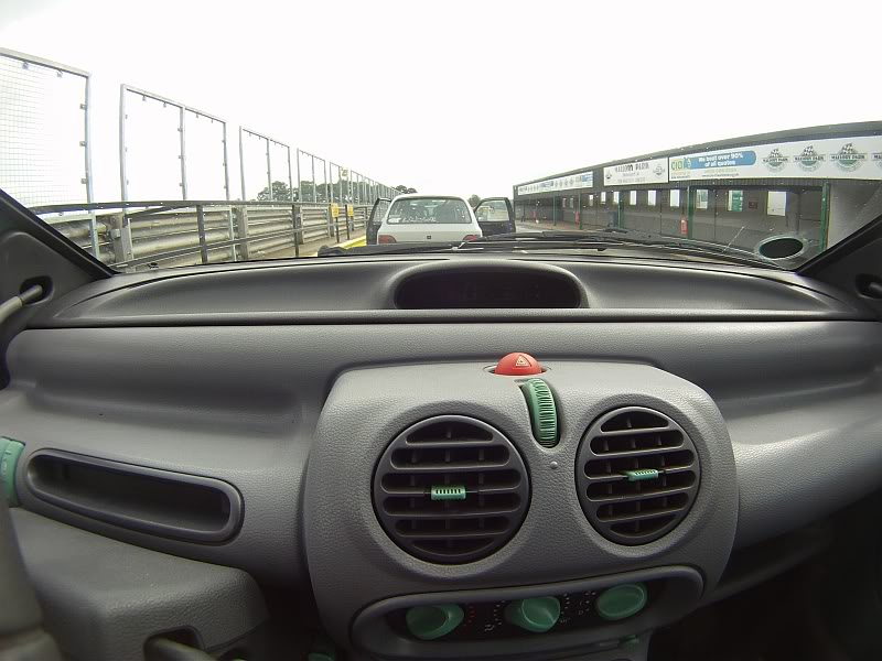

Sat in the pitlane at Mallory I clocked exactly 190,000kms, so thought I'd take a picture for posterity. Pity you can't actually read the numbers, they're on the display in the centre of the dash.
