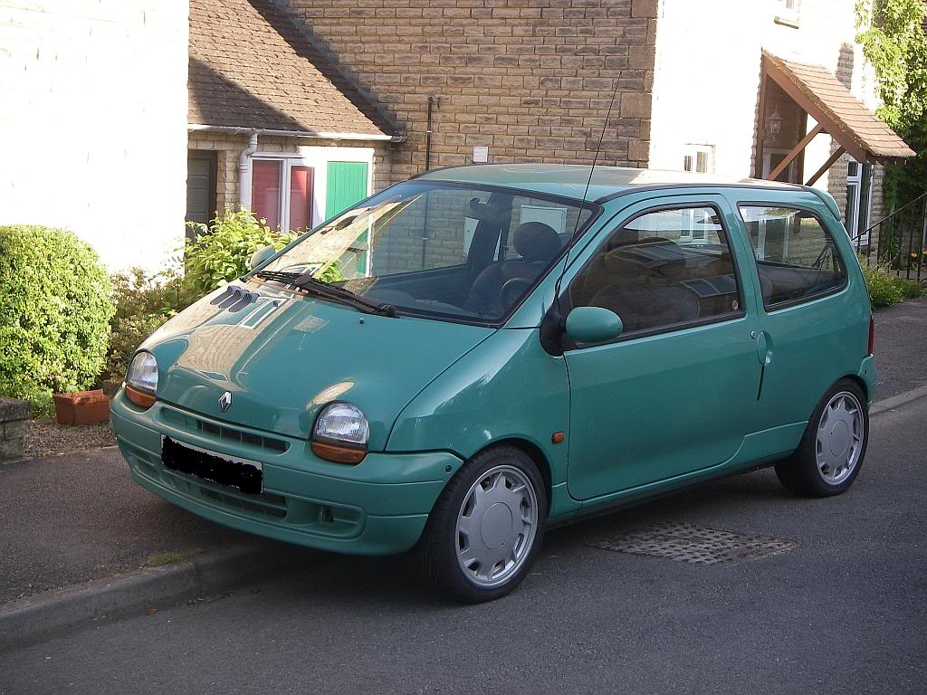

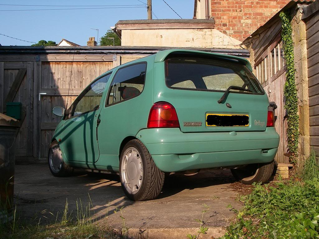

some snaps:
needs a bit of a clean, anyone with OCD want to pop around with your wet and dry, or what ever ones uses to clean stuff these days?
