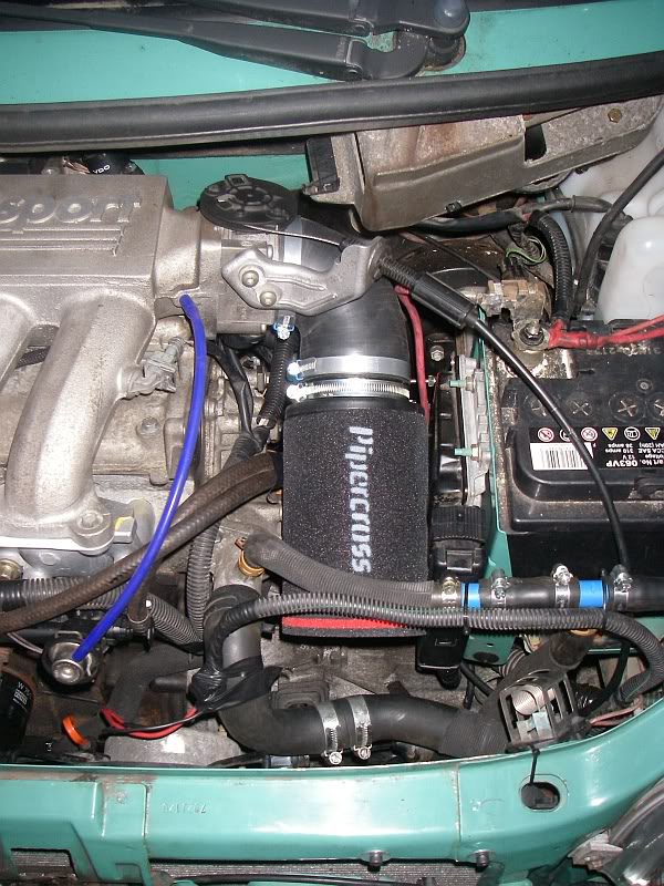

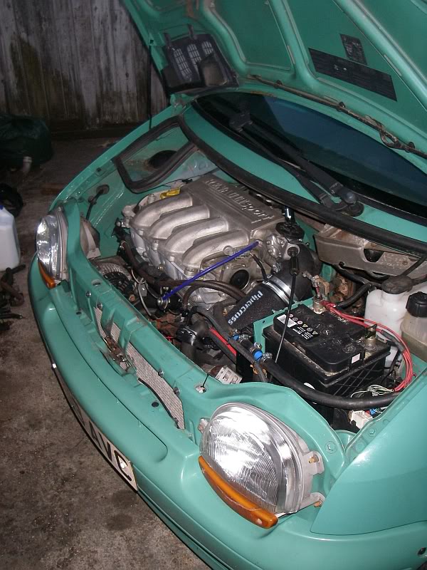

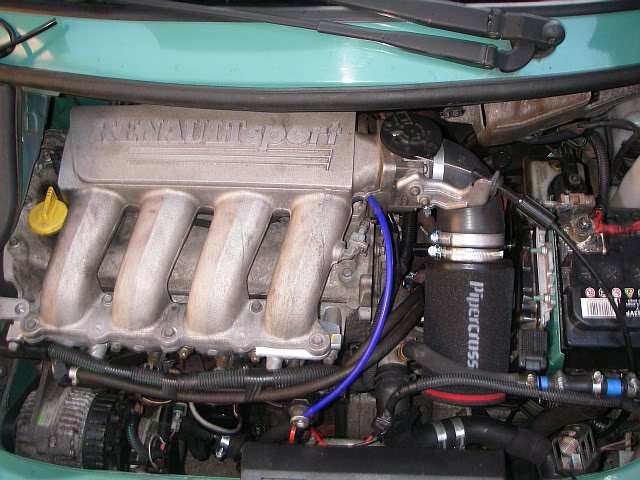

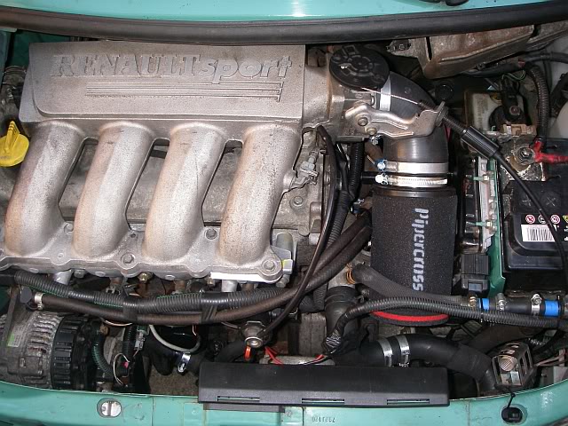

The first thing I got sorted was the air filter:
I used:
pipercross filter 100mm dia 200mm long 70mm inlet
samco 90deg 70mm
70mm aluminium tube
16mm revotec barb
16mm samco flex hose
A little bit of trim got the filter sat where I wanted it, I then fitted the 16mm barb into the elbow and ran the hose to the ISCV. Job done.
I'm thinking of bonding the filter to the aluminium pipe to the 90 with tigerseal to get rid of 2 of the jubilee clips as they look a bit messy.
I'd also like to swap the blue hose from the FPR to the plenum with either an original part, or some black silicon. Drop my a line if you have anything lying around :)

Nice work, although would the filter be better off a little further towards the front of the car? It'd be closer to where cool air would be entering, and further away from that hot plenum?
I don't think cool air has any interest in finding it's way under my bonnet :dapprove:
The only possibility would be to run a pipe across the front of the engine and collect air under the RH headlight. I'm not sure how much I'd gain after running all that piping inside the engine bay, it'd probably just stop the engine from cooling...

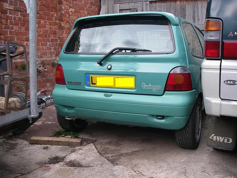

I was down at ProSpeed in Cardiff on Monday morning to get my exhaust made up. My requirement was to make it look and sound as standard as possible, Charlie recommended 2 boxes and 2" pipe, so that's what I went with. I'm not sure how long it'll take the guys at ProSpeed to get over seeing a 2L engine shoehorned into a Twingo, but I'm sure they're making good progress :D.
Anyway, so far I'm very happy, no knocks, or bangs, it's as quiet as I'd hoped, and looks pretty much standard.
Anyway, a couple of pics:
before
after:
you'll note that the number plates got replaced between pictures :cool:
oh, I almost forgot, when we got to look underneath at the standard system the rear box had ballooned, I guess it must have been pretty restrictive :)

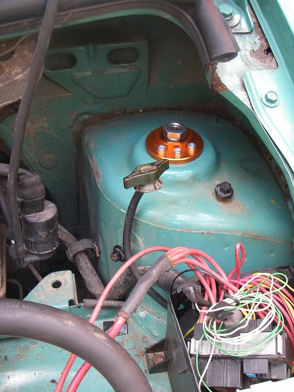

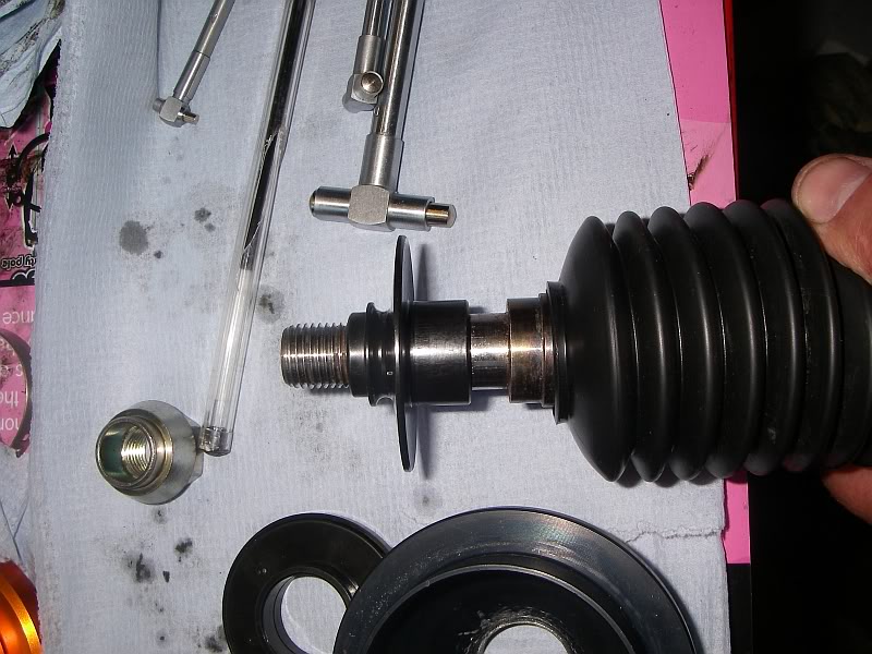

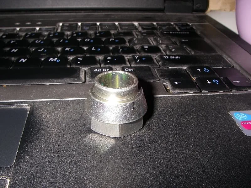

I guess it's time for an update... I've been listening to the standard top mounts knocking, so decided I'd try some roller top mounts. I don't know of any for the twingo, so got a pair of AST Clio mounts. I wasn't certain that they'd fit, but I have a lathe, so it's no bother to modify stuff if it's close.
Last night I pulled a strut off, and checked that the mount fitted the car. Perfect fit, so nothing to do there. When it came to fitting them to the dampers it was clear that I'd need to do a bit of work. I spent about an hour measuring everything and deciding which bits to modify.

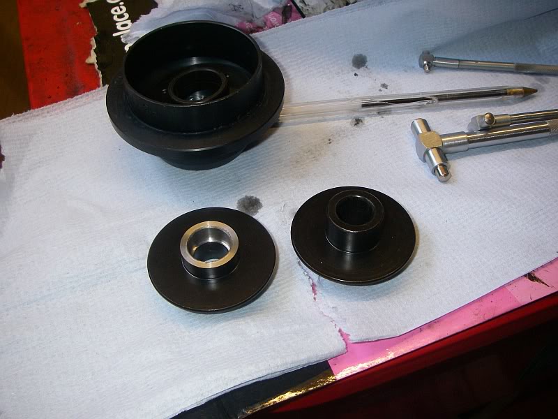

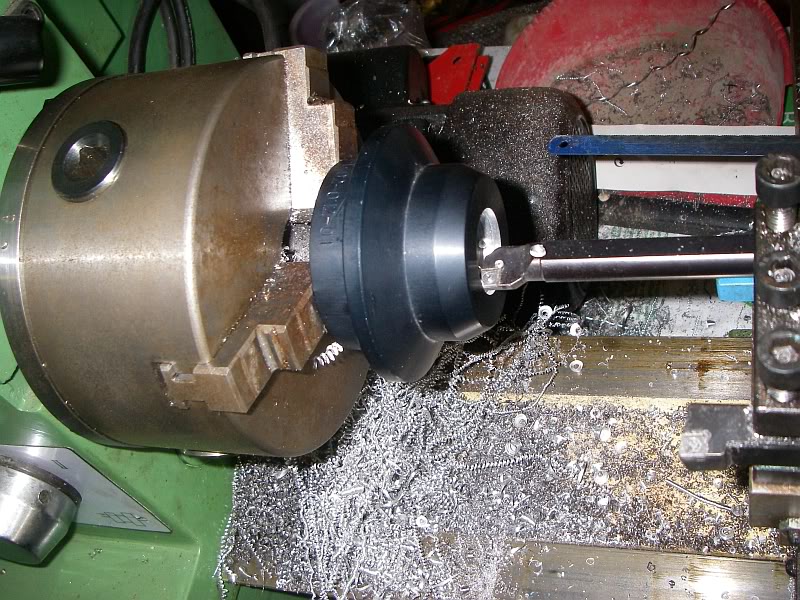

In the end I decided to bore out the H+R top seat to fit the AST bearing, then shorten the AST bearing seat, and bore it out to sit right on the damper top.
before:
standard and machined parts:
after:
boring out the H+R spring seat

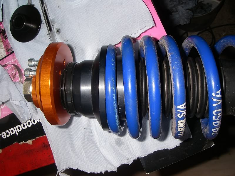

all assembled:

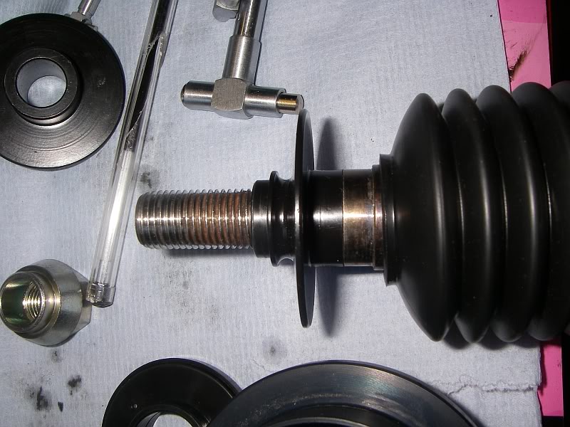

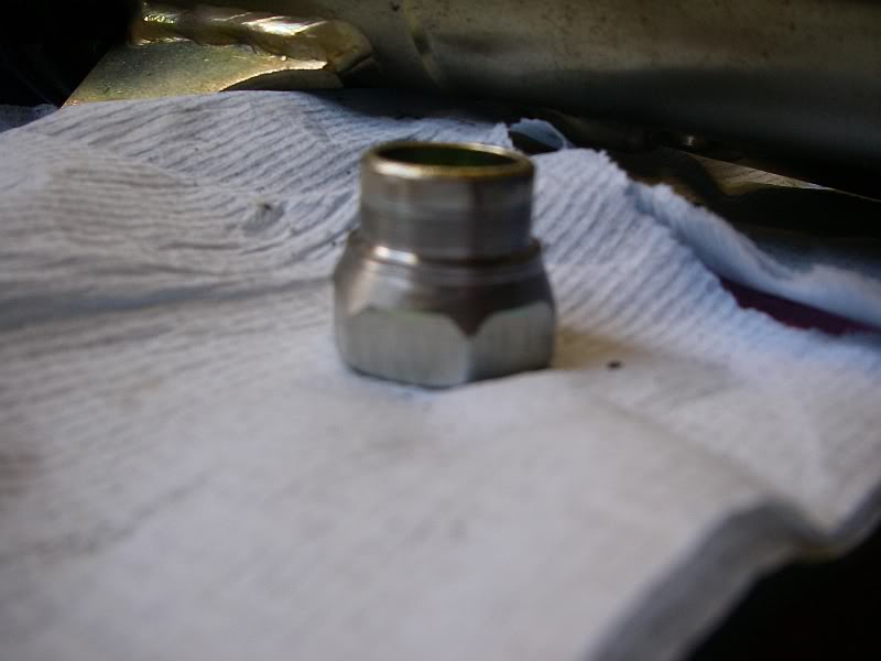

when it came to bolting it together the top nuts only had a couple of turns of thread engaged, I decided to modify the nut to sit deeper in the bearing.
standard nut:
I dropped them into the lathe and cut the shoulder deeper into the nut, and recut the taper to ensure it didn't clash with the bearing housing:
fitted, showing much better thread engagement
I've not driven it yet, so fingers crossed for an improvement :D
