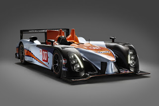

So hopefully everyone will find this of some interest!
Aston Martin AMR-One Chassis 001 rebuild.

So we unloaded the collected parts and components and set the tub up on its build stands on one of our engineering floors.
Over the past week we have been assessing the parts we currently have and whats missing to complete the car and bolting together as much as we can. As you can imagine from a works LMP1 project everything is made & designed to an extremely high quality and bolted together with the finest fasteners.
View from the drivers seat:
The Steering Wheel!
Last couple of days I have bolted the front wishbones on and sorted out, ready to be bolted on, the front upright assemblies with the carbon 'cake tin' brake ducts etc. Few pictures of that...
I then fitted the rear upright assemblies, complete cake tin assemblies, carbon brake discs, monobloc Brembo calipers with carbon pads and then finally the wheels just to see how wide the rear end is going to be. All of those components bolt directly to the gearbox as the gearbox is a stress baring component to save weight.
I will get more detailed pictures of the components, but got a bit excited putting the bits together that I only took pictures of the end result....
Had to check the car would fit through a doorway before we got too far down the line!
I then bolted the front dampers on..
Theres still a third damper to be fitted to the front which helps 'dampen' front dive under braking. There is also a third damper on the rear suspension to help 'dampen' the rear squatting down under acceleration. This is to keep the car as level as possible to help aero stability.
