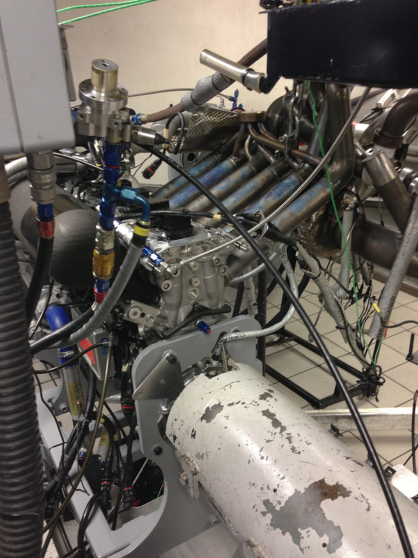

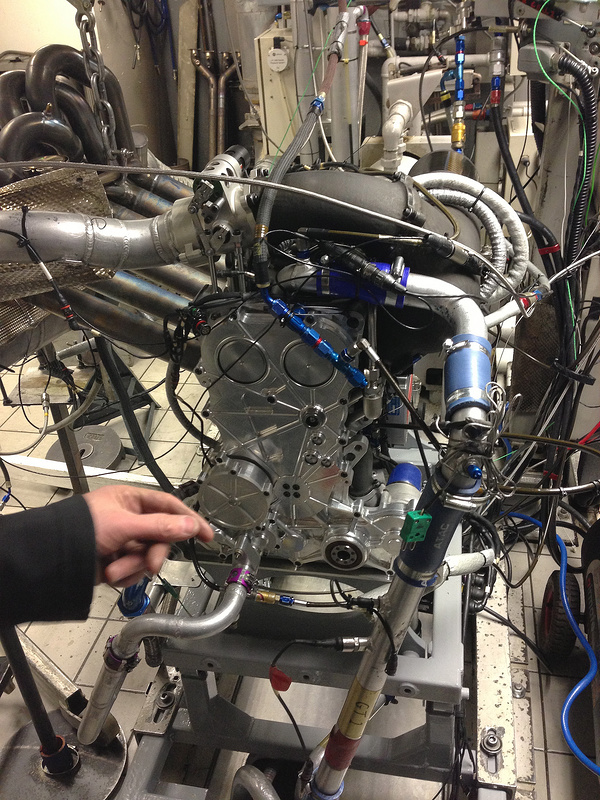

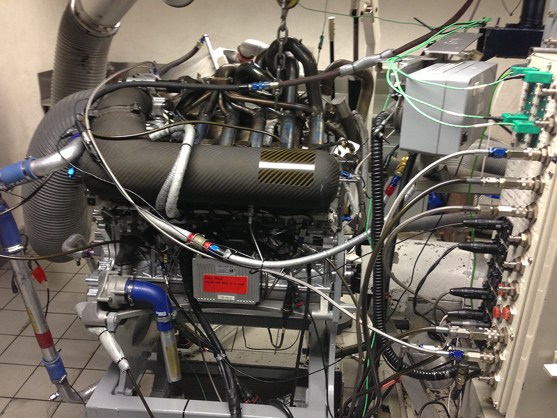

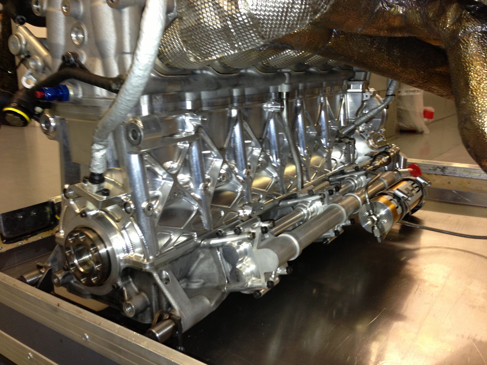

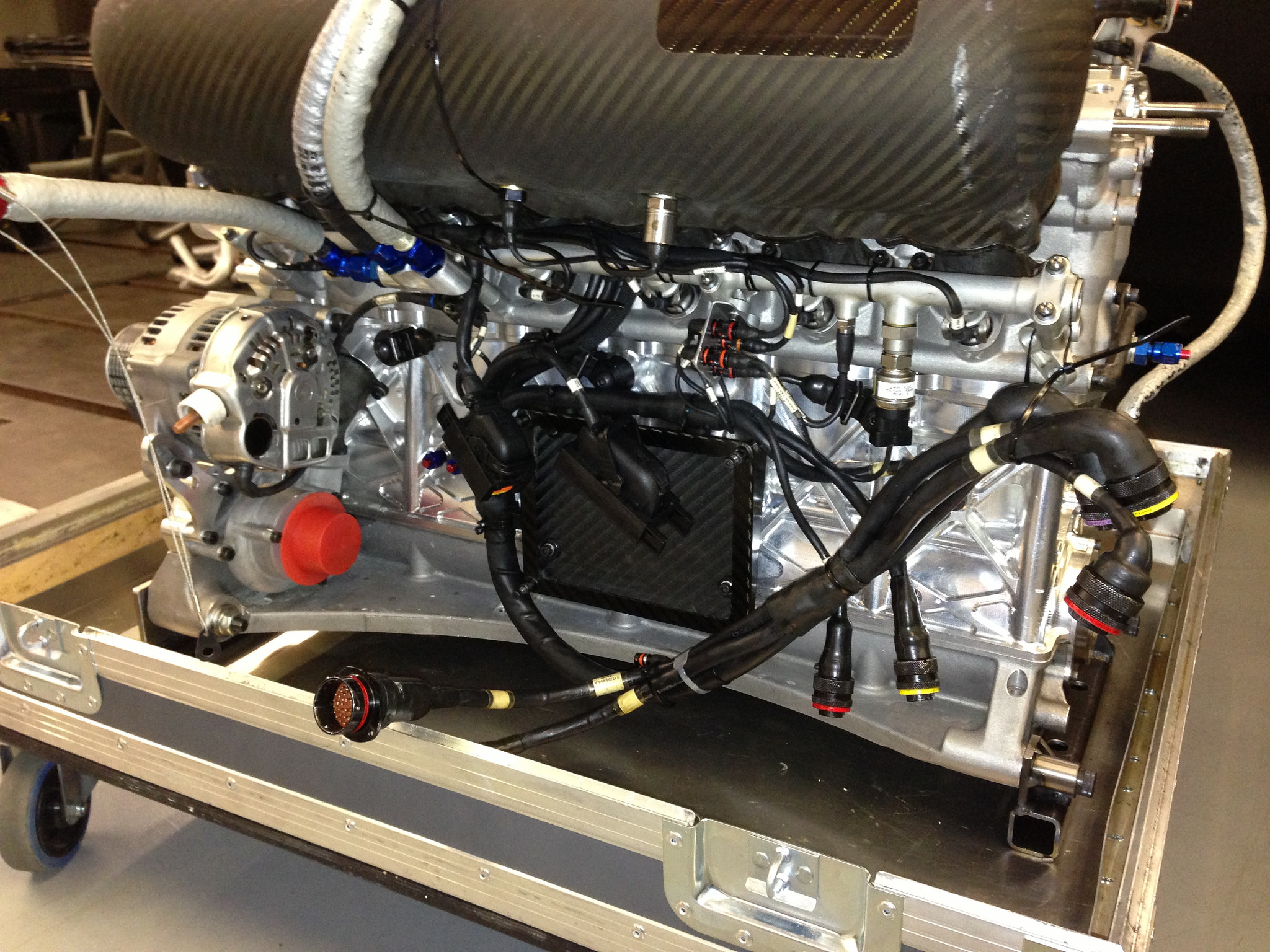

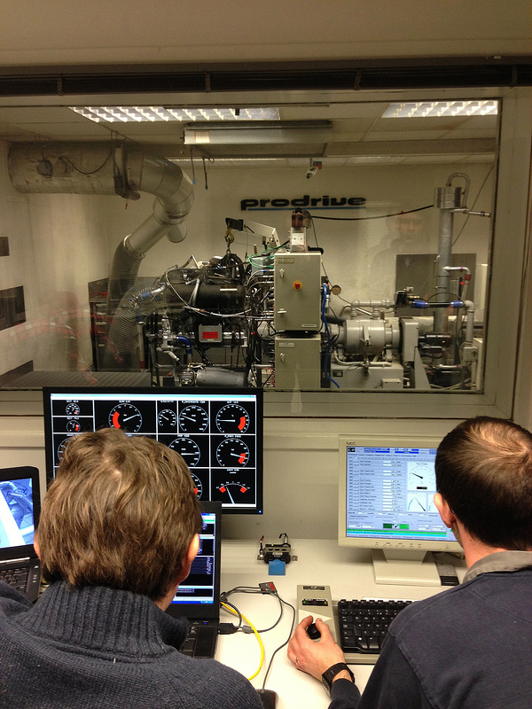

Yesterday we went into Prodrive to see the newly built engine (1st of 2 engines we are getting), on the dyno. It dyno'd at 480ish bhp, which I thought was pretty low but tbh I think its better to have the engine running and usable rather than it blowing up!

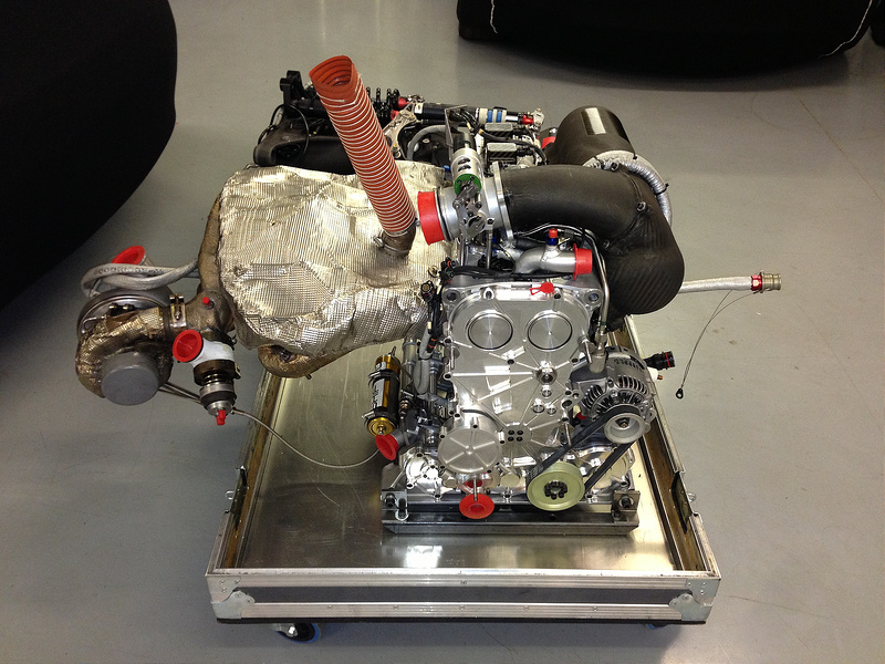

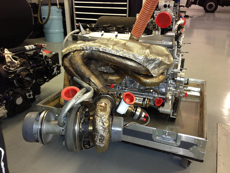

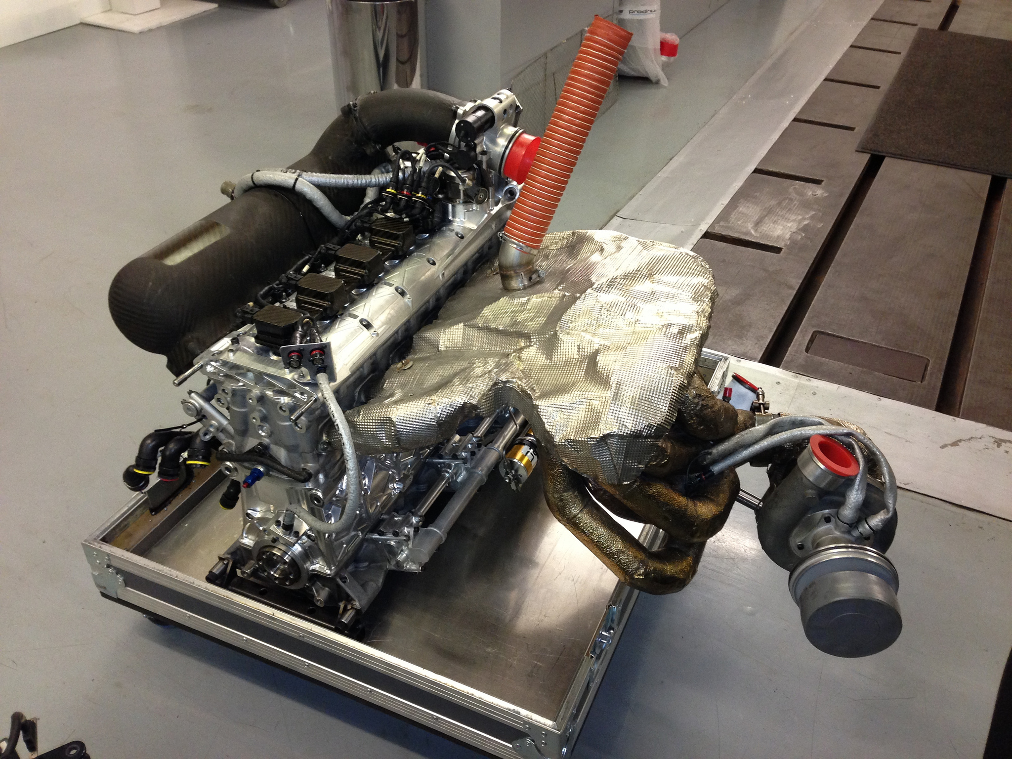

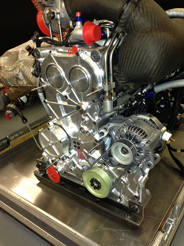

The engine was then delivered today once it had been PDI'd. You can see the alternator pulley which is the part of the engine which fails, apparently the harmonics of the engine cause the pulley drive gear fails and send itself up the front cover of the engine, destroying everything in its path. Obviously issues like this are worked out through development (and usually behind closed doors) but the AMR guys just didn't have enough time to do everything before Le Mans 2011 came round.
Anyway the engine is usable, but doubtful the guy buying the car will ever race it so not an issue anyway.
It block machining is a piece of art!!

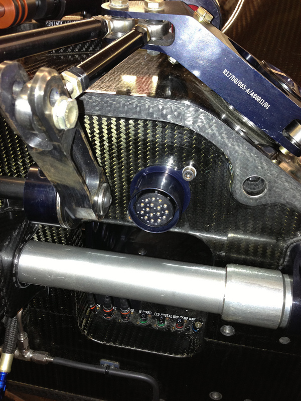

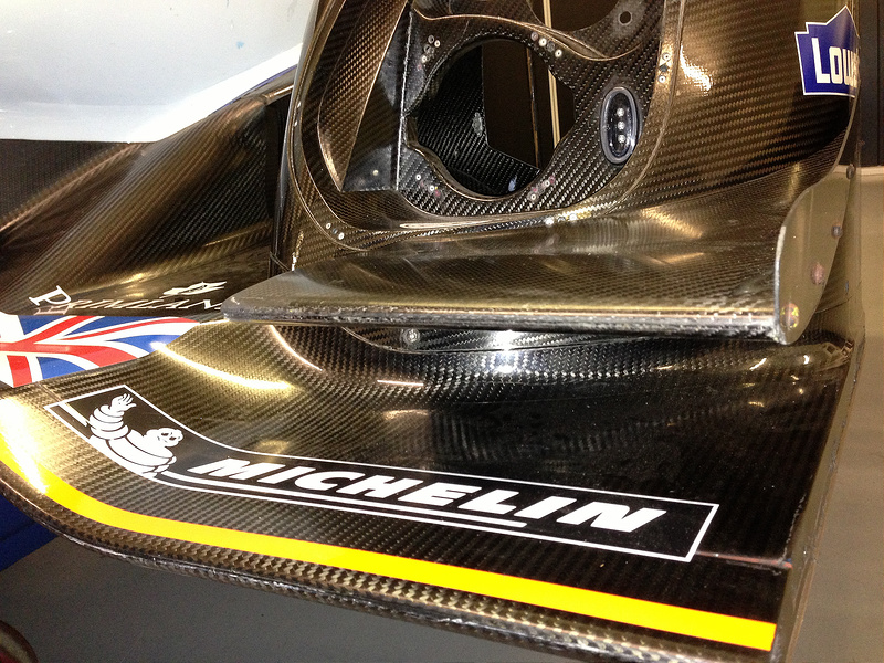

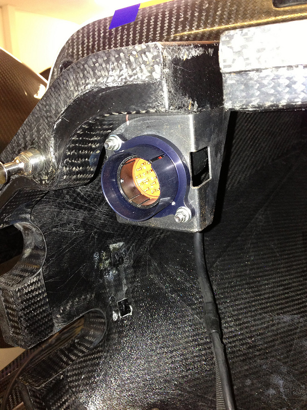

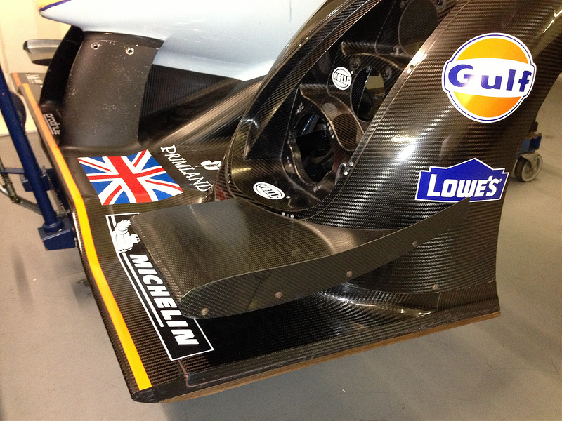

I also did some work on the front nosecone/splitter/wings body section. Fitted the front dive planes and also fitted the wiring loom and the electrical connectors which connect the loom to the body loom as the nose is fitted onto the car...
Oh and also had to have the front wishbone/upright assemblies off as theres a carbon fibre bracket which sits underneath the front of the tub and comes up the sides which holds all the brake ducts which has to be fitted before the wishbones can go on :mad:. Oh well all fun and games :clown:
