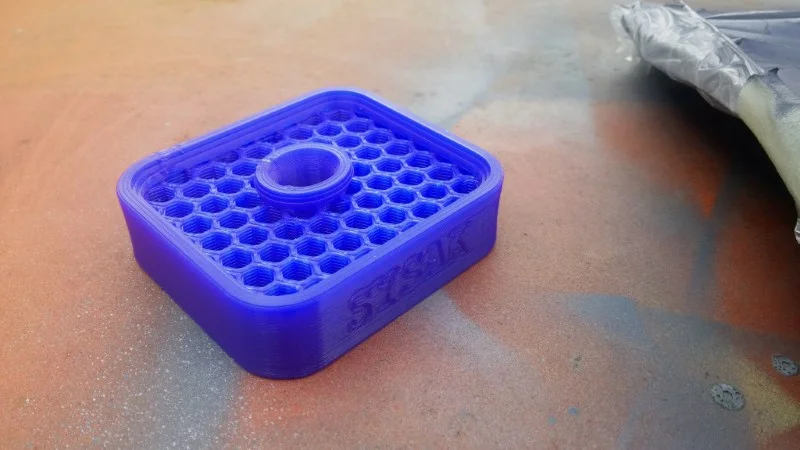

Hi all, some of you might have seen my posts in Rich's thread about poly exhaust mounts - I made a simple version of these when my brother used to have a Clio because it kept killing mounts, just a set we glued in, and they lasted until he sold it - but after reading the thread I spent a bit of time re-modelling and knocking some prototypes up of versions that should hold well enough just from being pressed in by hand, so it makes fitting very easy - and a few people are testing them at the moment.
I've had a lot more people asking about them than I originally imagined - both here, facebook and other forums - seems like everyone is sick of the OE ones and from Rich's thread the Powerflex options don't seem great if you don't want to go deaf, whereas mine have a lot more flex even though they're stiffer than a new OE mount:
That design also allows a lot more fore-aft movement than the solid ones, which helps if you don't have ultra-hard engine mounts.

You should do designs with the centre hole in different places (Vertically) to get them tucked right up. That's the main problem with the polybush ones!
  406 V6, Race Buggy
Well, it'll fit upside down too, which gives you a bit of adjustment.
If you want to be crude an M6 bolt will thread nicely into the hexes for fine tuning of height - I designed it that way in case they needed bolting in.
The centre hole is also designed so it'll take mounts from 10mm to 13mm, to allow for rust, plating, aftermarket boxes, etc.

Was just a thought buddy! Often people like them really tucked up against the surrounds, then others want them to be a bit further away. Leaves you more scope to sell to more of the market! Simple design change.
Are these PLA 3D Printed? (Look too rubbery to be PLA)
  406 V6, Race Buggy
No, they're polyurethane, same stuff I make engine and subframe mounts from - I don't think PLA would last 5 minutes!

No, they're polyurethane - I don't think PLA would last 5 minutes!
Yeah it's very rigid. For people worrying about them coming out they could easily just be cable tied.
Might make sense to oversize them in length like powerflex do, and add a little lip on the back that presses through and out on the other side then it's effectively locked in place.

I looked at that but if this design works fine, it's a fair bit cheaper/faster to make, and even if it does move, it's faster to make the locking piece than make it all one.
It's a different matter if I'm making a production mould but that requires selling 100+ really.
I've tried and you can't physically push them out by pressing on the centre mount where the hanger goes - the hex pattern just stretches instead - you have to shove the outside to get them to move. We'll see how they perform with a bit of vibration though.

How are they fitted / Held in place as the metal bracket is not a perfect square like the bush itself.
You can see from the power flex bush it is moulded to the metal bracket itself.

The bracket is actually roughly rectangular - I assume the powerflex one has that cutout there to allow for people that don't remove all the rubber, as there's a bit of it shaped like that on the stock ones.
They should all be a good tight press fit but manageable by hand into a clean housing - that's the main thing I wanting test/feedback for at the minute really.

They're quite a lot stiffer even with the honeycomb - it's a pretty hard/strong compound so they're still relatively rigid, so probaby about 1/2 the OE movement side-to-side and about 1/3rd vertically.
