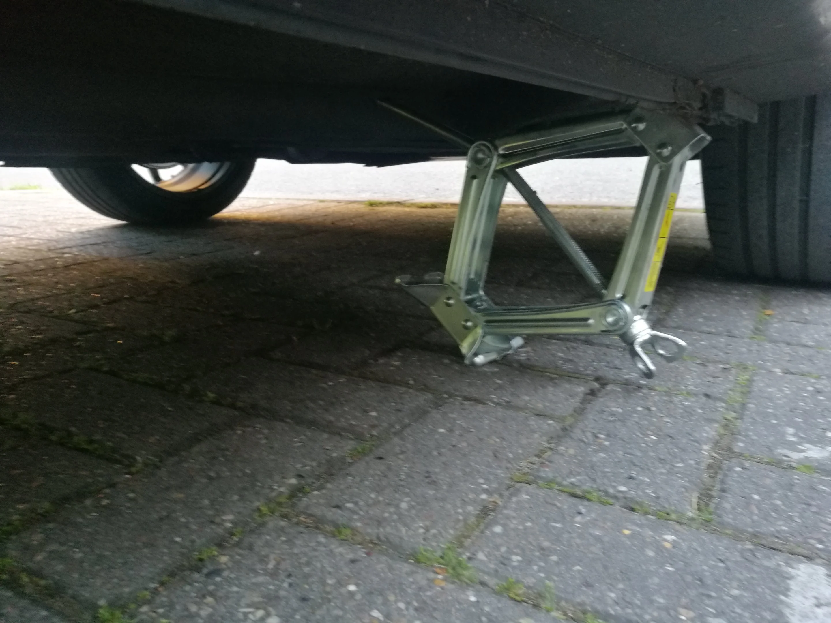

Is that a "The exhaust sits a lot higher, but mainly because the backbox is on my face because the jack fell over" ?

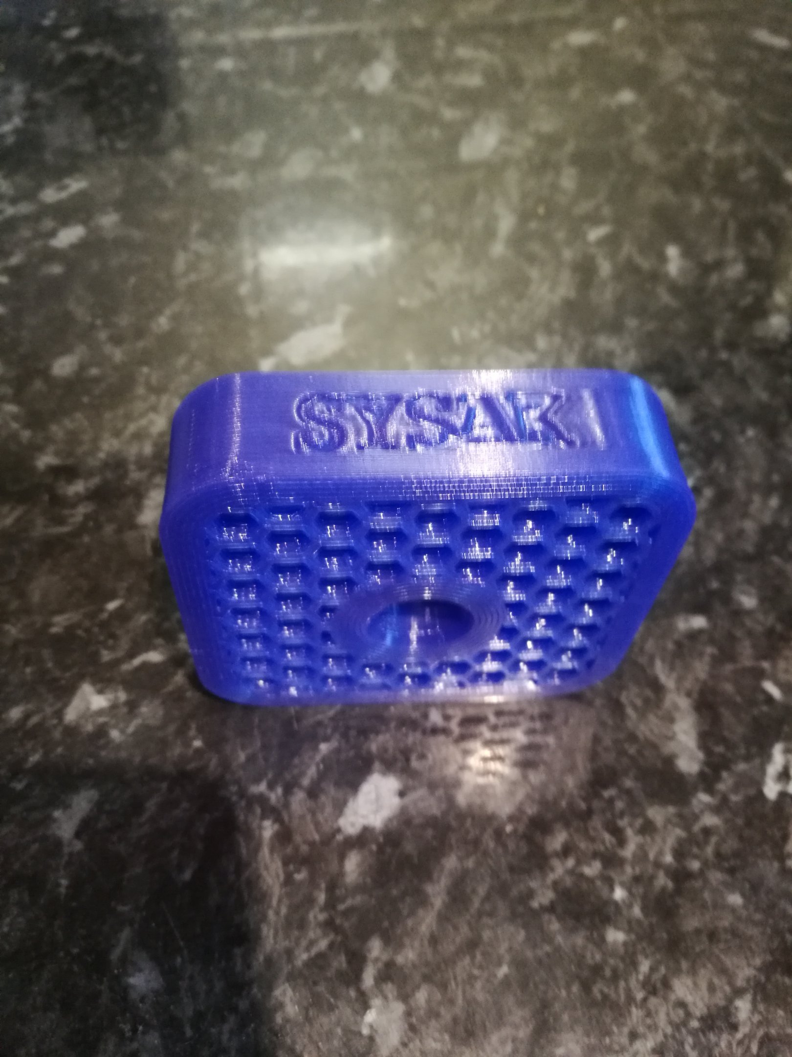

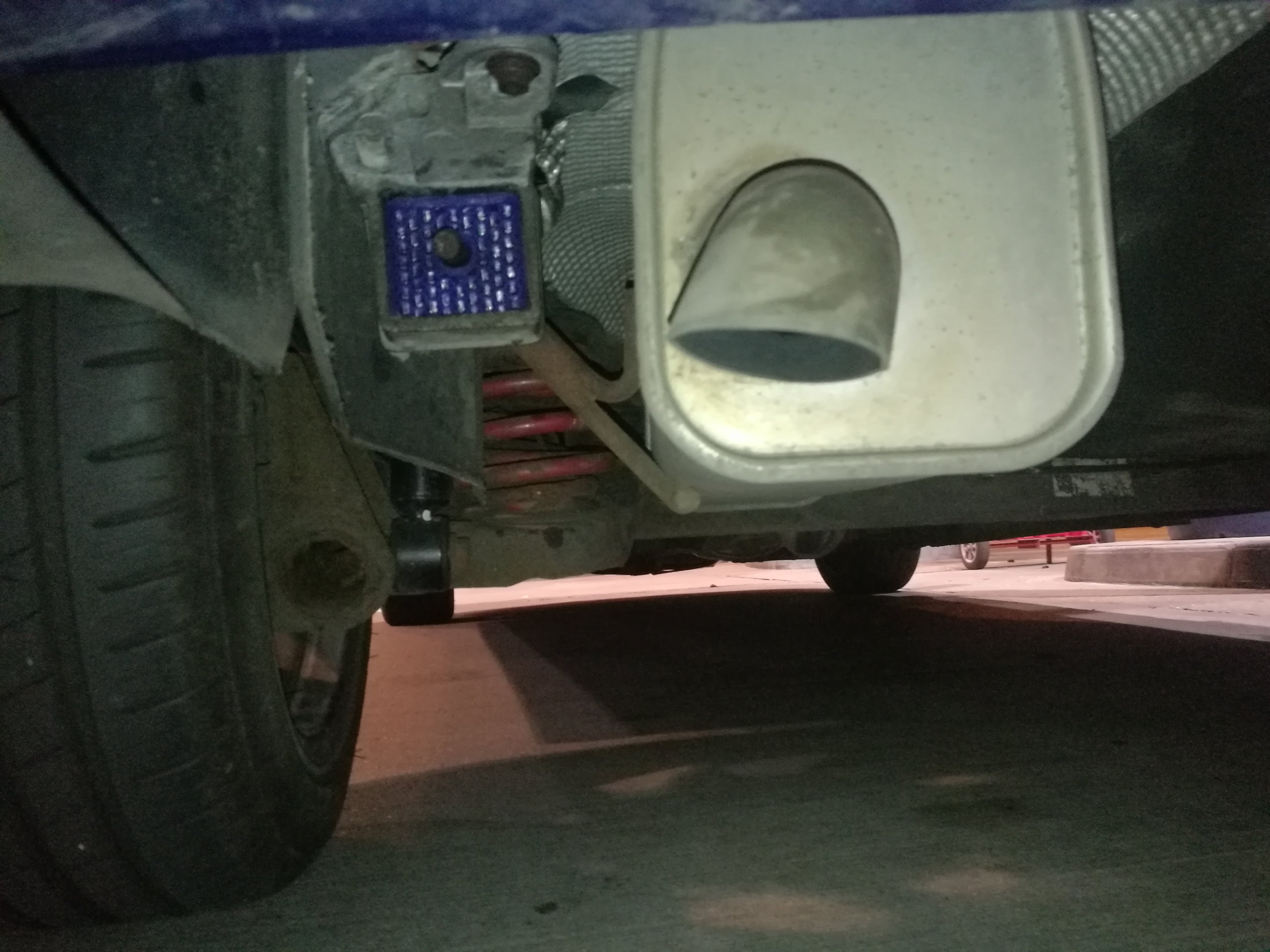

Hi there. So I fitted mine to my 172 yesterday.
The parcel arrived on Friday and apart from the mount I got a little riddle when I've seen the "Dolphin Friendly" logo showing through the tape. My girlfriend bet on some sort of fishing equipment I simply had no clue. Turned out to be a box of cat-food. My cat approved of this straight away.
Cheers for putting in the efort of putting my nick on the mount. Absolutely love it. Back in a day when I worked at MINI Plant Oxford in the Engineering department i was responsible for managing all the rapid prototyping jobs from engineers, so I appreciate this took an extra few minutes to do.

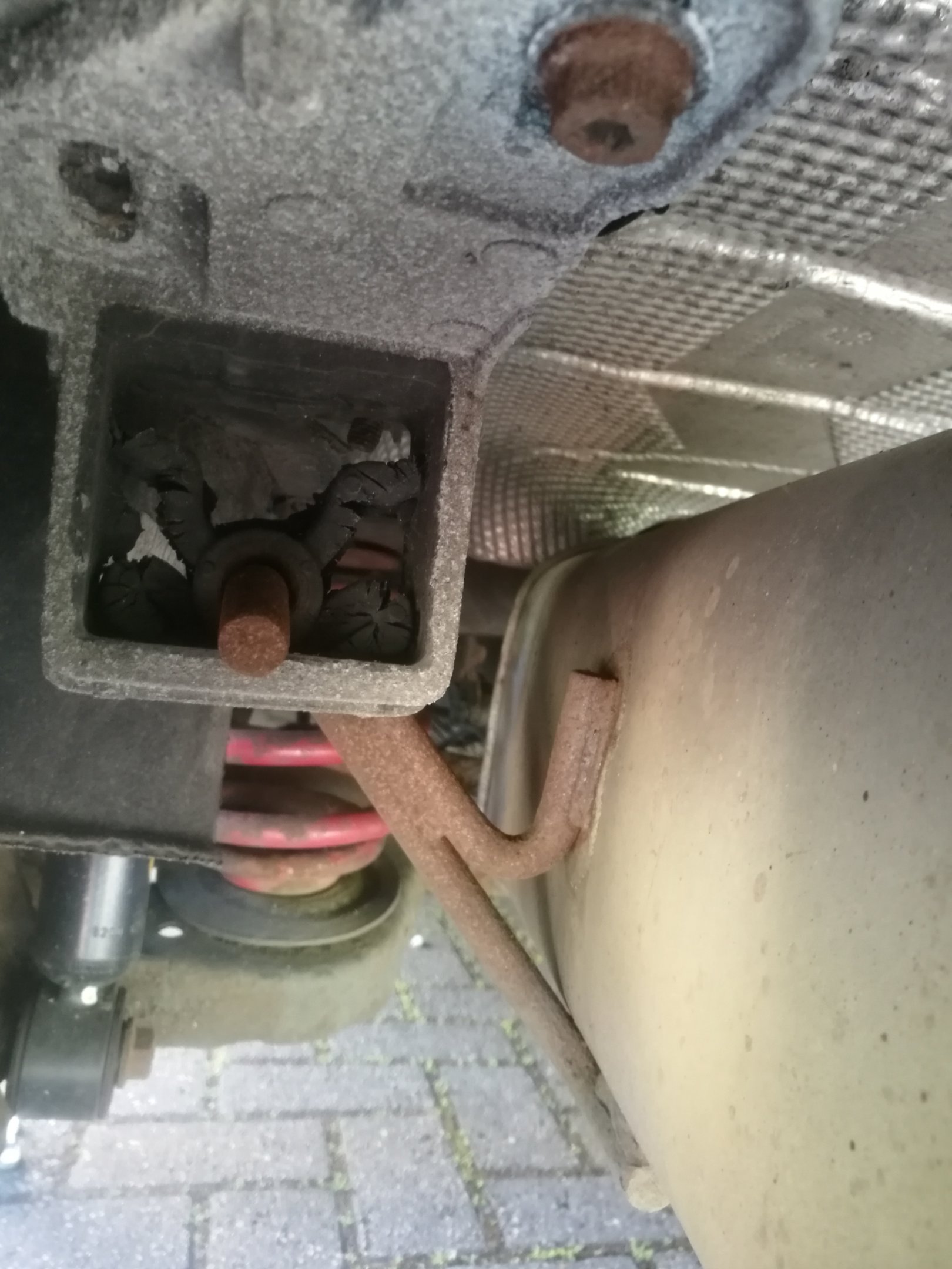

My exhaust was dropping down so I knew the mount will be in sorry state, but what I've seen kinda shocked me. I've unbolted the mount, which was quicker than expected as one of the bolts was snapped by previous owner ;) Then I proceeded to cut out the old insert which was an absolute b**ch to do. In the end I've gotten nearly all of the rubber out all the way to the mettal using 3 different knives, a small hacksaw and small, pointy pliers. I guess it could be handy if with the mounts you could provide the instructions of how best to tackle this job when you start the proper sales as it can be frustrating.

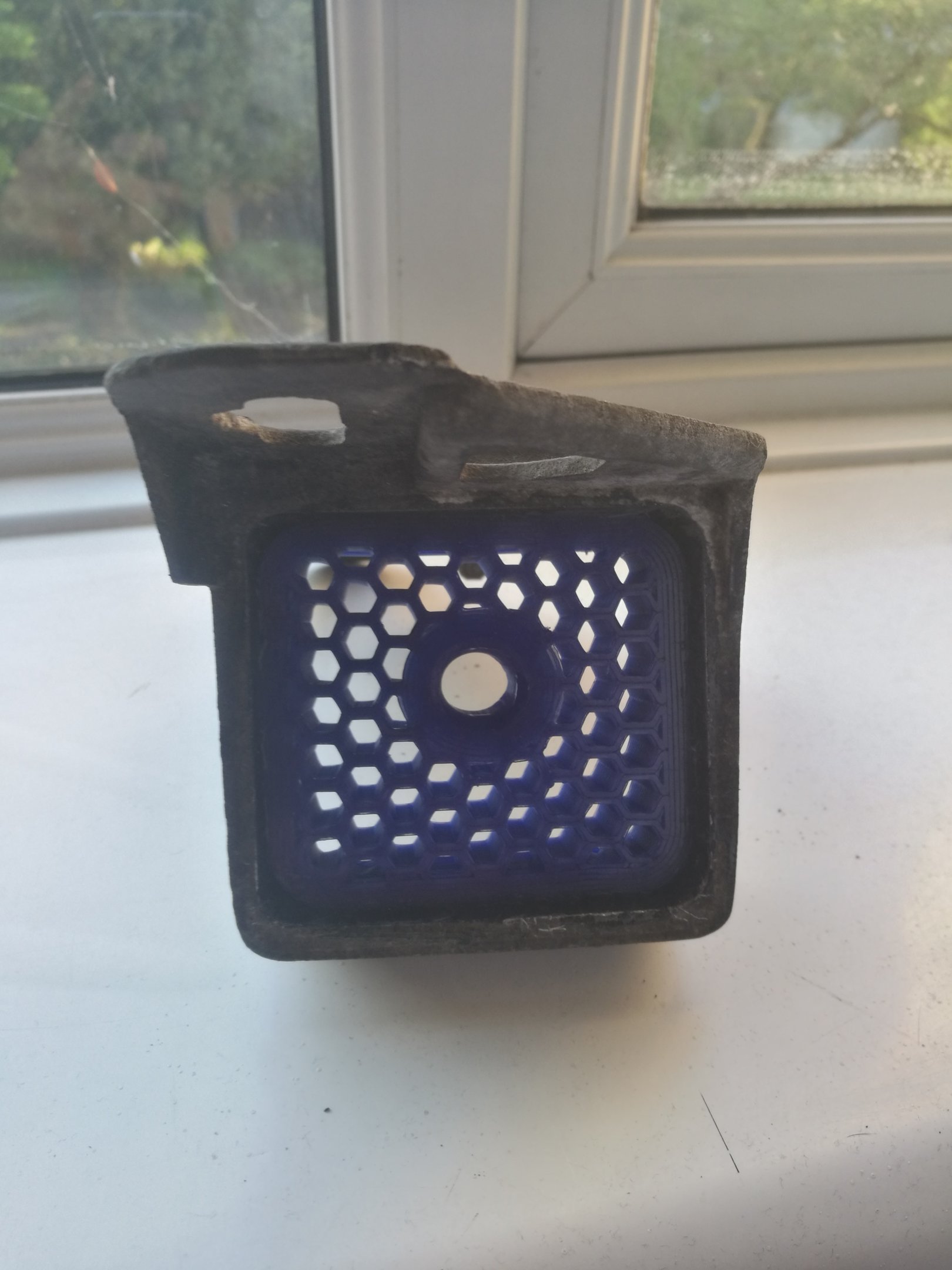

I lubed up the outside of the insert and inside of the bracket with fairy liquid, and was able to insert the mount quite easily by hand. Now this could be down to the way I cut out the rubber. Basically there is a small step in the metal at the narrower end of the mount on three sides of the box section (sides and bottom, not top). If I cut the rubber out flush with this step i think the fit would be perfect, with me getting rid of all the rubber, the fit is perfect but the metal doesn't grab it too hard. Once fitted to the car I moved the mount to align the bolts, and instead of the insert moving on the exhaust rod, the bracket was sliding on the insert.
My recommendation would be to make the mount 0.5-1mm wider and taller or make sure that rubber of the old mount is cut out flush with the step (although I find the step useful for holding the mount in place.
Then I also swapped out the old black center-section mount as mine was stretched beyond what seemed reasonable and the whole thing was just flopping about. I replaced it with the new style red mount which I have also wrapped with 2 thick cable ties to give it a bit more strength.
I then proceeded to change the downpipe to cat spring-s as one of mine is loose and rattles like hell at 3.5-4.5k revs. I didn't even get to start, because instead I learned why lifting an MK 2 clio front using 2 scisor jacks is a stupid Idea. Thank God I wasn't underneath the car when the whole thing collapsed, because otherwise I wouldn't be writing this. ;) This morning with my neighbour's hand I managed to get the Honda Jack from underneath the car. I'll report back when I do a test-drive and provide more pictures. The exhaust sits nice and high now.

Instead of buying new exhaust mounts you should have invested in axle stands and a proper trolley jack!
  406 V6, Race Buggy
Yes, I would advice anyone getting under a car for anything puts axle stands under there, even hydraulic jacks collapse sometimes.
If you don't have anything and it's an emergency at least take a wheel or two off and push them under the sills - better a wheel getting damaged than yourself.
You know how it is: jacks collapsing and other such storries can't happen to me, they only happen to random people on the internet. I'm careful and I know what I'm doing. Surely it will be fine... ;) Now being serious I live in a flat in London, keep the car on a common parking in front of the building. No space to keep a trolley jack anywhere, and besides I don't wrench on it often enough to justify it.
Meanwhile I drove down to the south coast today. The mount is great, same level of vibration as my previous worn one (which i think is perfectly acceptable, can't compare it to a fresh stock one) but obviously less backbox flopping about and clunking, so the car feels more solid going over bumps. However, it seems like I do have a loose heatshield somewhere as now I am getting an irregular buzzing noise mainly when idling. Luckily it's not too loud.

Okay, so far all the feedback I've had from testers sent out - as well as the two local/friends ones I've been having a look at when they come around - are having no issues, sag, exhaust fitment, vibration level/comfort, etc, all are reporting as fine, and the fit for the centre hanger seems perfect for everyone, whether it's a new stainless exhaust or an old rusty hanger (it's deliberately distorted in the bush so it can take a wider range of actual hanger diameters).
Fit in the mounts seems to be good, although both sysak above and one other has reported it moved a little in the housing initially - although not once they'd bedded in, then they stay retained just fine - that may be down to fitting them with lubricant/washing up liquid as the rest were fitted either dry or just with slightly soapy water.
However, bearing that in mind I've made a slight tweak to give them slightly more vertical preload (same lateral) - and increased the wall roughness slightly so they wipe/wick away anything used to fit them faster - just in case - I think they should be pretty much perfect at that.

Yes, I've already made a pair and tested them, they can still be fitted by hand albiet a bit harder to do, in a clean dry housing, so all good there. A bit of water alone is enough to get them into a housing with rubber remanants.
