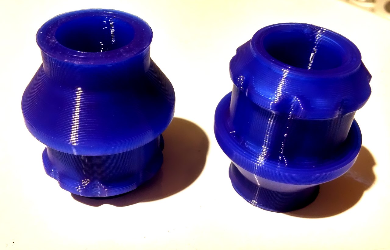

Oh, the larger bushes have the same crenelations as the small bush does as well now - reduces the forces needed to insert the bush, and it's more tolerant of not being pushed in perfectly square:
It also has a small taper lip on that side to help it self-centre when you're just starting to insert it - should help a lot for anyone fitting it just using clamps or a small vice.

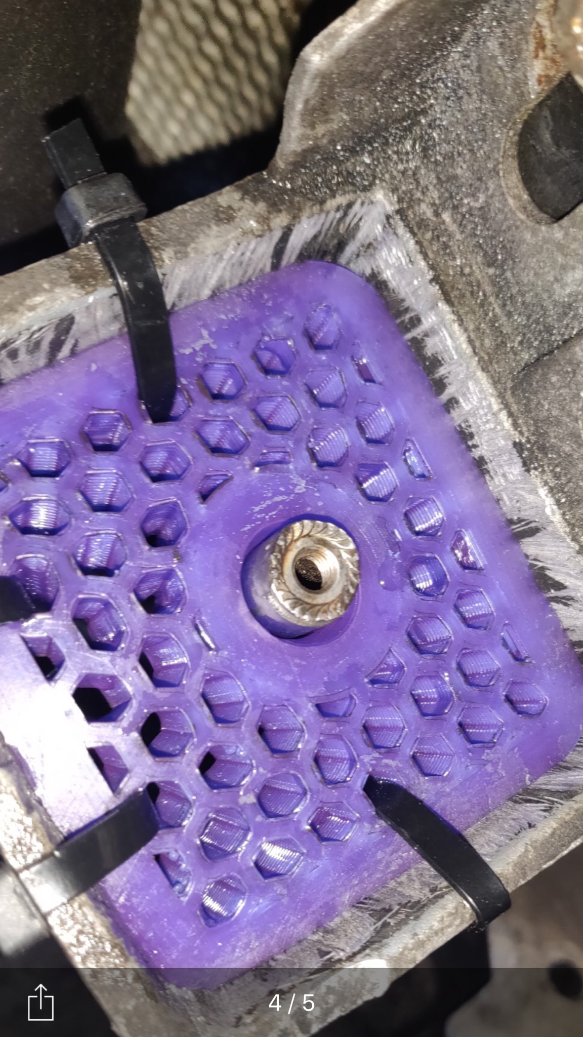

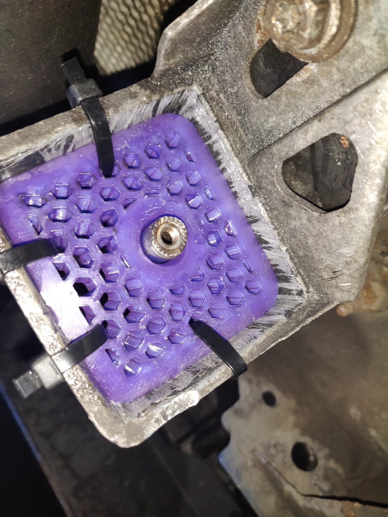

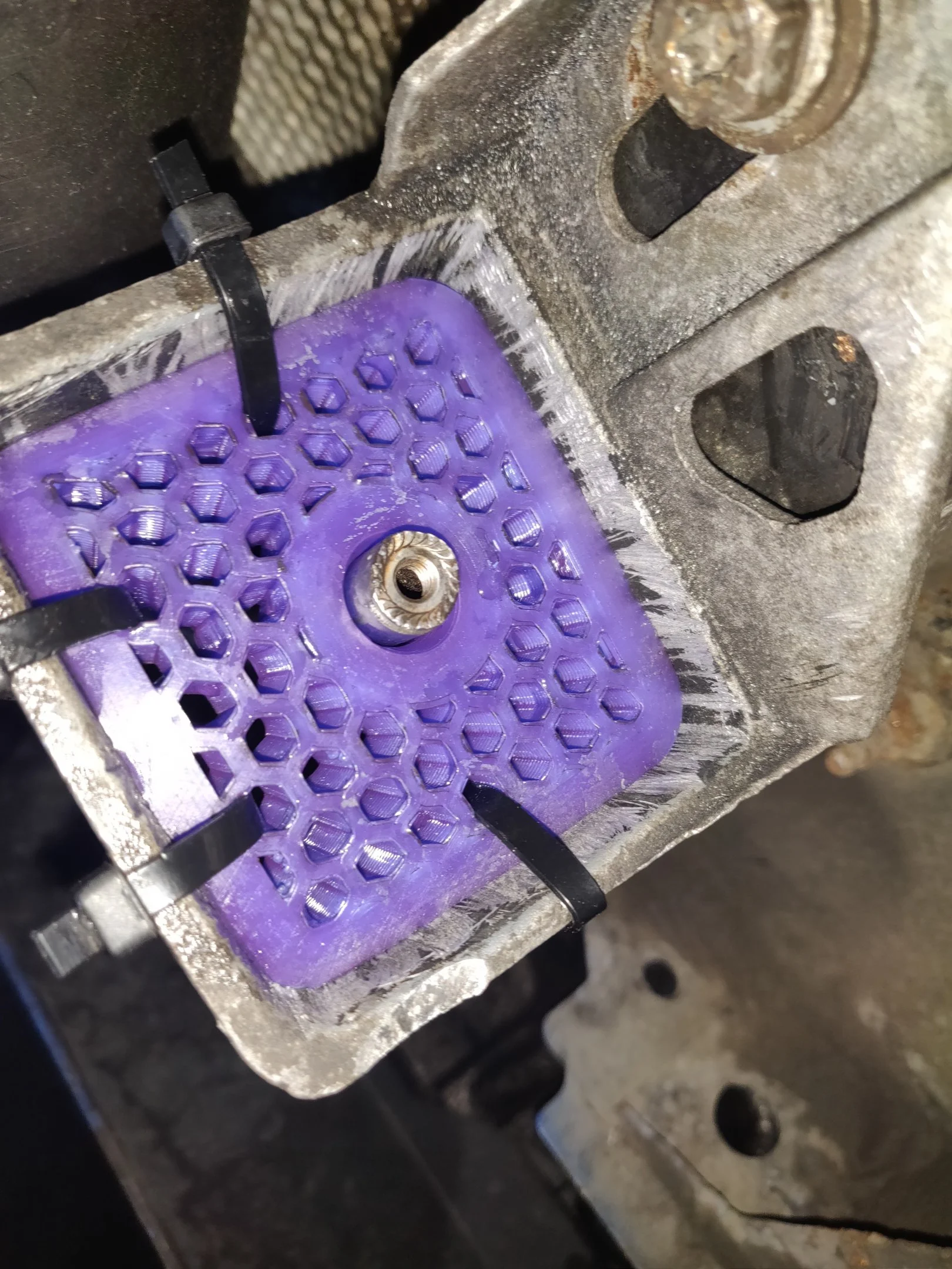

So I'm having a bit of a nightmare with these exhaust hangar inserts and wonder if you've got any thoughts/advice on how to fix? Or at least it might be some use for development.

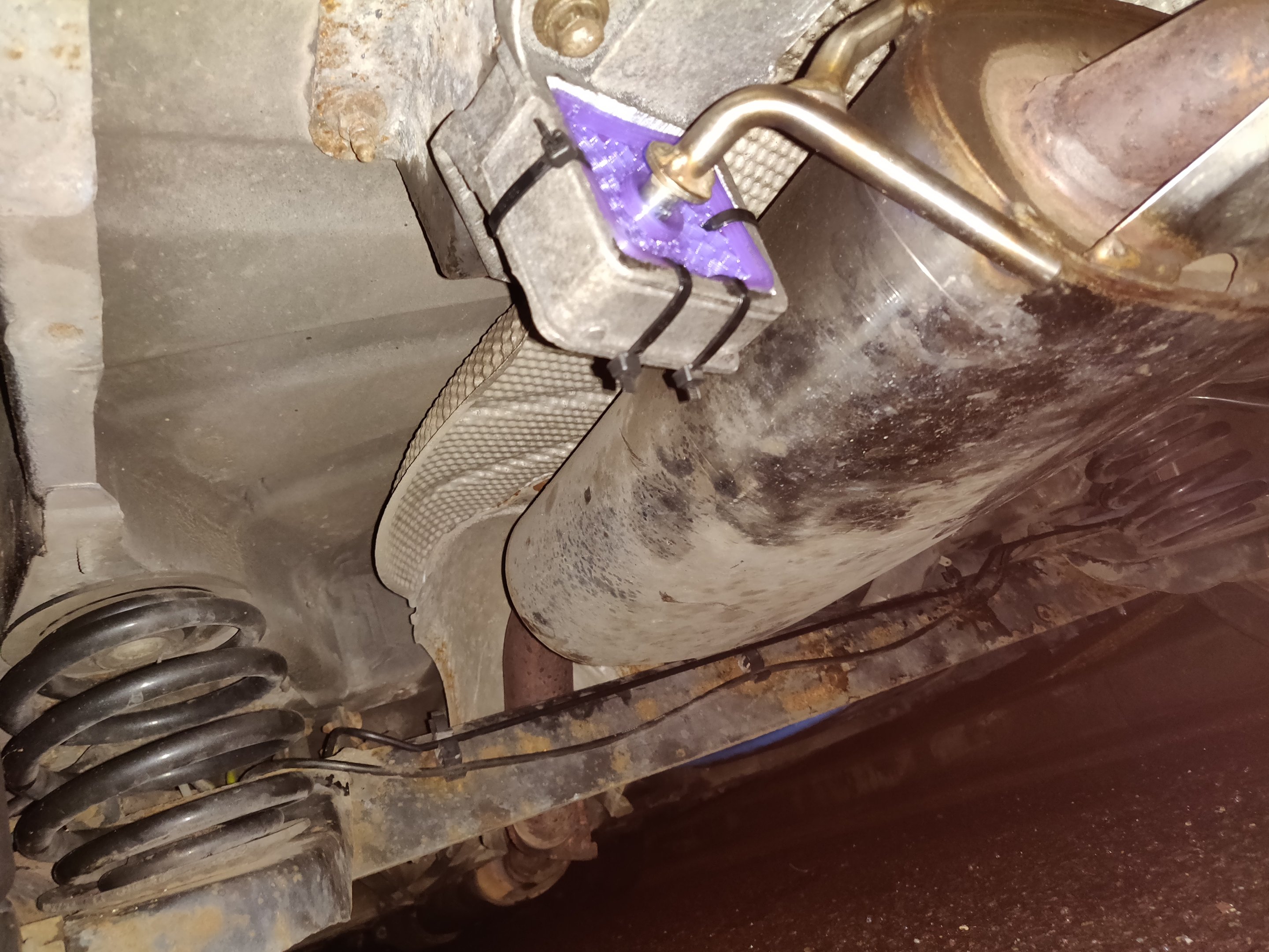

I have 182 Janspeed system. One mount sits in fine (driver's side) the other (passenger side) just will not work.
At first I (luckily) found the insert literally about to fall out and the exhaust support sat just in front of it on the bottom of the hangar. So presumed it had just pressed itself out.
However, after refitting and cable tieing it:
It turns out that actually the exhaust support was jumping out of the hole towards the rear bumper and swinging back into the insert, pushing it out. Unfortunately I forgot to take a photo of it in this position, however you can see it starting to happen again below:
I think from looking at other exhausts, the exhaust support is normally the other way round. (It is on the driver's side of the Janspeed as well which works fine) So the forces towards the rear bumper would push into the insert, rather than pulling out of it.
(this happens within about 3miles)
My last thought is to perhaps pack the hole up with some mild adhesive. Any thoughts before I do so?
Otherwise it's back to rubber mounts and cable tied bolts!

I would think as said above, a large washer and bolt in the end of that mount should stop it sliding out and would probably also stop it being pushed backwards out of the housing too? (although the washer being on the other side might still give it a shove)
Is the centre bore quite tight on the Janspeed hangers? I made them oval to accomodate for different sized hangers but if they're on the large size a bit of grease in the hole will help too.

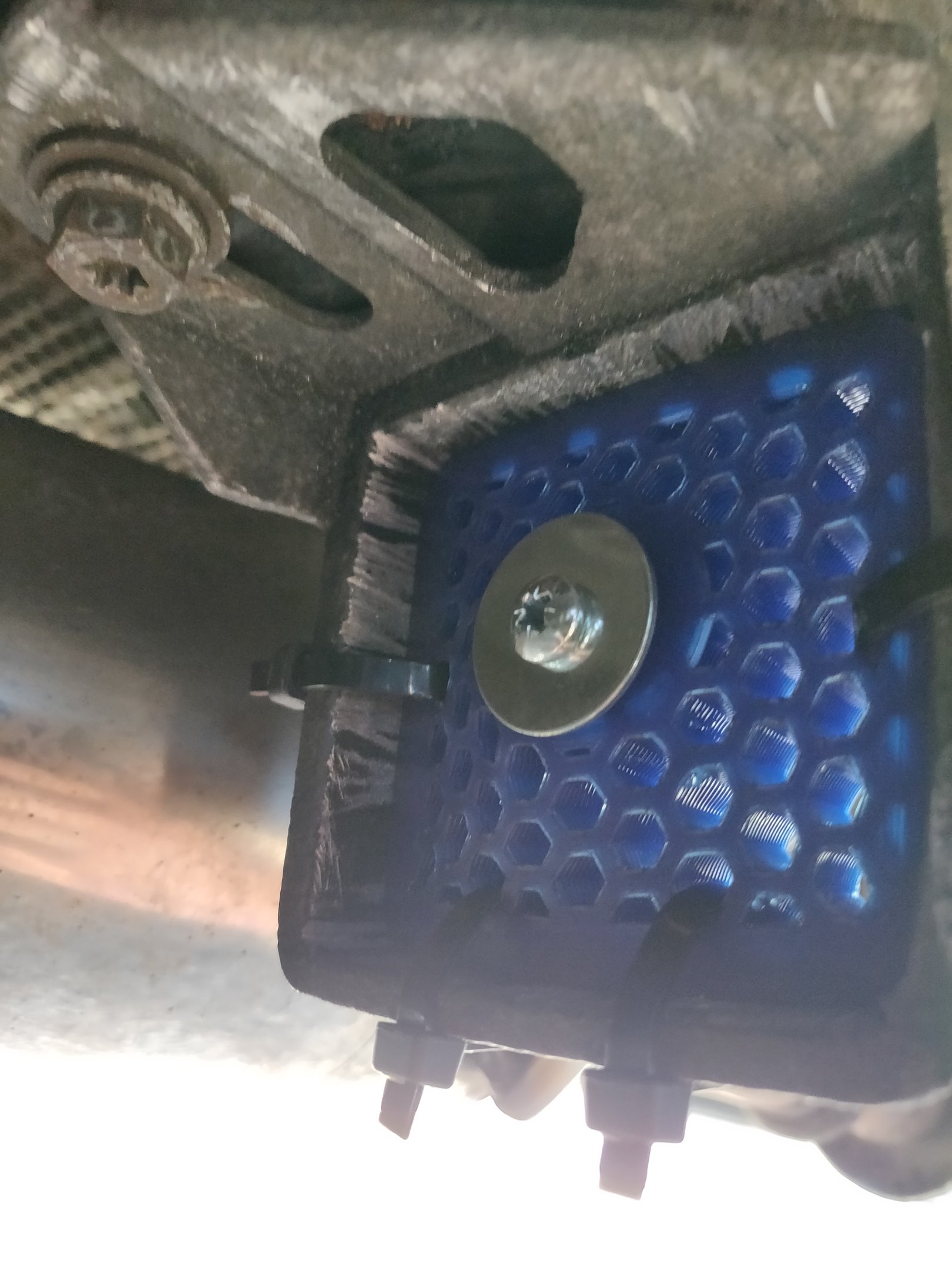

Well so far so good (10miles)!! Fantastic suggestion. M5 bolt with a penny washer. I'm not sure it actually needs the cable ties as the press fit tapers that way (i.e. with the force) so would probably stay, but not gonna risk testing it without.
Despite it looking quite obvious on that photo, I never actually noticed the thread in the exhaust hanger when lying under the car in the dark.
ERM, in terms of the centre bore, it's snug but slides on with a gentle pull (with or without a bit of water to help it). About what I'd expect tbh without comparing to other exhausts.
Will report back after my trip up North at the weekend if this is a permanent fix.

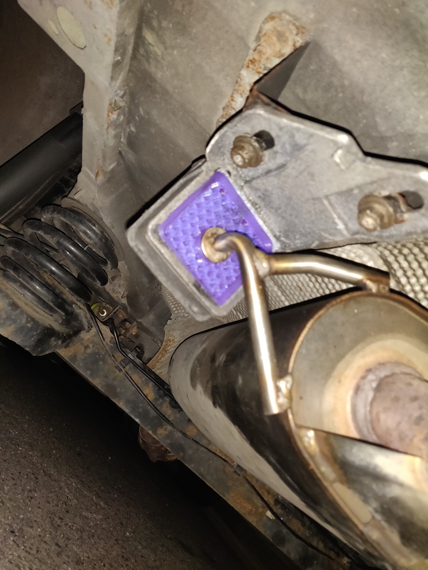

No suggestions for improvement, but i've had two fitted to a 182 Milltek system. Firm push fit in the holes and now done several what are "12 cars" (bit like road rally) with a good bit of throwing around and they are still in there like new. I did fit four cable ties, but this seems more to have my own piece of mind rather than actually needed.
  182FF - Land Rover
Great,thanks for posting a bit of feedback, much appreciated - happy with the NVH levels?
I had Vibratech eng+gbox mounts already, but these don't give much NVH like some others claim. Fitting these exhaust mounts gave me no real noticeable increase that I could detect from the back (I do have full interior fitted). Very happy with them from the worn out standard ones with some old heater hose "fillers" tied in, so should be ideal for a stock feel IMO.

@SWL16 Everything okay after the road trip?
Yep! All looking good mate after ~ 400 miles. @dCi_rep you deserve a pint!
The washer has pulled very tight onto the insert (as expected) but all held together with no issues!
Noise and vibration levels seem good - better than cable tied bolts anyway! Enjoying my exhaust sound again. Really happy with the inserts now, so will write up a review at some point.
