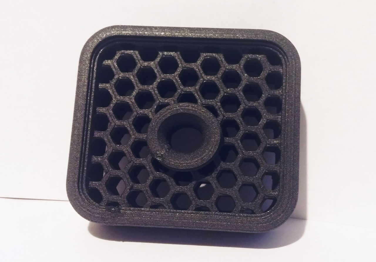

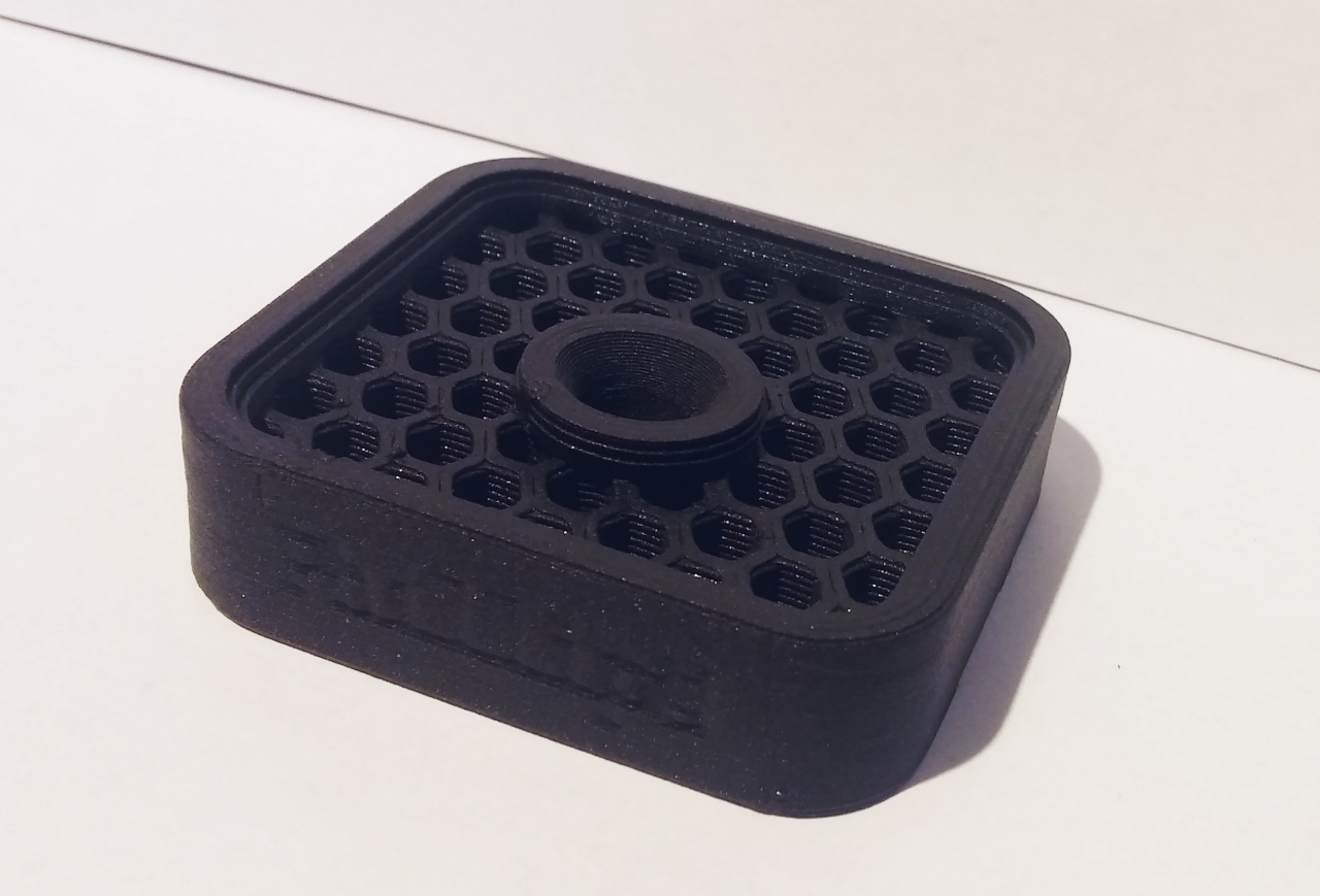

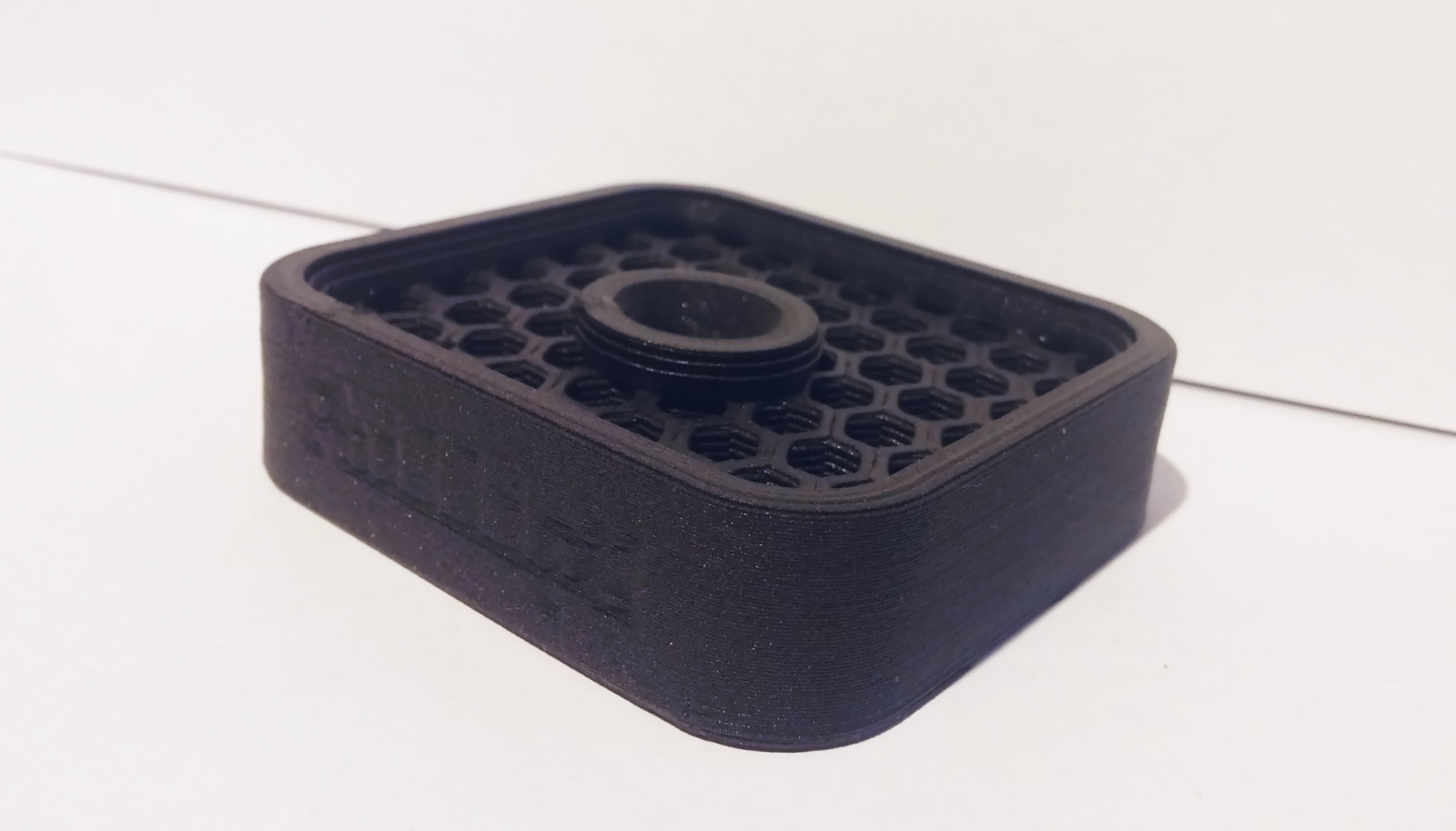

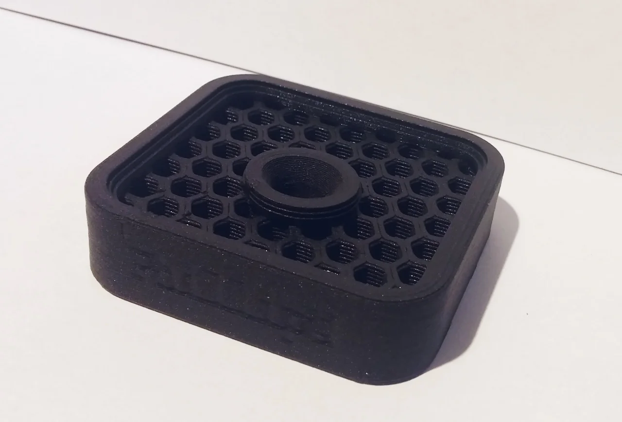

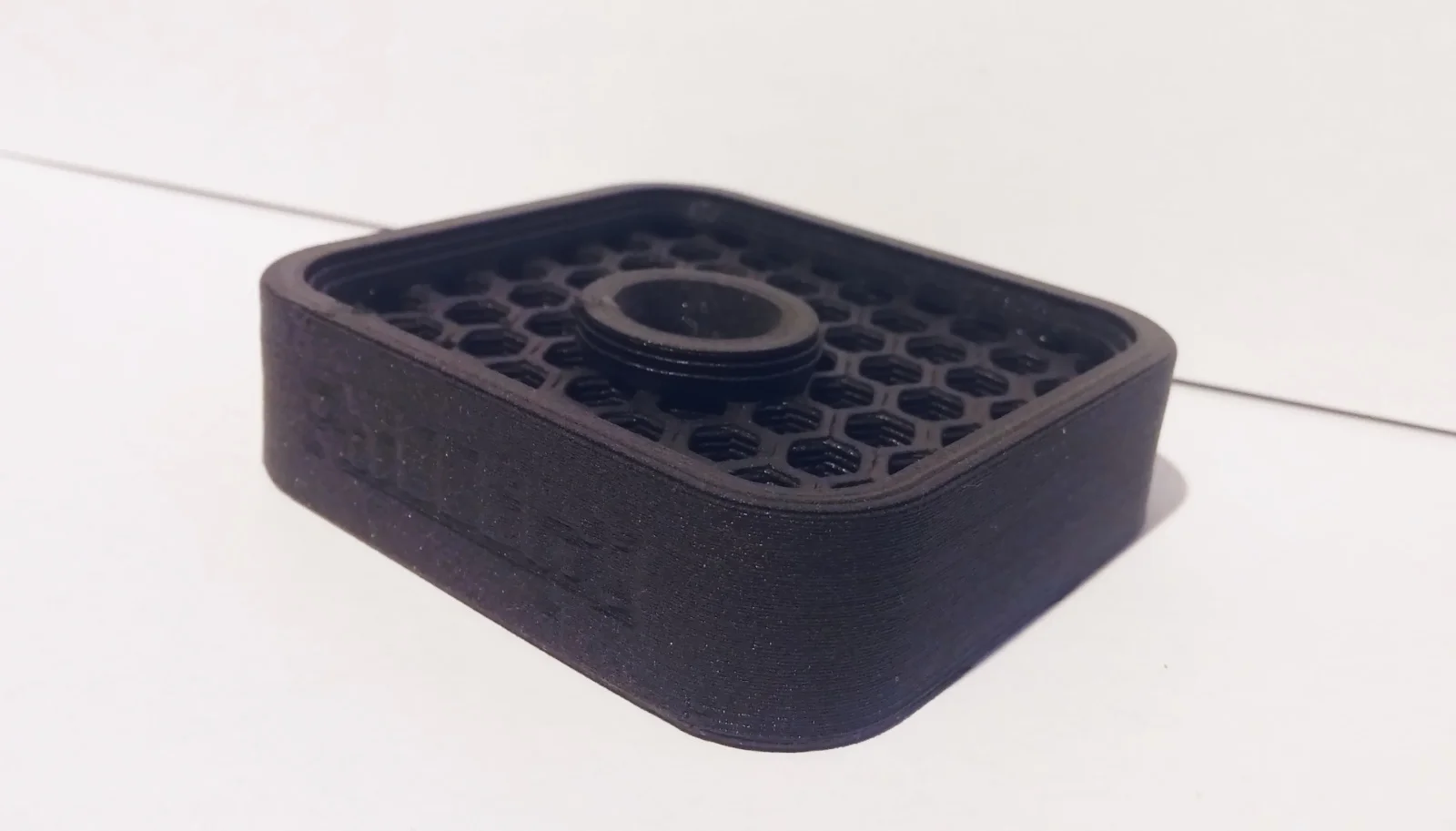

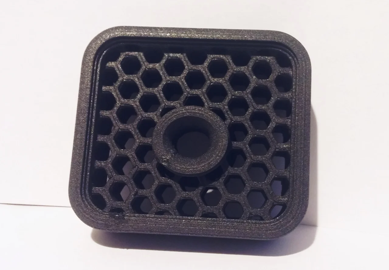

Small update, mounts will be available in a new material/resin shortly, it's microfoamed internally much like polyurethane bumpstops (or high end dashboard plastics with the soft touch surfaces) - which means the mounts now have more internal damping so I can lower the spring rate a little more for even less NVH, and it's been compensated for by foaming the outer surfaces of the mount more to increase the initial preload for both mount retention and exhaust location - and as a bonus, because of it they feel like those high quality soft touch dashboards I mentioned, not that it makes much difference when fitted but they feel pretty high quality when you take 'em outta the box :LOL:

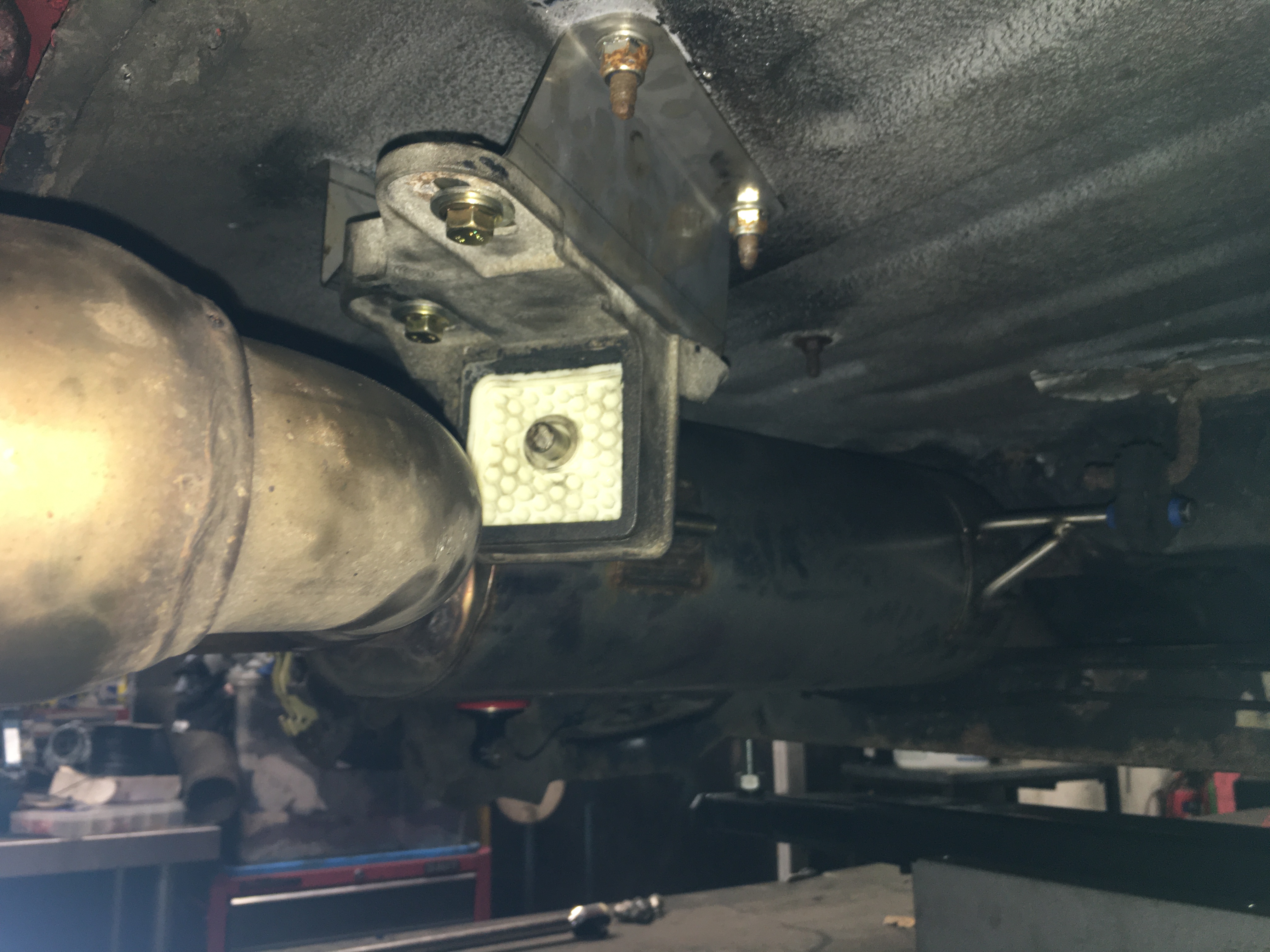

No use for me now i have the PMS system with PMS mounts. But these were noticeably better than the solid offerings from other manufacturers.
Much reduced NVH transferring to the boot floor, but still supporting the exhaust properly.
Good product :)

And I can report that the new prototype took my car abuse without any issues! Was a doddle to fit with a light tap
