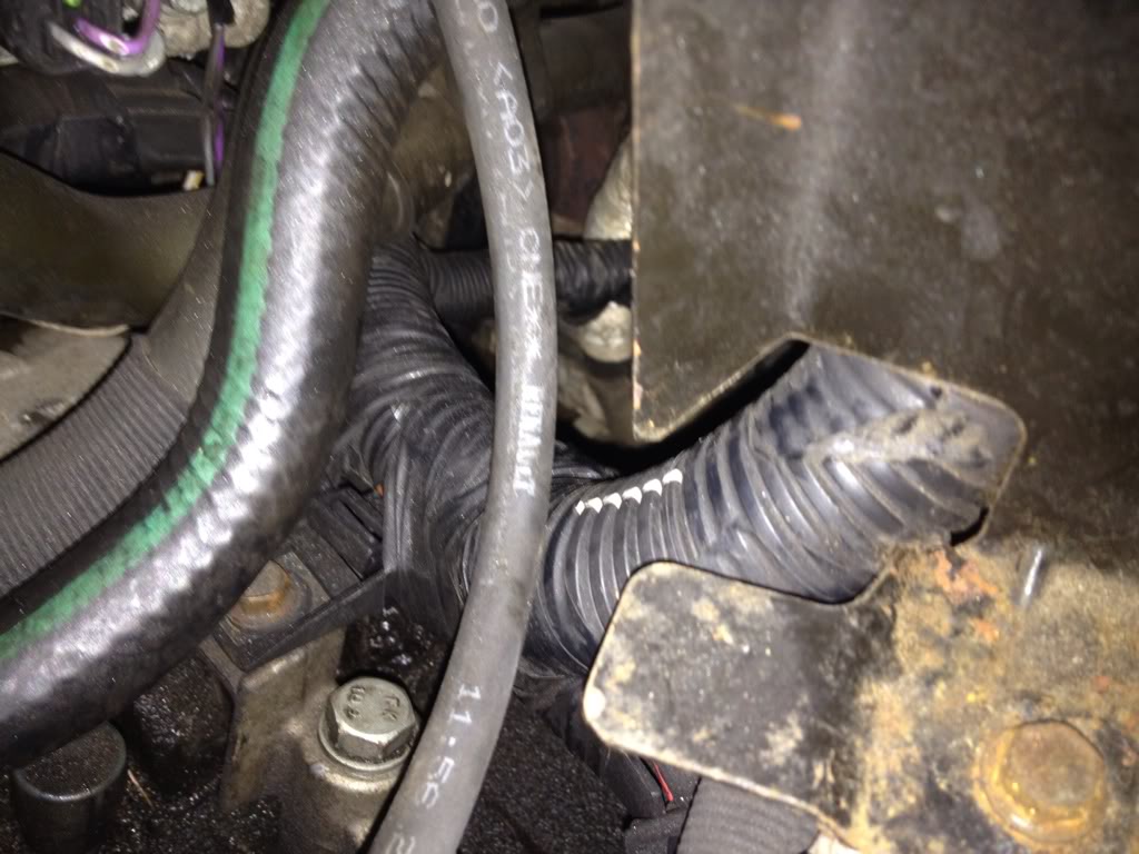

just found this on mine, looks like the ecu case has been rubbing through the armoured sleeve in the ecu wiring!! or not till I have a proper look

yeah that seems a very common fault. someone had been nice enough to f**k that casing off mine before i bought the car. good luck sorting it out. i now know what a pain finding that fault is
