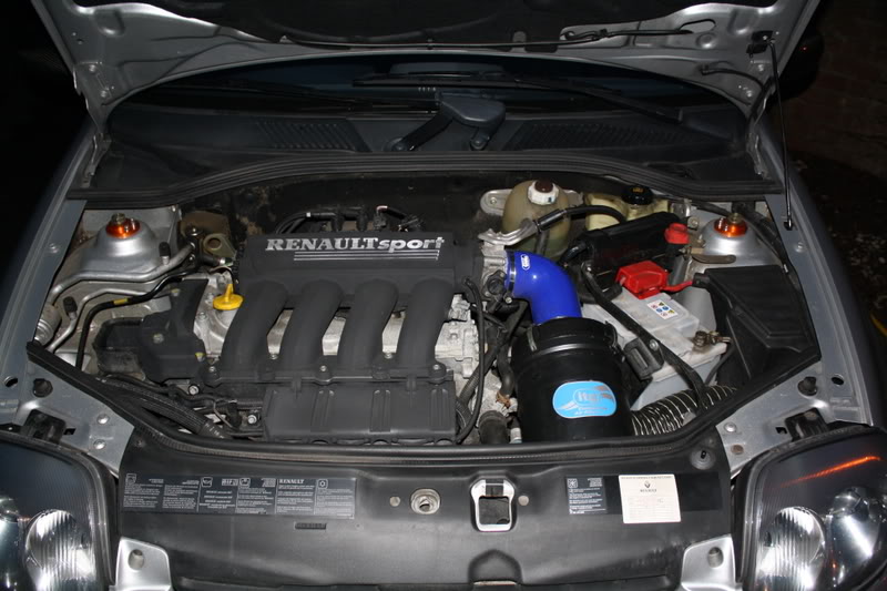

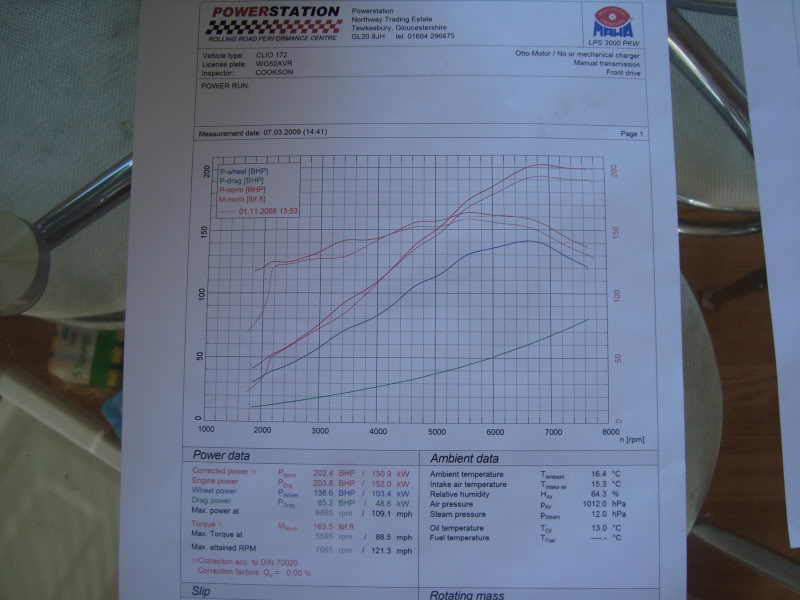

No power loss mate! Gained 10 bhp and 5 1/2 ft/lb over my old bmc cda with the espace v6 airbox and 105mm cold air feed. (i have battery relocated to boot and 45 degree elbow)

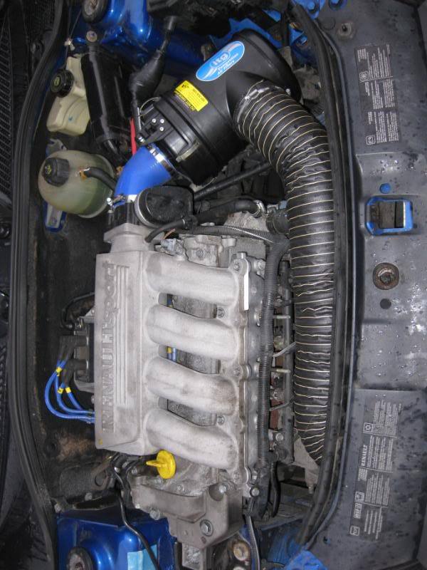

Heres my setup:
This is the rolling road data comparing the bmc cda vs the V6 airbox itg filter and 105mm caf.

im with quade on this one, definaltly extra noise but i also gained power from it over the pipercross viper. assuming the matched inlets gave me 10bhp, the v6 airbox and samco 90' bend gave me 8bhp

Heres my list of mods:
Prospeed Exhaust
Prospeed Decat
V6 airbox
ITG panel filter
105 mm cold air feed
45 degree inlet elbow
Headtune.co.uk ported throttle body
Angelworks matched inlets
PTFE inlet manifold gasket
PTFE plenum to inlet gasket
Magnecor Ignition leads
AWT/ RS Tuning remap (not the rs tuner)
Ran on tescos 99 fuel.
Hope that helps!:approve:
