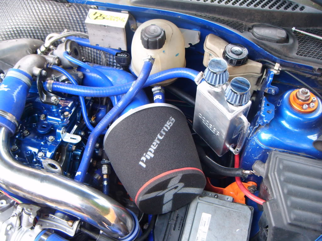

That's an impressive engine bay! As that looks a lot different than mine I'm unsure what the catch tank is?
The catch tank is the square box with the two breathers to the top right of the pic. The problem with only a breather filter is that they can blind over with oil and block and then the engine has no breather and so can pop seals. You would need to change the filter regularly but if you had an issue it could go any time.
​Cch tanks are a very easy mod to install as you can see from mine.
