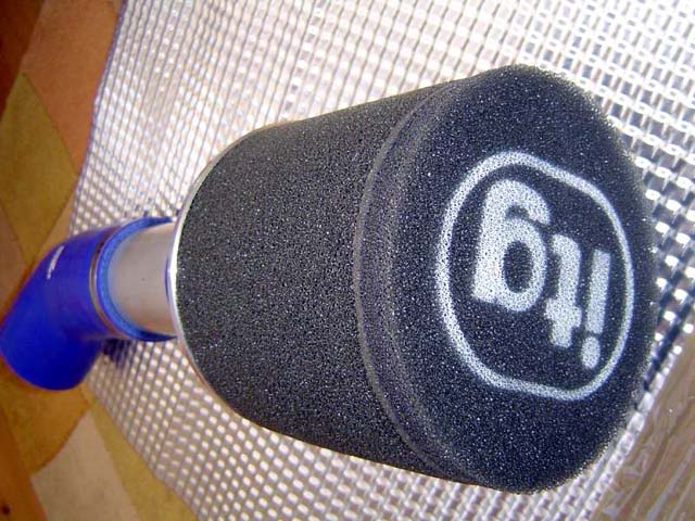

could you use something like the above picture but use bends and pipe to lower an open filter behind the bumper, further away from the engine?
  VaVa
I believe the K&N Typhoon does something similar. Not entirely sure how effective it is, but there's a lot of kinks and bends disturbing the flow of air on its way into the engine.
Ben will tell you whether that's a good thing or not. lol.
Typically well sized piping that is the same size of the TB OD is more than sufficient, bends so long as they are made well, also do not really affect things.
The typhoon doesnt look like too bad a solution, would like to try one.

Nick Hill questioned why the intake of the ITG Maxogen trumpet was smaller than the TB OD.....
Speaking of which, I need to sort a cold air feed out for mine.
The efficiency of a hole is greatly affected by the design of the lead in and taper behind. Typically following the shape of a venturi with a showllow taper downstream and a bell mouth radii entry.
With a hole, flow is all about reducing any pressure differential across the hole. A bare pipe cut end flows less because air is trying to enter at a greater velocity from the sides and pinches the middle of the pipes flow, effectively reducing the size of the hole by 40% or so.
You should see what the FIA GT cars run in terms of restrictor holes, some are as small as 28-32mm and they still pelt out stupid HP, but the hole has no common factors to a 'hole' apart from the fact that a cork bung will fit in both orifaces.
In the maxogen case, the OD isnt a big factor since the actual butterfly OD is substantially smaller, with a taper lead in and a big fat thick rim.
