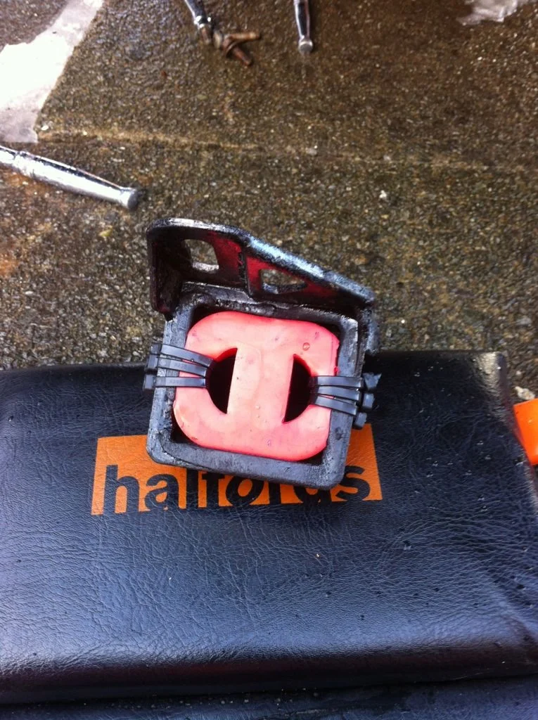

Fitted this at the weekend makes the exhaust sit a lot nicer and also doesn't bang under hard cornering. Also uprated the Centre mount

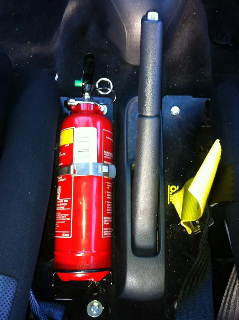

Fitted my fire extinguisher as well. Its bolted down and wont be going any where. I was going to put it in front of the passenger seat but it looks like this gap was made for it to go there ha ha. Gary and i from gok garage serviced moved the passenger seat over to the left abit more so that when on track i don't hit the passenger worked out quiet well now :)

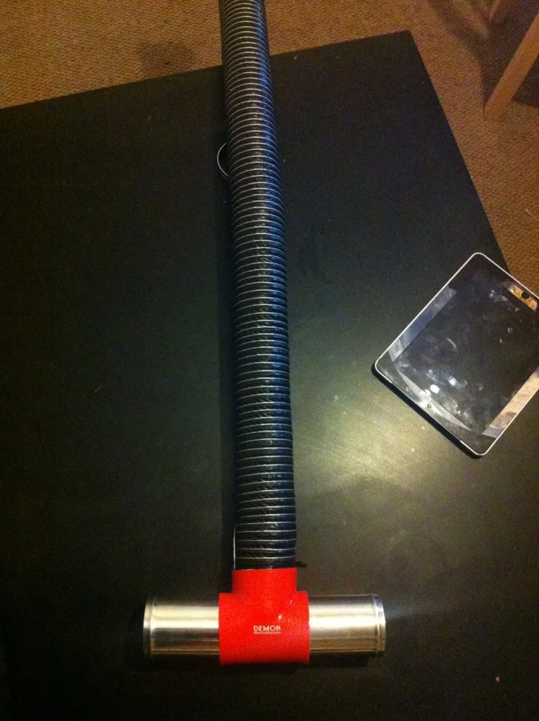

I wanted a better cold air feed so decided im going to cut my brake vent on the passenger side in half and put this in place so i still have the use of my brake vent but also get a decent air feed ,will post piccys when its fitted

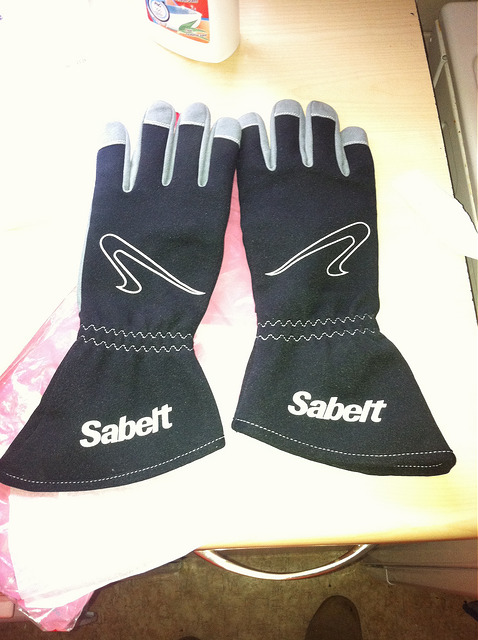

also got my new gloves today after ruining my last pair of mountin bike gloves i had used, not bad for £20 posted :D

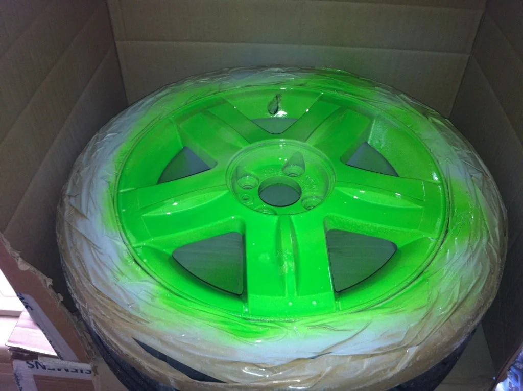

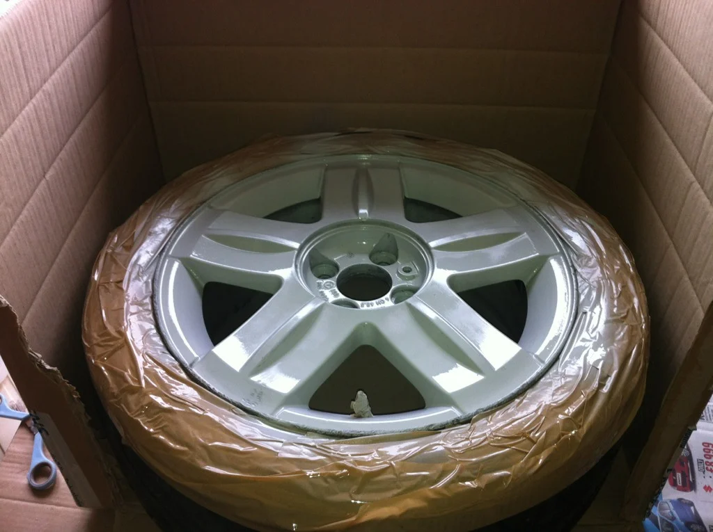

Still not sure on the colour , im getting stickers made up for it in green so iv bought green wheel paint but also got black paint aswell. :-/
IMG_2043 by MSPhotographic, on Flickr
Where were the gloves from as I need a pair?

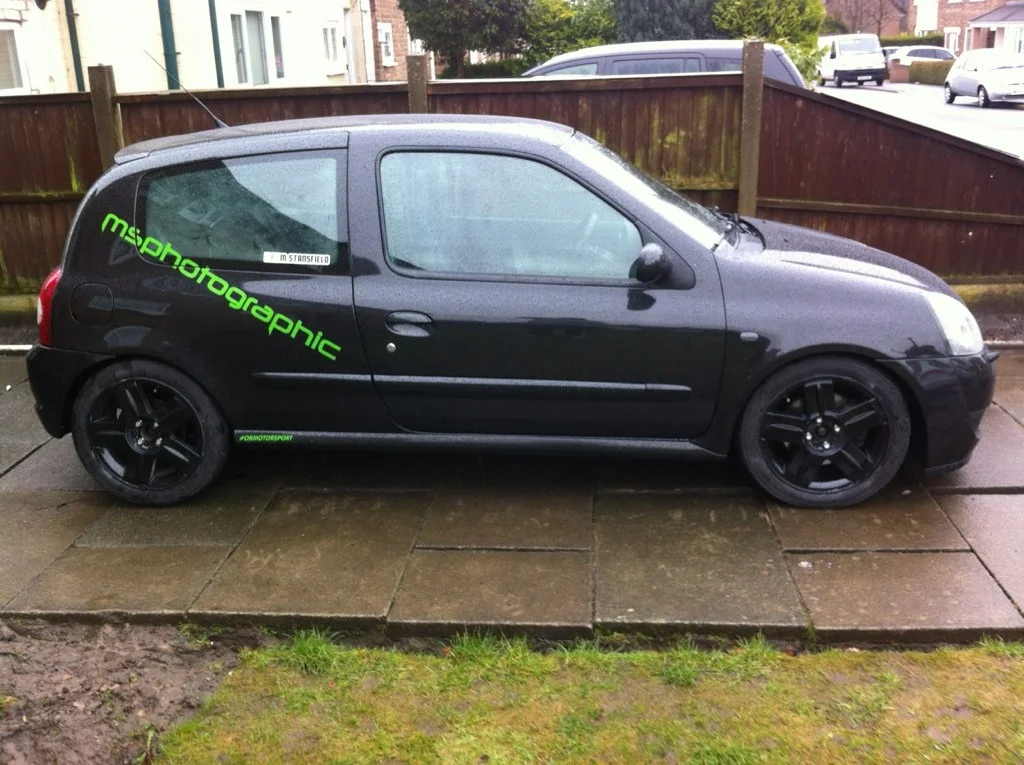

Well it started like this at the start of the weekend
And finished like this
Small name stickers where just put on for a laugh

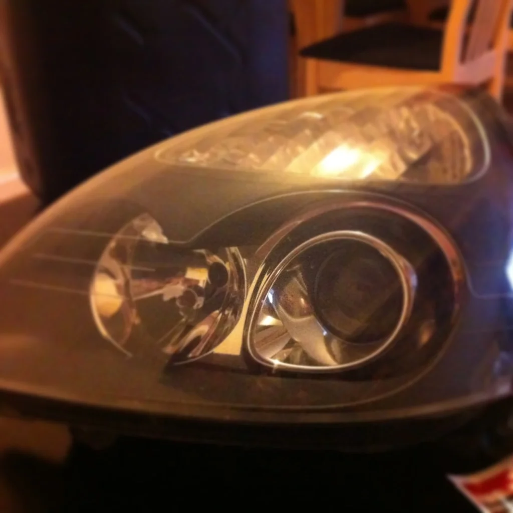

Broke my headlight the other day so bought one of a lad on here gave it a quick refurb :)

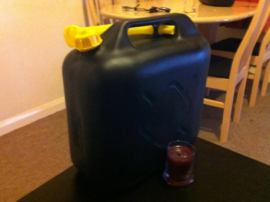

Jerry can for track days

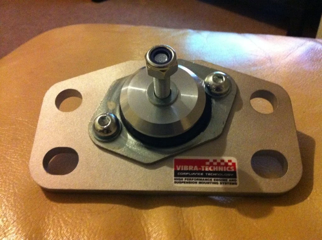

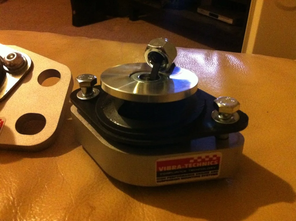

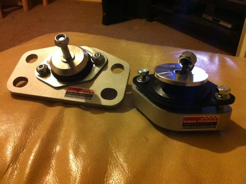

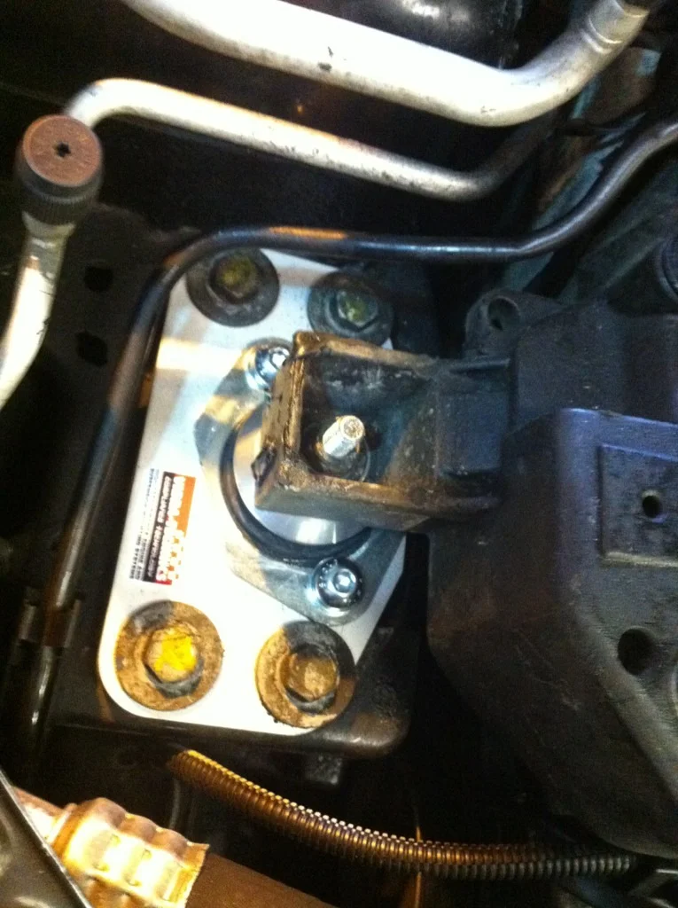

After that i went and got my new vibra technic mounts fitted
Made up with them no more knocking and very very little vibration so made up

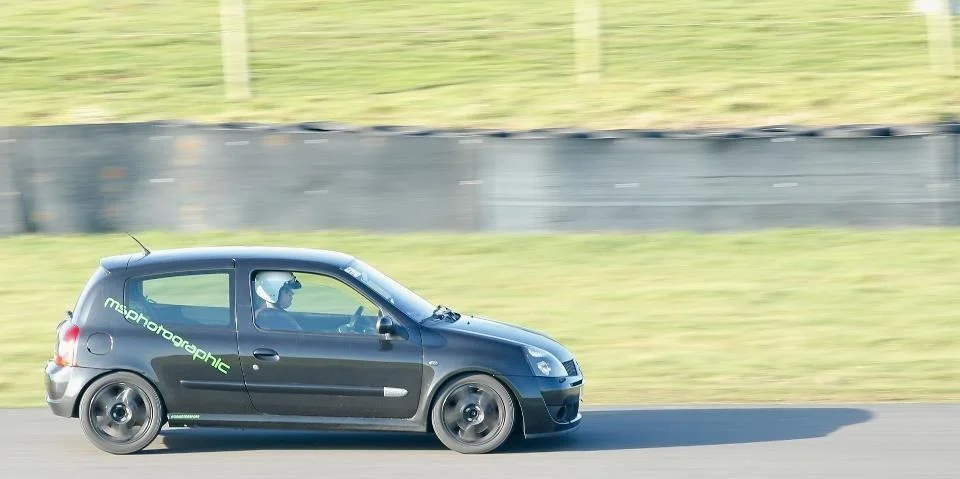

Well this weekend is one iv been working towards for ages ,trying to get the car ready. On the friday it didnt look like id be able to go due to the car playing up but luckily the engjne management light stayed off. We arrived jn Anglesey on saturday night and started to prep our selfs for the day ahead of us in the only way we thought best
Om nom nom
Sunday morning came and we set of to track. Now the last time i was on track my car was totally standard so i needed to learn the learn again ,well i was shocked. The car was amazing. Out braking everything. Out turning. Yer it may not have the straight line speed to bully evos ect but in the twisty i was all over them, i went past so many cars thst i thought id come nowhere near. My dad and step mum came down and tuck some piccys of us. Il upload them in a bit. The car performed great with no faults bar tyre scrubbing on the front which i think is mainly due to the a048s being a 50 profile. Maybe i should go to a 15 for track im not to sure yet. I did how ever ruin one tyre by locking up once thru out the day which was a shame , so need to look into getting some new ones.

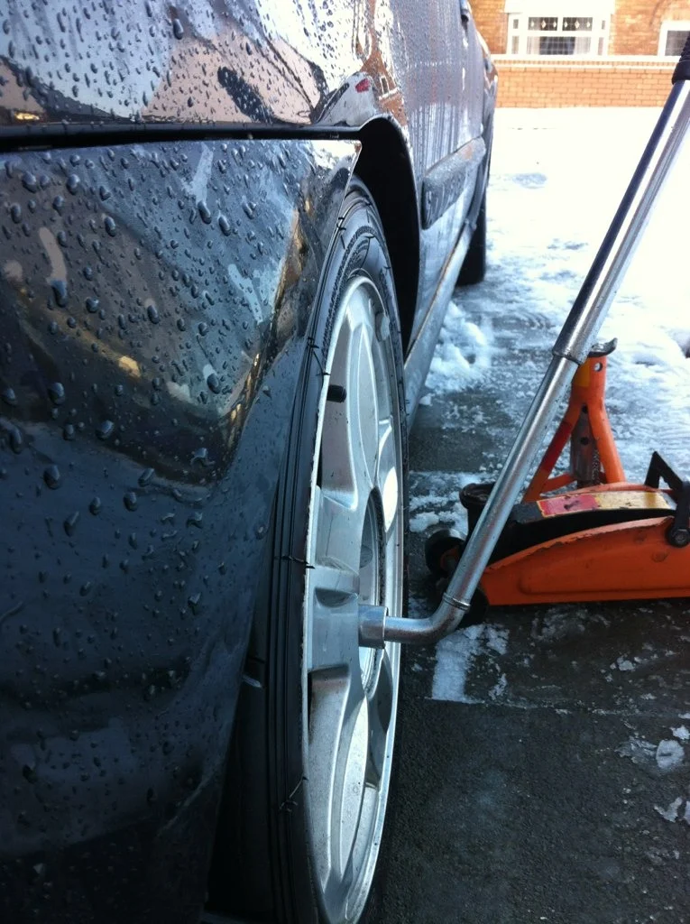

Heres a quick video from the weekend the screeching noise is tyres scrubbing i forgot my spanners to raise the front up doh

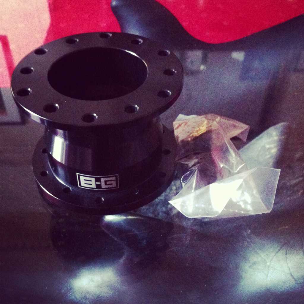

Got my 60mm wheel spacer as well

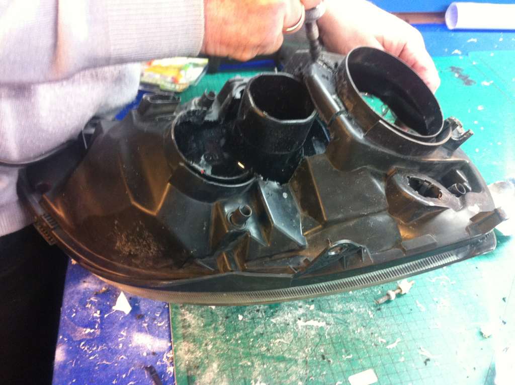

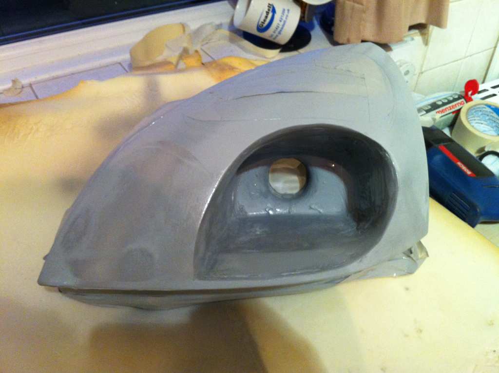

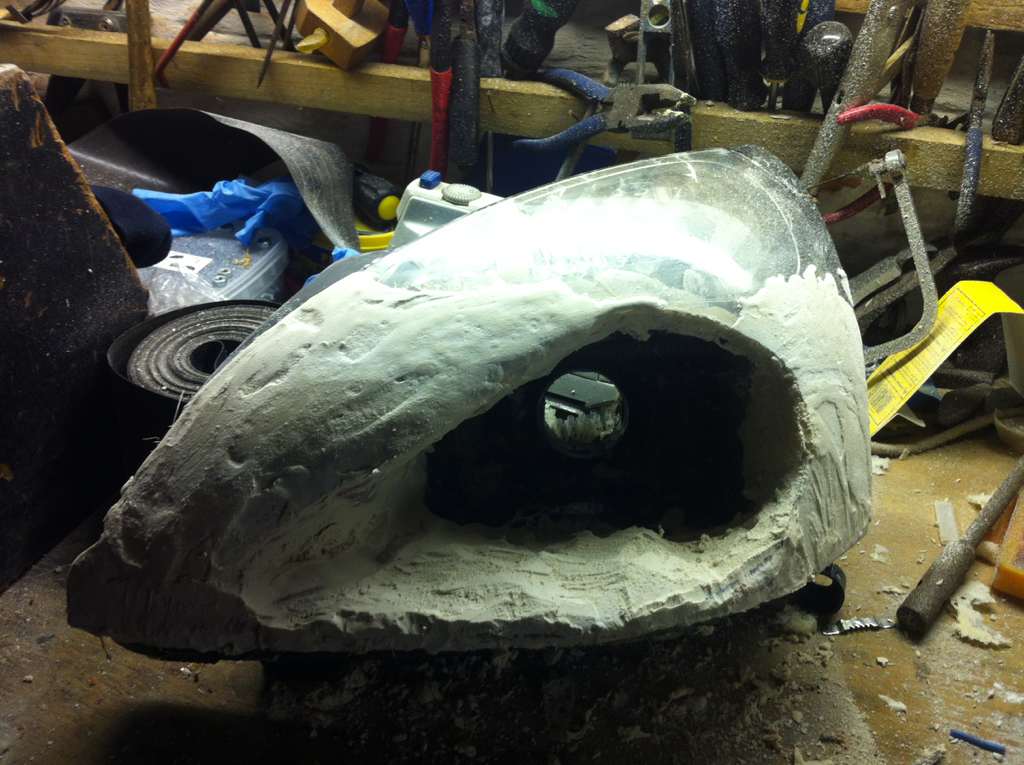

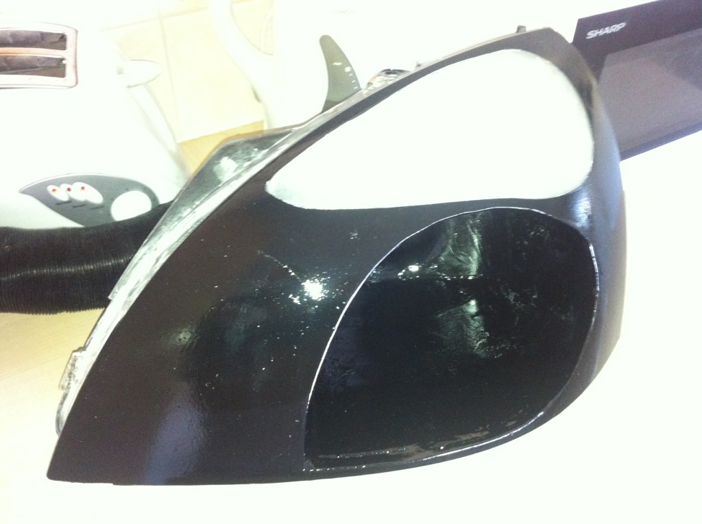

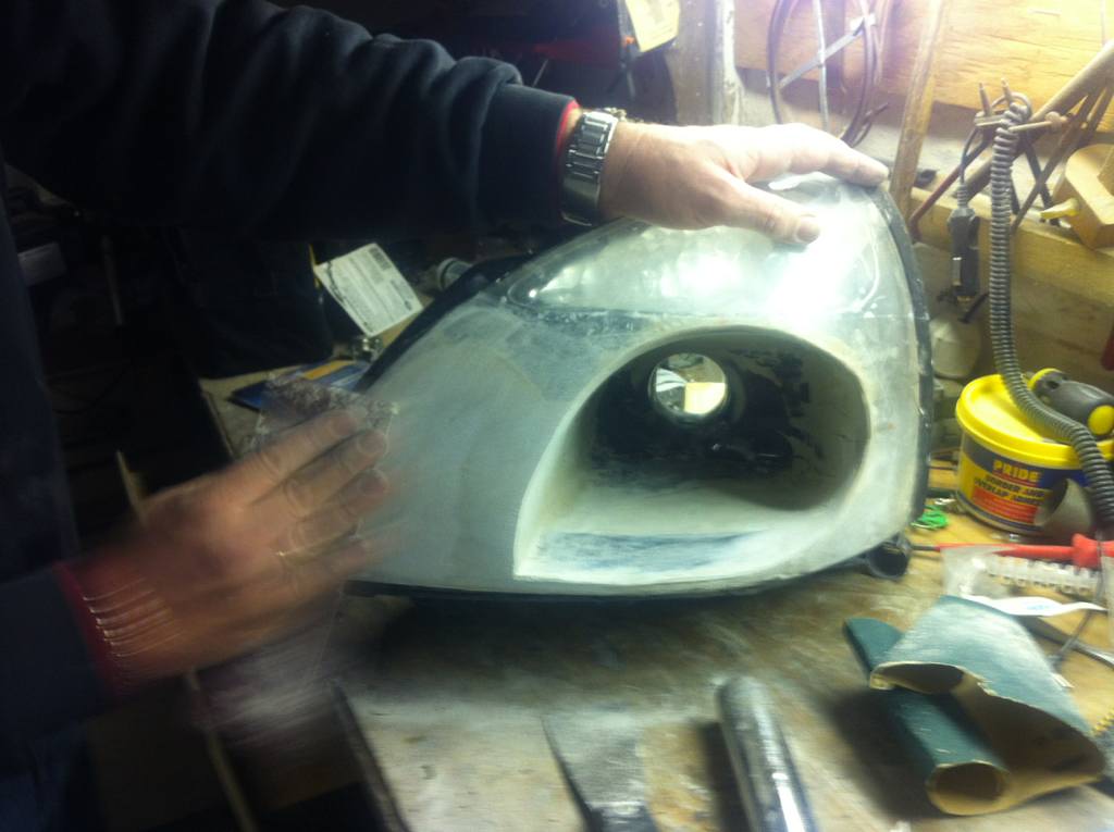

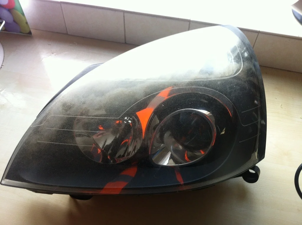

My dad and i are making a cold air feed headlight from my old faulty head light. Its far from finished. The filler i used today is the wrong stuff some i tuck if all of and we are starting again
Hes the piccy of it with the crap filler un finished
Heres the rear

Haha. I have to sit nearly all the way back so need it abit closer. Got it fitted to and it feels great. Can not drive it on the road atm as iv got a flat spot on my rear a048 so need some road wheels.

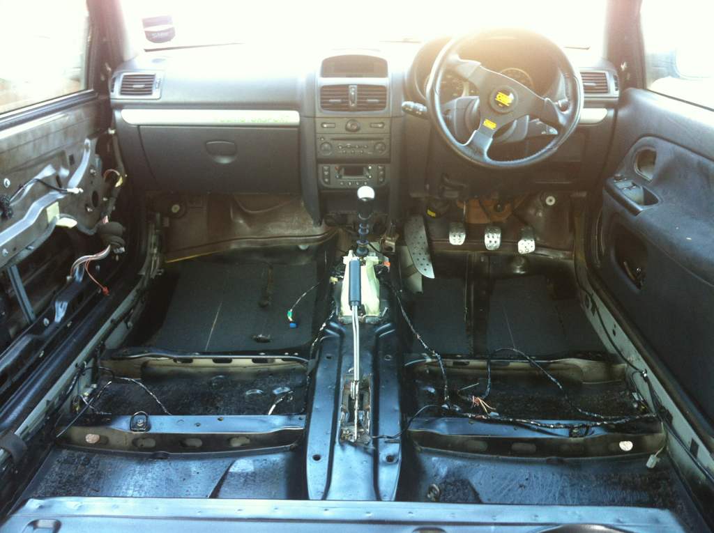

Also started taking all the carpets ect out and door cards ,

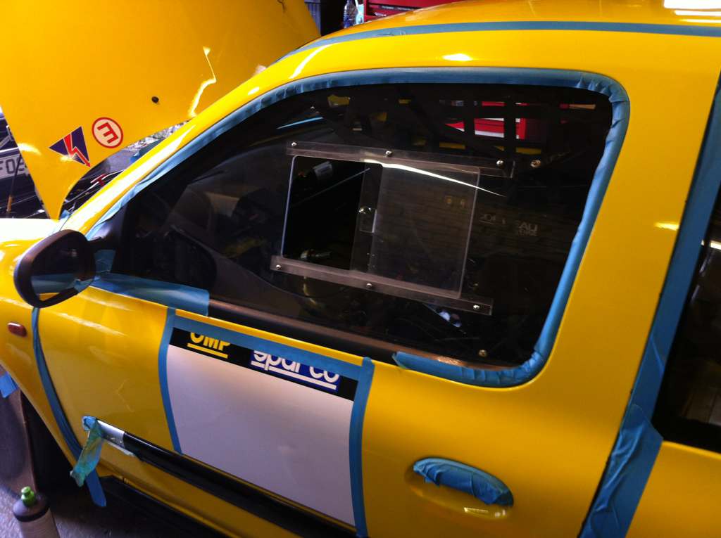

Aiming to get them somthing like my mate adams clio cup race car

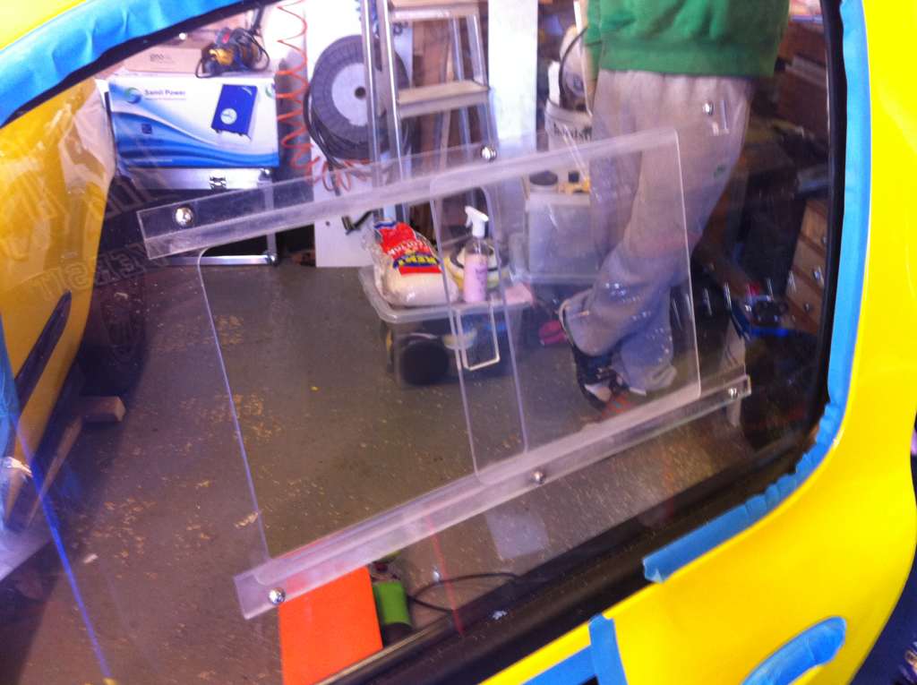

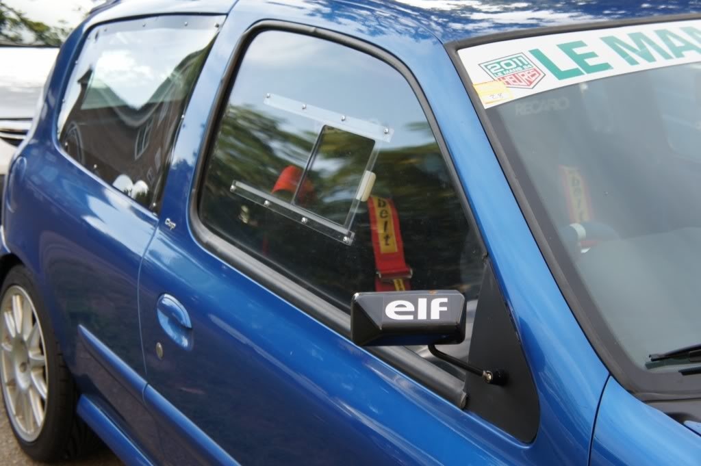

Im also looking into poly windows il be getting the fronts made up asap but need to find a rear one
Here are adams

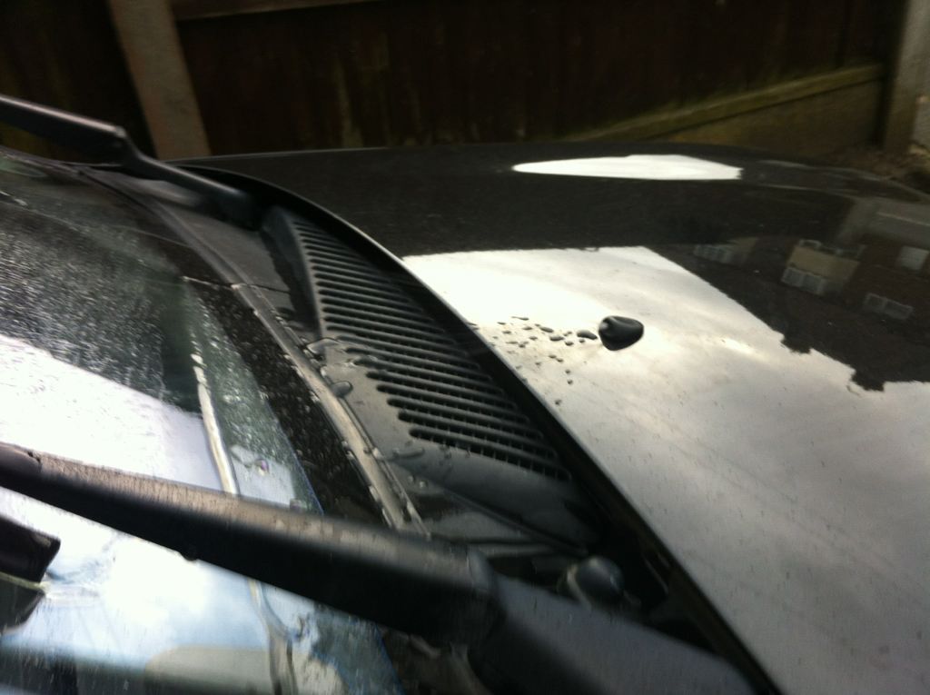

Fitted my new washer jets today ,loads better than standard

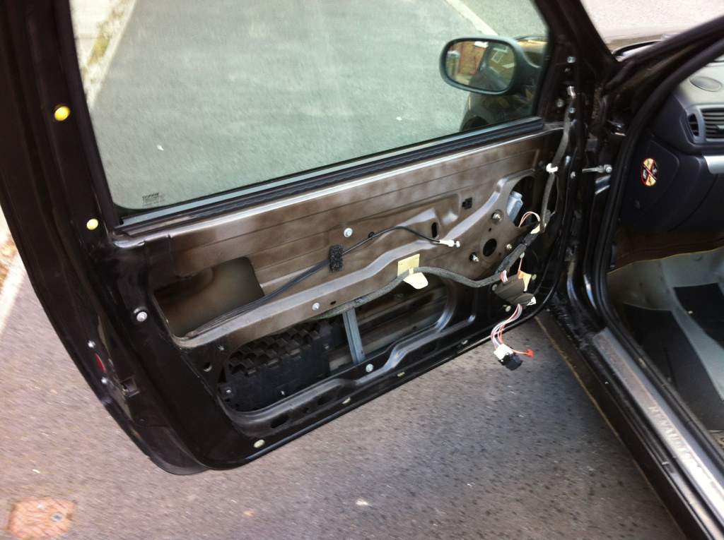

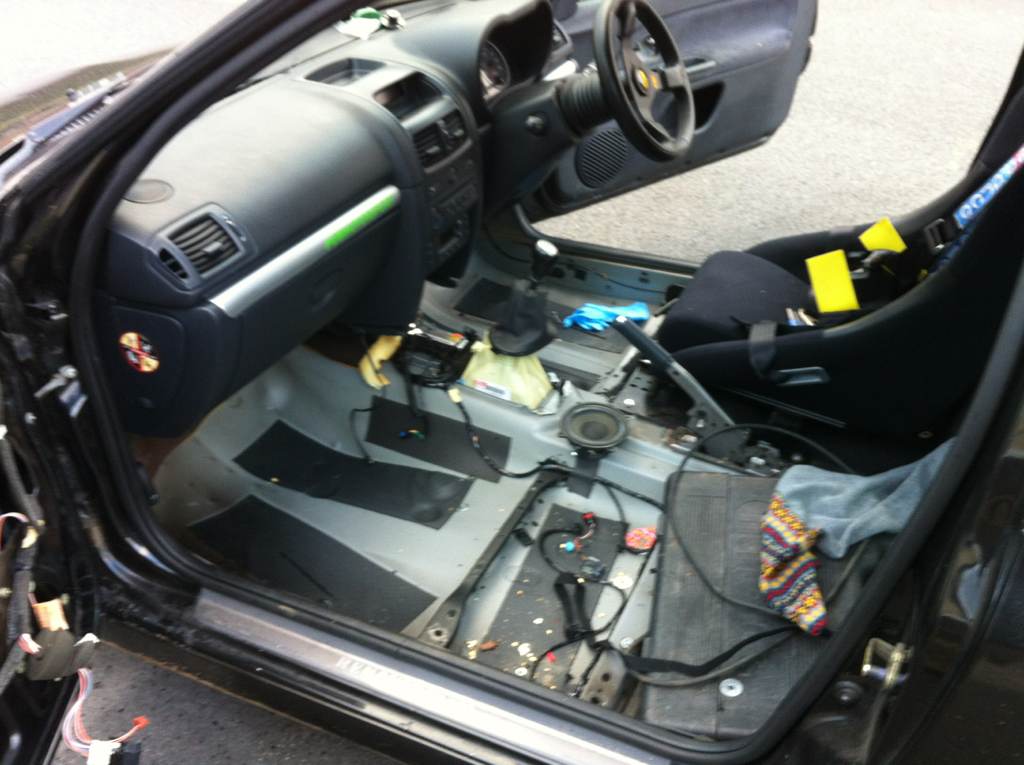

Started to take out all excess weight inc sound deadening
Only got the passenger site done for now
My headlight cold air feed is coming on nice now
Letting the primer set then its going gloss black
  clio 172

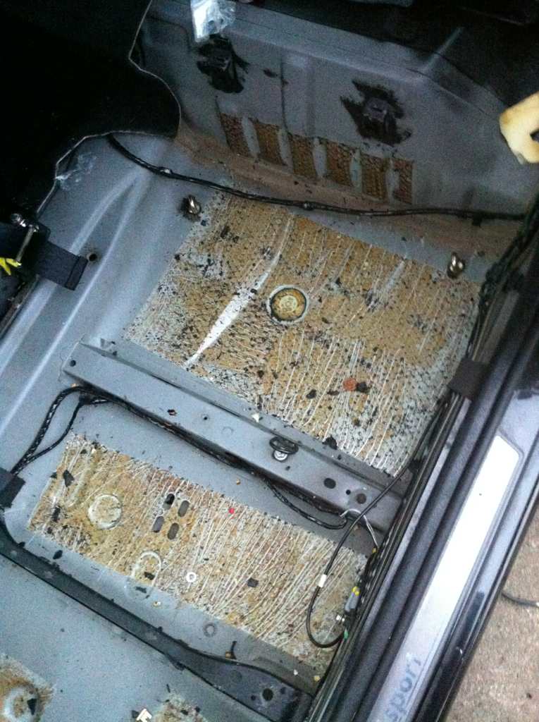

Removed most the sound deadening and also fitted my grip tape

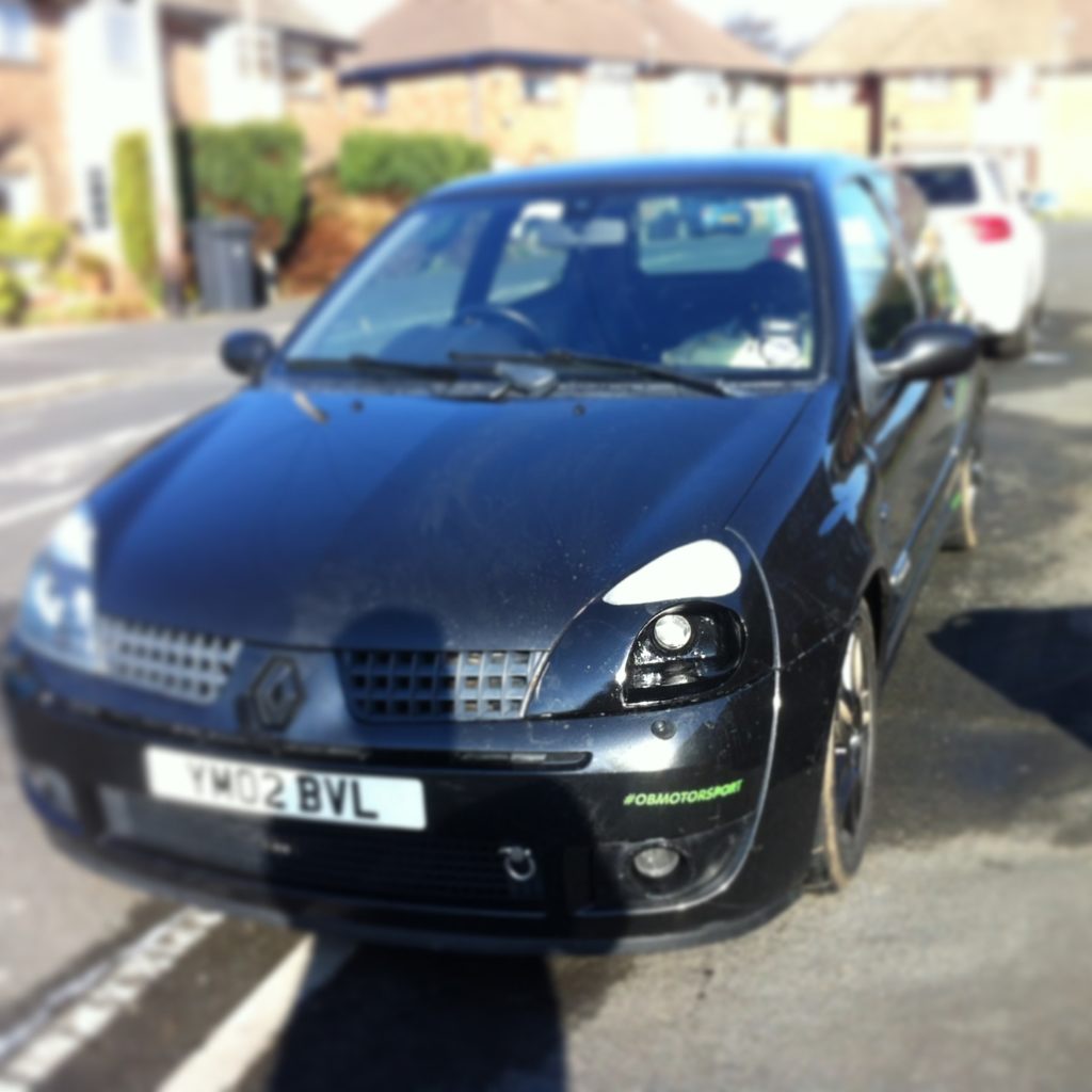

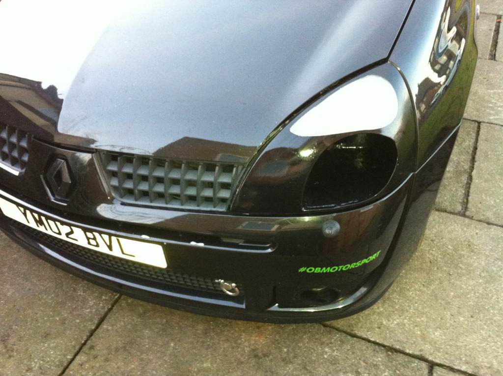

Finished my headlight intake. Gave it a trail fit aswell

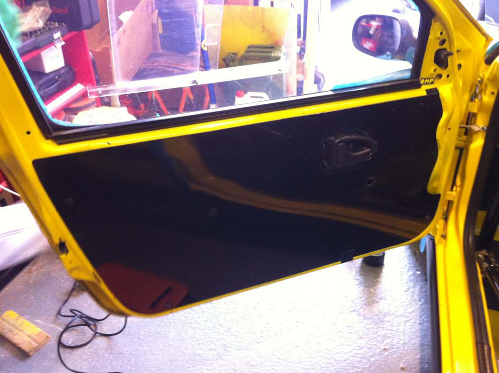

Picking up some foamex board in a couple of nights so
I can start to Make my door cards,

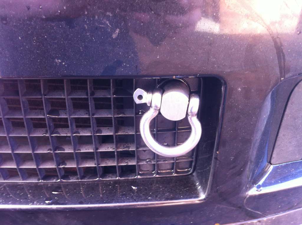

Iv also ordered a new towing eye in black so mine will be up for sale soon
New one
Old one thats prob going to be for sale
