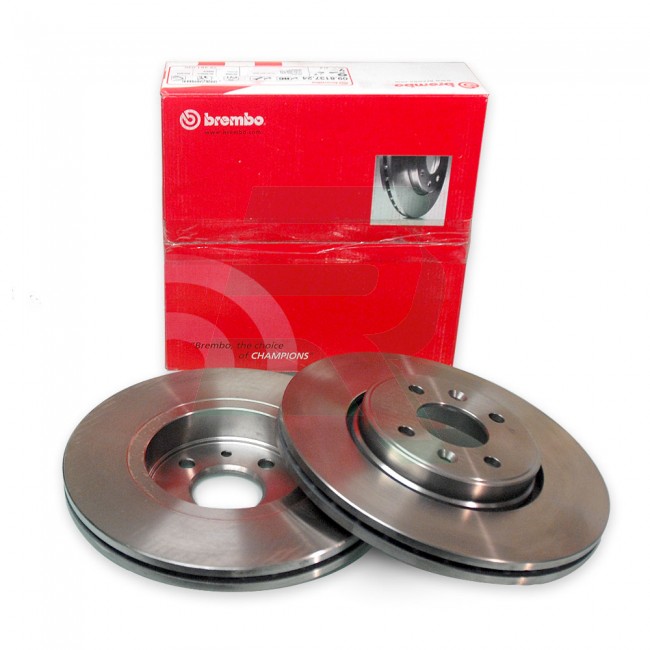

First up is the usual 300mm Brembo. These are just plain ordinary HC discs.

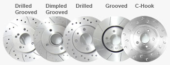

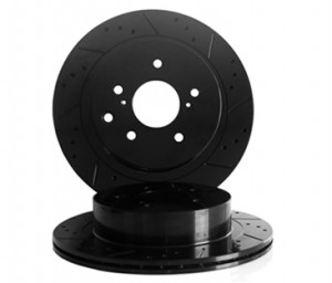

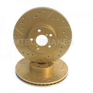

Second option are discs from Mtecbrakes
You cant get these as plain discs and they only come in the styles below. You can also get the discs coated too which im quite interested in.

Go for the Brembo. If you want grooves get a local engineering company to machine them for you. The last ones I had done were £50 cash.
Would not recommend this.
If you put the grooves in the wrong place it can weaken the disc.
They have to sit in between the vent vains, and aren't they usually a curve rather than straight?
Same goes for drilling them.
I would agree with the drilling, but as for grooves I'm not so convinced, they are only deep enough so when they disappear the disk is as minimum thickness. The ones I've had done in the past have proved to have no issues.
The number of disks available with curved groove on straight vane, straight groove on curved vane and J hooks on both types I don't see a major issue - but that's my take on it.
