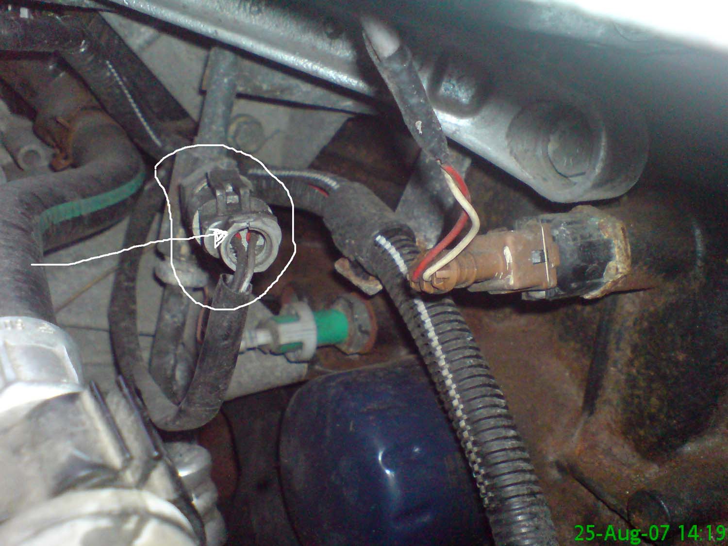

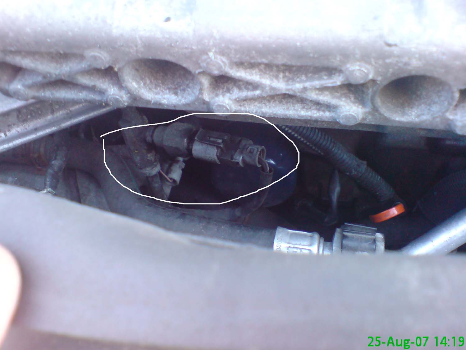

Went to check the oil today, found this plug disconnected and tucked behind the alternator loom.
Ive refitted it, but was wondering what it was..
Anyone.?
Aircon pipe.?
Power steering pipe.?

Power steering pressure switch, its usually used to pick the idle up when you load the power steering on idle. But for some reason it doesn't on the 1*2, so i'm not entirely sure what its there for tbh.
