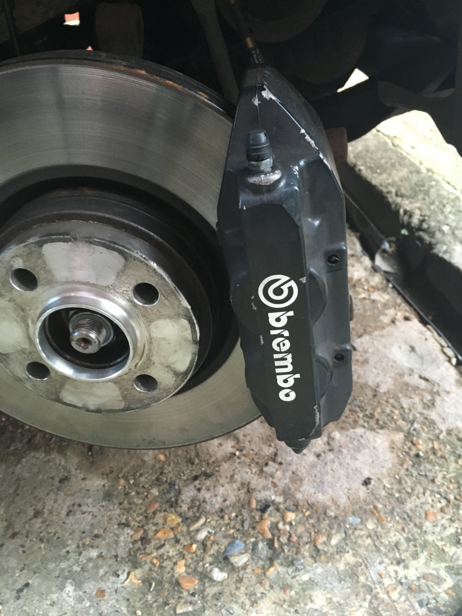

Spacers+brembos so you can guide the wheel on easier. And this was taken a while ago 😞
