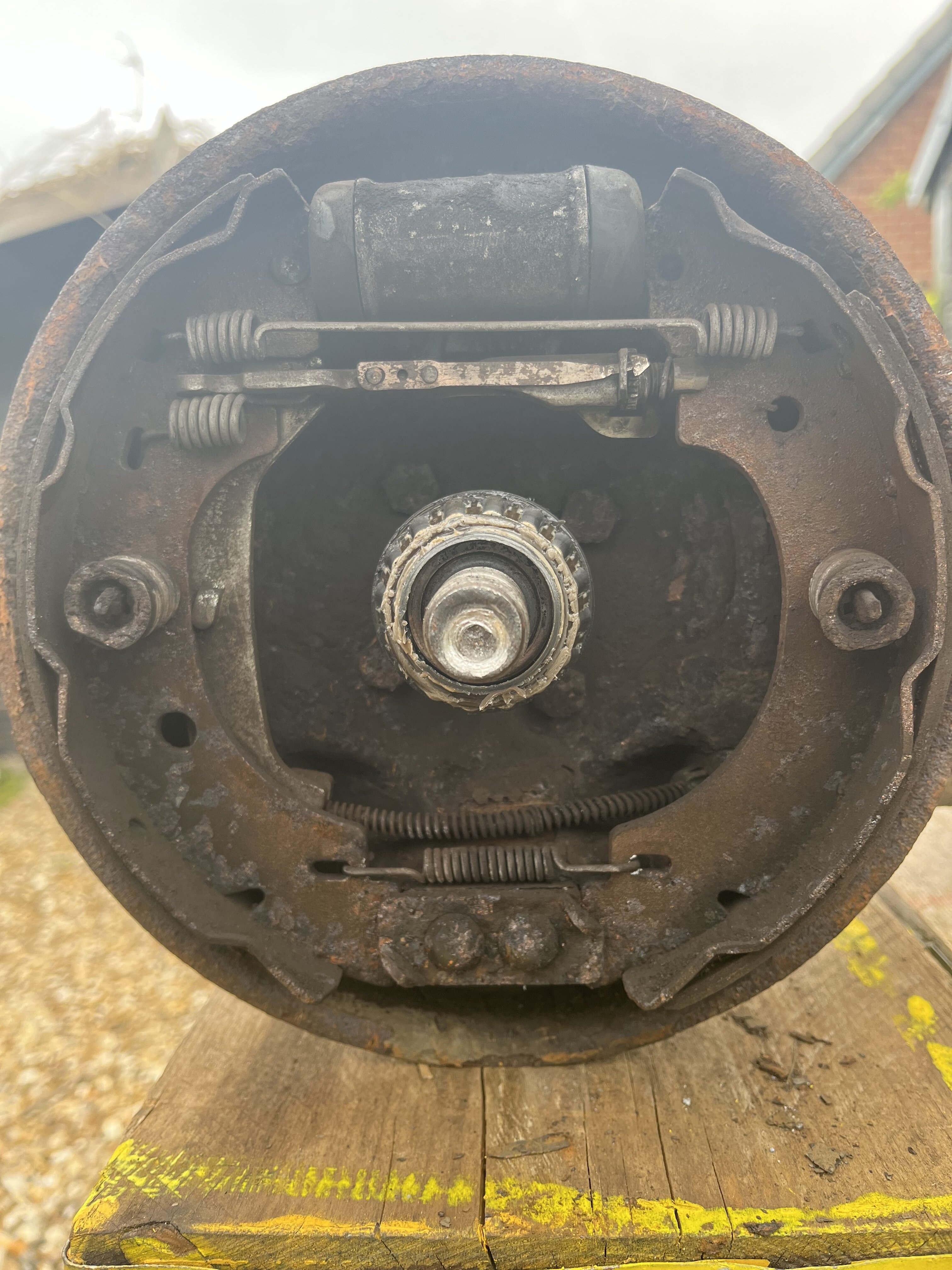

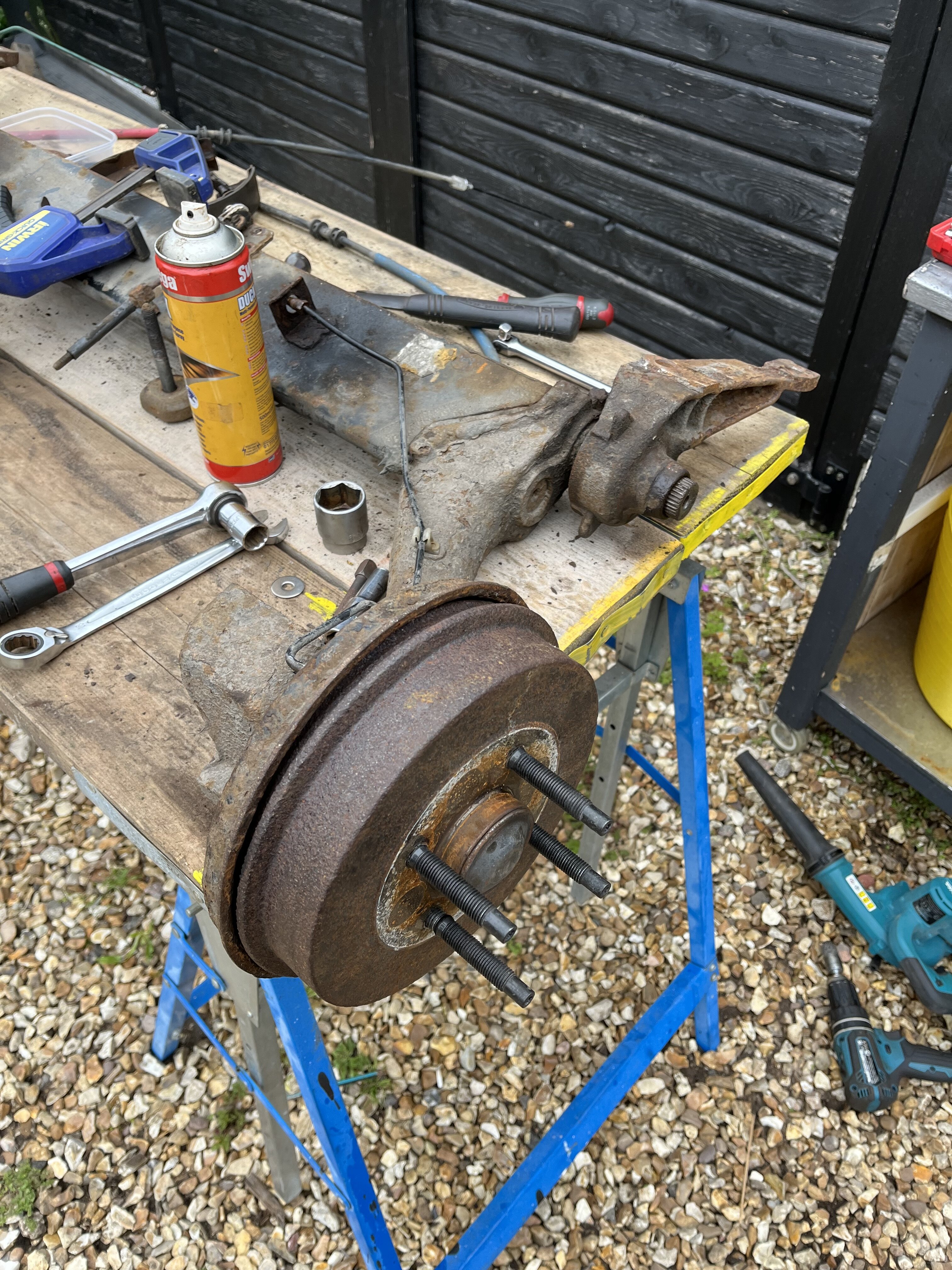

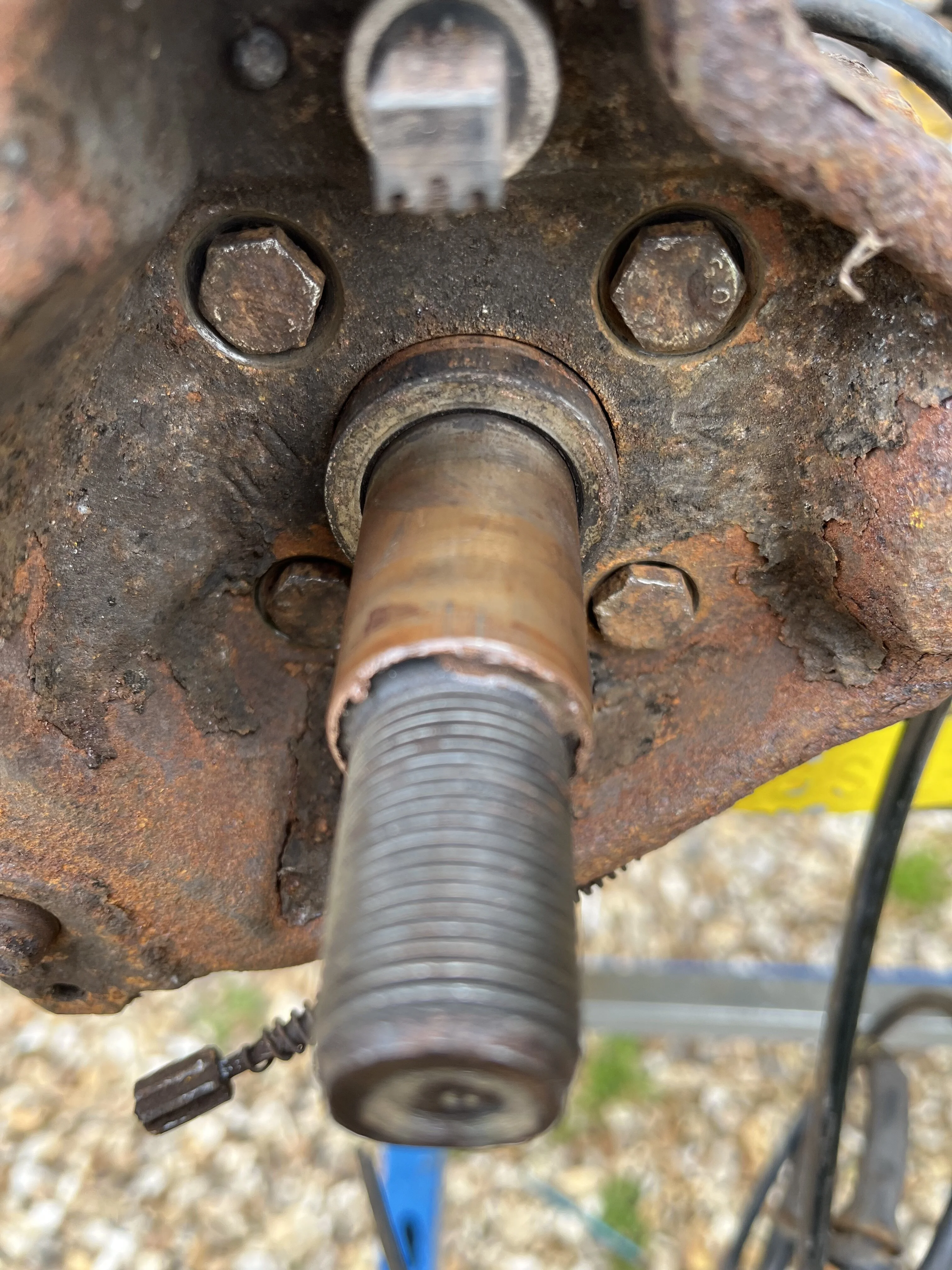

So, 2 weeks ago I removed the rear beam off the van because it was picked up on the last MOT that the rear bearing on the driver’s side was shot. I tried nipping the nut up but it still had play in it, he also said the rear bushes in the arms were split as well! Nice1 cheers 4 that 🤣.
Having got the beam on the floor I set about trying to get the torsion bars out, I already new after reading a few posts on here that it was a pig of a job! & boy you wasn’t wrong!! It took a good few hours with a sledgehammer & a peace of 30mm solid bar ground down with a point on the end to fit into the hole in the bar, after smacking the crap out of it it started to move!. It peed me off that much I nearly spat my dummy out & smashed it up! 🤣

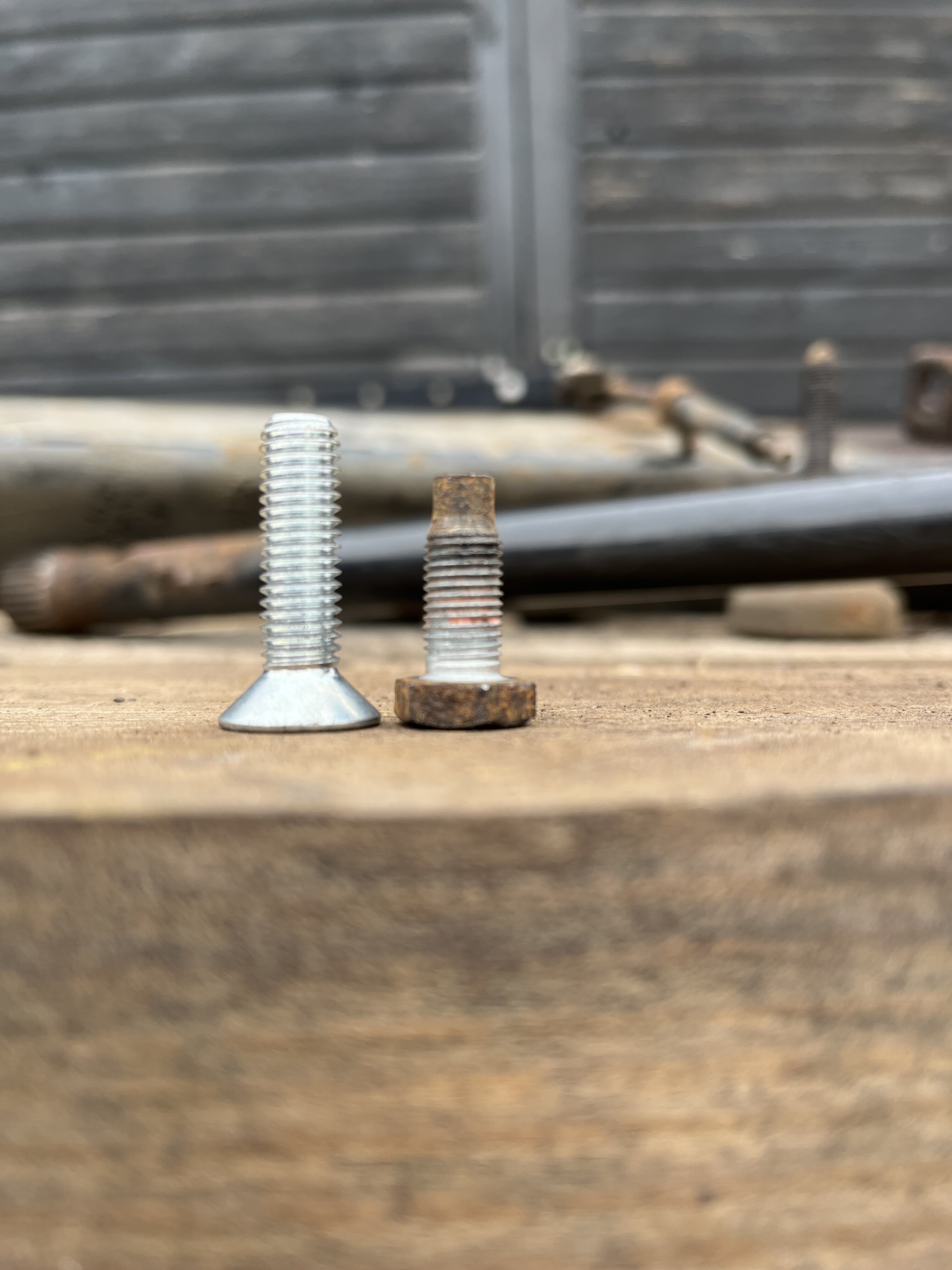

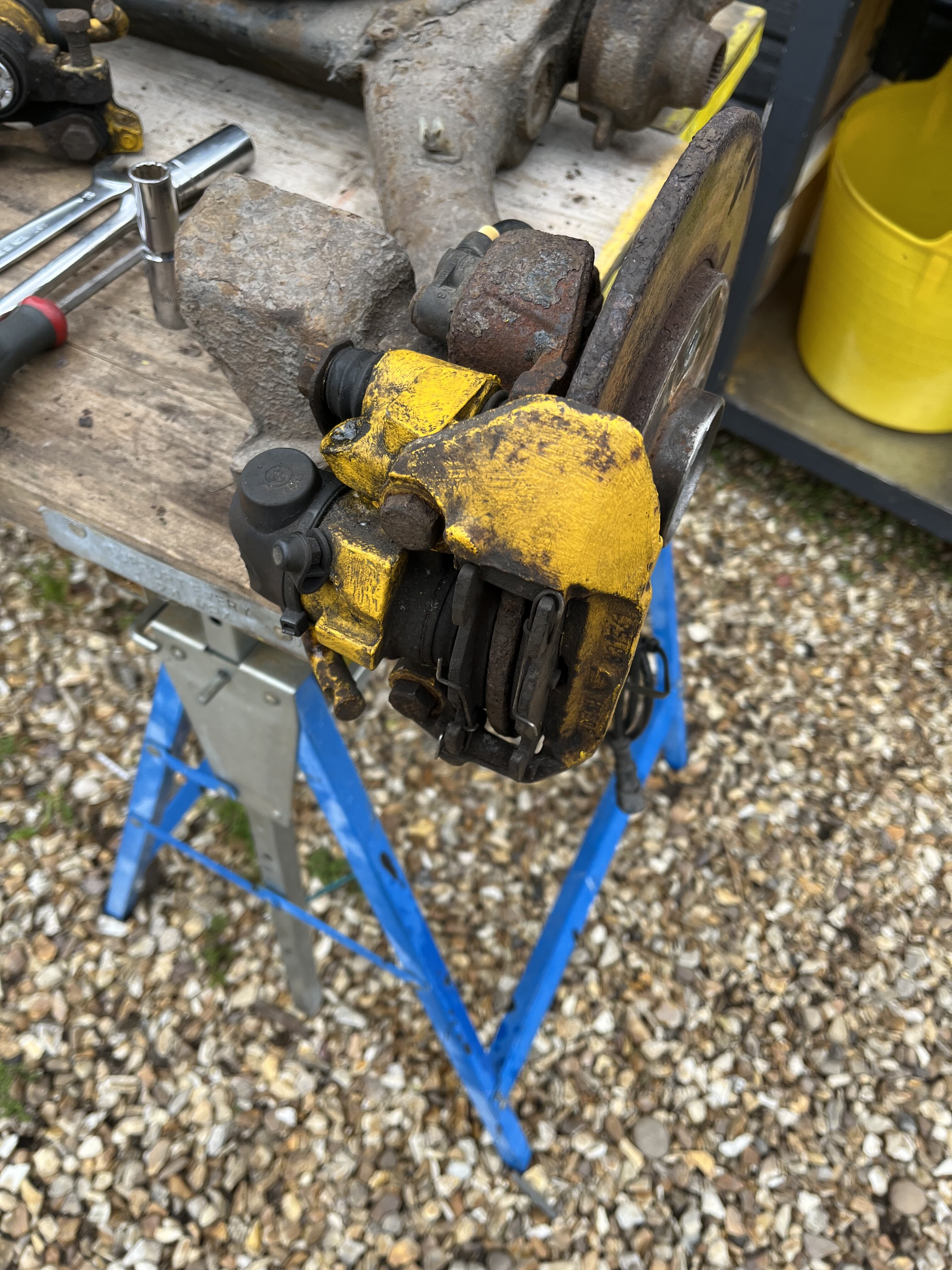

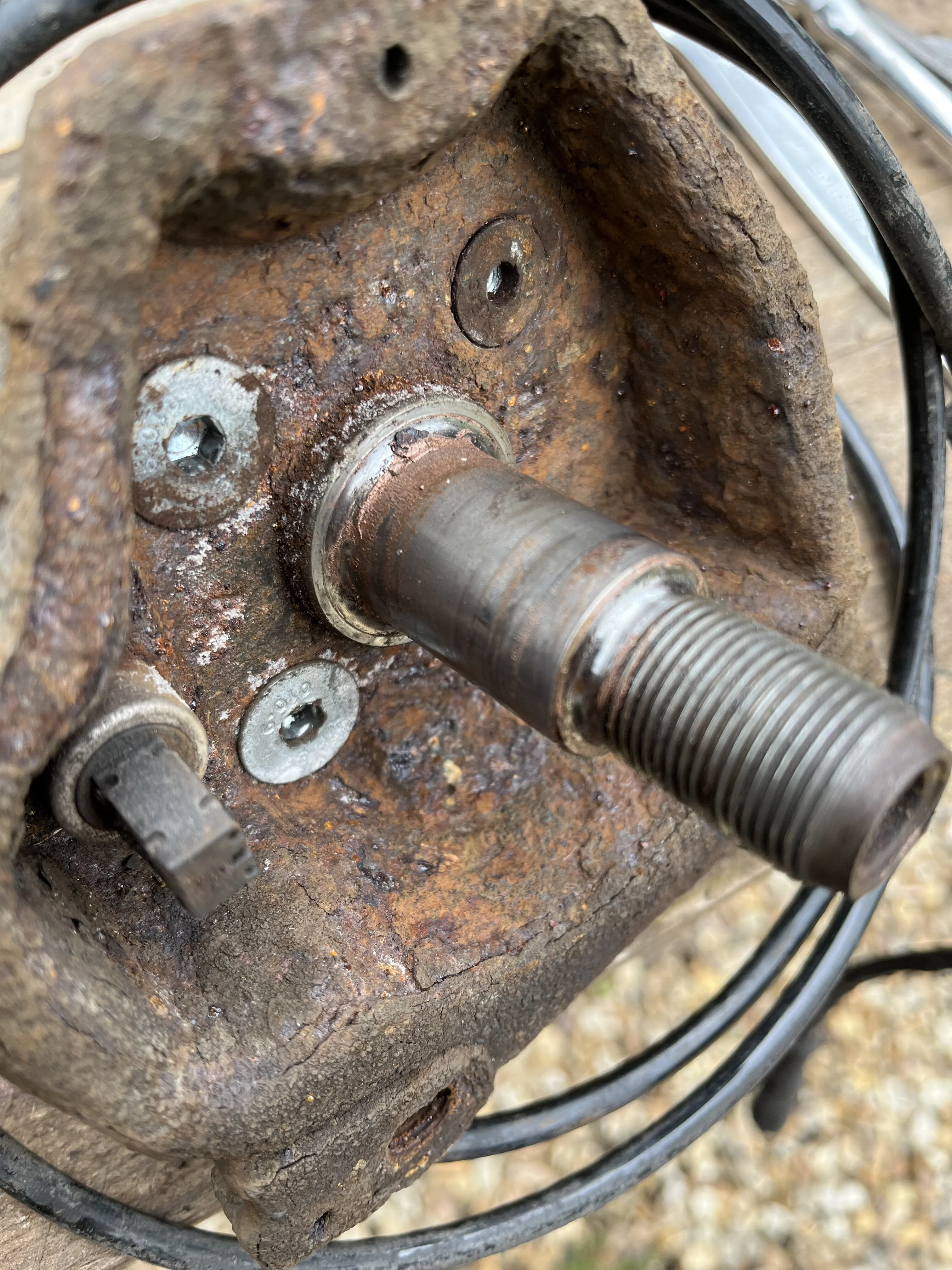

Fast forward today, I set about stripping the hubs off to find the bearing was fxxked along with the brake shoes & wheel cylinder. Quick look online to find the price for the bits need. How much! Lol sod spending on bits when I'm braking a Clio to do the conversion. Let’s see how hard it is to convert to rear disc. After a dry run it seems to b doable!? The only problem I’ve found is the thread pitch in the beam that holds the original bk plate on are a fine thread, can anyone point me in the right direction on some countersunk bolts that will fit? Also what handbrake cable can I use for rear discs? I’ll upload some pictures next.

M8 x1mm is the pitch. Can usually find a countersunk screw with that pitch online. I’ve just sold the last of the ones I had. 👍🏻

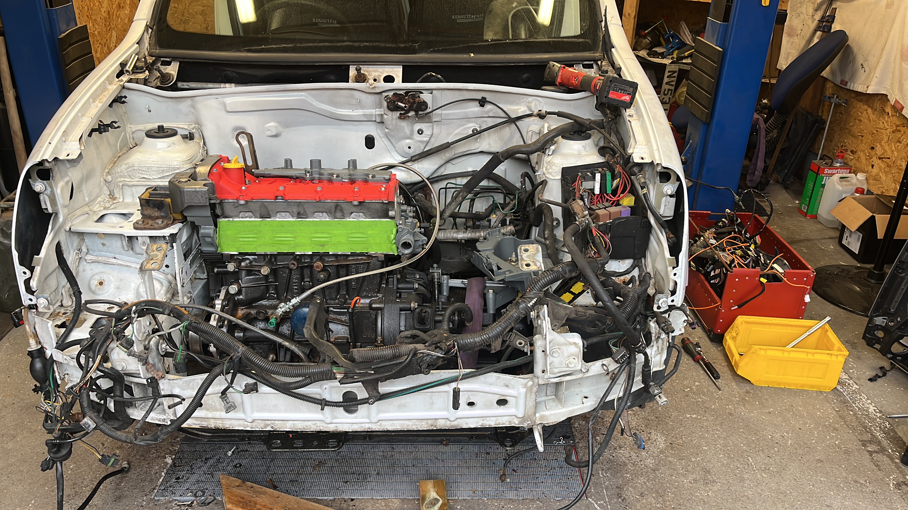

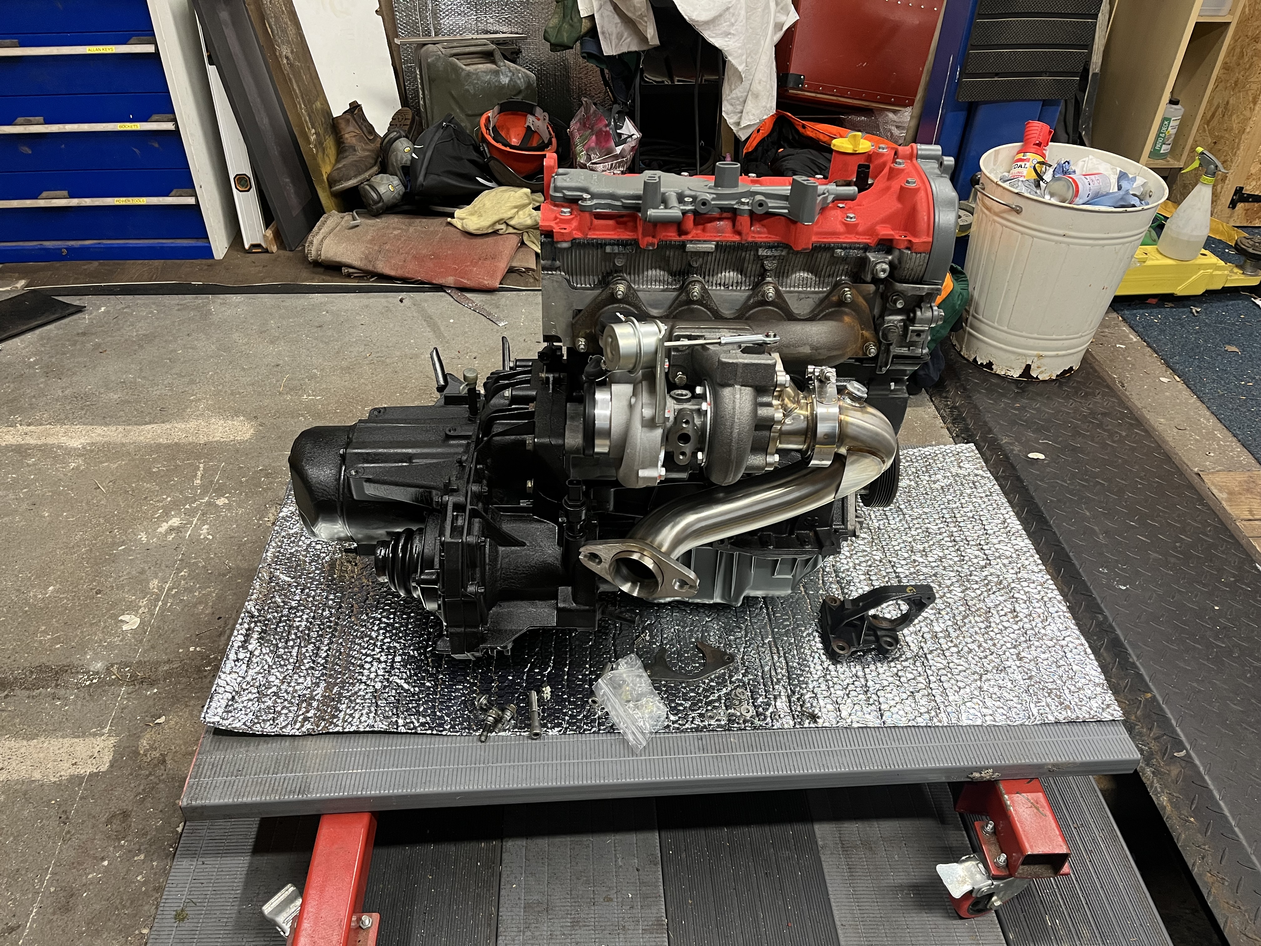

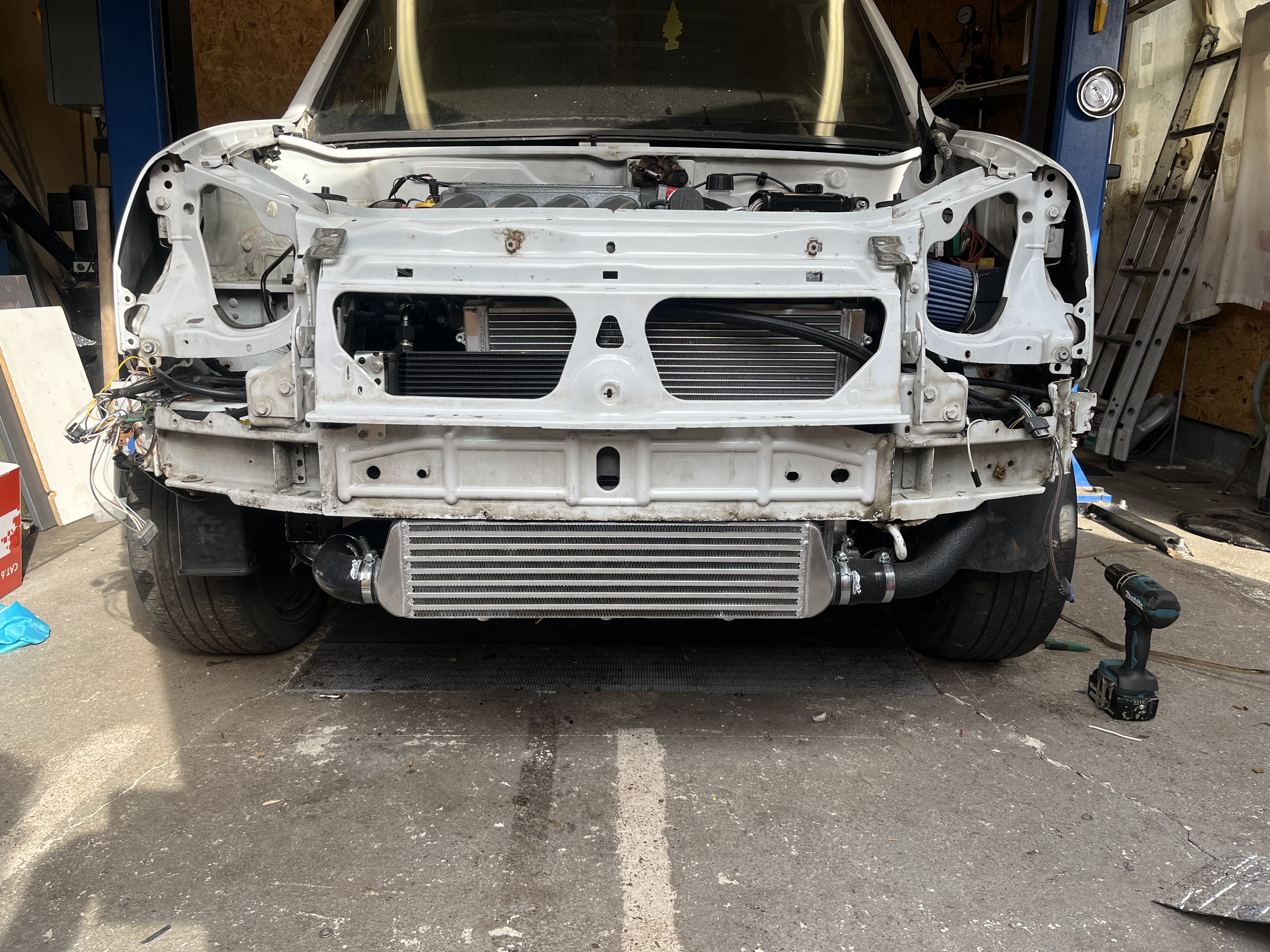

Wow 2023 was the last post! How time flys, family kids house work etc 🤣🤣. Massive update on the build pictures to follow. So the boring bits, engine is out the van & sold on. Removed the kangoo sub frame along with the lower arms, hubs etc. I’ve just gone full swap with the 172 subframe because it already has the hole in the frame to take the second gearbox mount. Easy swap along with the steering rack, so job lot happy days. I’ve also fitted the Clio ABS unit along with the brake survo because the van didn’t have ABS to start with but I won’t to run it, again easy job all fits a treat, I’ve also fitted the Clio pedal box witch all lines up. So when I get loom in it’s plug & play. So far so good everything is literally unbolt of the Clio & bolt onto the van.

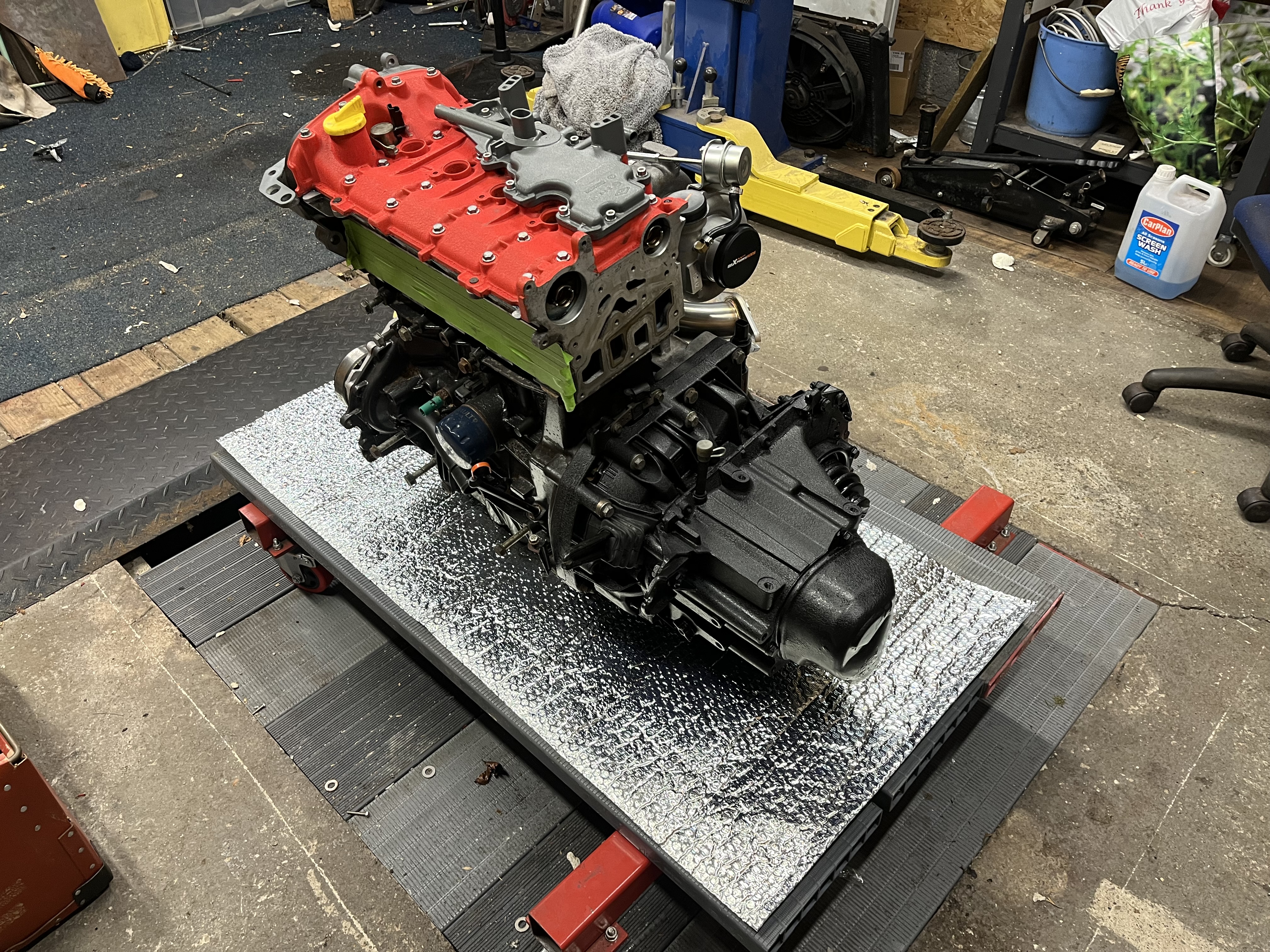

So engine wise this is what’s going in. Fully stripped & cleaned along with ARP stud & nut throughout, plus all bearing. Thicker head gasket, new exhaust & inlet valves plus valve springs, port & polish u no the score 🤣

Loads of people have done this & to fair the mechanics side is easy! I’m gunna concentrate on the wiring side on things coz that’s what I’m struggling with, so will go picture heavy on that side

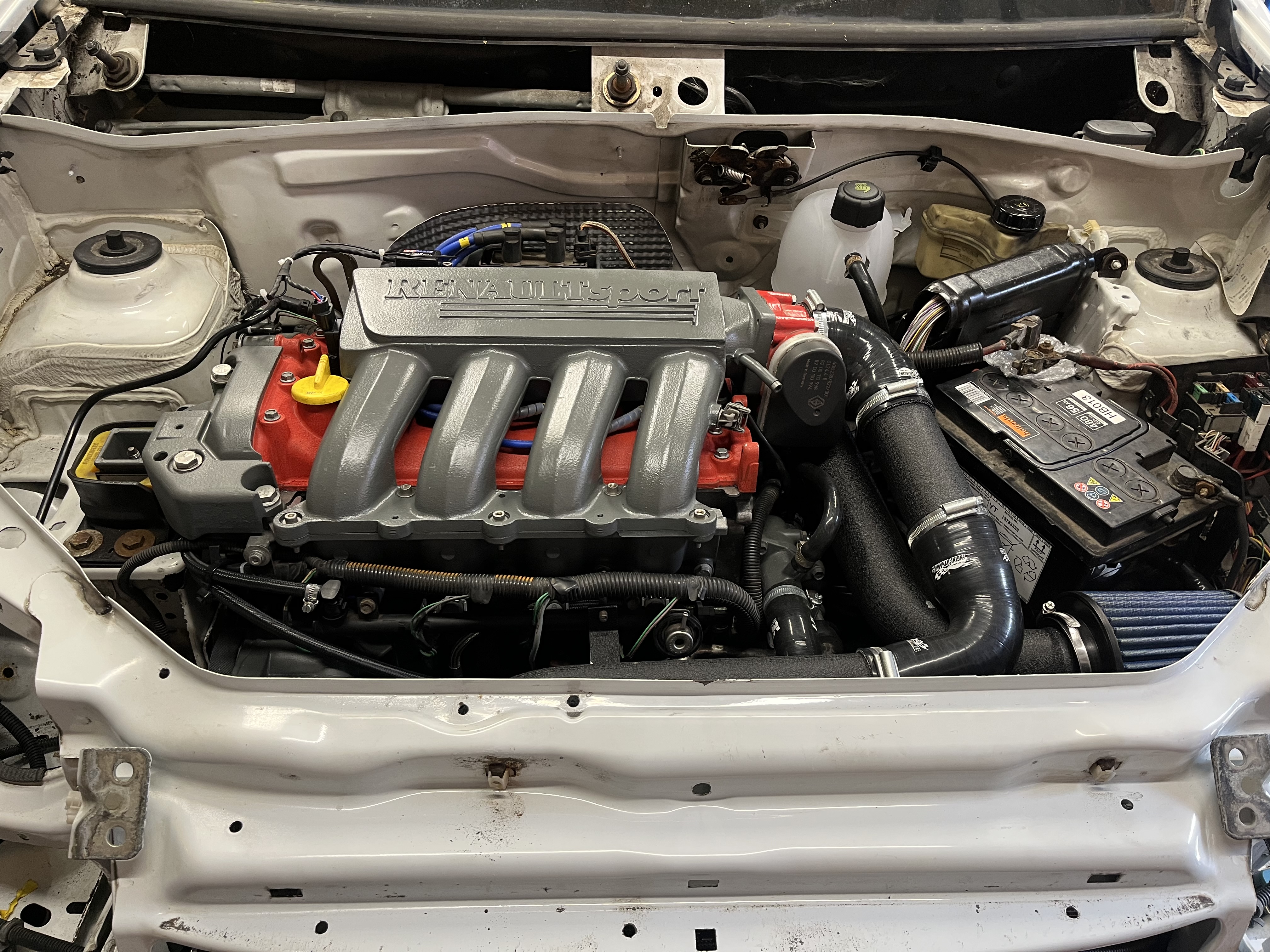

Big update! Been a while 😂 life & family always gets in the way. So to start with, last post I was having problems with the temp sensor reading 88 degrees, spent hours trying to bottom this out. & it was my fxxk up all along. I’d got the speedo & the coolant plugs the wrong way round! What a muppet but you live a learn. The plug off the gearbox for the speedo has 3 wires & the plug on the temperature sensor has 2 wires. Anyway that’s done now. As said before the mechanical side of the conversion is easy. The only part I struggled with was the electrical side to it because I’m using the full Renault Clio sport 172 loom I had to chop into the Renault kangoo van loom for the backend.lights & fuel pump are easy, air bags not so much you have to put restrictor in to bypass the circuit ect to eliminate lights on the dash. Because you can’t use the passenger airbag in the kangoo van because the dash is different. Anyway engine in with gearbox all plumbed in started up on the 3rd turn runs sweet as nut, drove if for 100miles or so then it went wrong big time 😂😂. Spun the bottom pulley for the cam timing. NOTE if any1 turbos the Clio engine use the Meg bottom pulley on the crank cos it has a keyed pulley £58 part has cost me a lot 😂😂

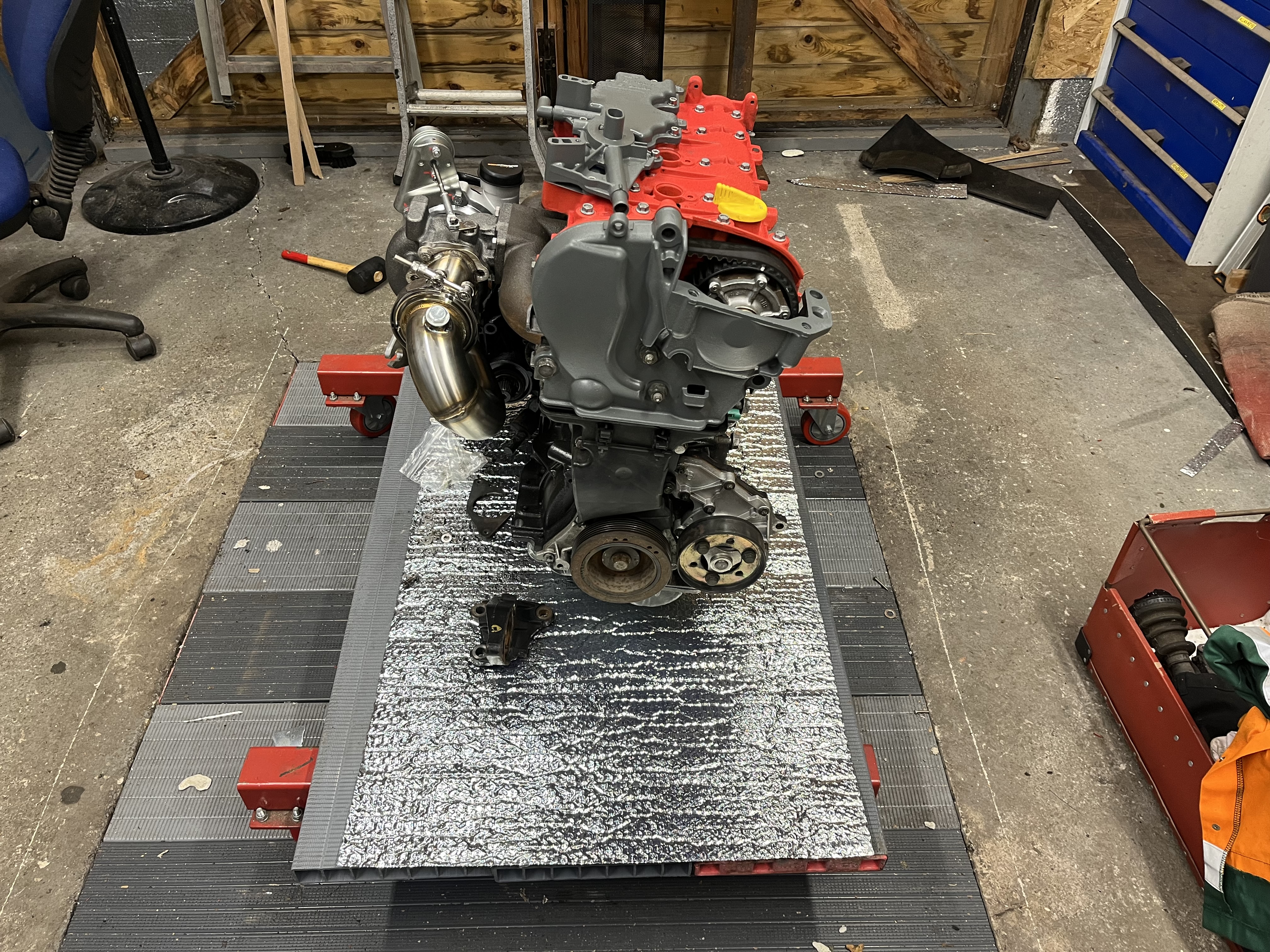

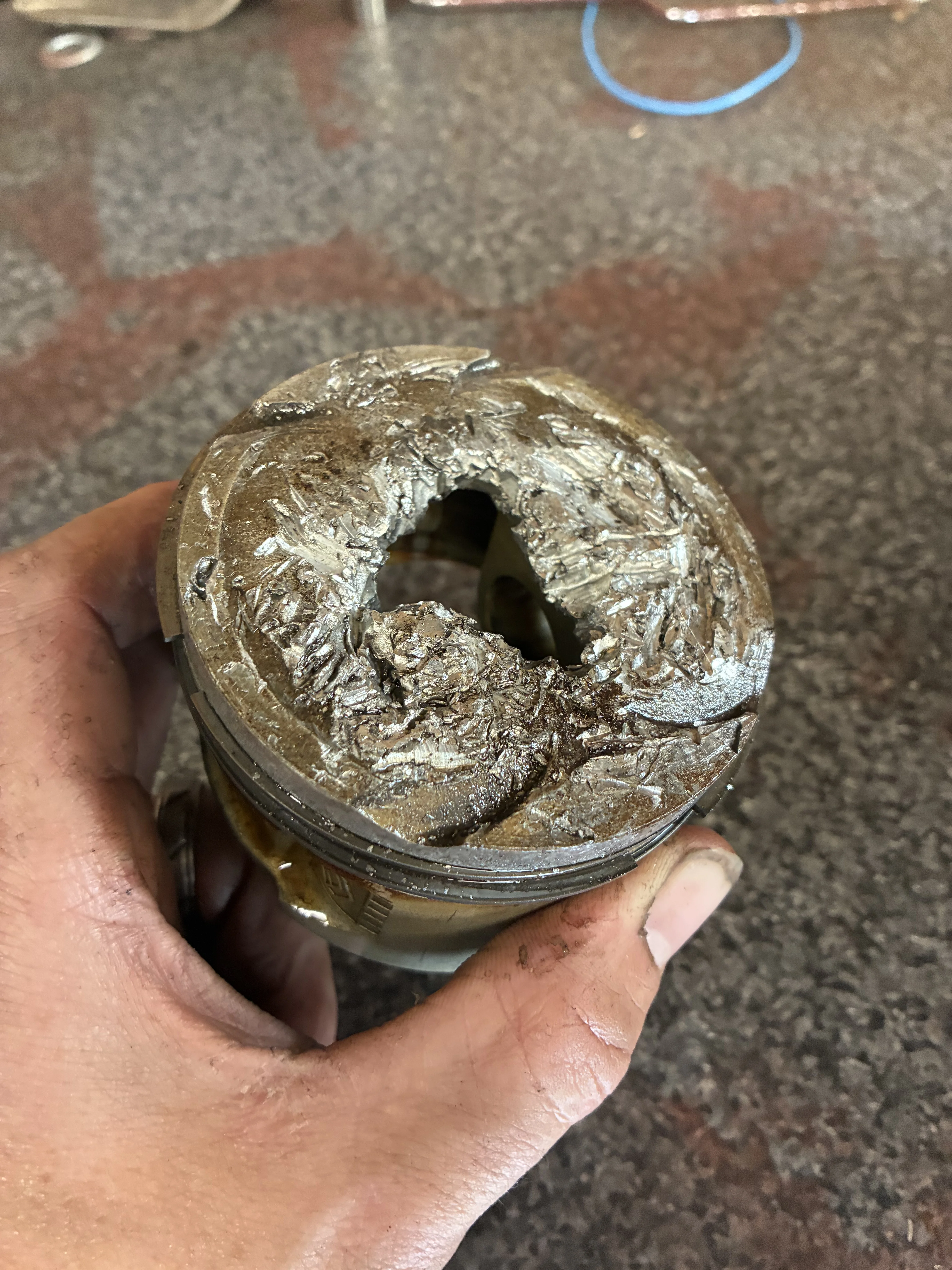

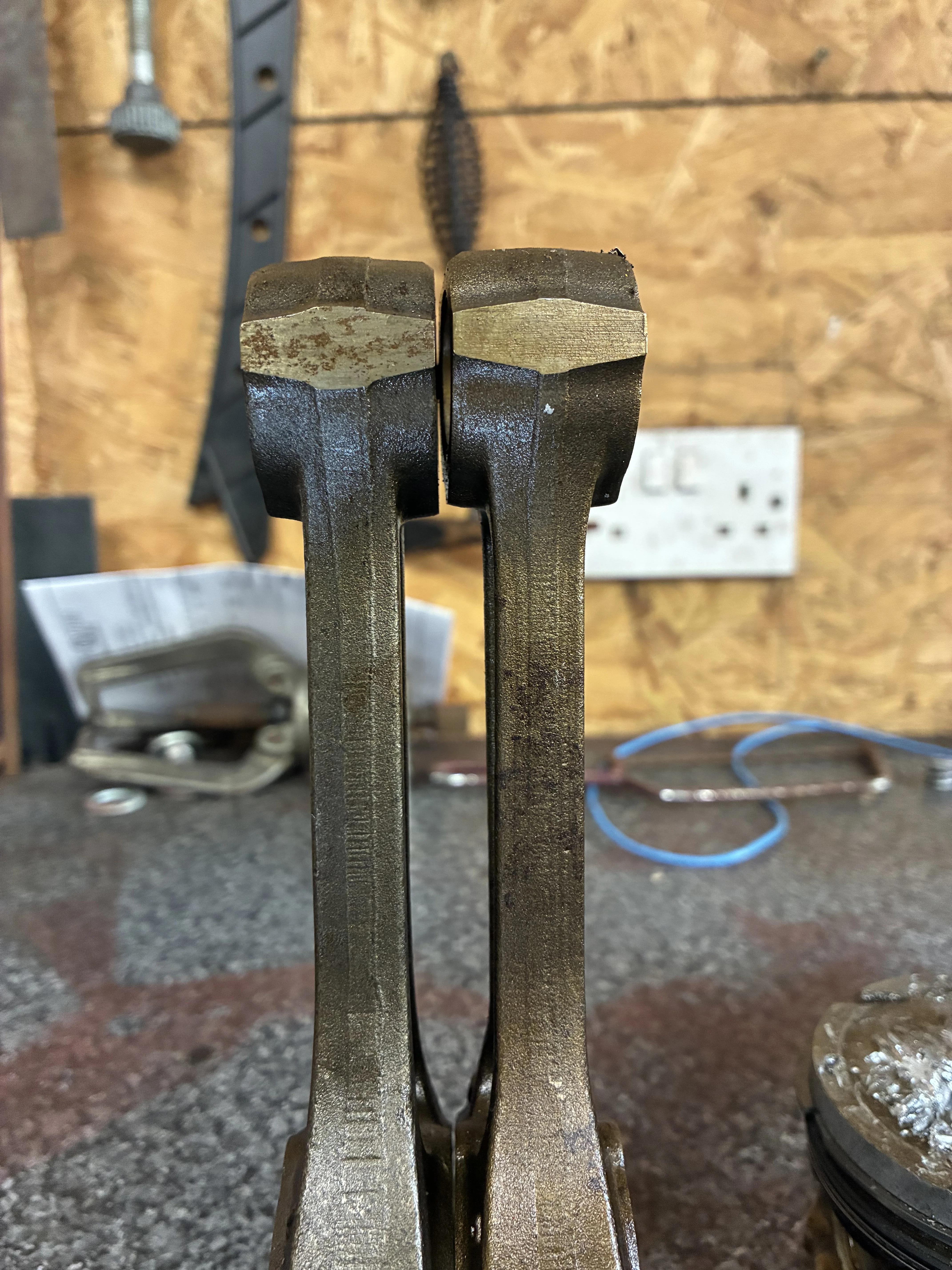

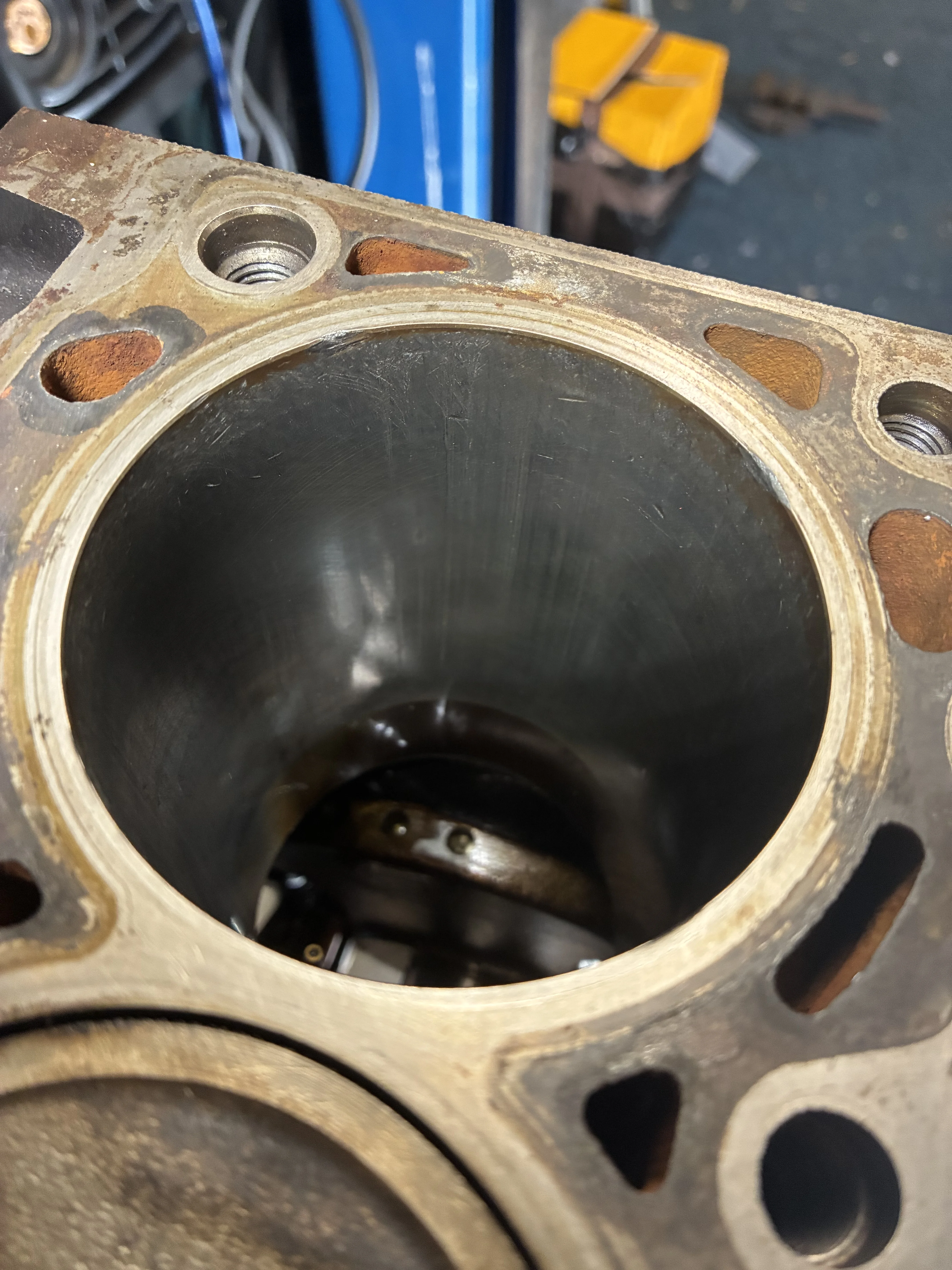

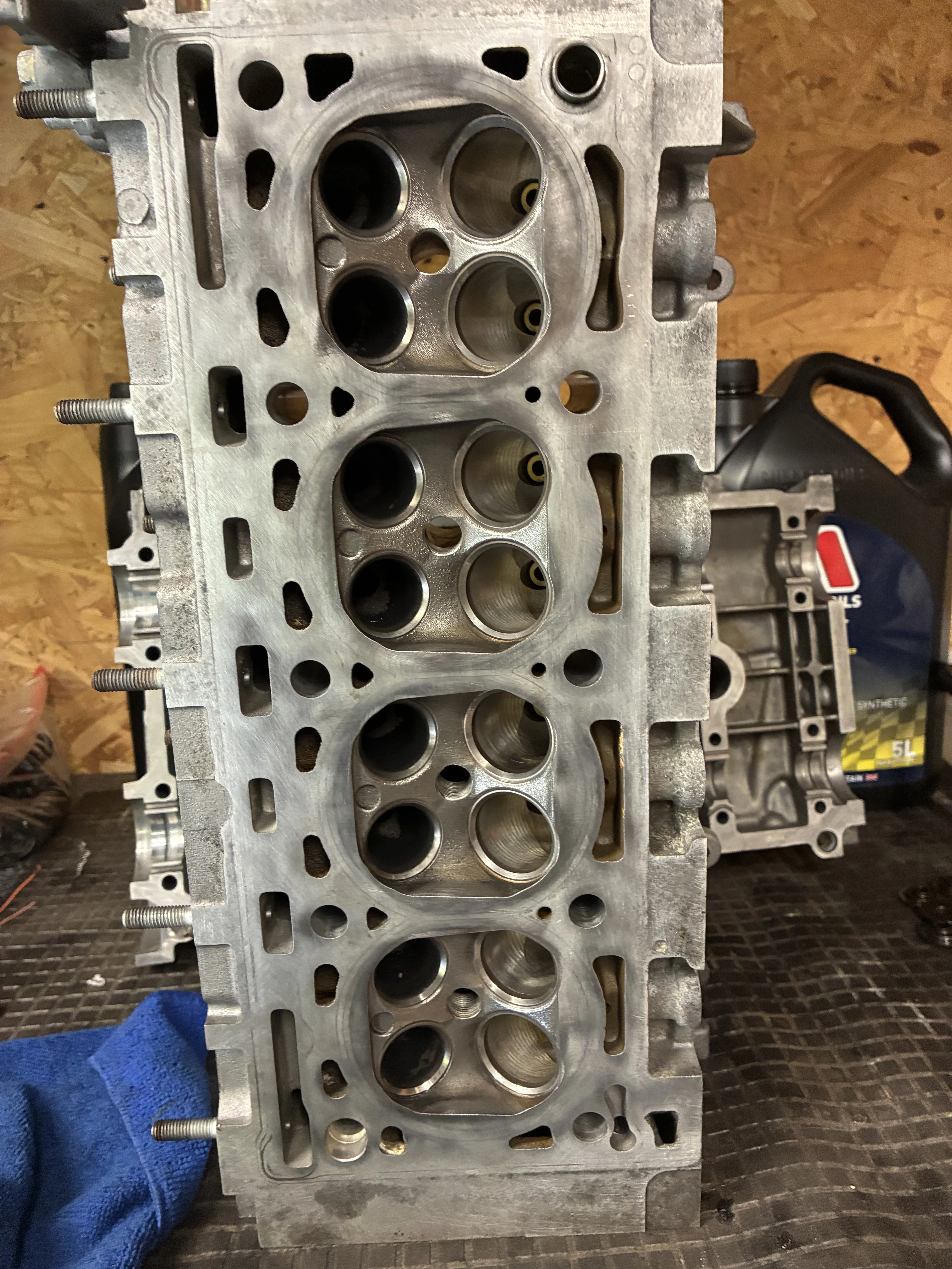

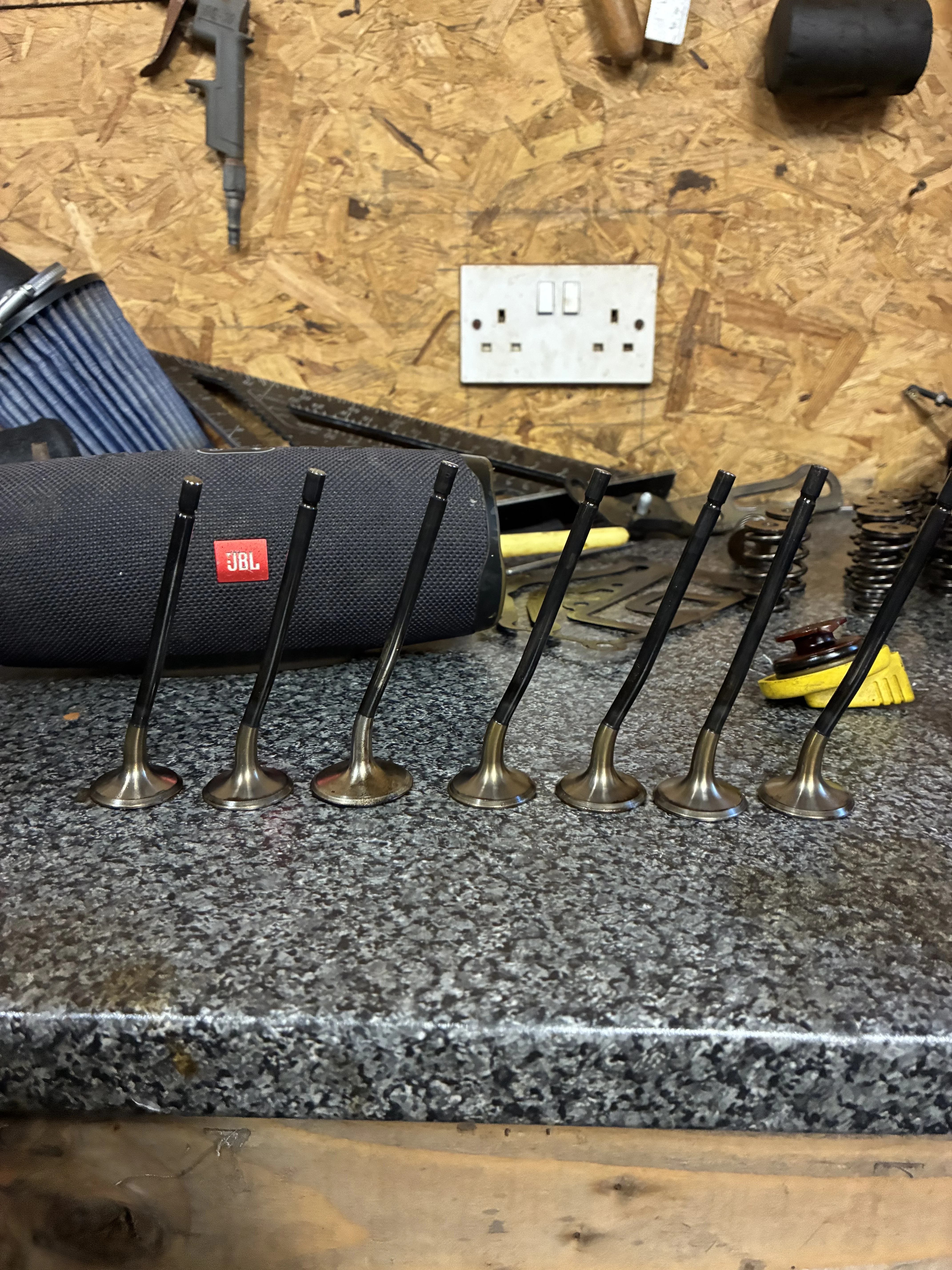

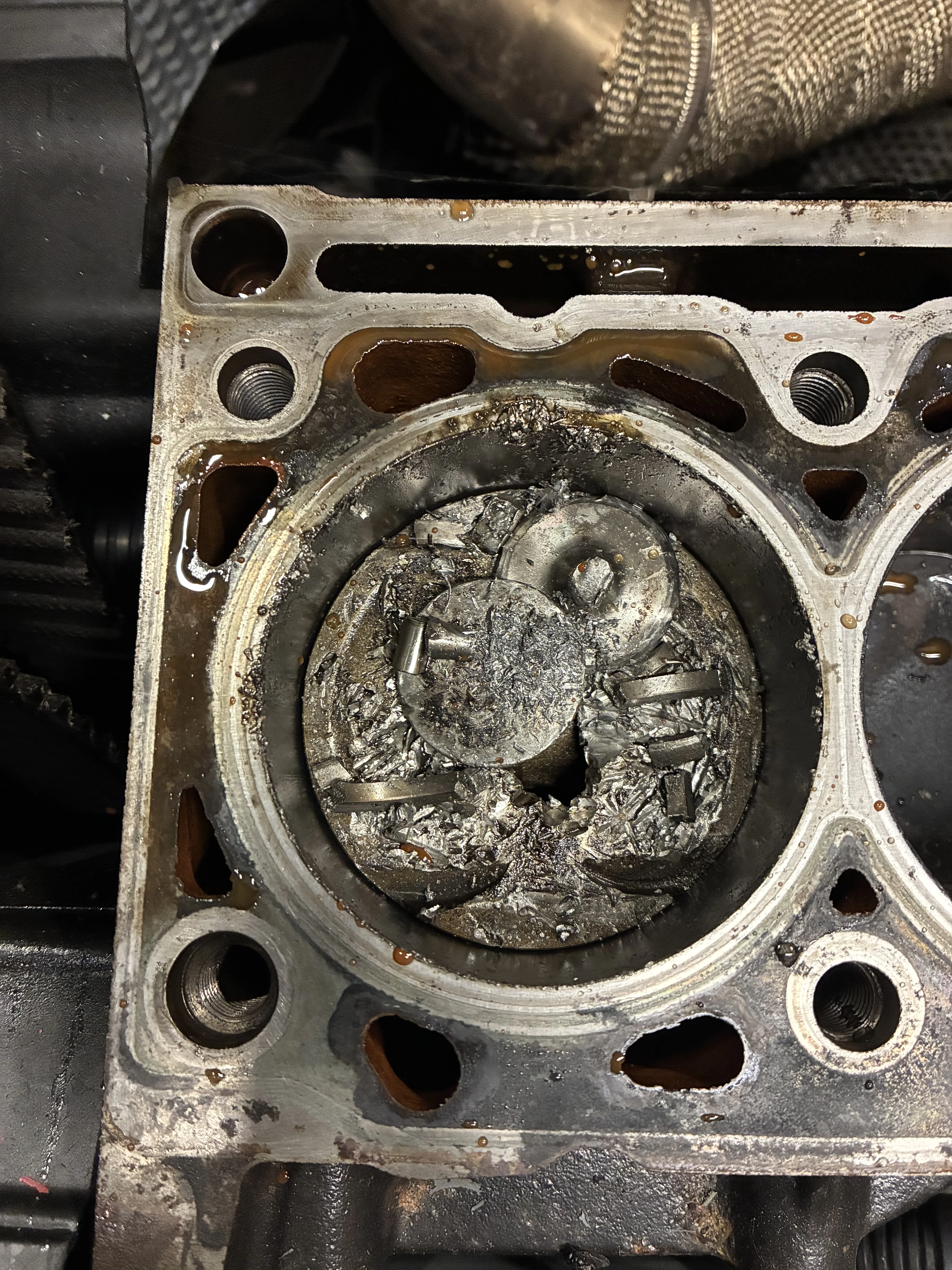

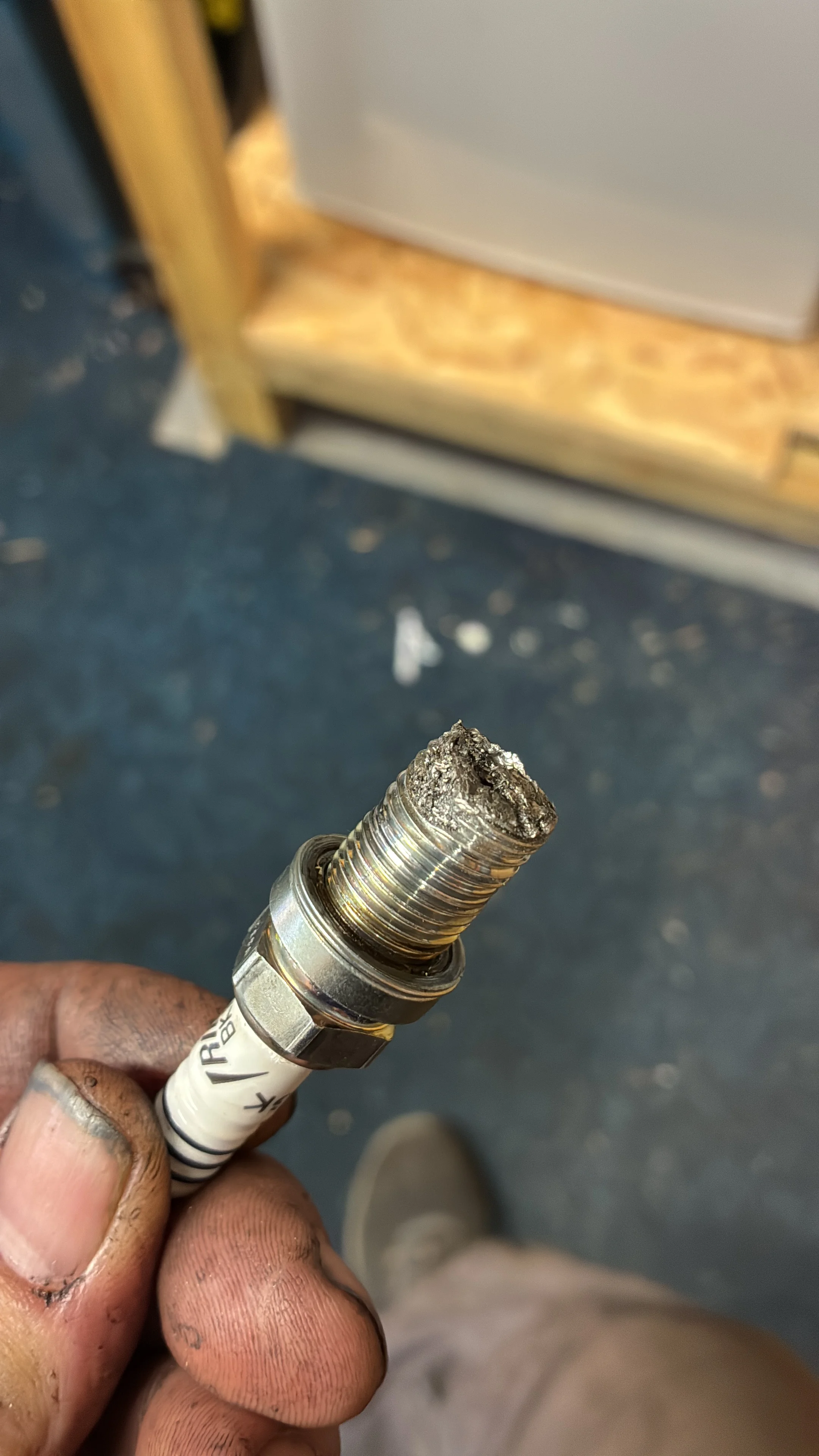

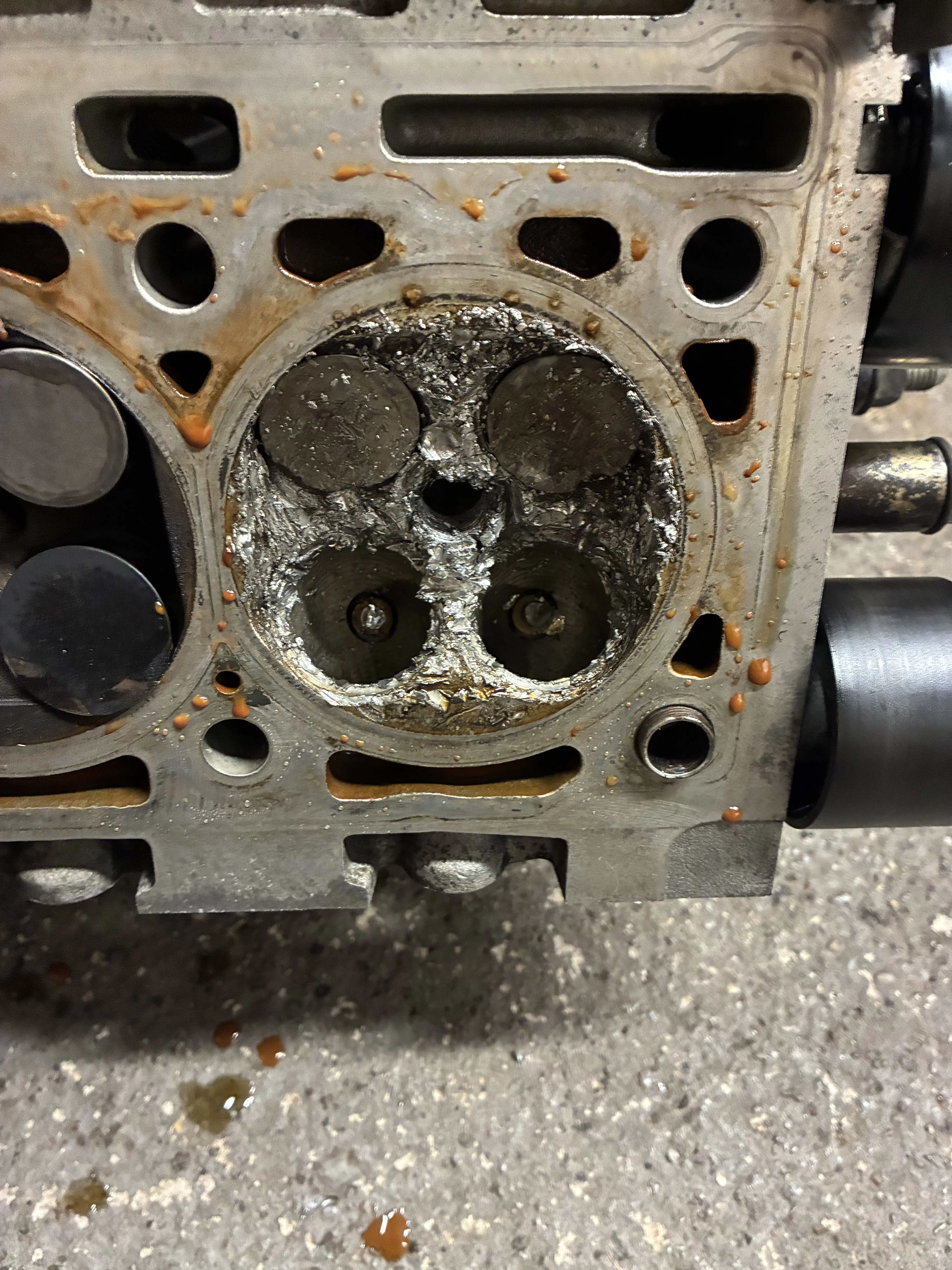

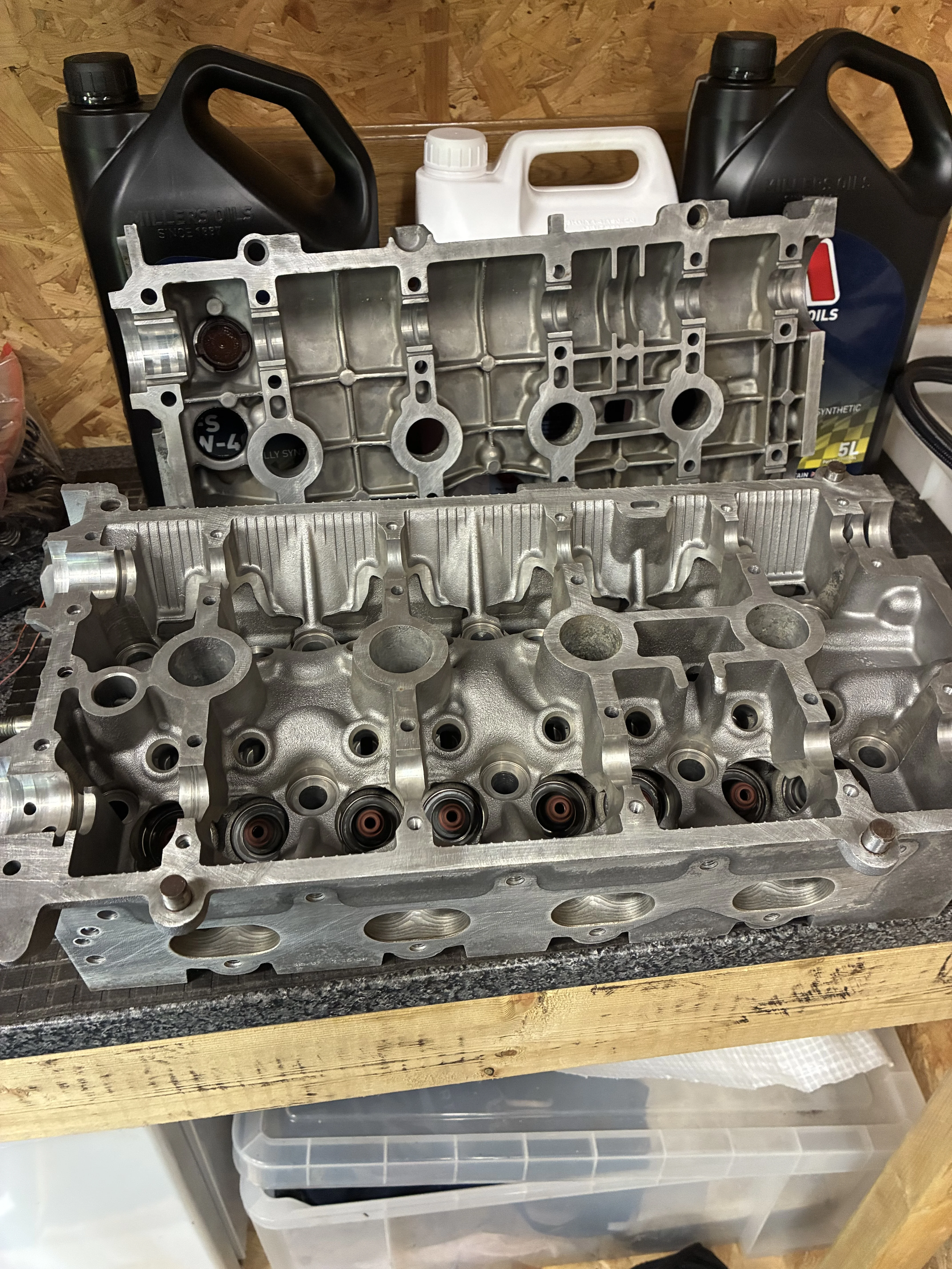

Had a few hours spare today so I thought I’d dig into the engine & inspect how far the damage went, luckily & don’t know how but the block is sound with no scoring at all! So that’s a big win 😂. Didn’t realise id bent No1 con rod, it wasn’t until I put it next to a spare rod that I noticed it. Rod on the right hand side of the picture is the bent 1.the cams have a bit of scoring but I think it will buff out & go again. I couldn’t believe how much aluminium was inside the top end, it was fxxking everywhere lol. Managed to source a second hand head & matching rocker cover that’s in better condition than my old one before it went bang so that’s handy!. Ordered a load of bits today from Andy @ engine dynamics so hopefully shouldn’t b to long b4 it’s up & running again. I’m gunna use Meg 250 pistons this time round as I had them in stock to use at later date with H section rods, I’m also thinking of running wideband as well so I can see what the air & fuel is doing but we will see

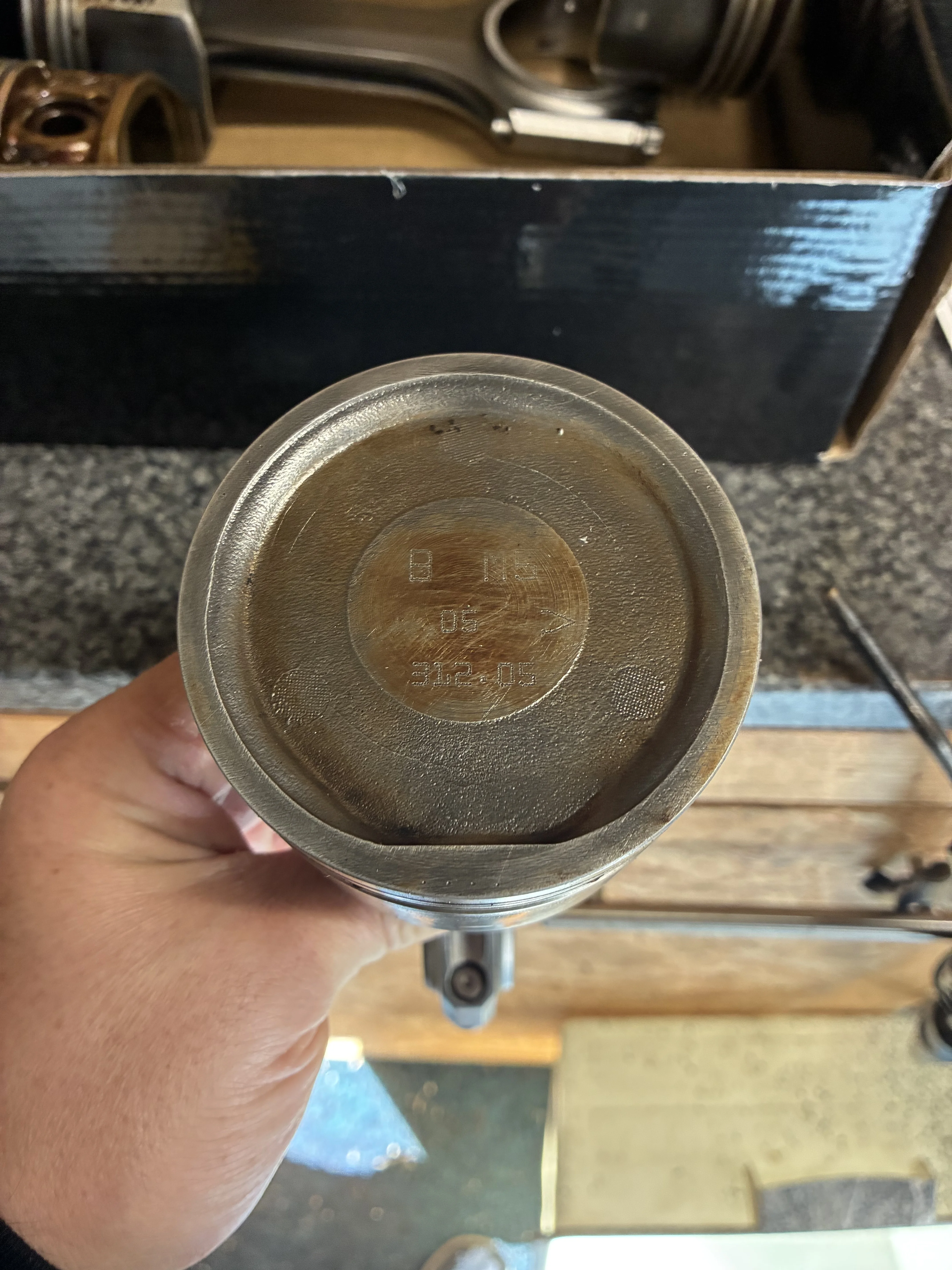

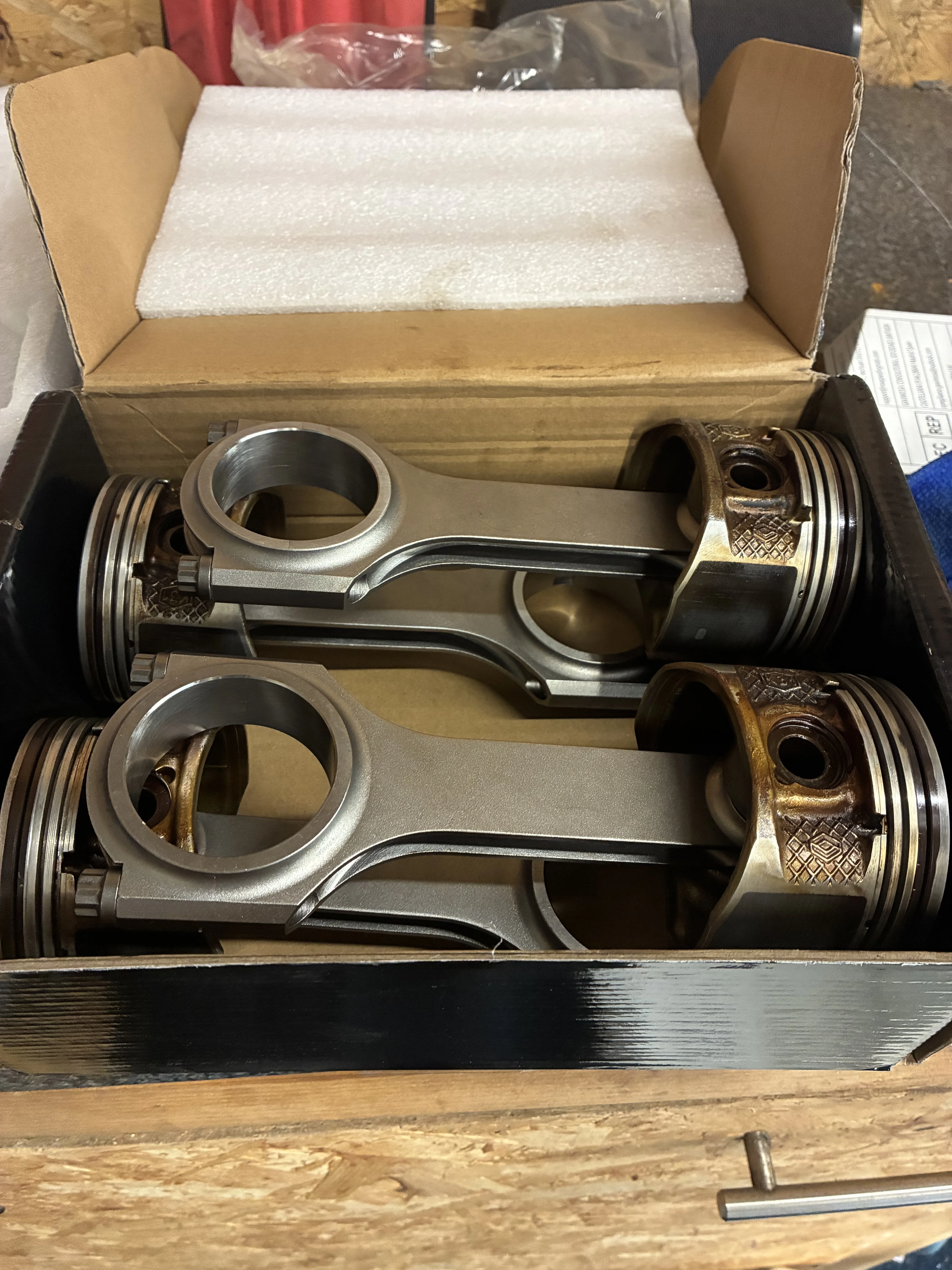

Had a spare couple of hour's today so I thought I’d check the bores on the block & make sure the meg pistons I’ve got fitted… b****cks! I’ve got the wrong pistons 🤣 these are 225 pistons & not the 250 pistons. Difference being 250 have valve pockets machined in the top to run VVT. Standard 225 ones are smooth domed because they don’t run VVT. Have looked at wossner but I’m not paying £800, if anyone has any 250 pistons with the cutouts for the valves let me know 👍🏻
