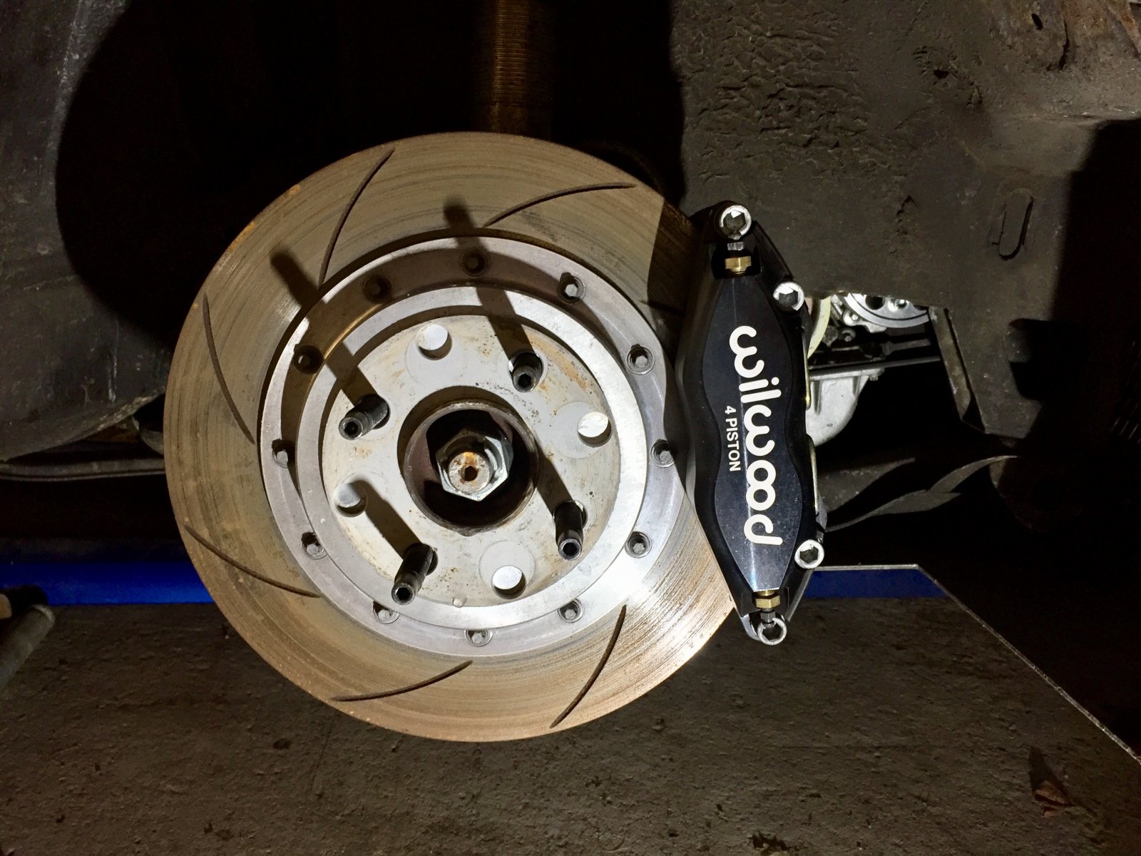

JamSport making a kit using wilwoods and they sell the discs. Just check the sizes.
I'm running their 2 piece discs using AP Racing rotors
