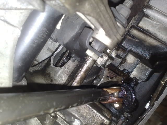

When PM'ing the last owner about the car he stated there had been a slight oil leak. At the time i asked if the oil was black or golden but i got no answer to this. I then asked him to check the engine and gearbox for leaks. I was told no more oil had come from the car and not to worry.
Today i got the car over my pit to take the exhaust off as it also broke on the way home as its totally rotten.

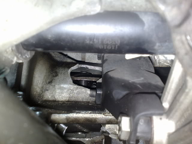

I think i found the source of the ''mystery'' oil leak.
How i made it home i have no idea. All i know is that i'm f**king luckly. I hate to think what would have happened if it seized on the motorway. No wonder no more oil came out. There is none! As you can see this isn't a recent thing. The box is bone dry!

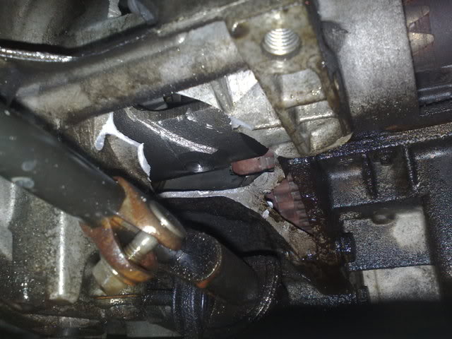

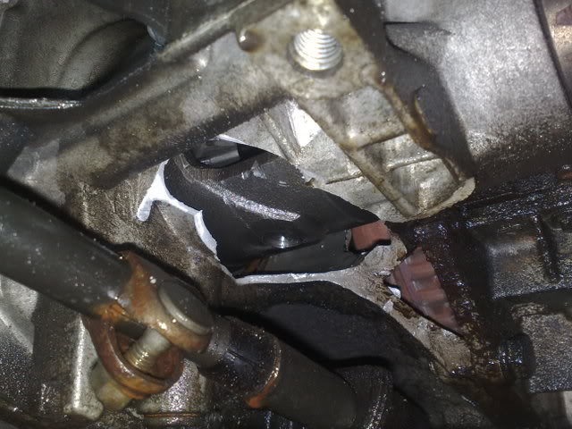

I then gave it a slight poke to see what state the internals were in......

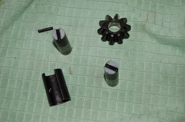

This is what fell out.
I'm lost for words.

Does it go into gear ok, whine or anything? What a f**king numpty, LOL!

Looks like a very fresh break though, Look how clean the metal is where its broke off, it cant have been like that for long at all.
He mentioned the oil leak happened when he moved it to where i picked it up from.
So its fairly new i'd say.
