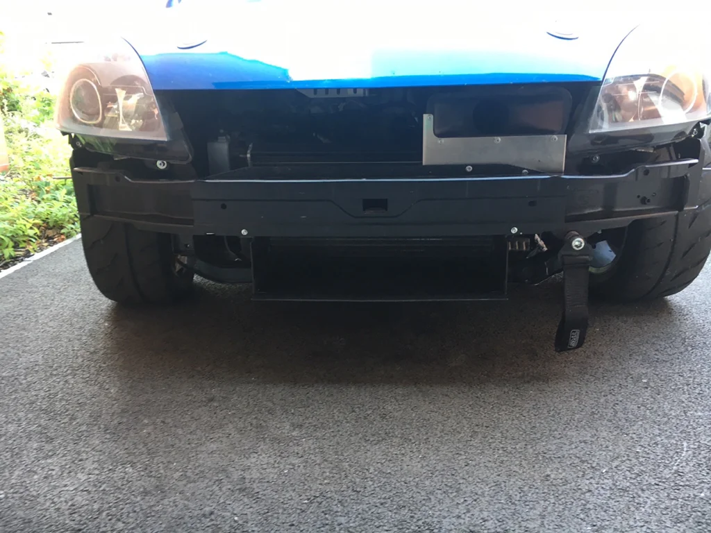

You know the crash bar is right behind where you plan to drill? So unless you drill that too then it won't do a single thing. It won't do much anyway imo, maybe help the rad out slightly but it's not needed.

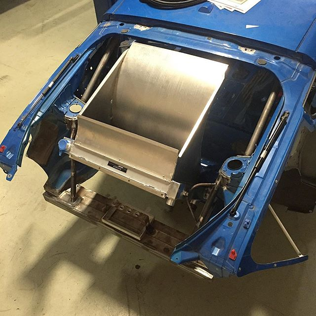

I dont know on the clio if there is enough space to put in a post rad duct like on the some motorsport applications to get rid of the heat straight from the rad.
Like this :
1410490

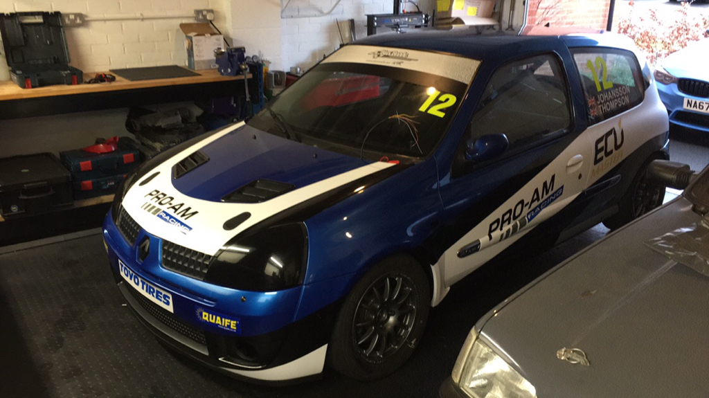

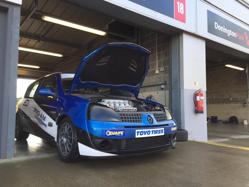

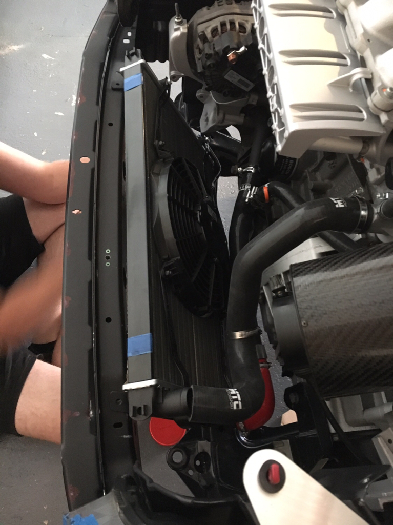

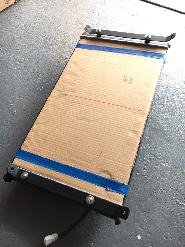

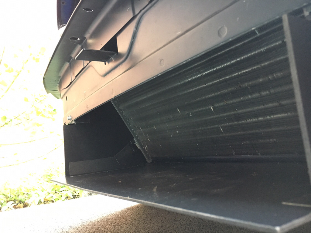

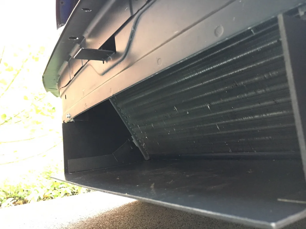

I run a completely bespoke rad layout which enables me to run a smaller rad to allow me to get the air inlet for the engine fed from the kidney grille on the bonnet
I have angled it forward and added a duct on the front to feed all the air from the main grille into the rad
I then run bonnet vents positioned nearer the front of the bonnet (infront the cam cover and behind the rad) to draw the hot air exiting the rad out of the bonnet, using the low pressure air passing over bonnet
As previously said, to far back and the airflow is turbulent and high pressure.. also the airflow is blocked by the inlet above the cam cover

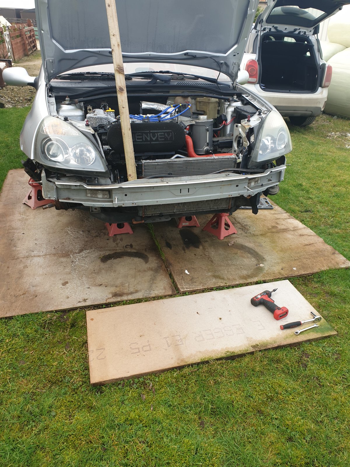

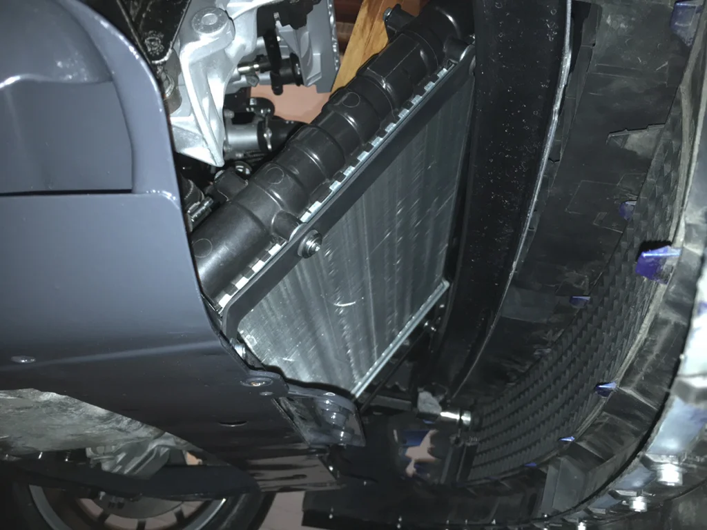

@Tomotek what rad is that your using out of interest please. I've got a VW polo one I think in mine because of the bodies. Lower down out of the way also make life easier getting to things at the front of the engine. The front cross member blocks off around 50/55%% of the rad aswell...
