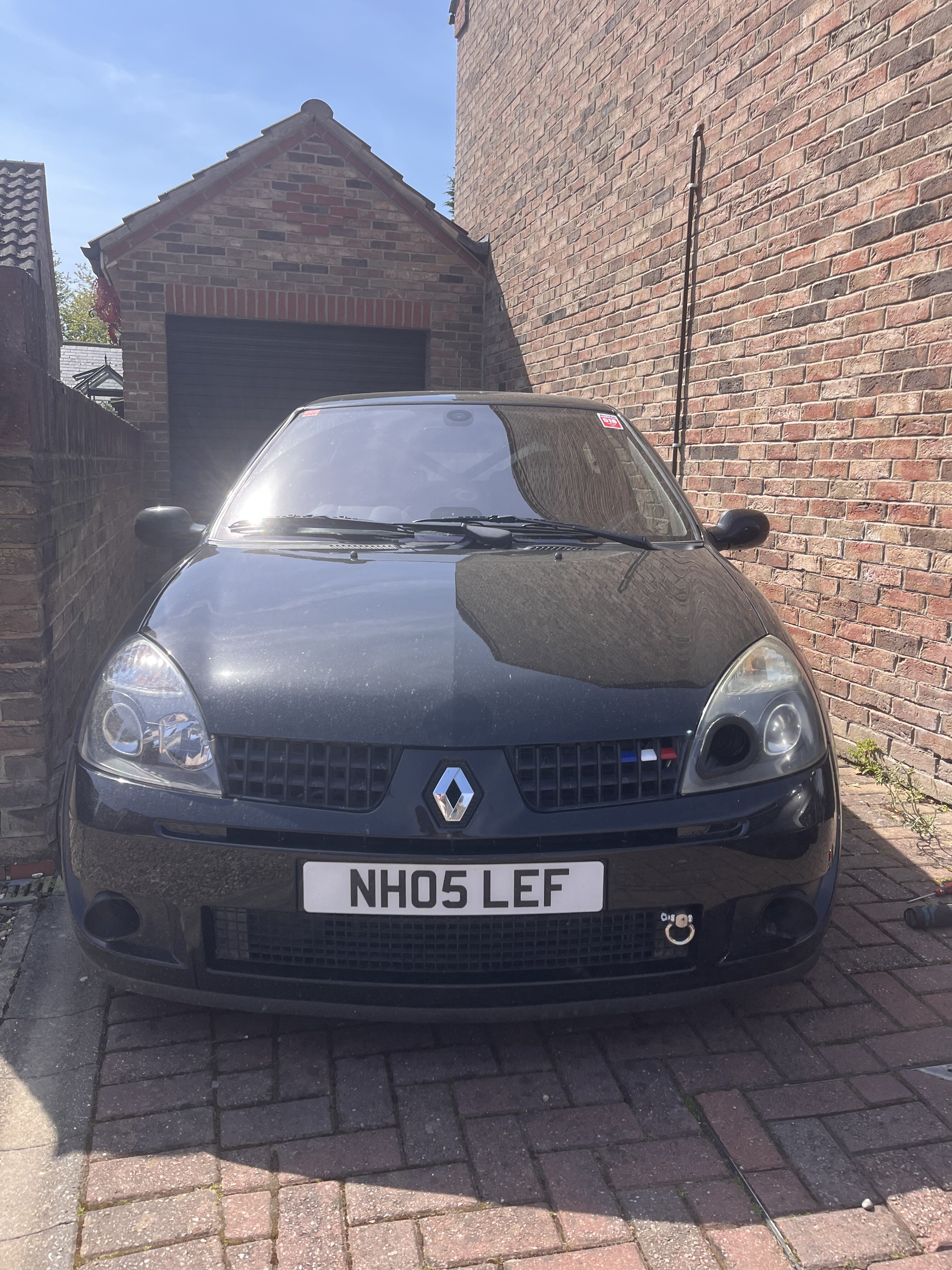

So when I say not much more I want to do, that was a lie.

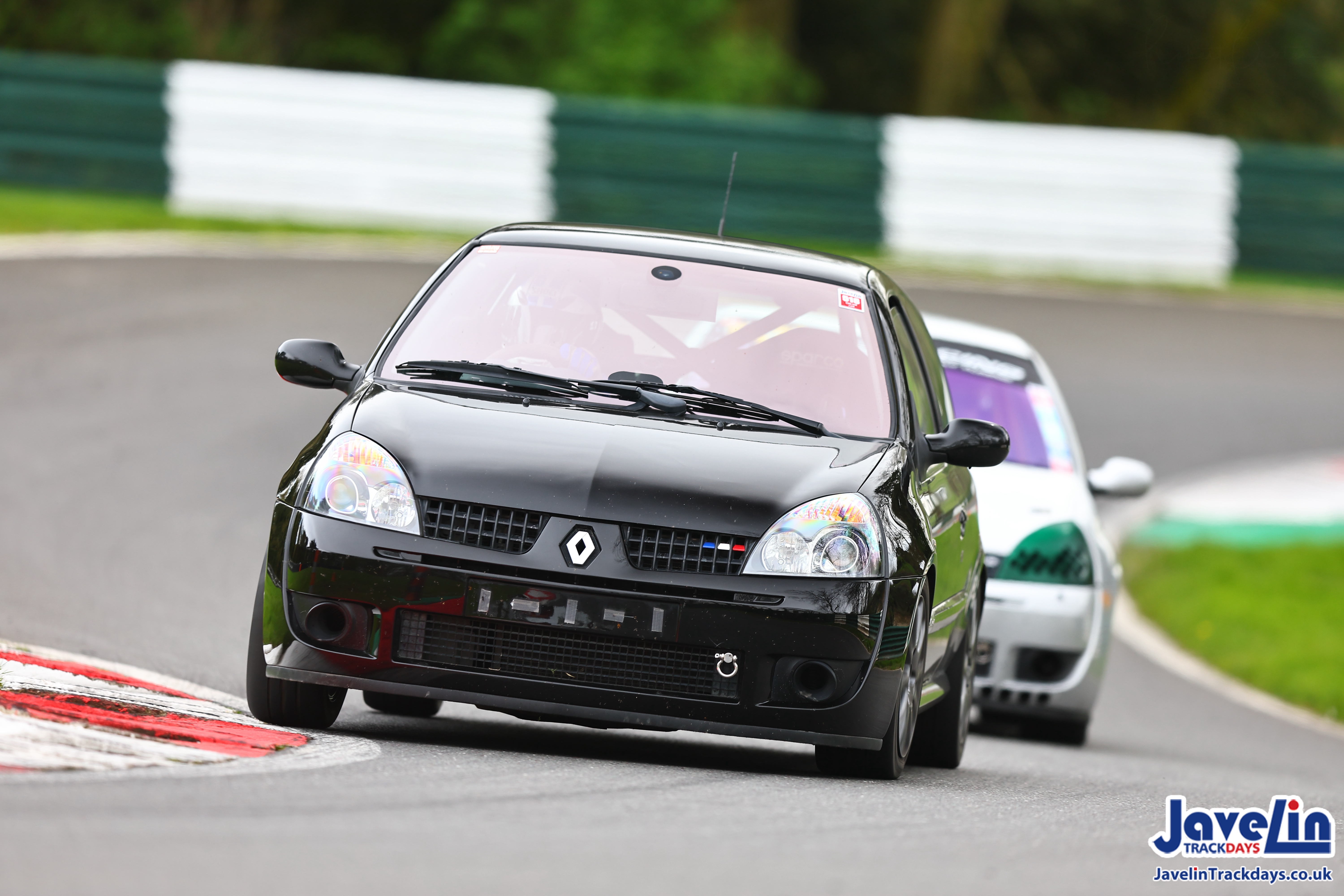

Javelin no doubt. They should have picked that up before letting you out tbf.Oh.. also I forgot to mention, I set on the sighting laps and went around the gooseneck and thought something had broken as there was a sliding noise followed by a loud thud... only on the second sighting lap did I realise I still had 40 litres of fuel in jerry cans sliding about in the back!
Don't lose comfort though. Keep your heater and electric windows in at the very least. My ACW racing windows in my last circuit car were a pain and if you've not got a heater in, you'll not be able to enjoy winter trackdays. Have you got rid of that damper under the bonnet, just below the top engine mount? 2 kg in that alone.Literally got the car off the trailer and looked at it and realised how much weight there still was in it. Think it will be off the road shortly and become a proper track toy tbh.
Yeah I’m not losing the ac or electric cars windows. It’s a fair shout. Loads of carpet, sound deadening and the like though.Don't lose comfort though. Keep your heater and electric windows in at the very least. My ACW racing windows in my last circuit car were a pain and if you've not got a heater in, you'll not be able to enjoy winter trackdays. Have you got rid of that damper under the bonnet, just below the top engine mount? 2 kg in that alone.

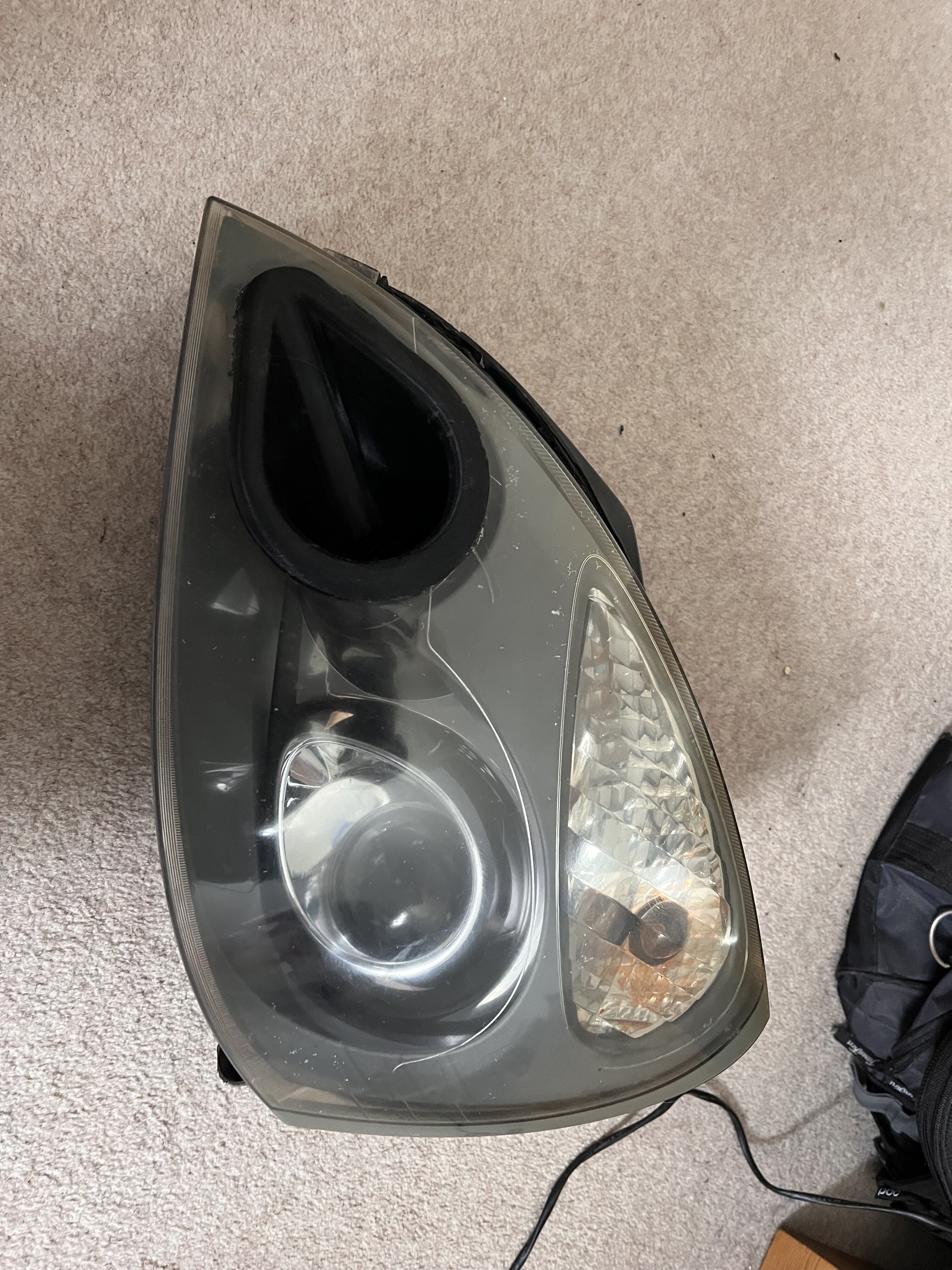

I'm getting some headlamp blanks again as there's some weight in those Xenons. Dead easy to whip in and out in the morning before doing your sighting laps.

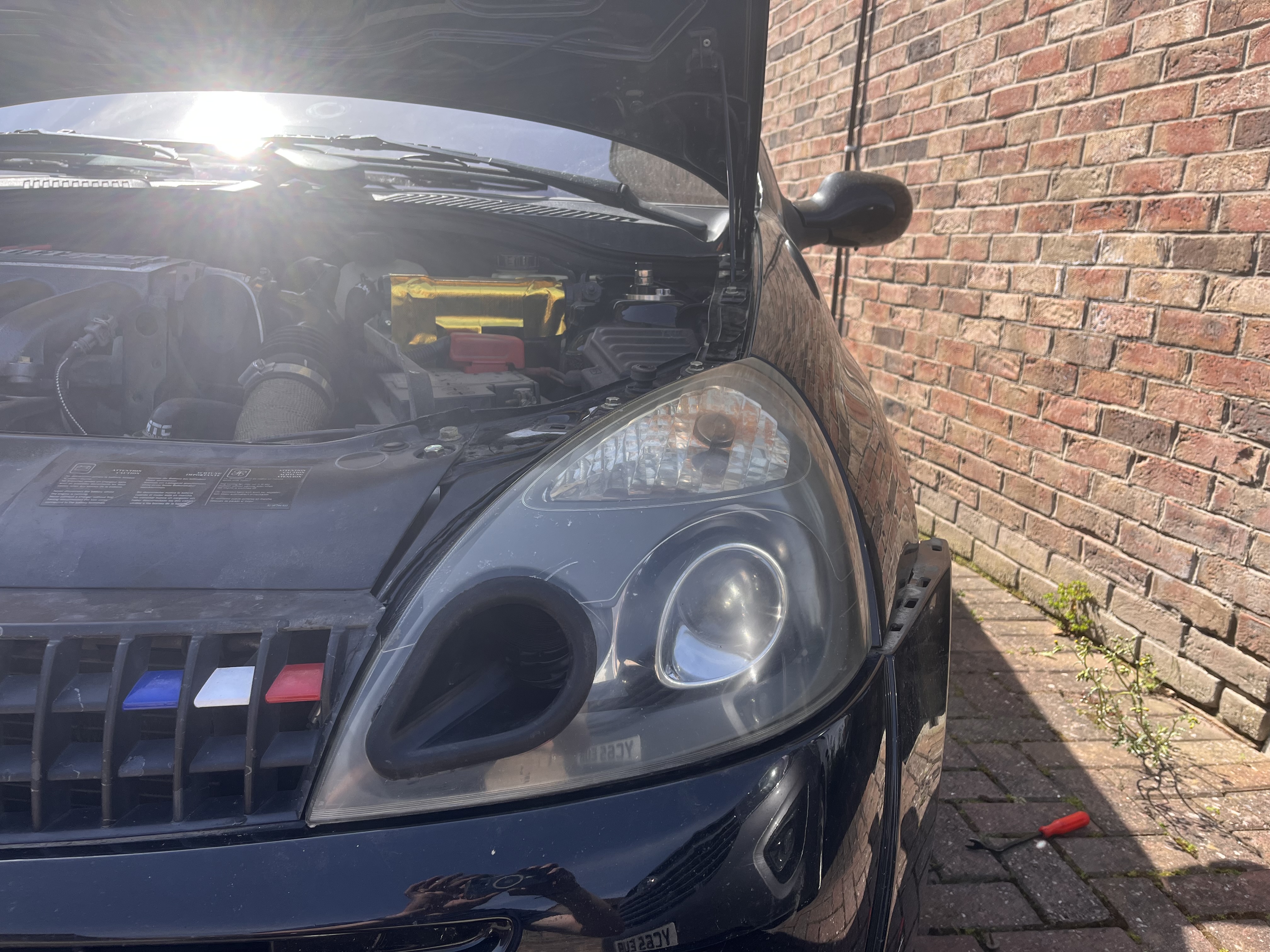

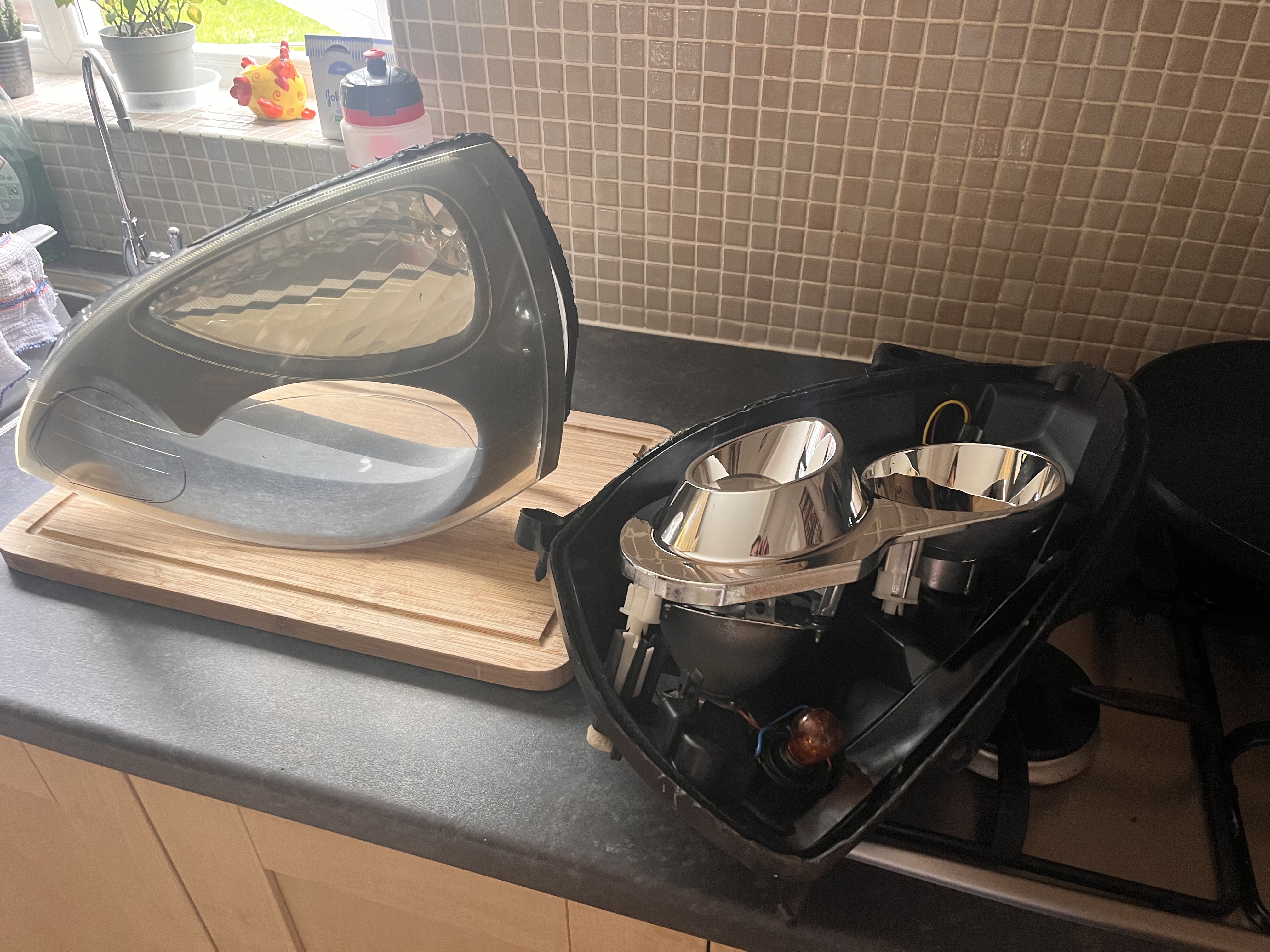

I did, 200c for 2 mins at a time, still put up a fight but a bit of patience and got there in the end.@SharpyClio that's a very clean separation on the headlight lens - did you do it in the oven?

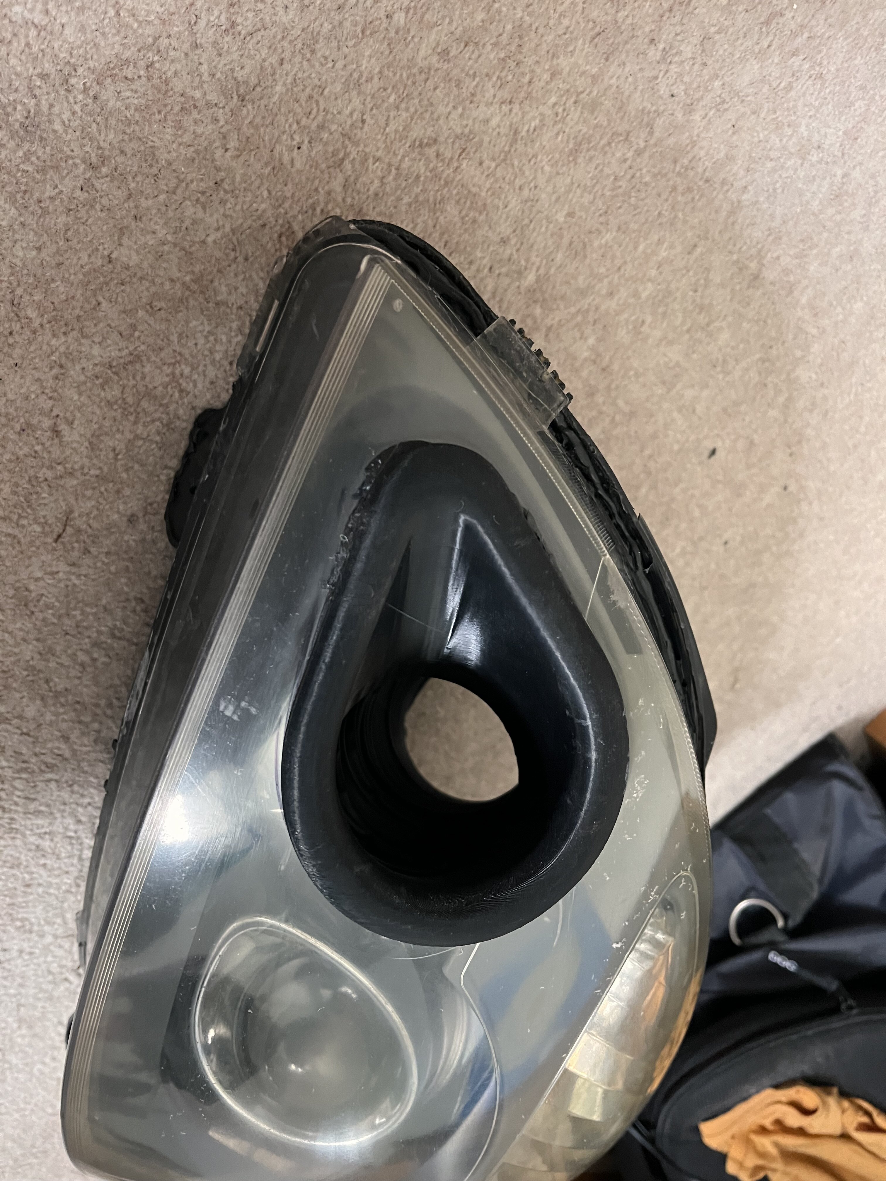

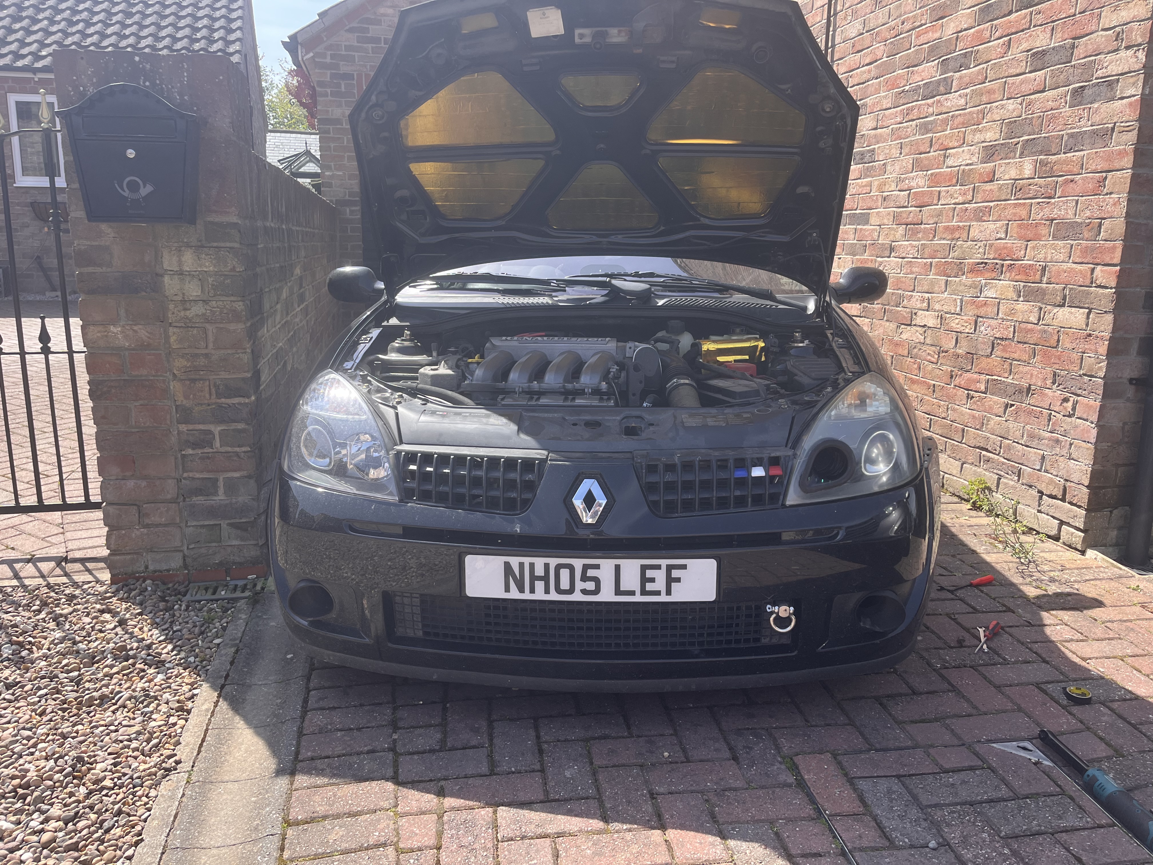

I realise now my pics make it look pretty crap. Will get some better ones where it doesn't look like its been put together by a one armed blind ape.whether it makes a difference or not I’ve been messing about and fitted a air intake in the headlight, not bad for a first attempt (not sure I’ll do it again though) and for the track car it’s grand.
View attachment 1689529View attachment 1689530
