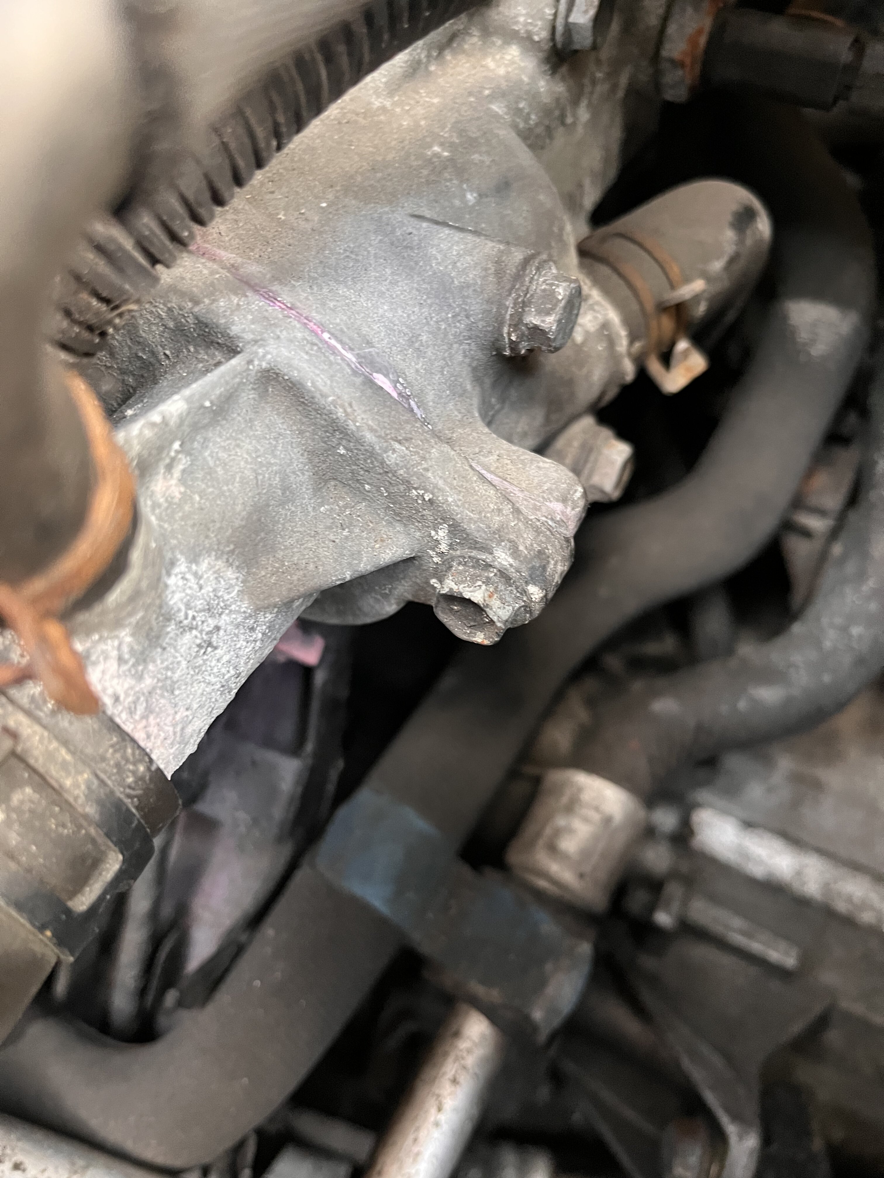

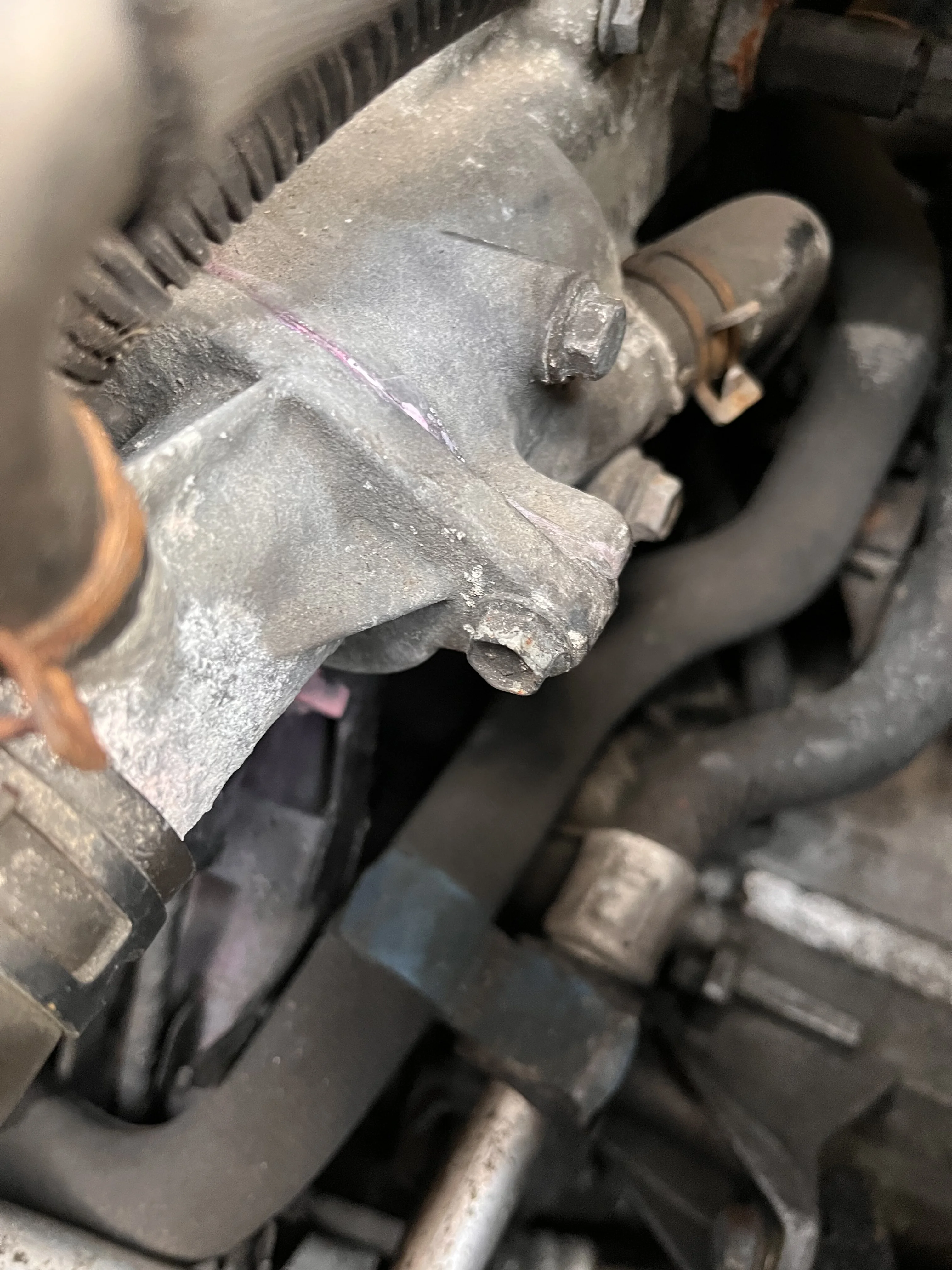

So, I’ve noticed at some point there has been a small leak from the thermostat but I can’t work out if there is a gasket and the o-ring for thermostat or just the o-ring? I’m tempted to change the hoses as well as they’re looking pretty tired and the last thing I need is a hose split!
It’s not leaking now and is never wet so not a major issue right now but if I’m taking all the hoses off I may as well fix it as well.
I think this has been the case on all my 182s as the mating surfaces on that housing are showing their age. I just replaced the thermostats, then added a bit of silicone and they've been gold. They especially seem to leak around the pipe going to the radiator, so again a bit of silicone around that too.

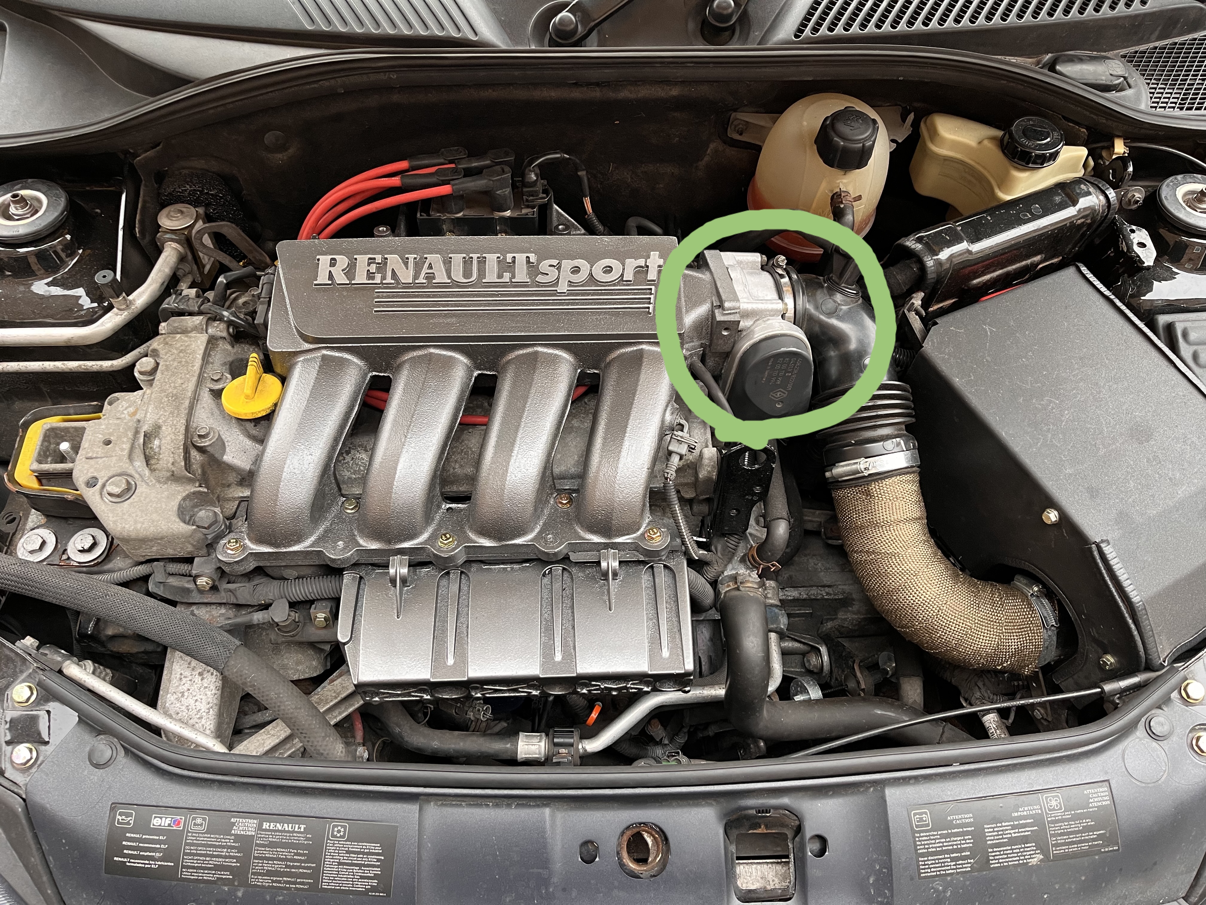

Finally I also managed to get a cold air intake from @04-182 its the same as @MrBlonde has and will allow a great deal more cold air to intake. I am also looking to block up some of the holes that go from the engine bay into the intake area to reduce the amount of hot air crossing over which should help a tiny bit with hot weather running.

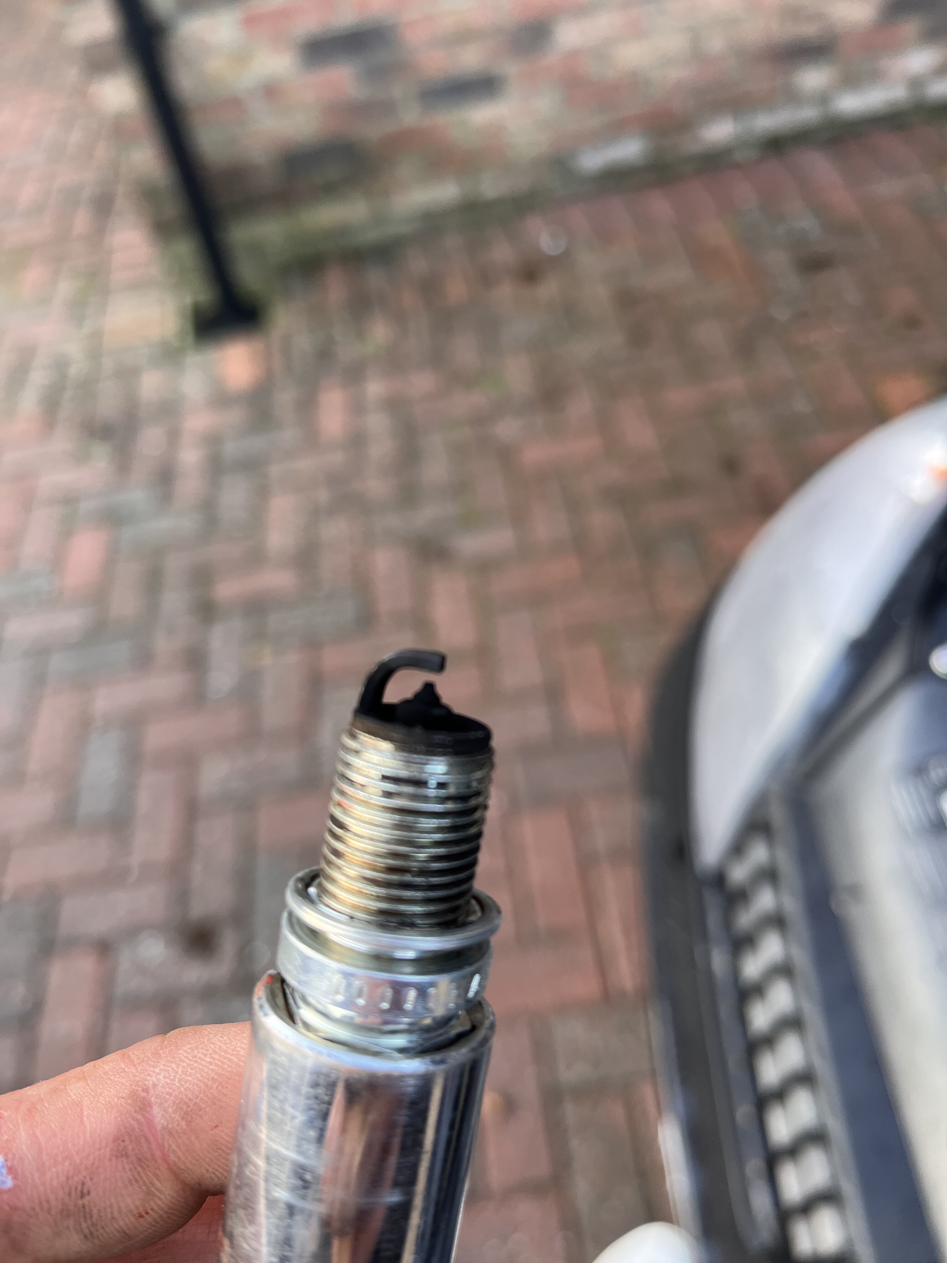

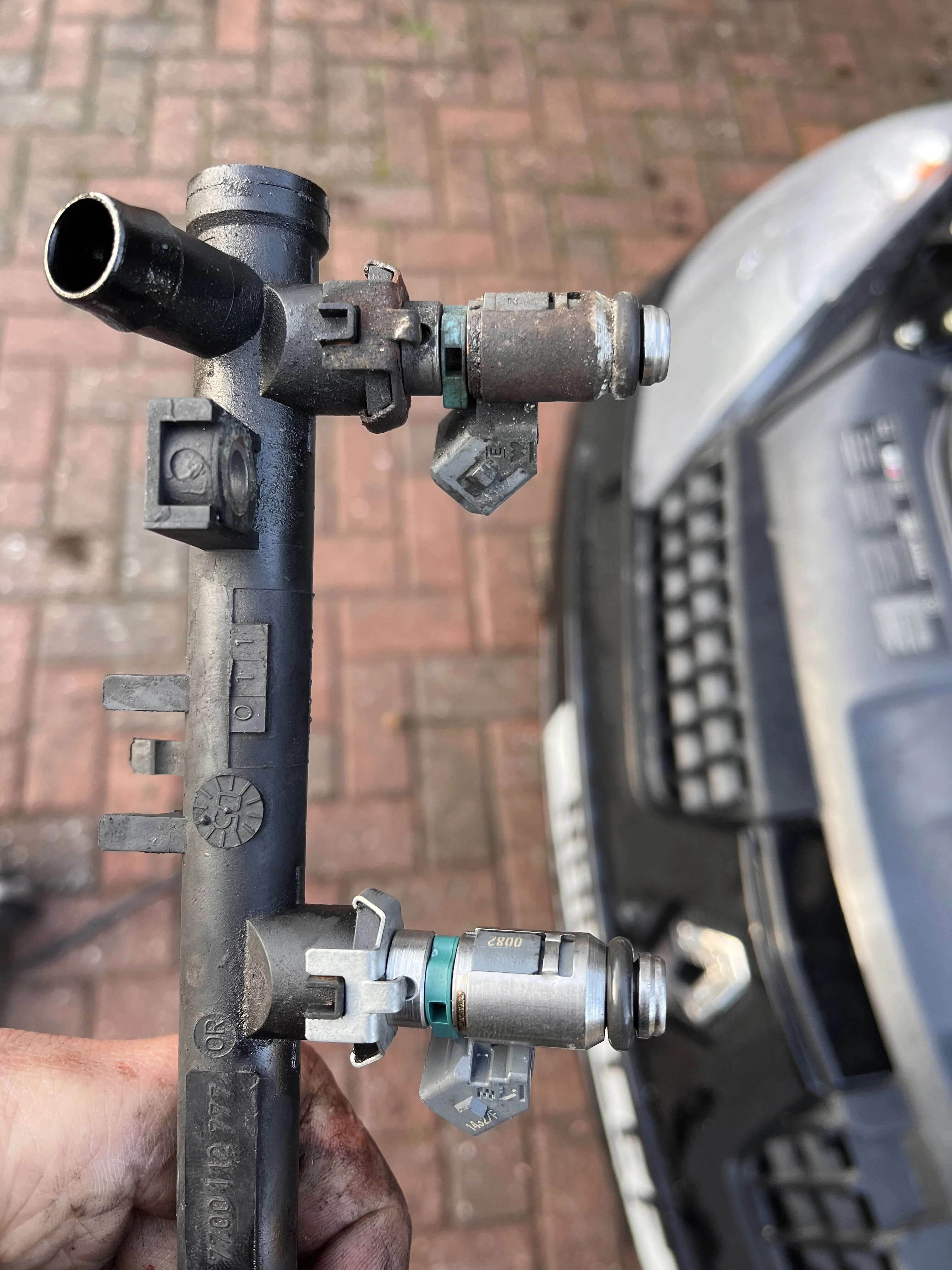

Soooo…. New injector in, checked the spark plugs just to make sure I had the right cylinder and pretty sure I did… no. 3
So went about changing it. I knew before i started what was about to happen, the fuel rail was pretty hard to get off due to oxidisation onto the injectors. But once off east enough to change.
all out back together and it started on the button but I’ve not got a cyclinder 4 misfire 🤣. Think I’ll just order 3 more injectors and be done with it.
Id change the rest. If you have access to clip, reset fuelling adaptives so it adjusts to suit. Its not 100% necessary but its like the icing on the cake.
Just bought 3 more. Sadly I don’t have Clip, might see if anyone local does. I do have a cheap icarsoft but guessing that won’t do it.
i knew as soon as i looked at them that I should have just got 4.
Its not necessary to do it, but its nice. Id imagine most mid range scanners might be able to reset fuelling adaptives.
I reset the throttle adaptives on mine whilst in and it ran class, the throttle was so responsive.

good to know, I’ll see what options it has and if not I’ll take it to my mates garage and get it done.
Cars almost un drive able at this point. Miss fires are worse now and getting about 20mpg so think I’ll park it up until spares arrive to get it sorted. May also end up putting new plugs in again as these are pretty coked up on 3&4 and I’m not sure that’ll resolve itself.

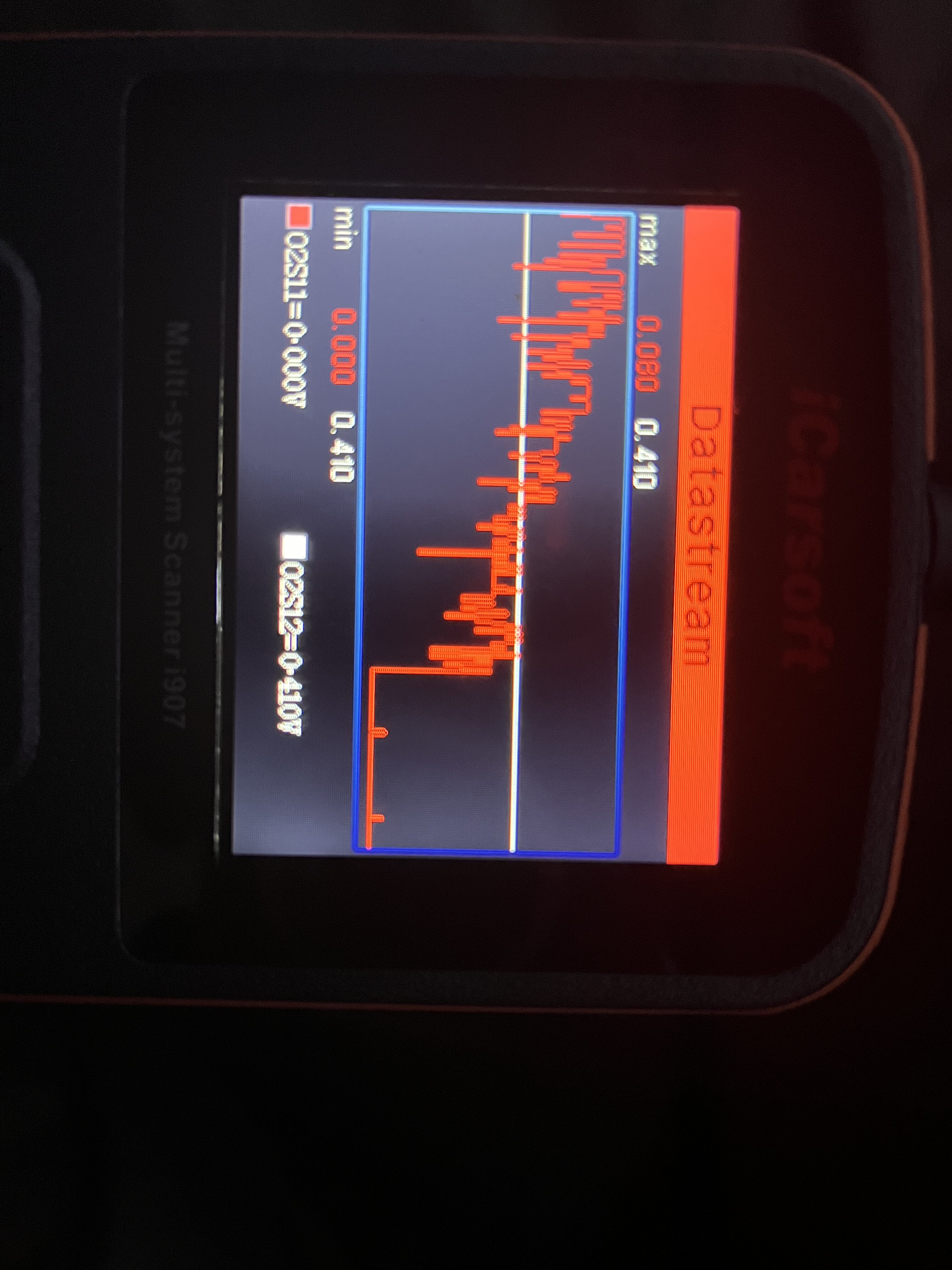

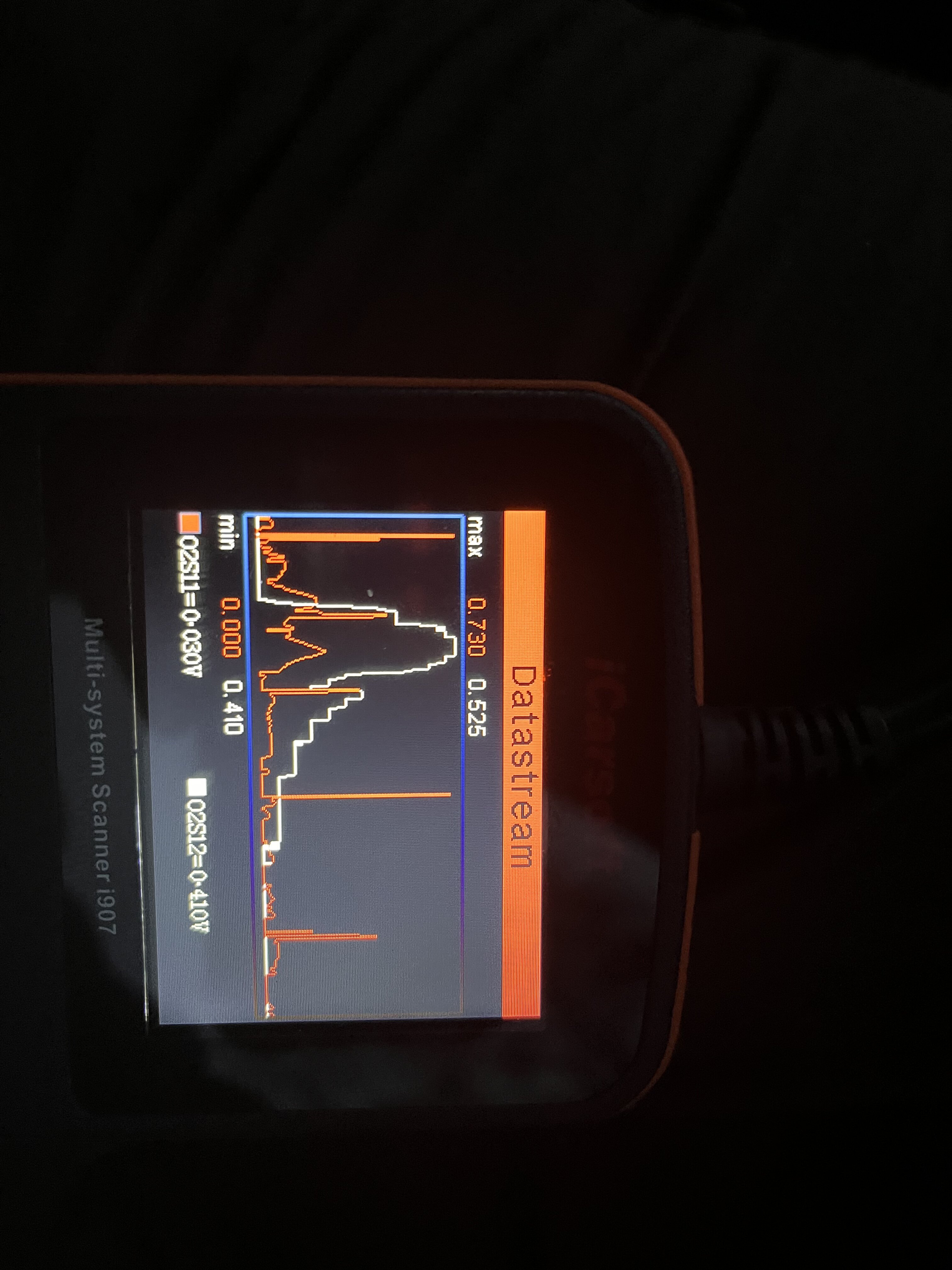

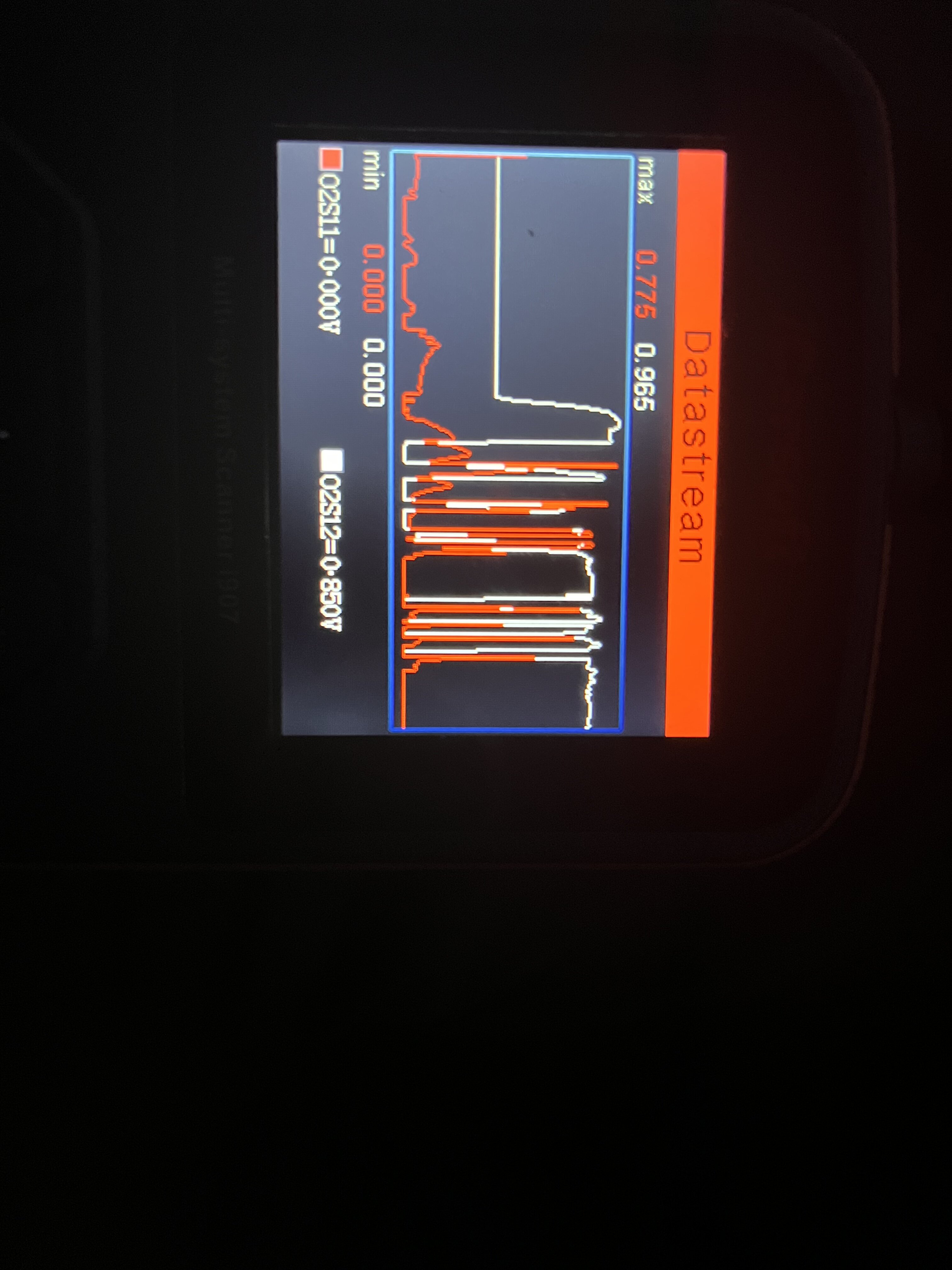

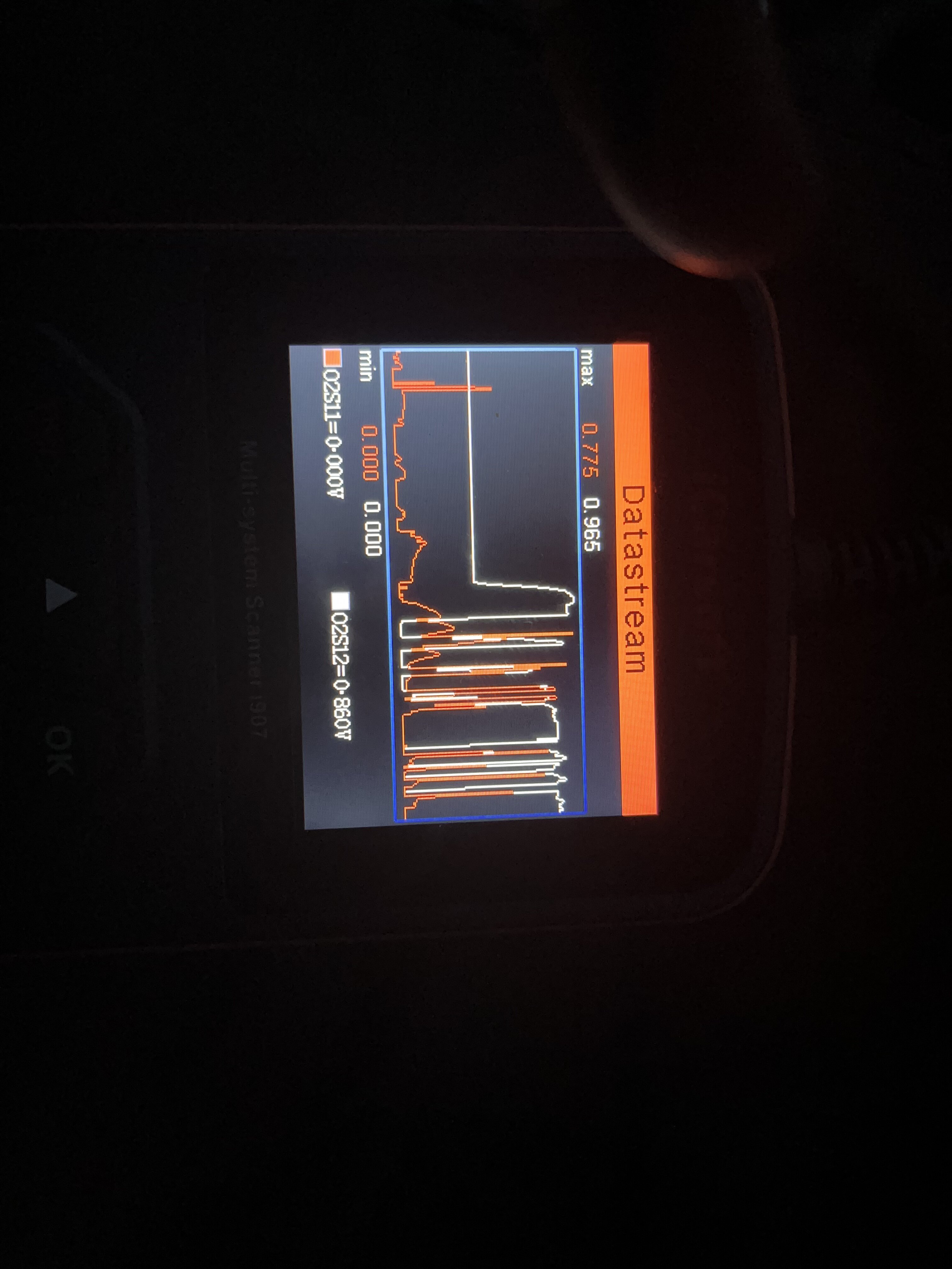

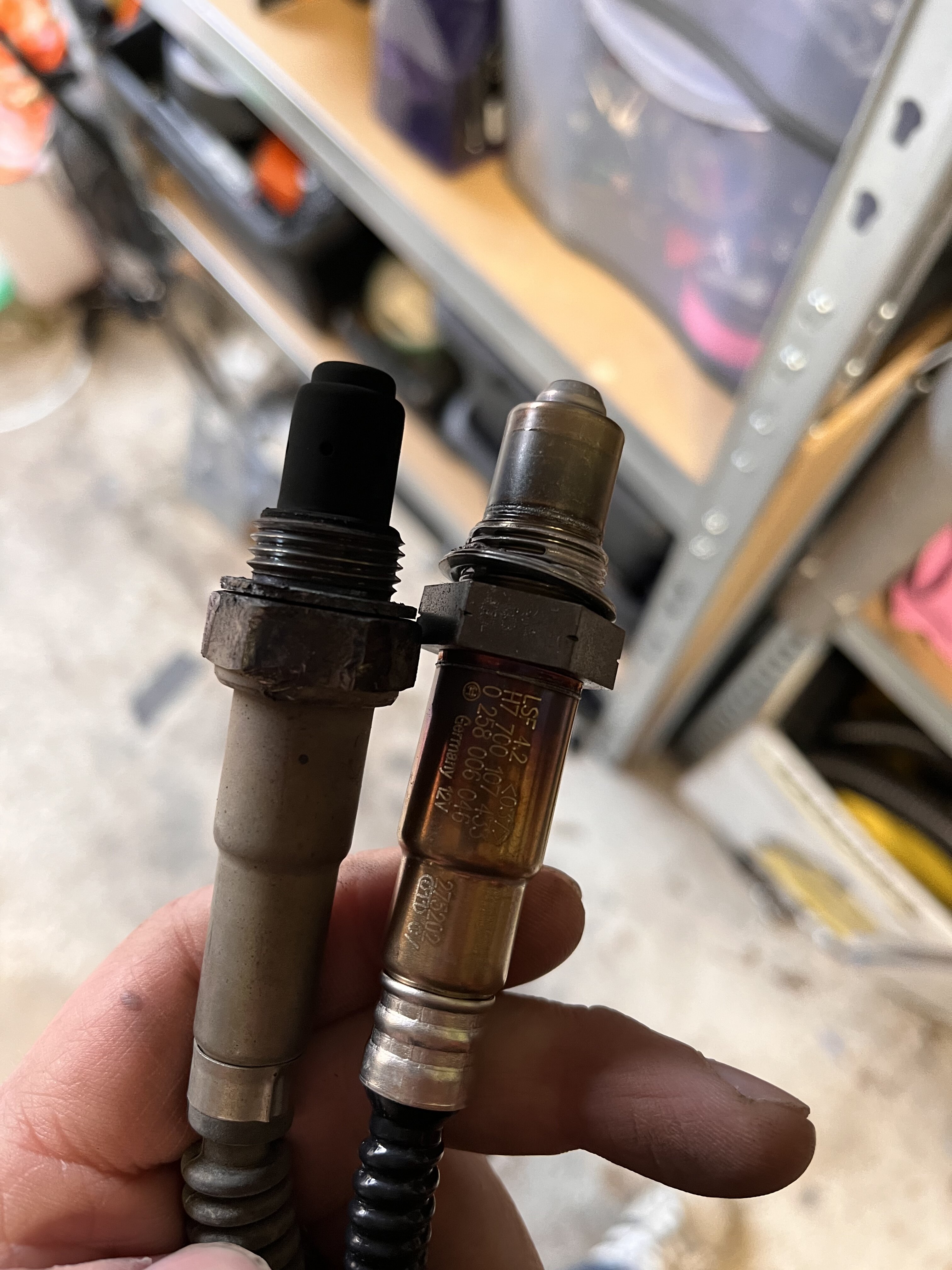

As I’m still waiting for Evri to deliver the new injectors that were handed to them on the 24th I went out and did some data logging on the o2 sensors. Im pretty sure the pre cat sensor is dead / dying as the following is what I’m seeing. It starts okay, slowly ebbs to 0v then when driving is all over the place high highs and low lows as well as some “okay” readings. I also wonder if this is connected to the misfires as I swapped out the cylinder 3 injector to cylinder 4 and now I have a cylinder 1 misfire lol.
On the drive static
driving
driving doing pulls
back on the drive
I have the new pre cat sensor so I’ll put that on at some point but really need the injectors as I’d like to do it all at the same time ideally.
but any thoughts on the above appreciated
I won’t bore with loads of photos but it’s all fixed. New o2 sensor made quite a big difference but it was still misfiring.
i ended up with 6 new injectors as EVRi delivered the AUTODOC ones today I announced and the ones I bought from ECP also arrived so now I have spares I guess.

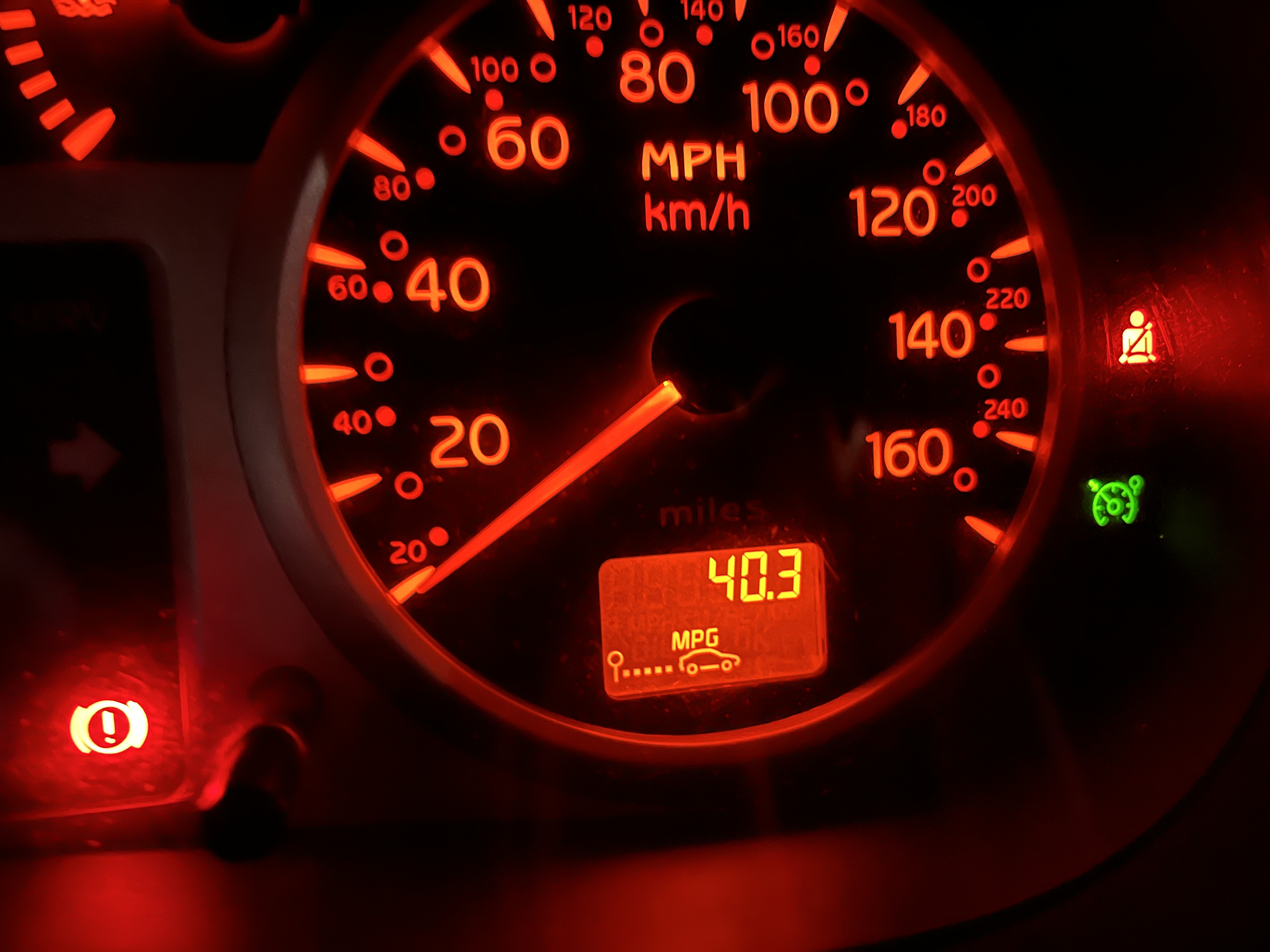

replaced all the injectors and she’s super smooth again, idles nicely and the codes haven’t come back. Pretty pleased all told.
I also suspect the o2 sensor was the overall cause as my mpg was never more than 30mph really but it’s now getting high 30s when pottering about. One to keep an eye on.

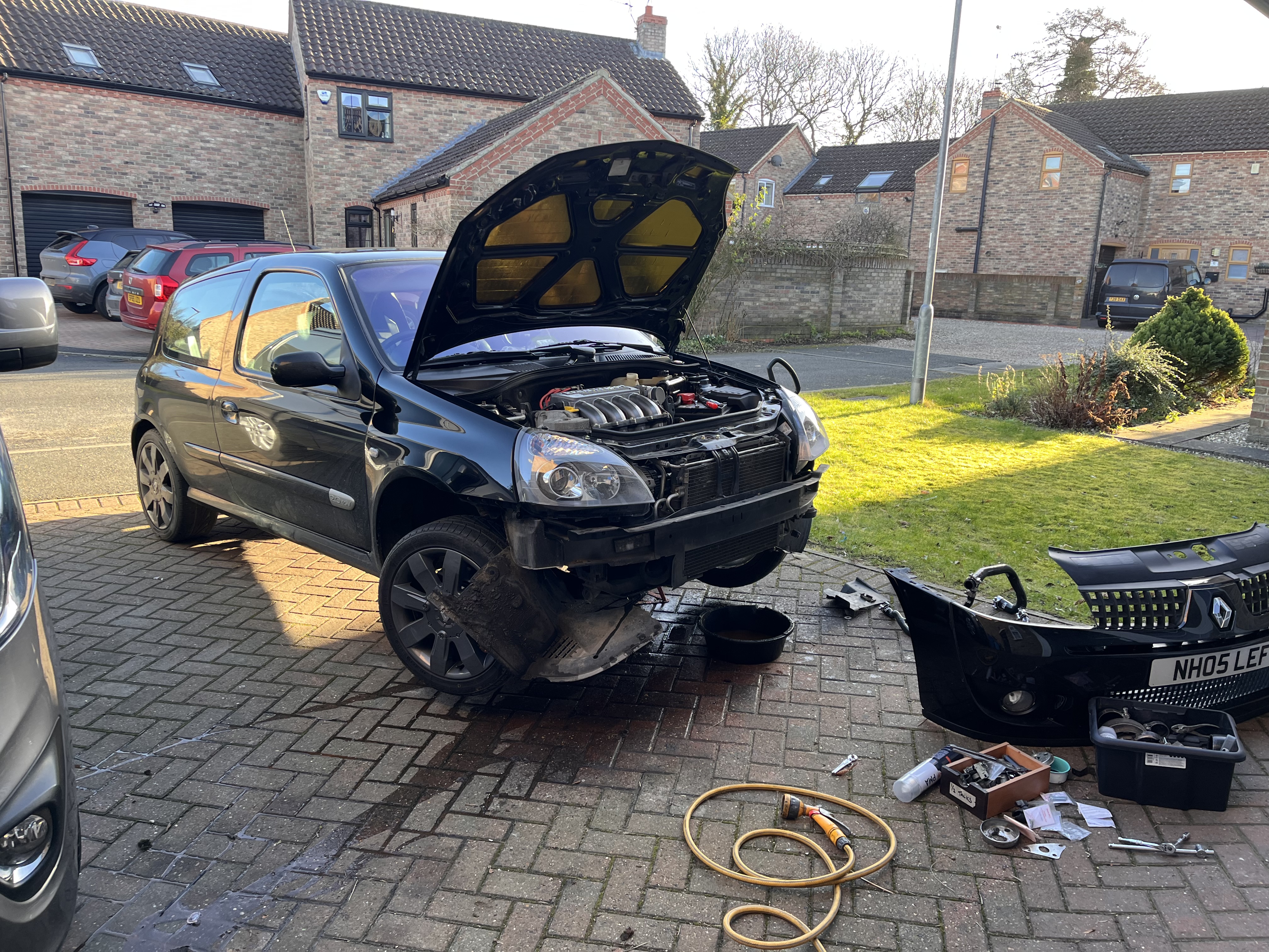

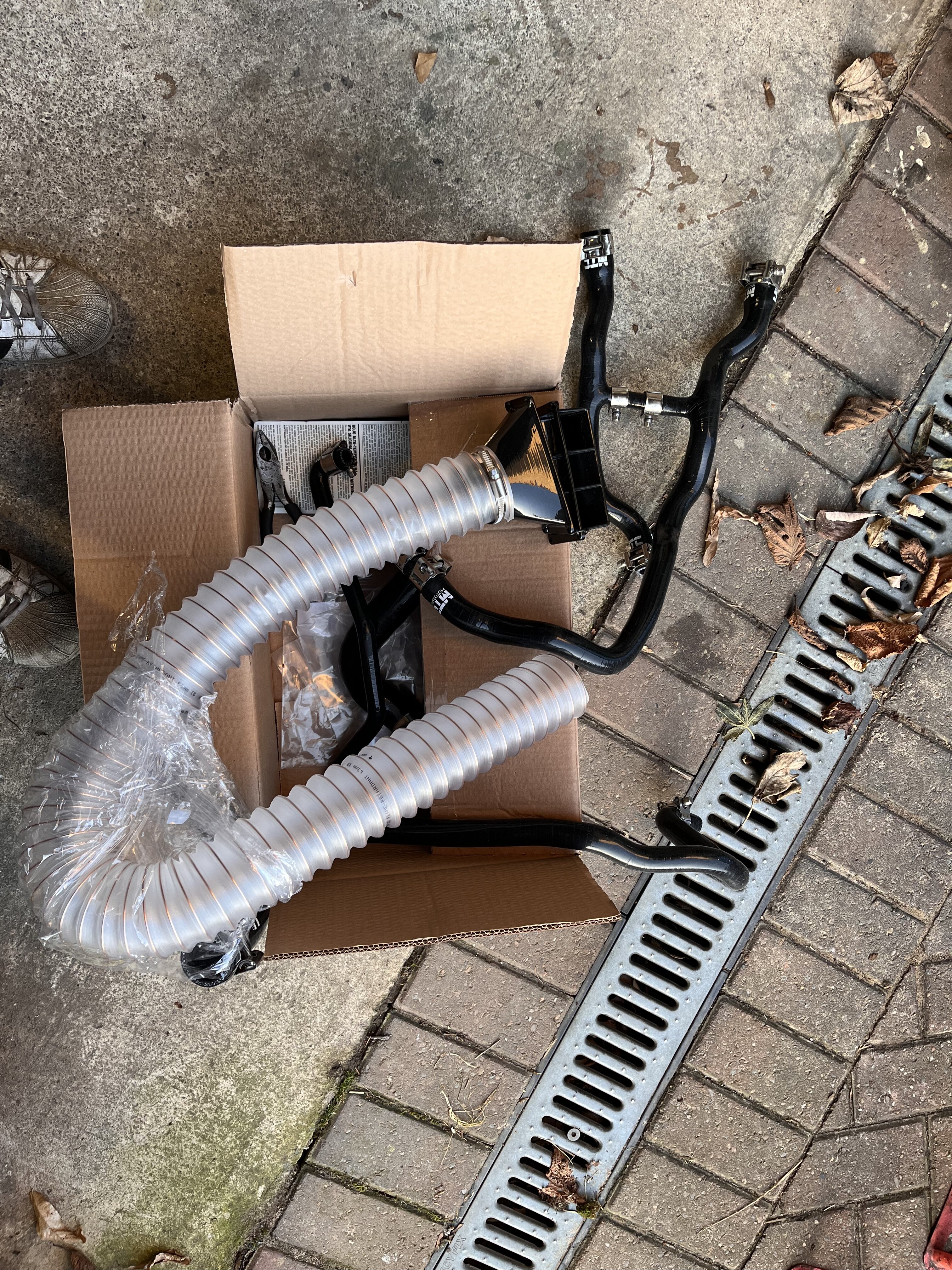

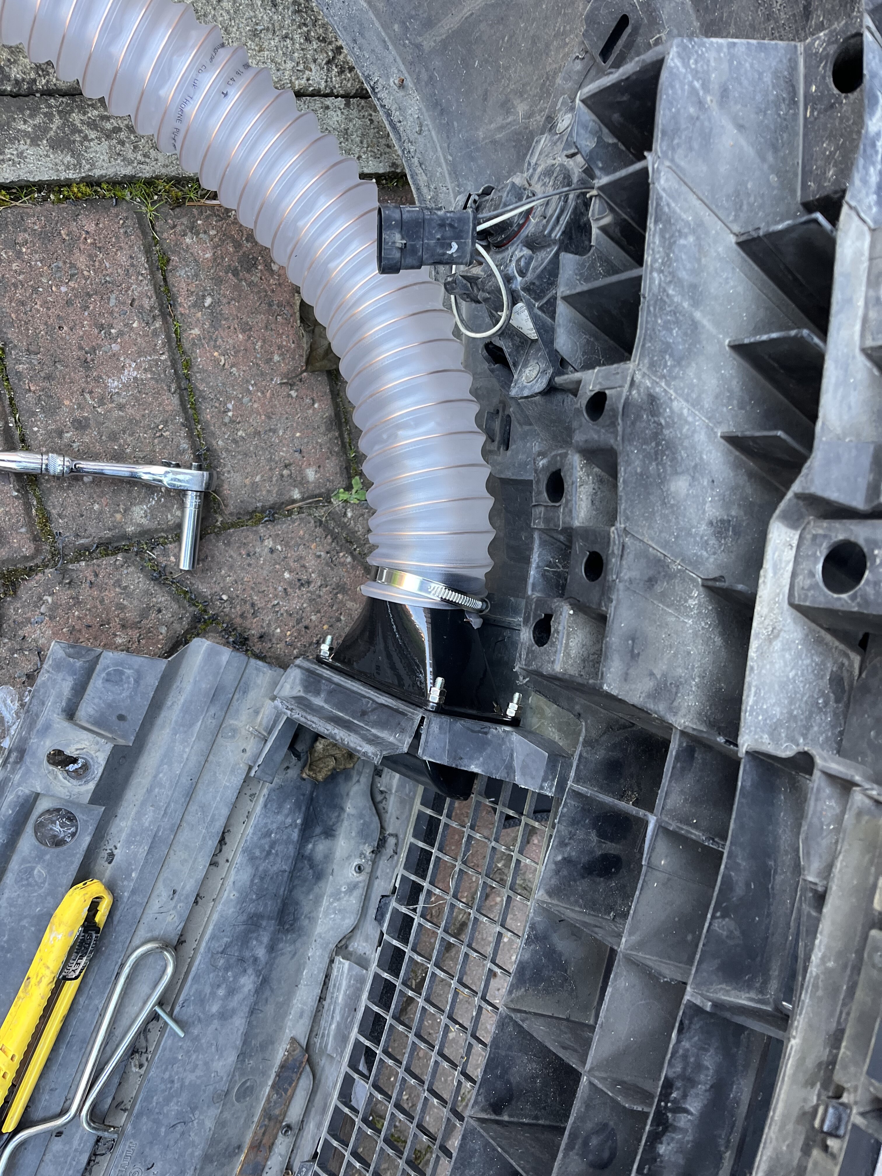

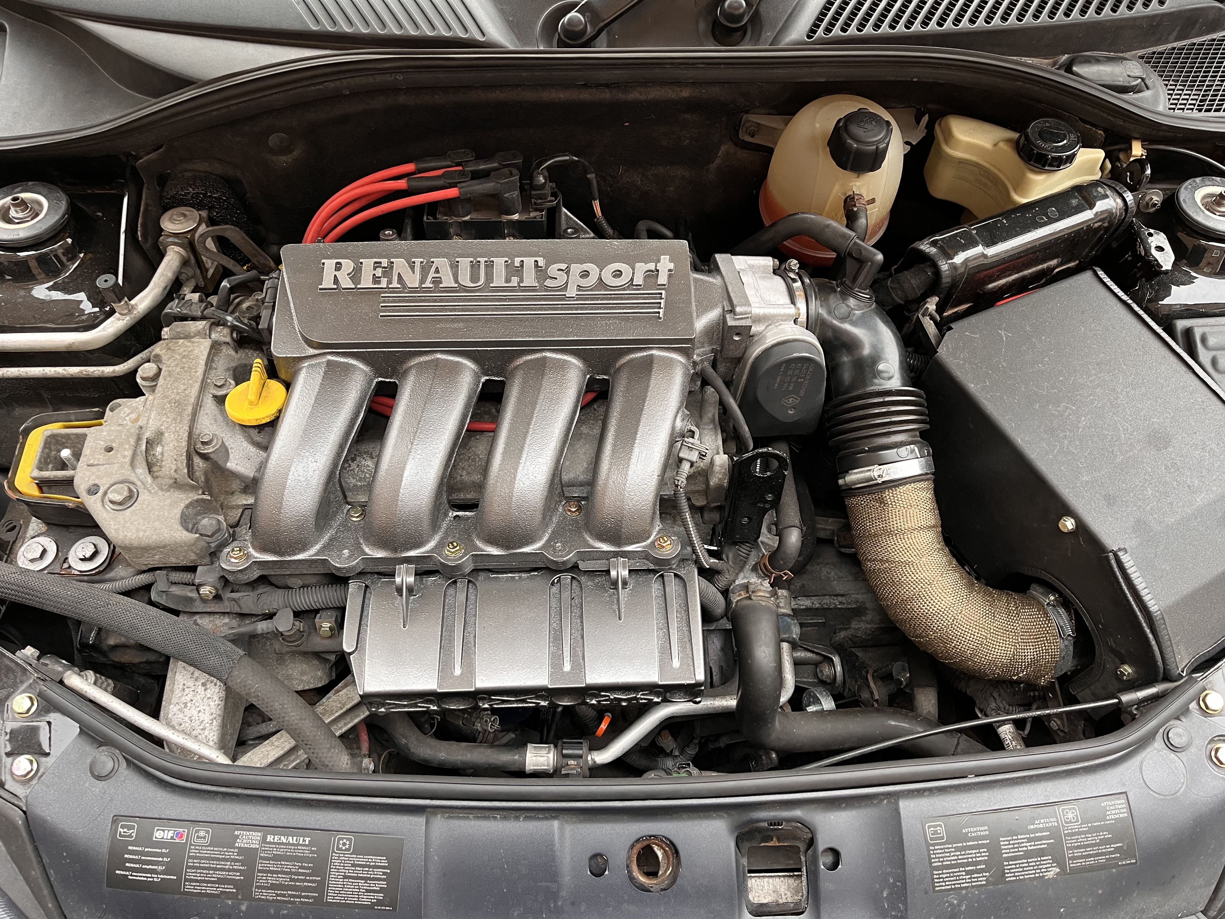

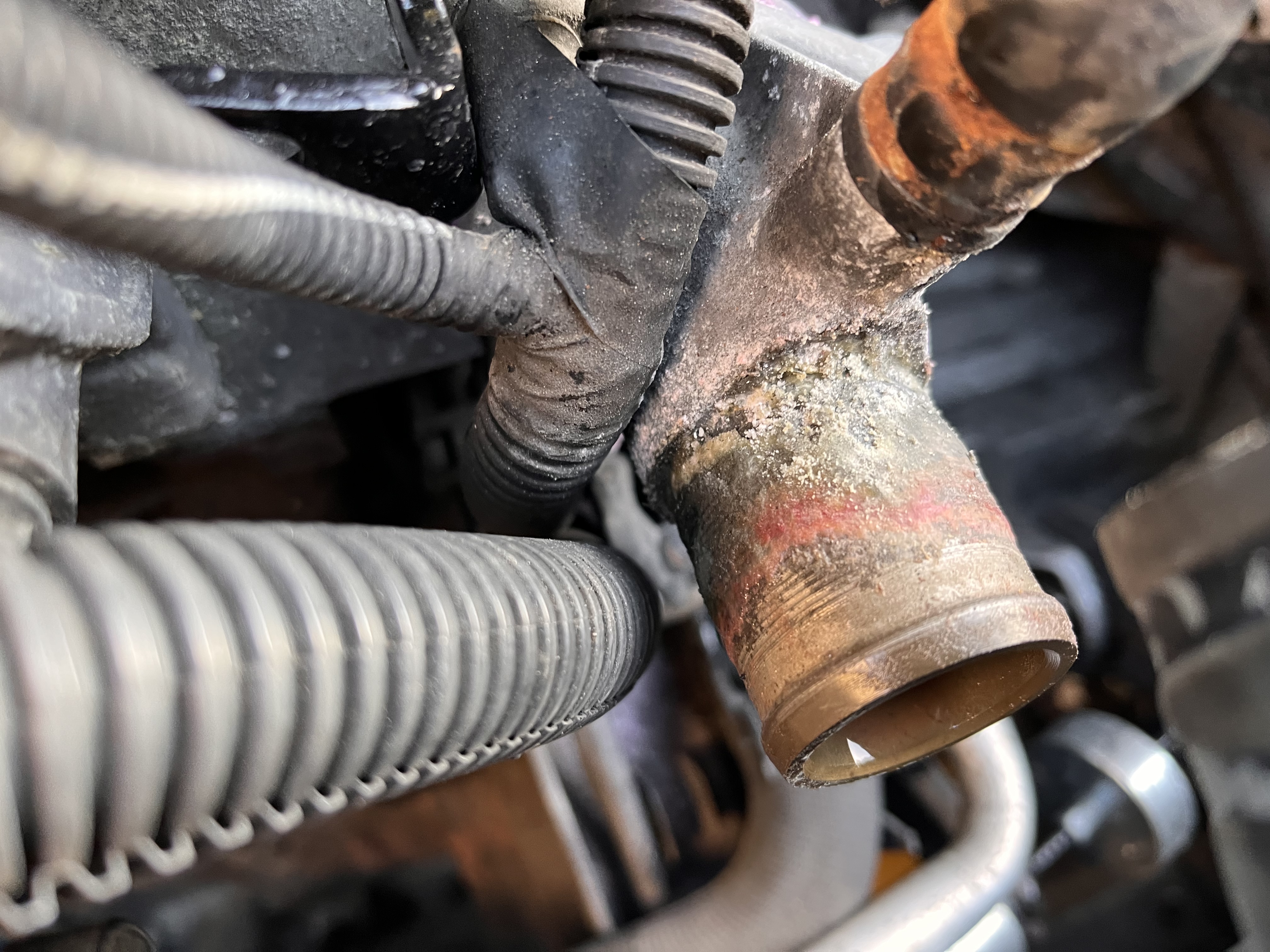

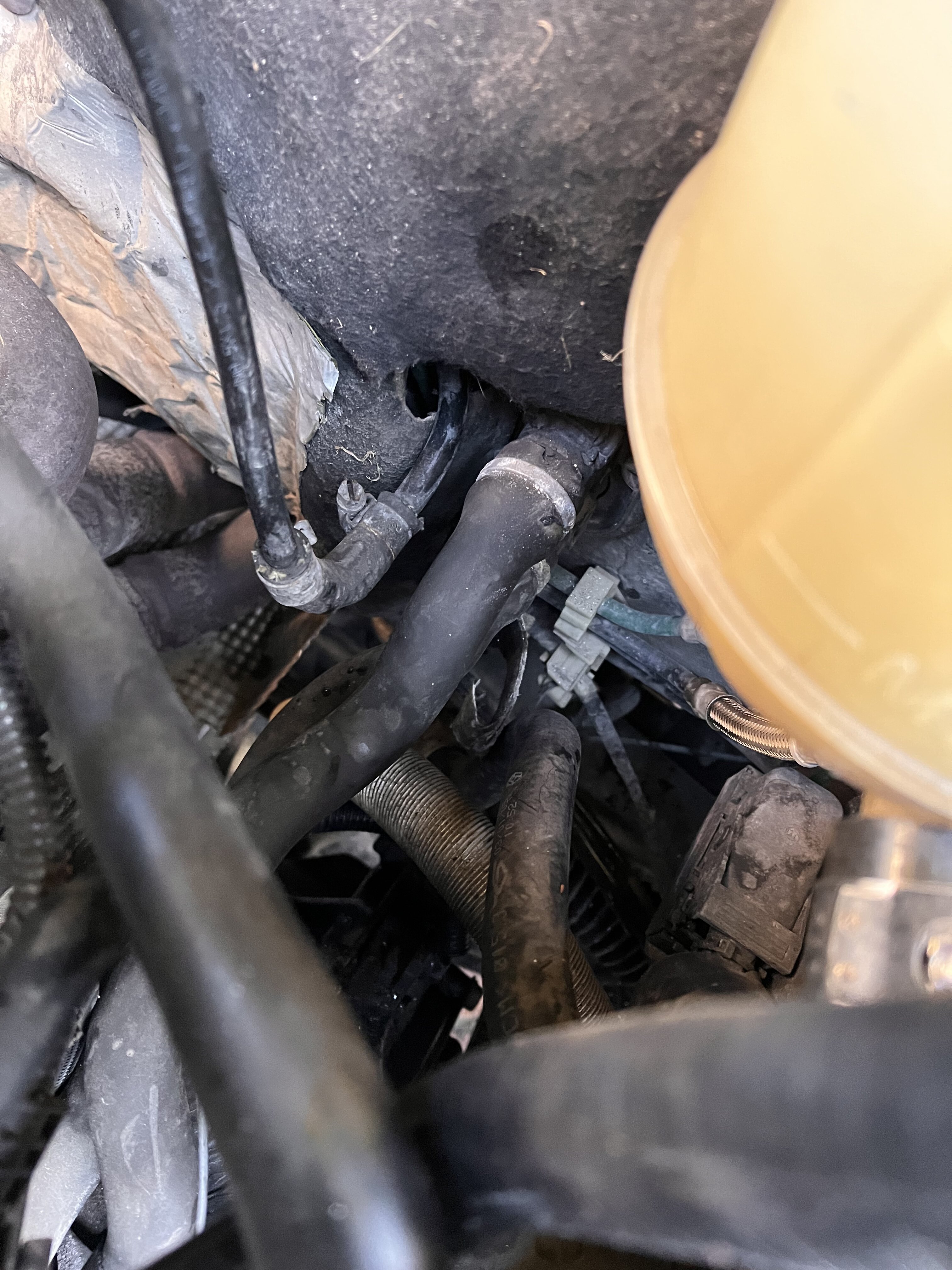

It’s been a while since I did much with the Clio but I’ve been collecting some parts, today I had some time and given I had a small coolant leak I replace the hoses and while the bumper was off I’d fit the cold air duct that @04-182 kindly supplied to me.
Reading others reports the main issue was going to be the plastic clips that go into the heater matrix, but all told it went okay save for some of the clips being the wrong size.
fair bit of crust from the small leak
all jacked up, getting pretty quick at taking the bumper off, might fit some quick releases

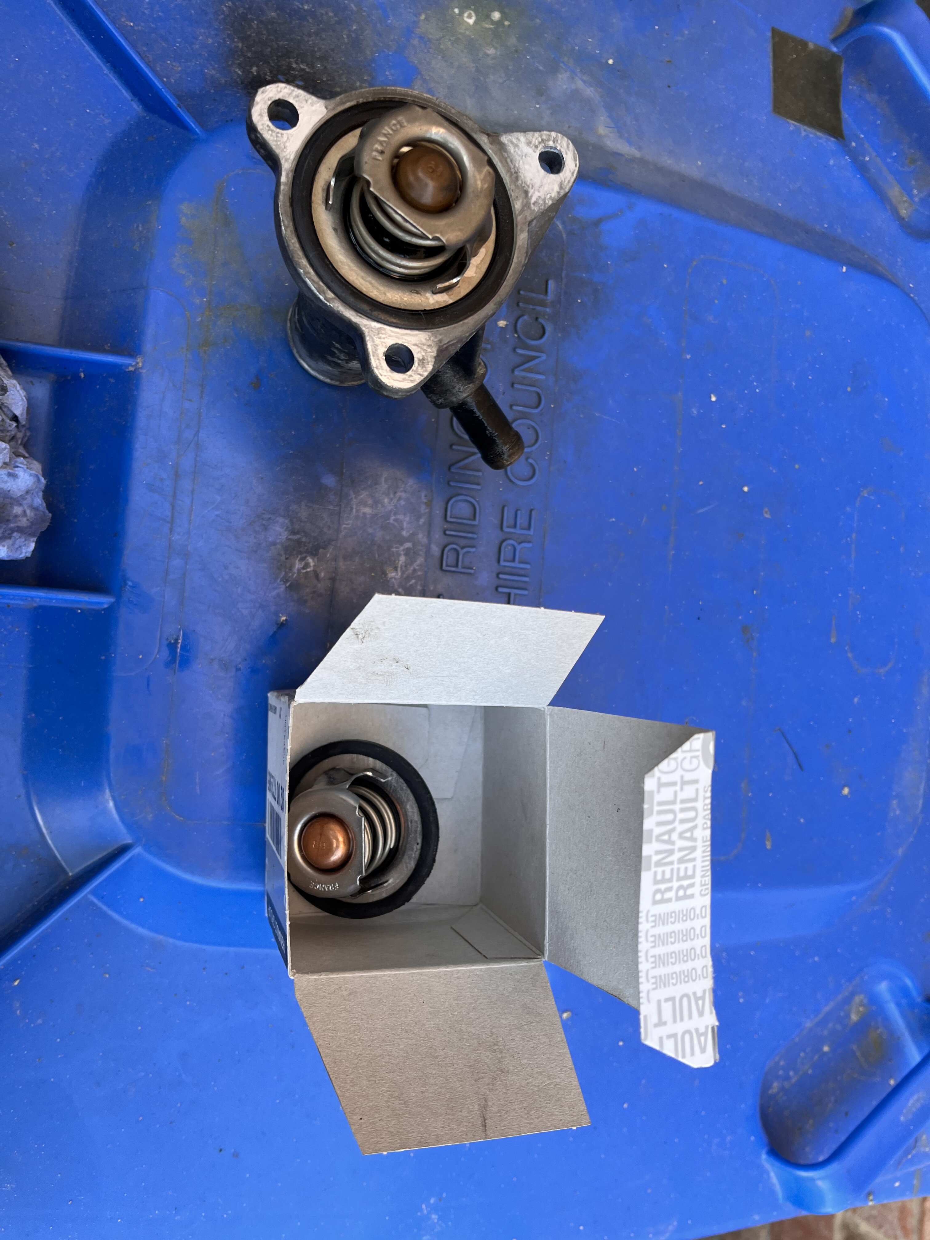

Also replaced the thermostat, didn’t need to really but while it was apart it seemed sensible.
what I did here was cut the metal clips off and left the plastic connected, then just pushed the new hoses on, seemed easier than disconnecting the actual clips
then once it was all done on to this

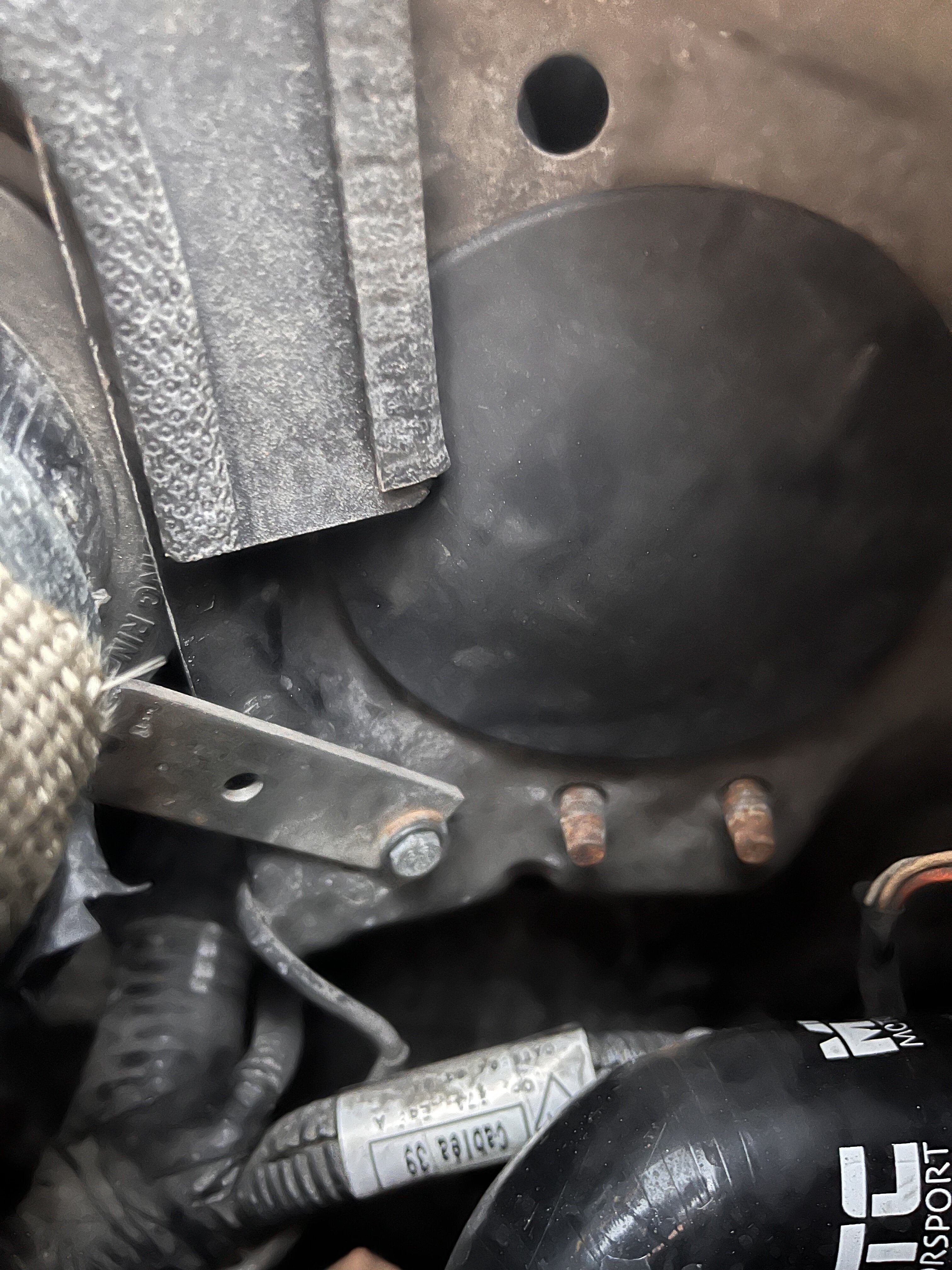

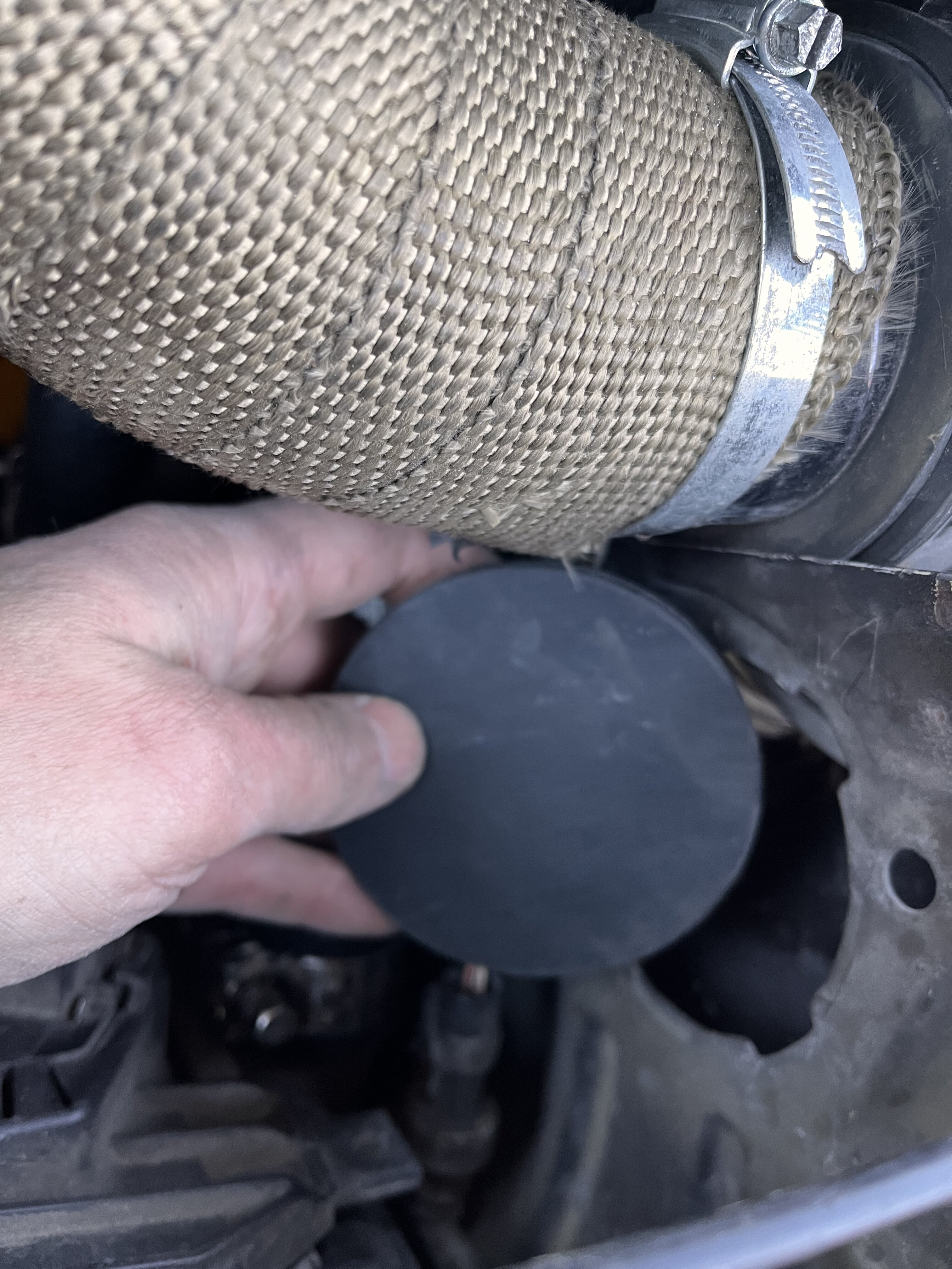

i also bought a cheap plug to over the hole near the headlight to just reduce the heat soak a bit.

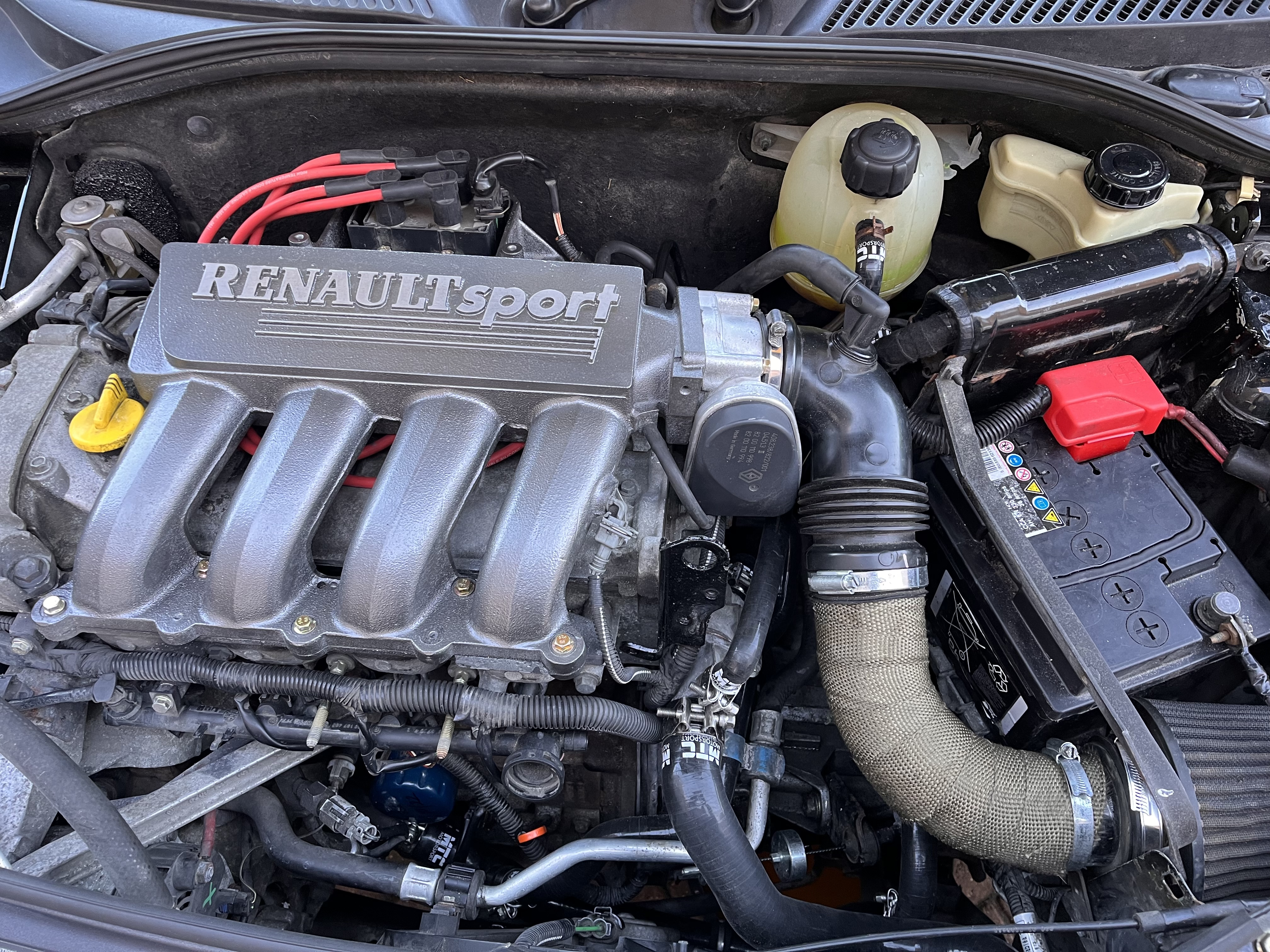

All done

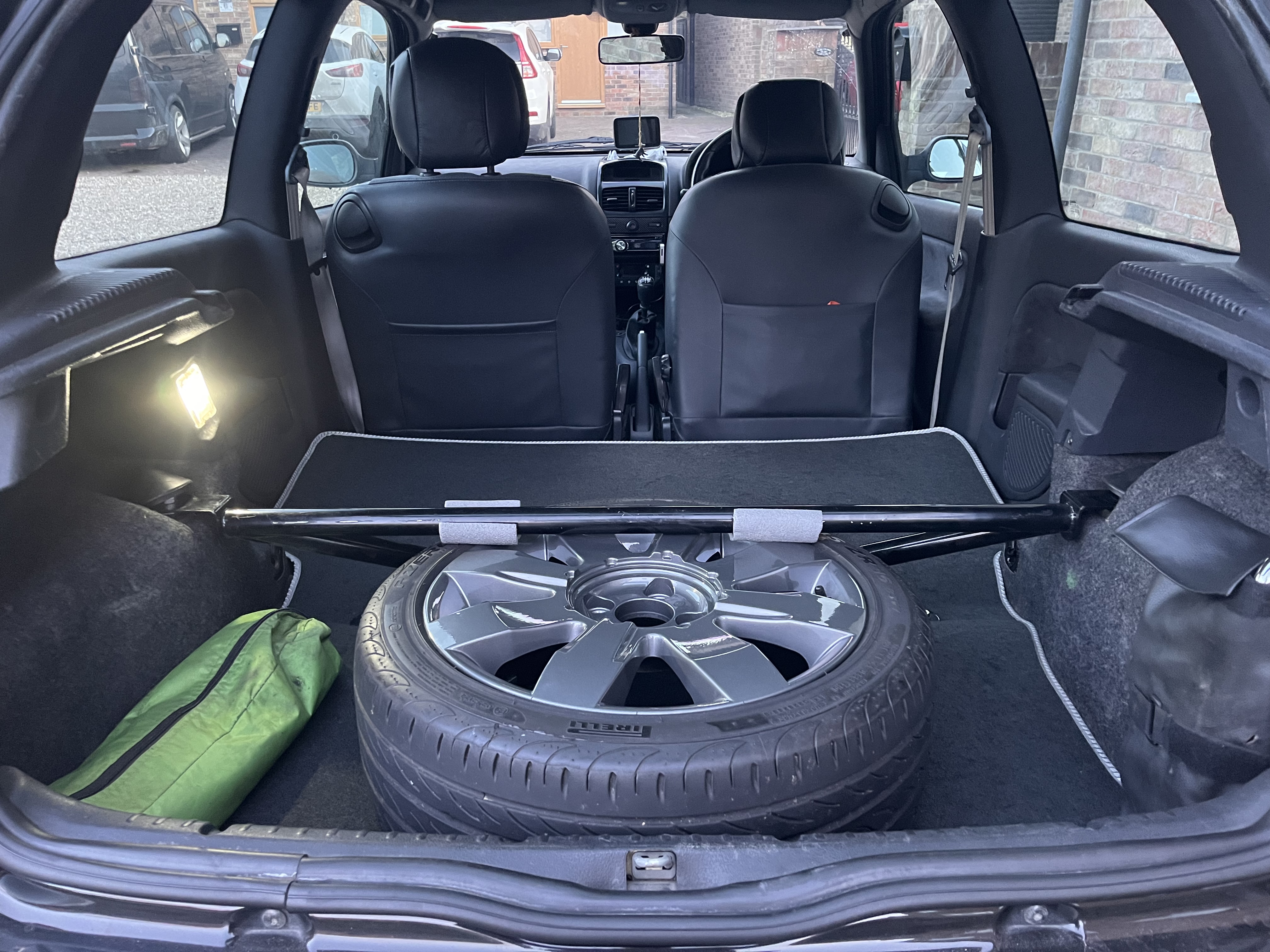

I also picked up a k-brace for cheaps as I fancied losing the back seats but wanted something to hold the spare wheel in place. Works a treat. Just need the carpet to arrive

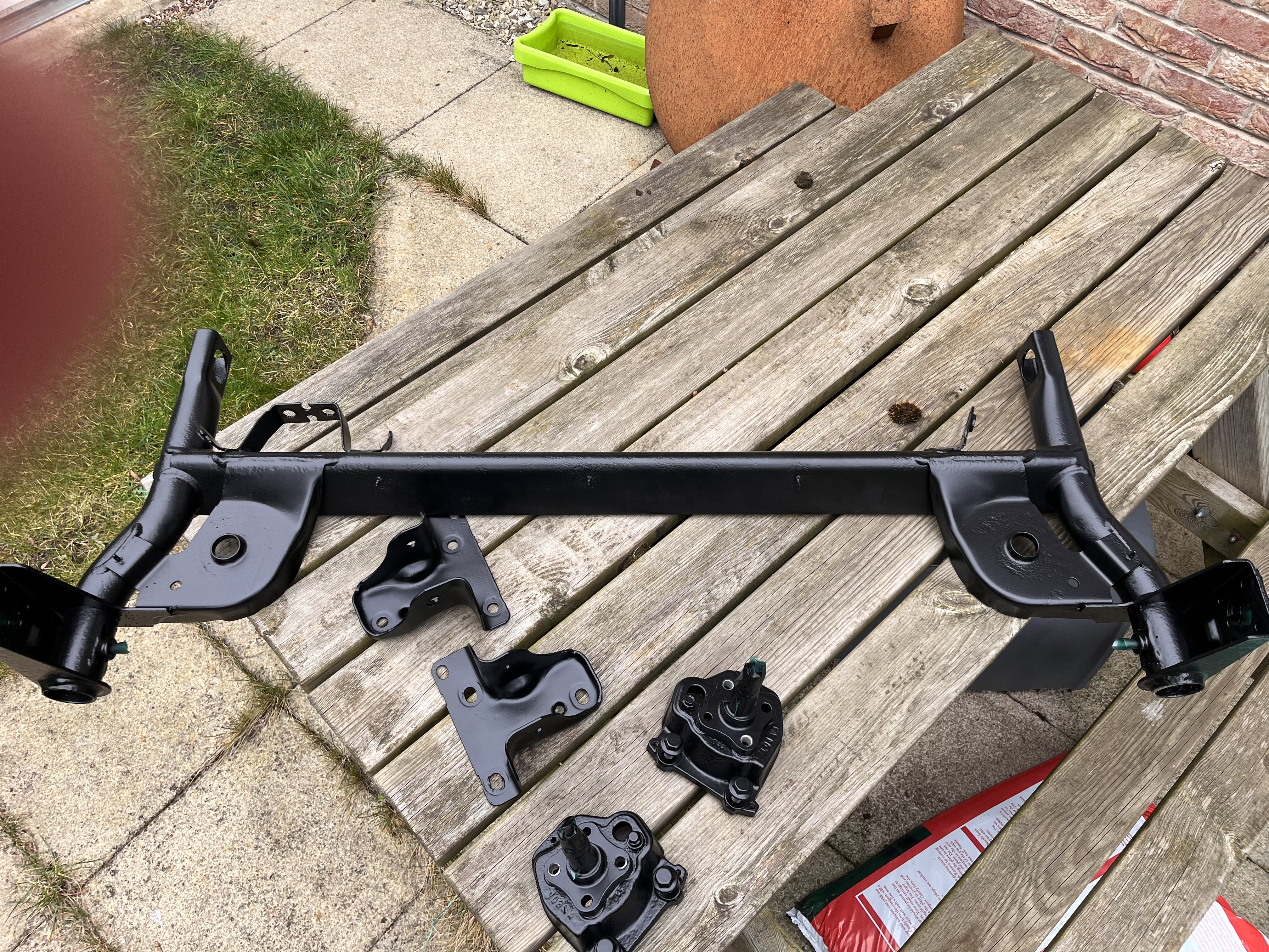

the rear axle I got is at the powder coater, I’ll be taking the subframe etc over next week then I’ll be getting on with swapping them over.
All done

What size is the blanking plug you used?
