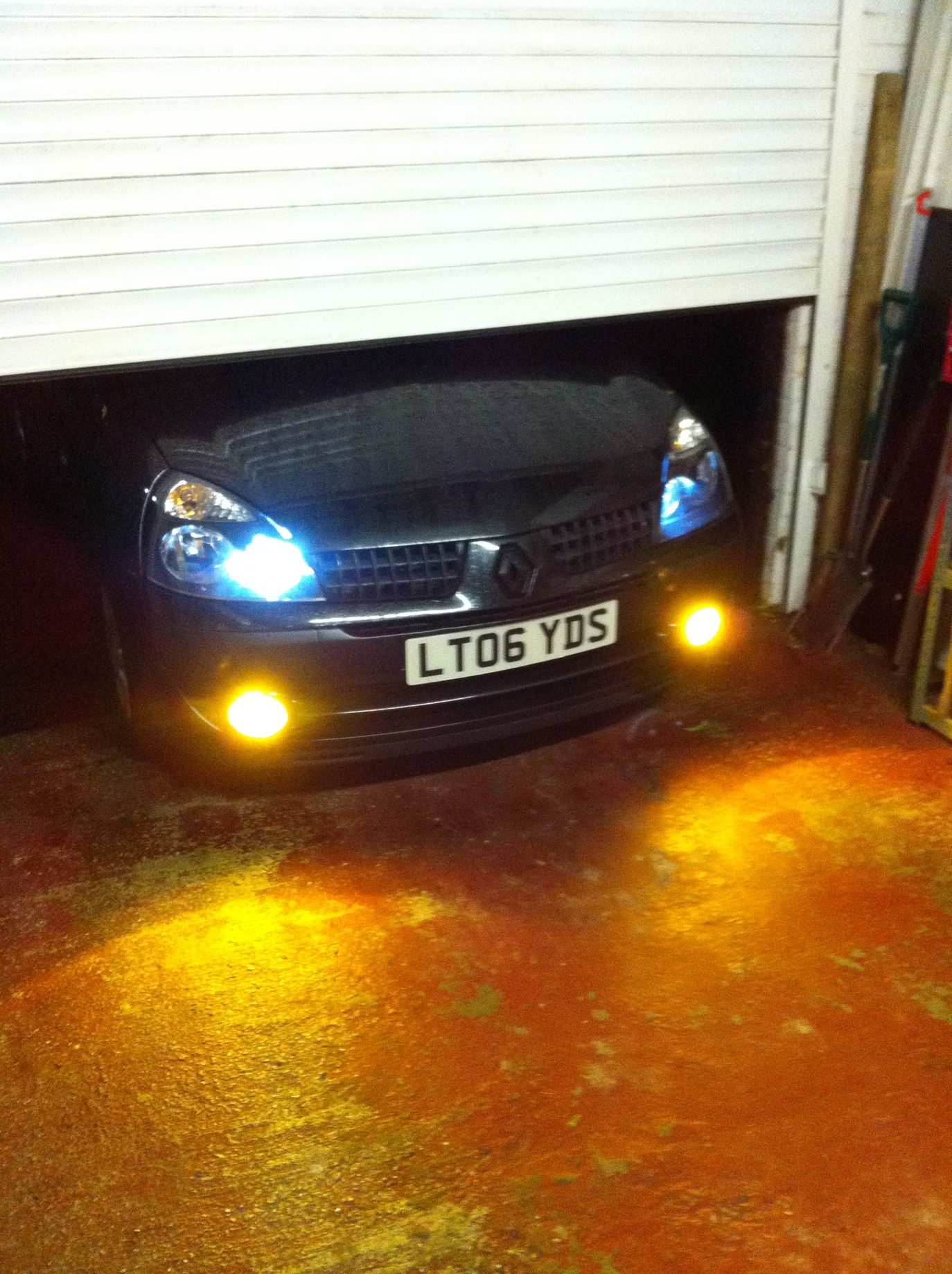

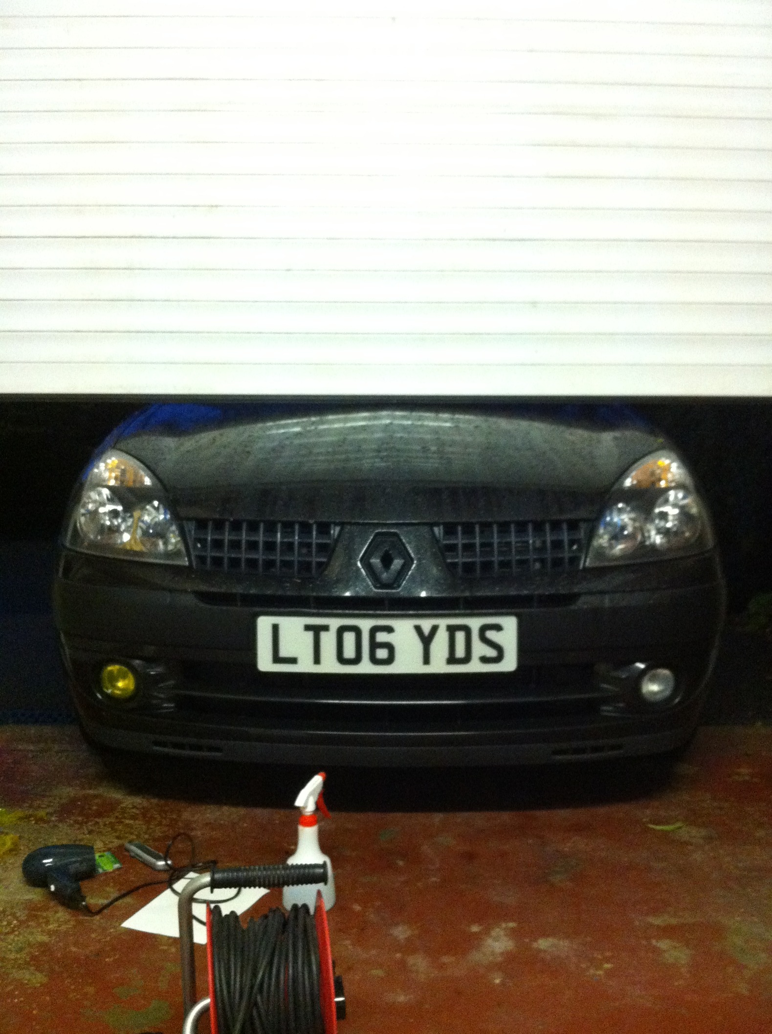

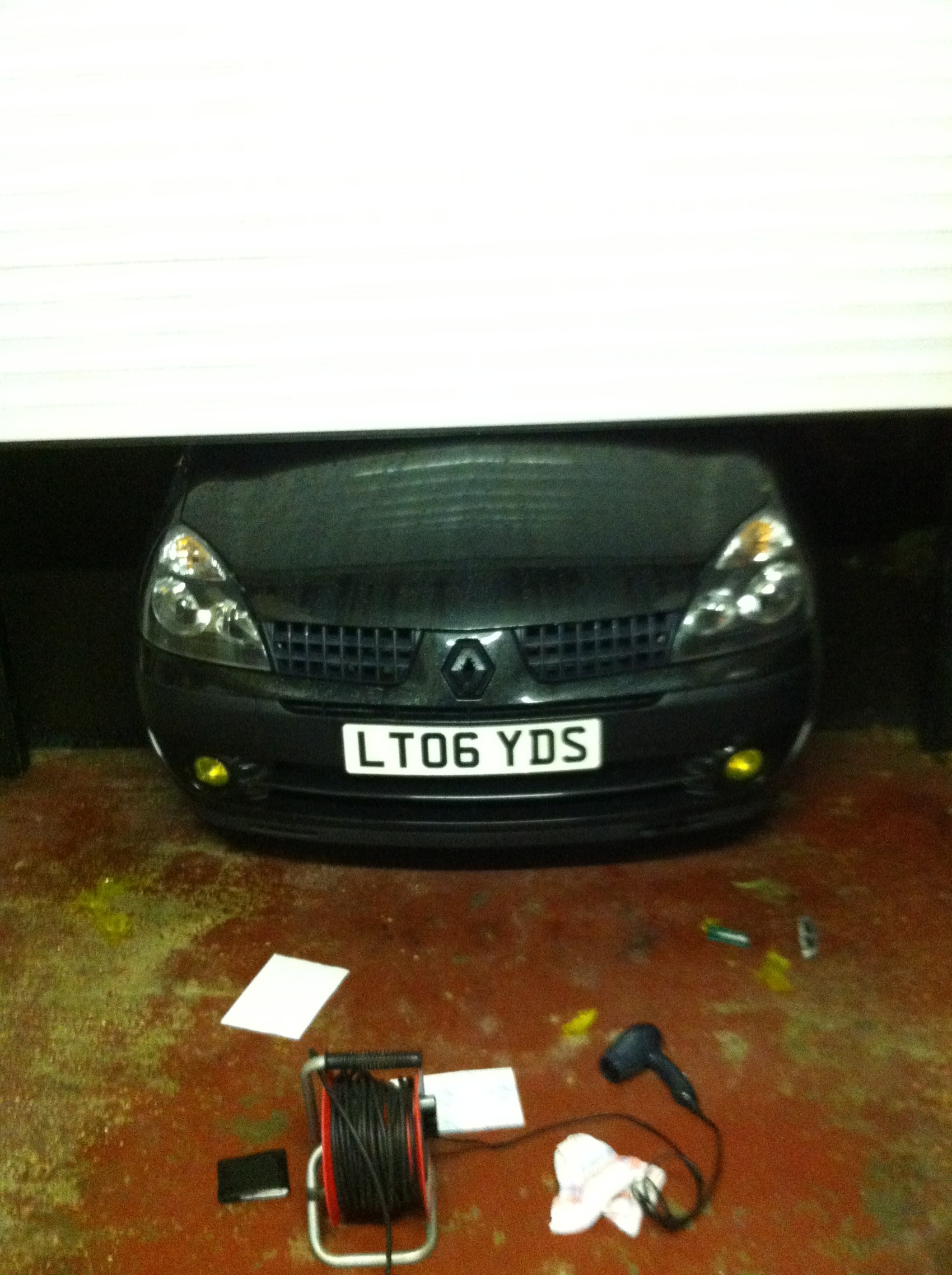

Got a couple of things done recently. Tinted the fogs last night in a moment of boredom, didn't come out too badly!
And done!

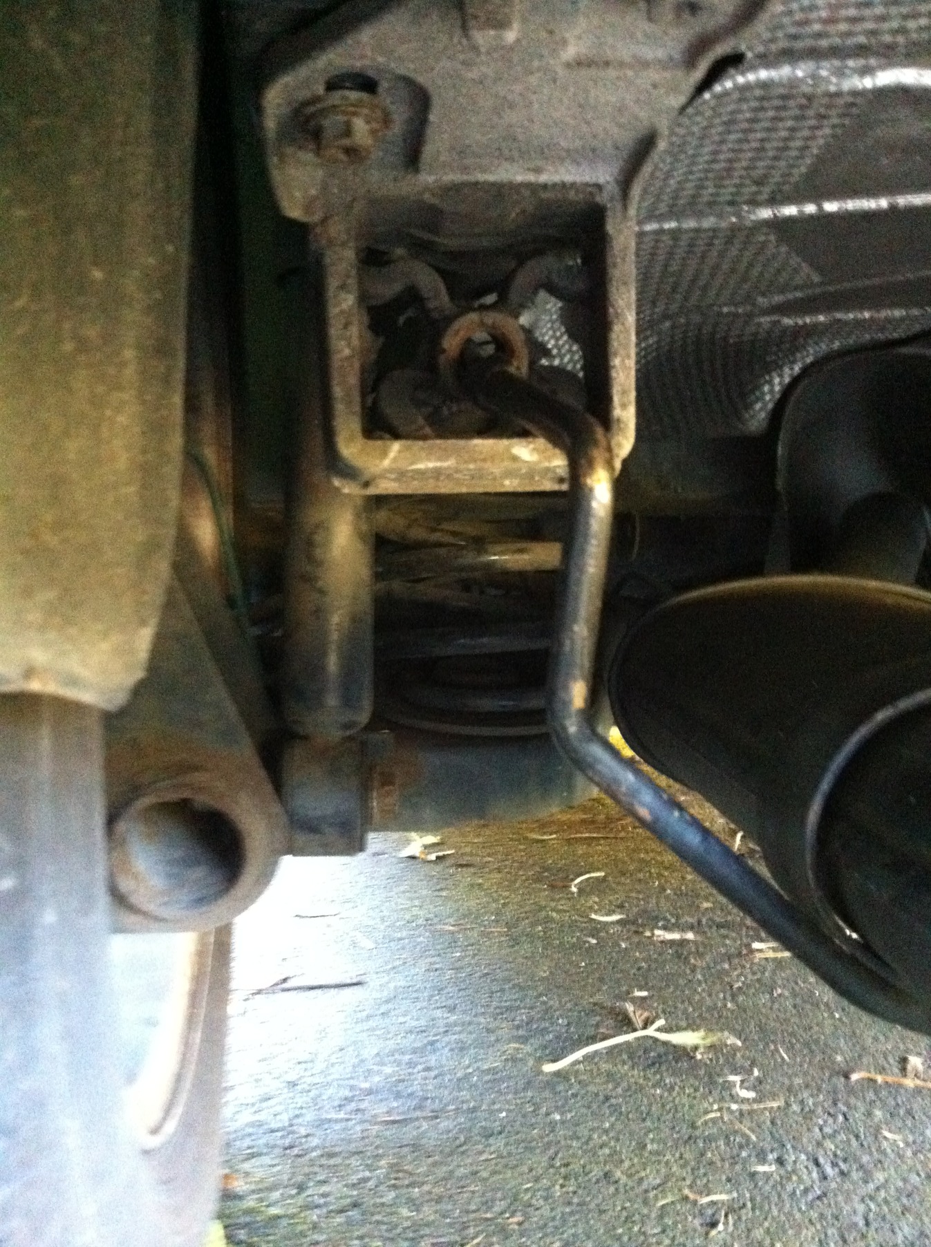

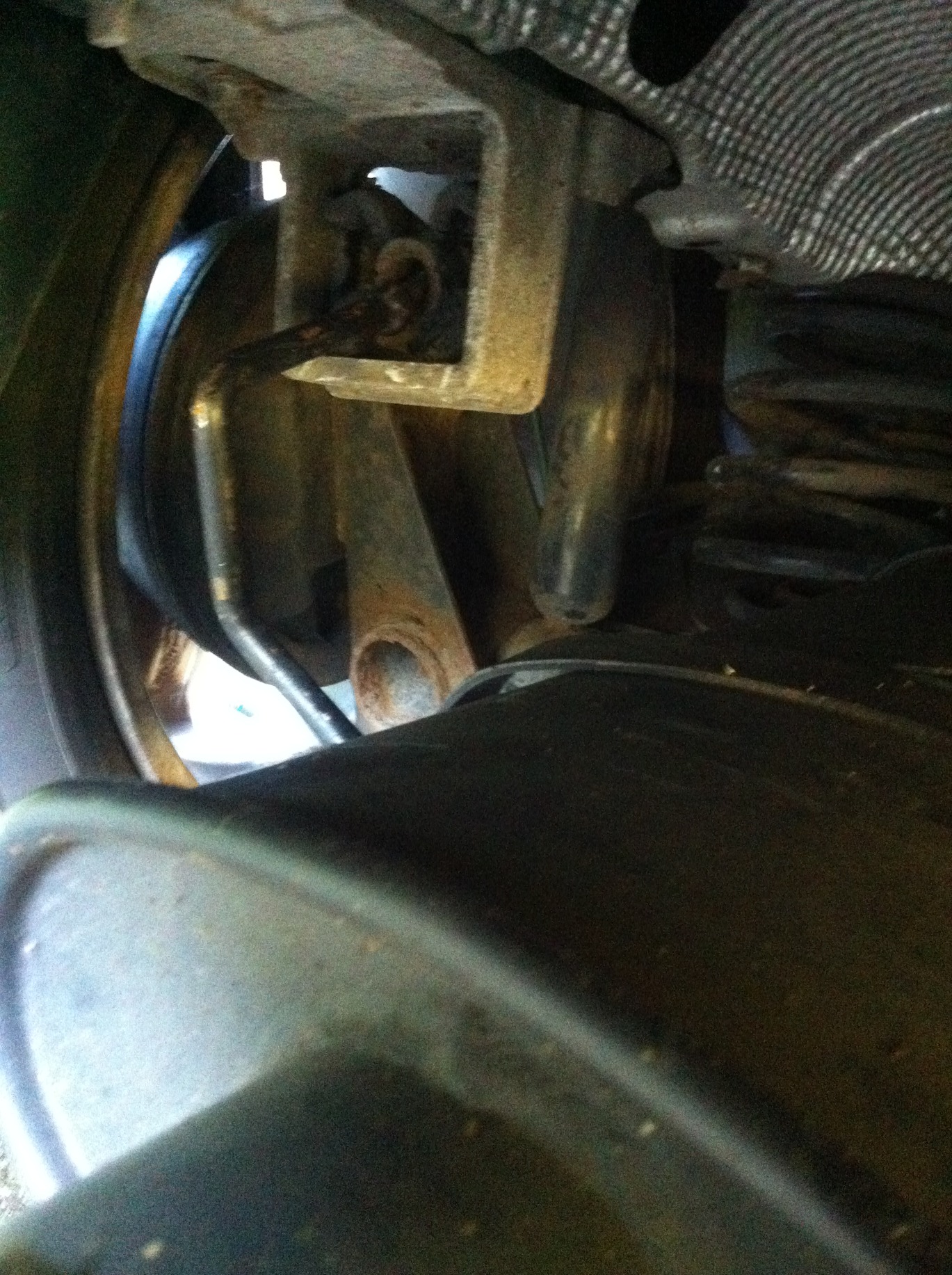

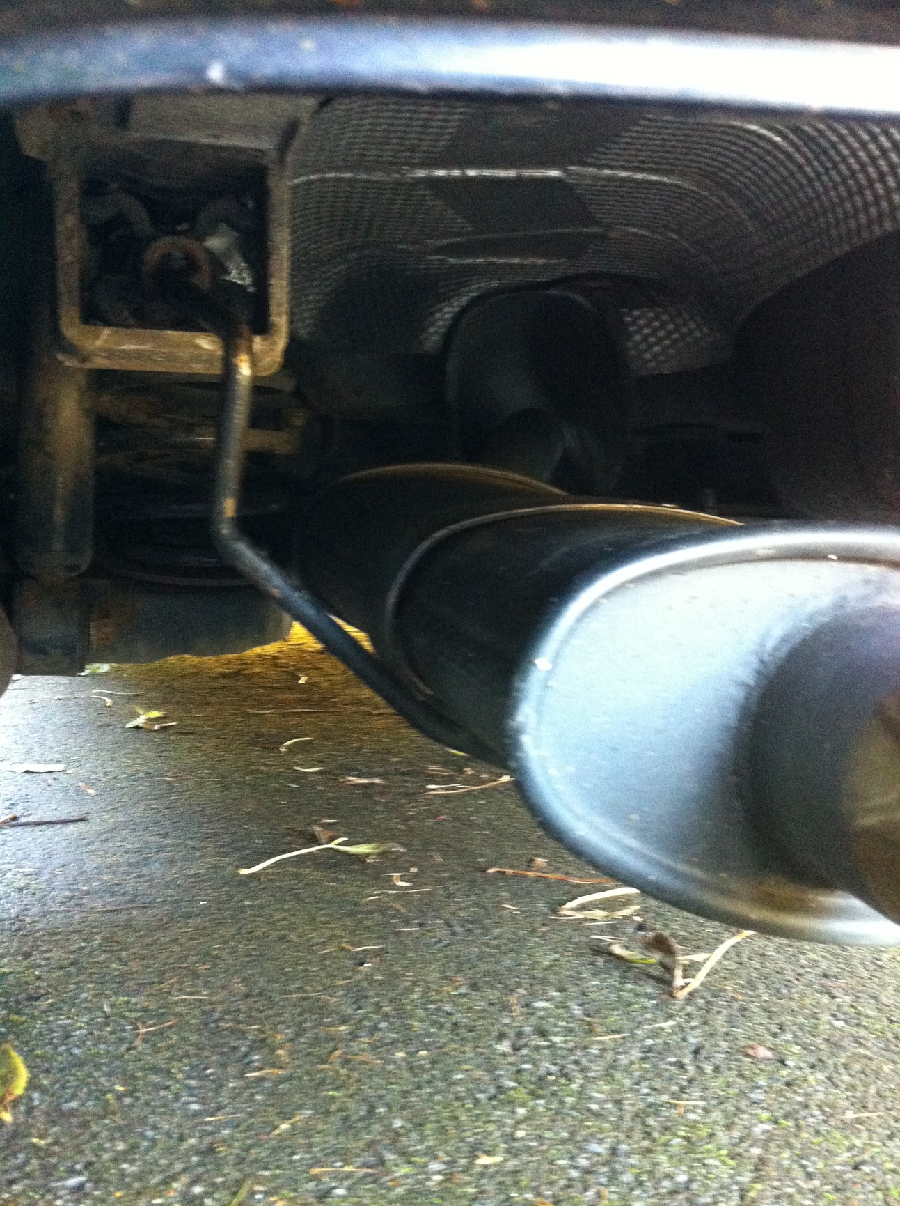

I'd watch where that clamp is joining the center section to the cat. The lamba sensor wiring fray's easily, mine did the same where it hung and it was pulling on wire.
If you push down on the tail pipe you should notice it straighten out. I'd replace the mounts they look shagged.
Sweet!
But yeah that rear mount is fcuked! get that sorted and you can properly position your backbox.

Looks like I need to replace the rear mount and have a reposition then! Any suggestions on any specific ones to get or just an OEM replacement?

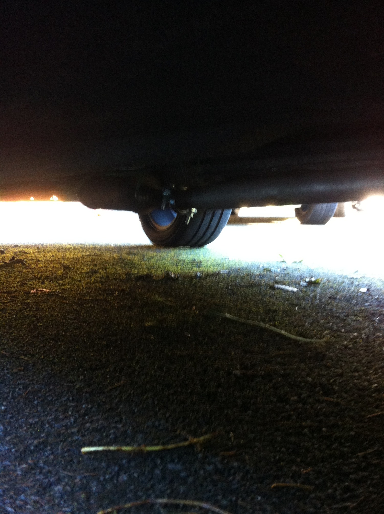

I'll probably look into that powerflex trick when I've got some spare moola, but at the minute I'm pinching every penny for Christmas haha. Student wages don't go far on car running costs + girlfriend + Christmas presents! Although I will probably do it at some point. Have had a fiddle and a tighten, and I've worked on my exhaust too ;) haha, hanging a bit higher now
Desperately in need of a wash too! Looks like it's hanging too far true of the bumper but it's fine close up!:) and a shot of the craphole:

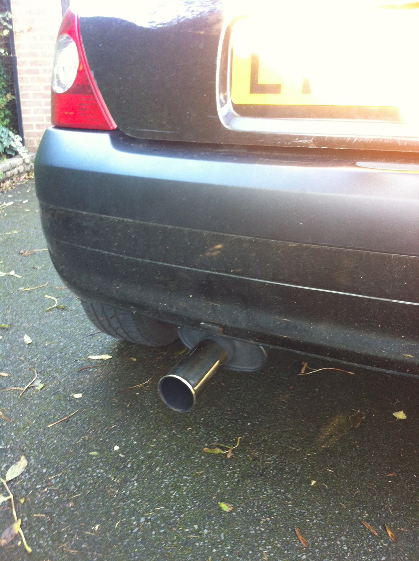

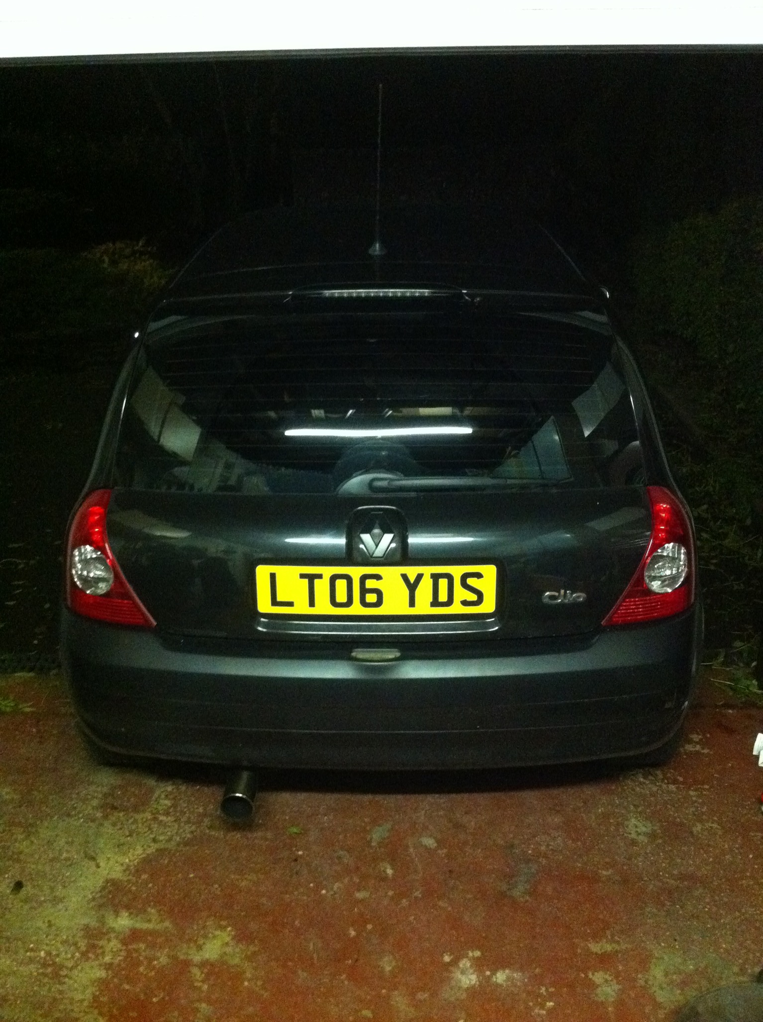

i would definitely try to find a 90 degree bend that you could replace that long tip with... so its more like the KTec stealth,

looks nice man,exhaust tip looks like its coming out a bit far though! looking good though. hows life now your driving?

Does look like it but from the side on profile, it sits flush with the bumper. And it's awesome dude, found out that I've done more miles in 2 months with it, than it did between 2010 and 2011 :p
