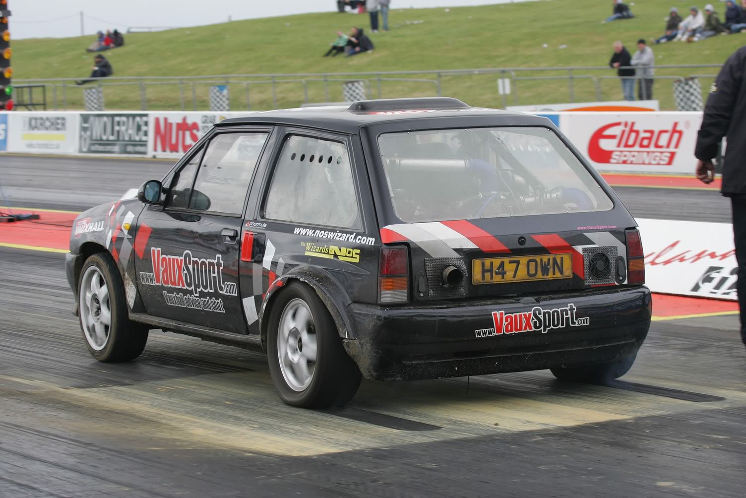

Its only a bit of fun, and Im not putting it up as a perfect example of how to build a mid engined car, its far from that, I would do loads differently if I was starting again TBH, but it does proove that getting one up and running and road legal (and chasing you to beligium and back in it -J-, lol) isnt dificult.
