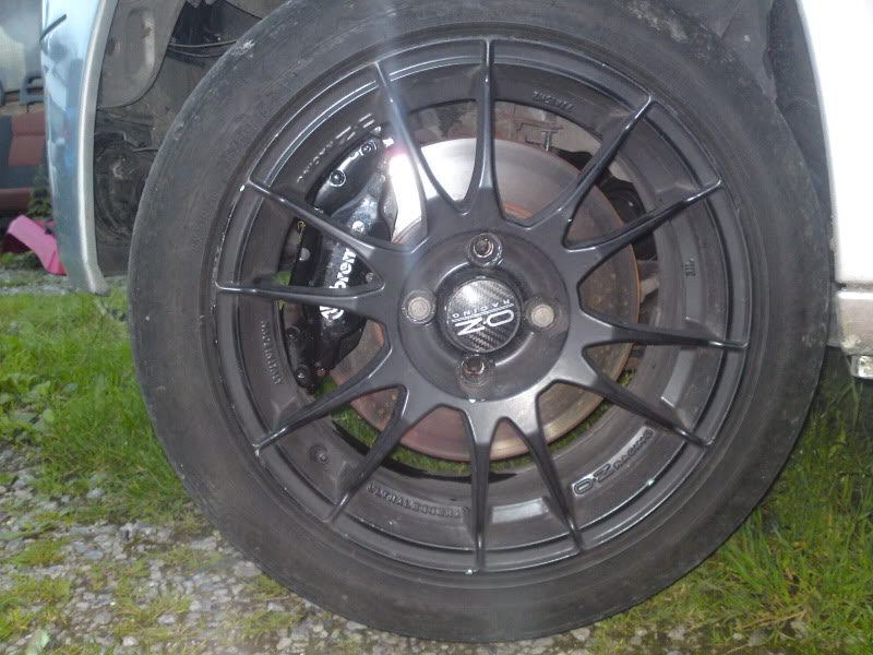

my solution is in progress now fitting a set of 225 brembos to the front hope it helps ,i bloody wants to.
silly me just scrolled down ,what disks you running standard yes ? and you using the 197 lines ? ??adaptor plate fitted i assume .cheers james
also they fit nice without work on the joiner line in 16'z ?

As said they worked perfectly well but just didn't seem enough. You seem to realize more now because of how good the 4 pots are.:)
