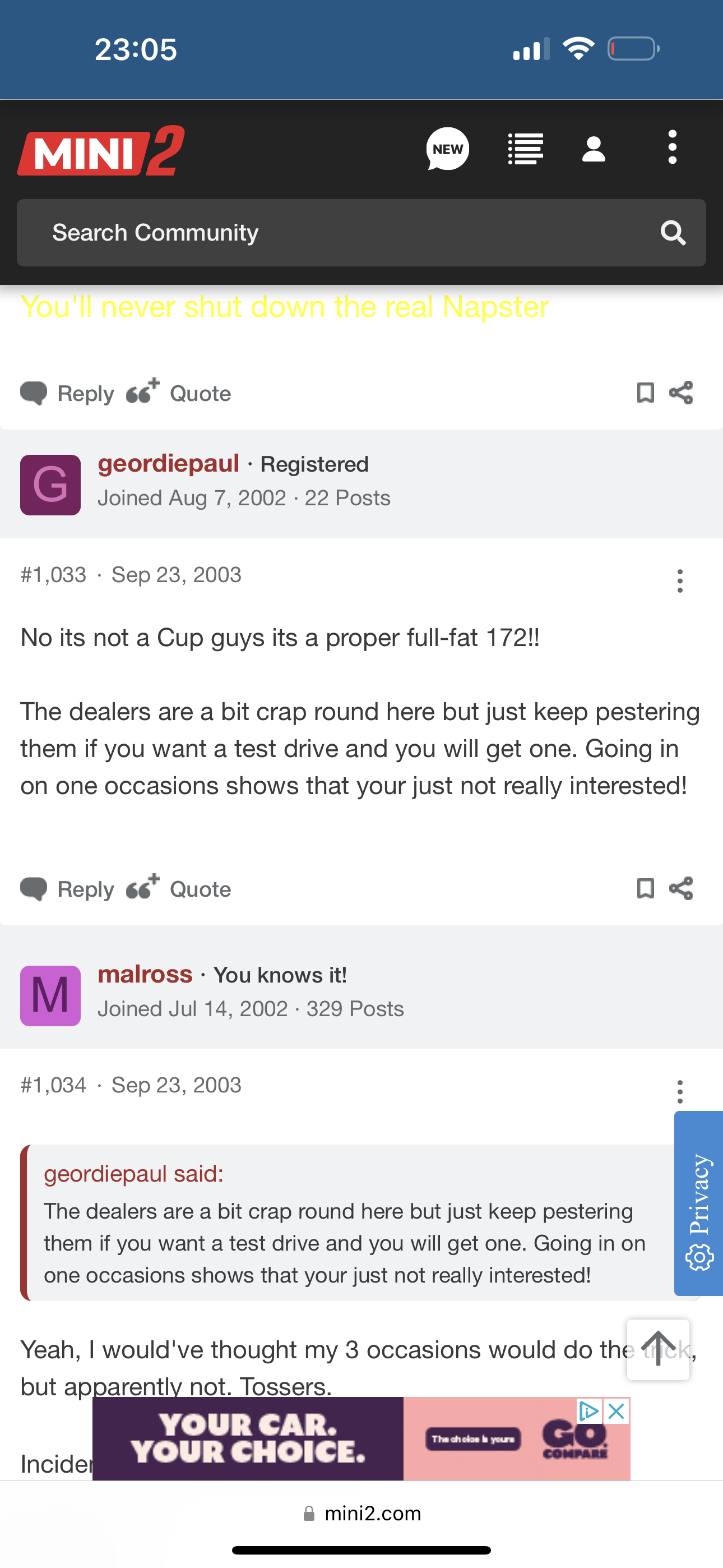

This is brilliant. Confirms the Inferno Orange I’m picking up soon is FF. I’m new to Clio’s, I heard that some have different bolt spacing on the front struts, 154mm 160mm? Might be keeping my eye out for a set of coilovers so would be good to know which I should look out for 🙂
Sorry I have to disagree. The term full fat has been around a long time. Used to describe a non-lightweight variant, so yes there is a 172 full fat as there is a lightweight 172. Whatever coincidence there was with the dealer option, it is only that … a coincidence! Full fat 182 is simply not a cup.
No
