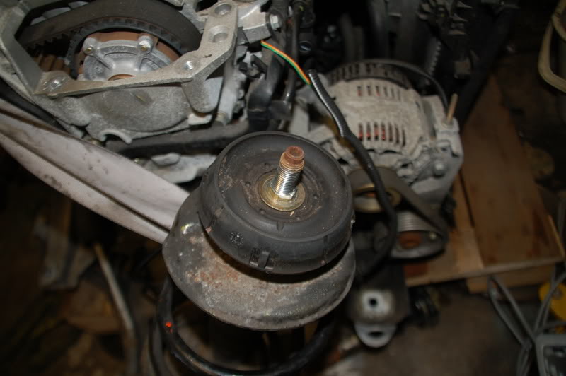

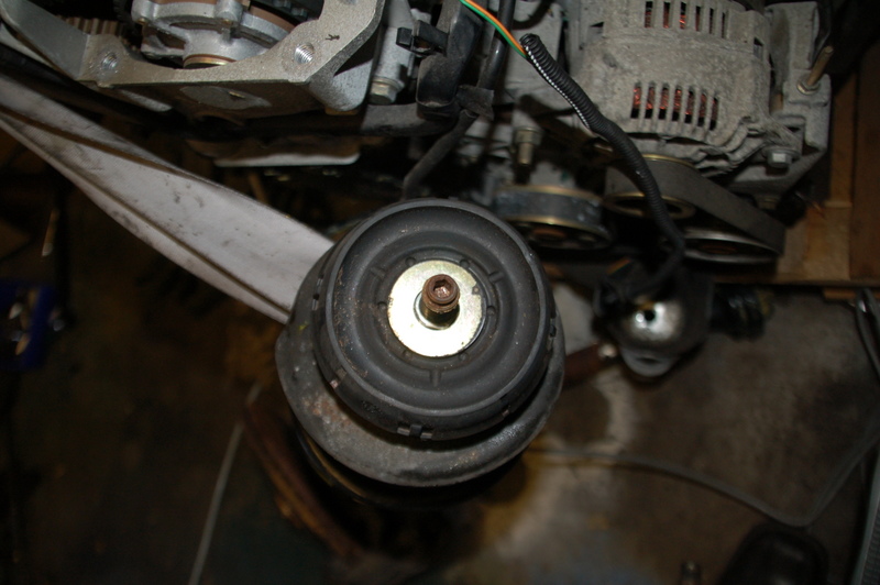

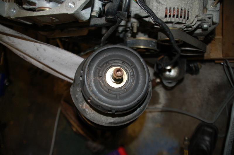

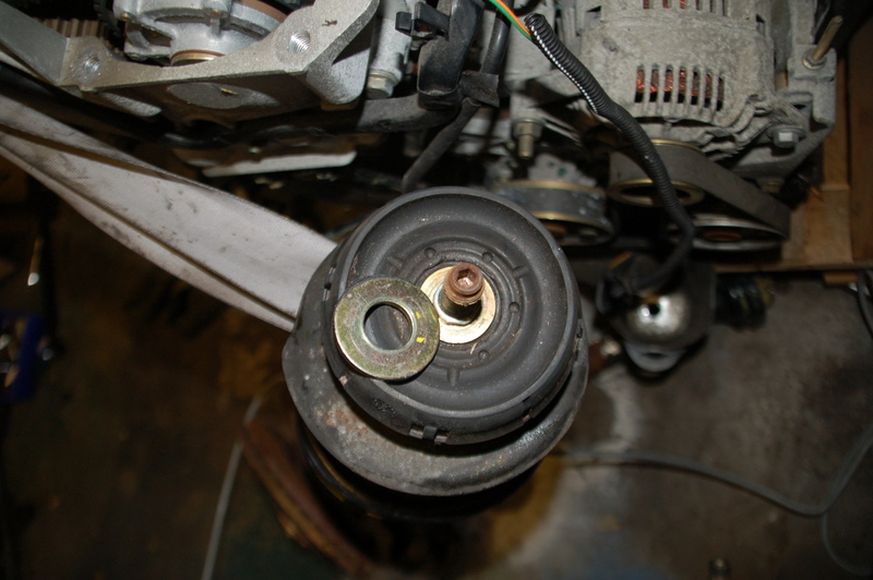

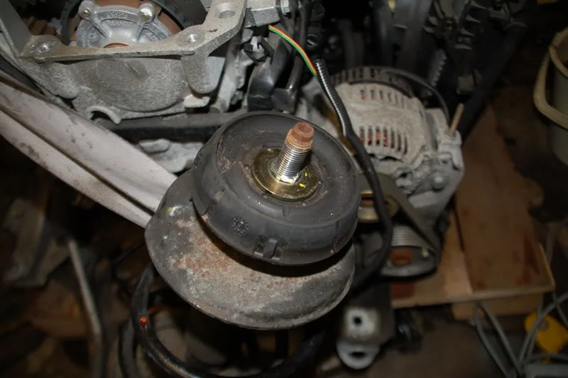

some pics
before
spacer
spacer fitted
ta dar
