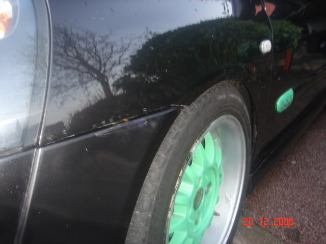

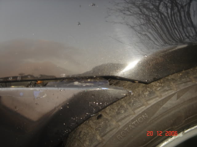

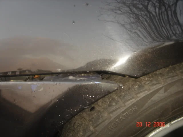

mate, just done this myself. i have a blue car and came out like this with the addition of some sealant to hide the gap . . . .
had to sand down the side parts of the front bumper but its not bad at all.

this look good mine will show up even less with my car being black! which parts have you had to sand down? i'm guessing it may be the top side parts where the bumper clips into the wing? and by how much?
I reckon you would need to alter the wheel arch flare section of the bumper. If you look at the pic's above, the 172 bumper runs horizontally right to the point at the edge of the arch. The non-RS wing has what appears to be a 5-10 degree angle as the bumper forms the arch flare. Looking at the pictures, if you could match this angle, I reckon you could erradicate 95% of the gap seen above.
wings are £60~ each from renault without the arch liners, if you add the wings you will need the skirts to match as the bottom of the wing marries up with the start of the skirt.
so try and space the arch out? so it sticks a little further out? i'm actually starting to think his sanded the edge that slots into the wing so it goes in further

You just need to do it slowly fella, take your time and get it down mm by mm. you need to sand down the side parts that slot into the arches as they stick out (where the bolts hold it in place), and also the actually bumper on show where it meets the arch, just measure the angle that it descends with the wing and sand down according ly, dont be afraid to use some marker as they rub off paint.

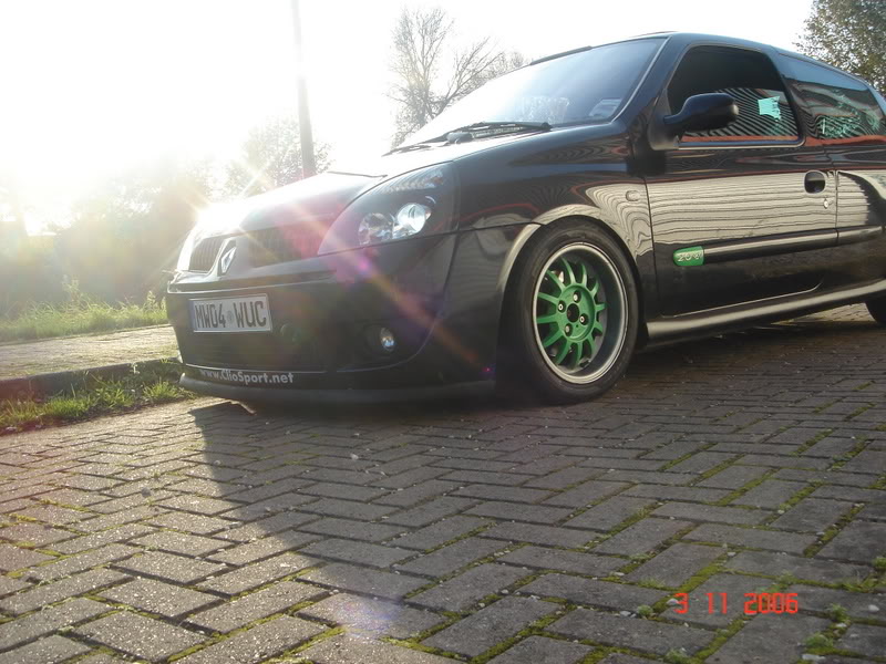

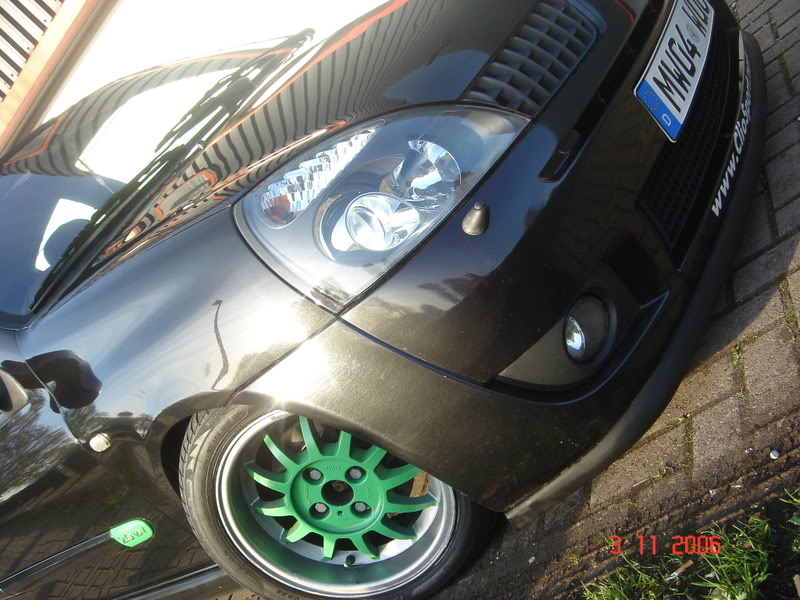

^^ shaved off the ends of the bumper so it sits under the arch properly
results?

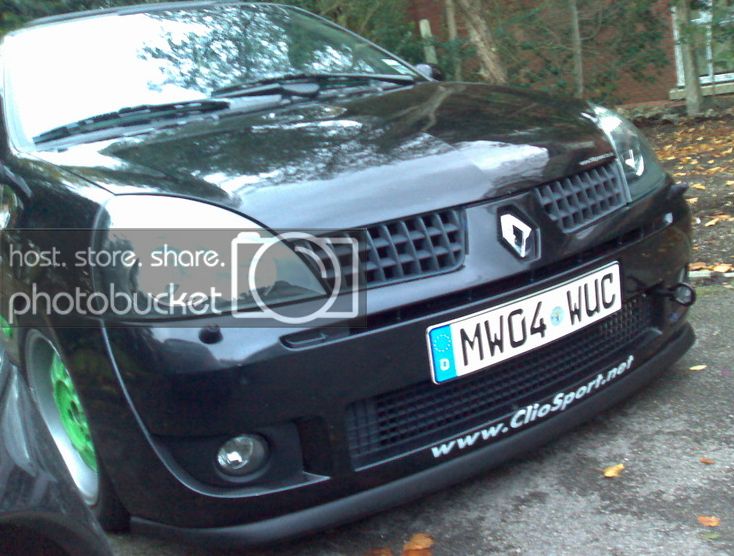

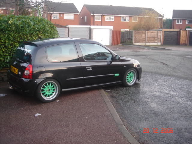

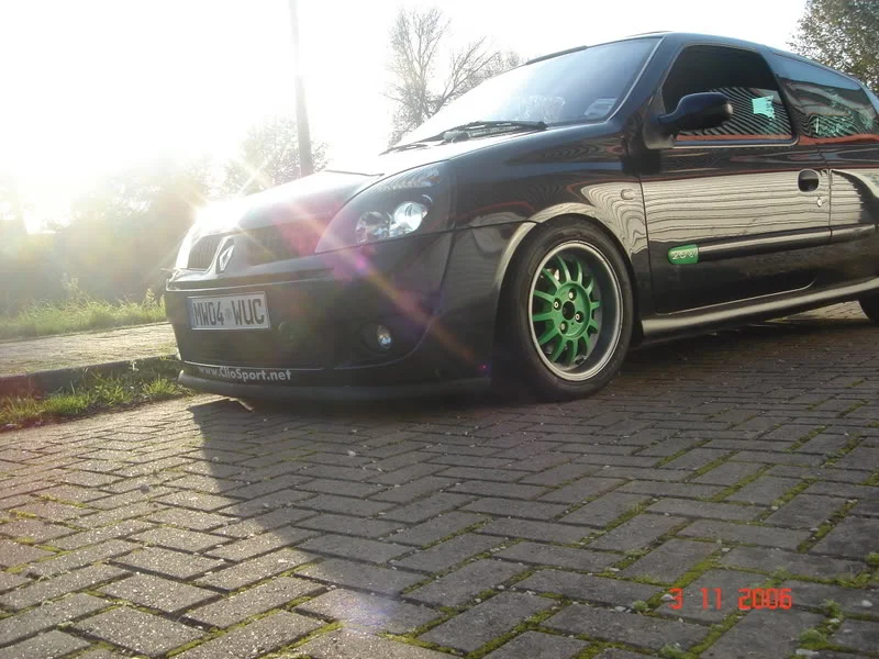

here's mine as it stands at the mo
i dont mind the look of the front end just it sticks out quite far and my car is seriously low and i've managed to crack the bumper again (second time now) and it cost me £150 for paint and £40 for mesh last time i had it fixed so to get it done again would be the same, now i can get a front rs bumper all grilles and carbon splitter for £300 then painted for £100 and i know its not going to crack like fiberglass,
i'm really happy with the bk bumper and skirts its just the front bumper it looks good from a distance but nearer it doesnt look as good which is not paint quality just the shape and the mesh + i cant fit a tow eye with the bumper on and if the car breaks down i have to completely remove the front bumper to tow it! (bumper is in the way of eye not mesh)
now i have a cup spoiler and i'm booked in to have it sprayed along with side strips and handles and for the front bumper to be done but obv i've changed my mind, i really want the exterior to be "finished" after messing around with it for 2 years i just wanna be done and get onto tuning it
what do you guys think? back bumper stays along with new cup spoiler and new "yozzasport" plates i'm waiting on being delivered :), colour coding and the rs bumper with mods i mentioned earlier + black indicators and 1.2 badges? couold i finally call it finished?
i'd change the front bumper and see how it looks before spending more money. as im not sure how the sides / back bumper would go with the RS front.

the whole car looks quite square and wide, which i dont mind, but i think that the RS bumper might be a little too, dare i say it, plain, in comparison to the rest. . . . and i think the wheels look almost too small as well
im not dissing your car mate, liking the dark look like i said, just some hopefully helpful opinions :)
