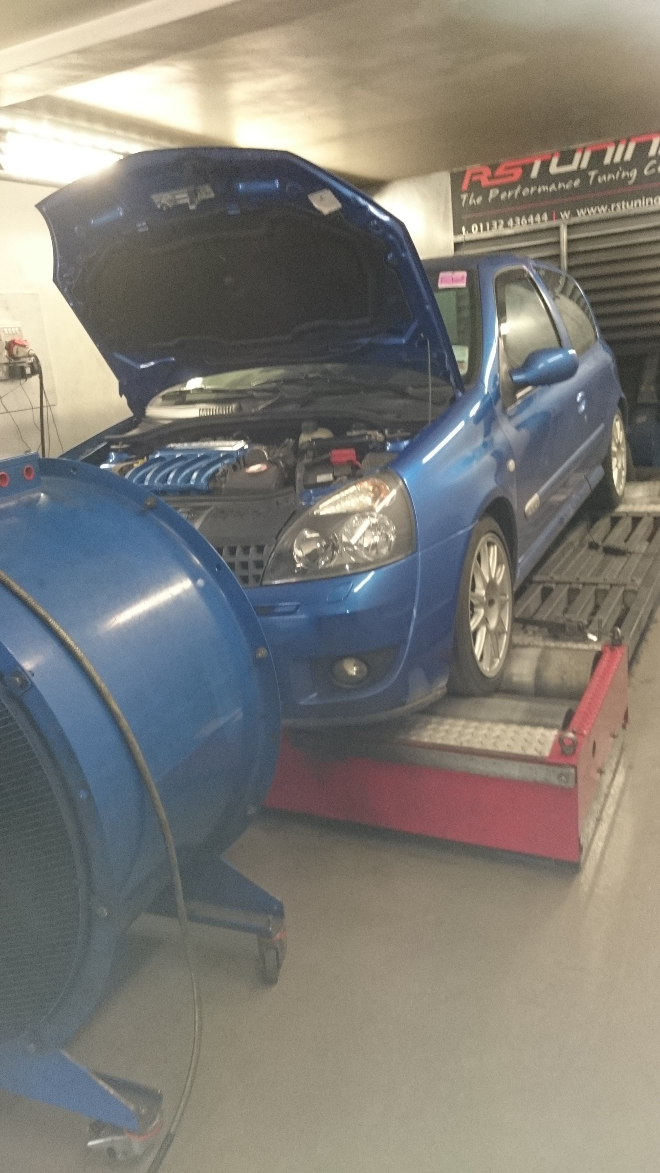

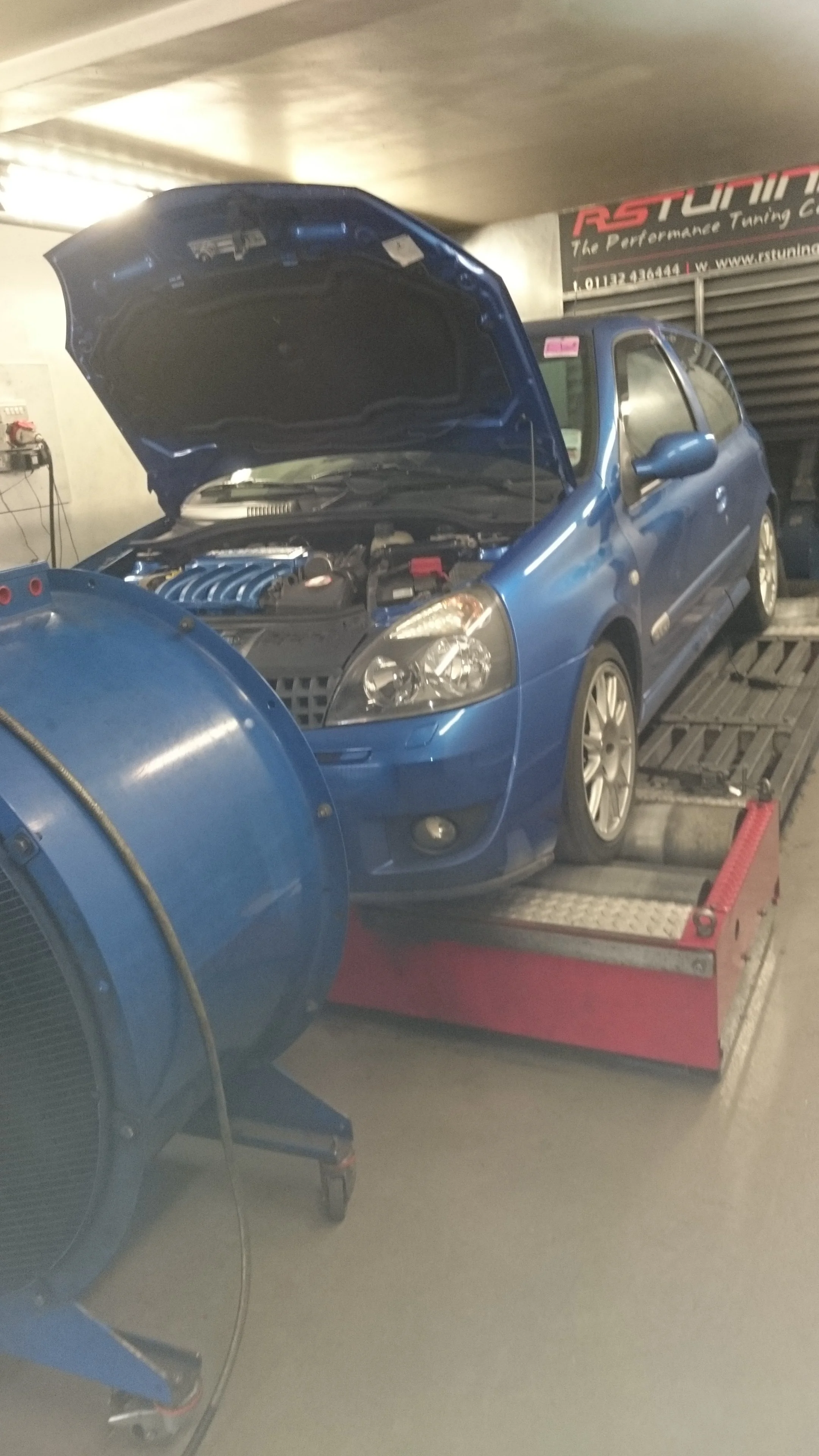

Just took it for a map, it's got port matched inlets, k&n panel filter, miltec de cat, power flow stealth, timing was out on first run at 154bhp, adjusted timing and mapped got 168bhp, that 200bhp now looks miles away,probably never going to get it.

At a rolling road day mine made 183bhp and someone elses ph1 made 168bhp on the same day. Realistically, mine was only just quicker. There's no way there was such a big difference.
I was told forget the port matched they may give me 1 bhp and decat may be 1bhp, so asked about cams, was told nar forget cams there not worth the money, for little bhp gains, :-( told super charger, or throttle bodies only good way to make power... So probably staying at 168 lol

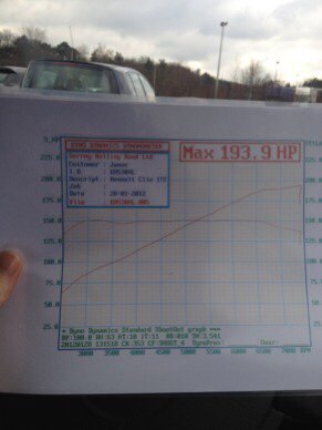

Well as can been seen on mine above, there are certainly gains to be had.
The RR print out wasn't run on a RR related to the garage that did the work, totally independent run before and after.
I was certainly happy with the results (the run above was actually done on a CS.net RR day).

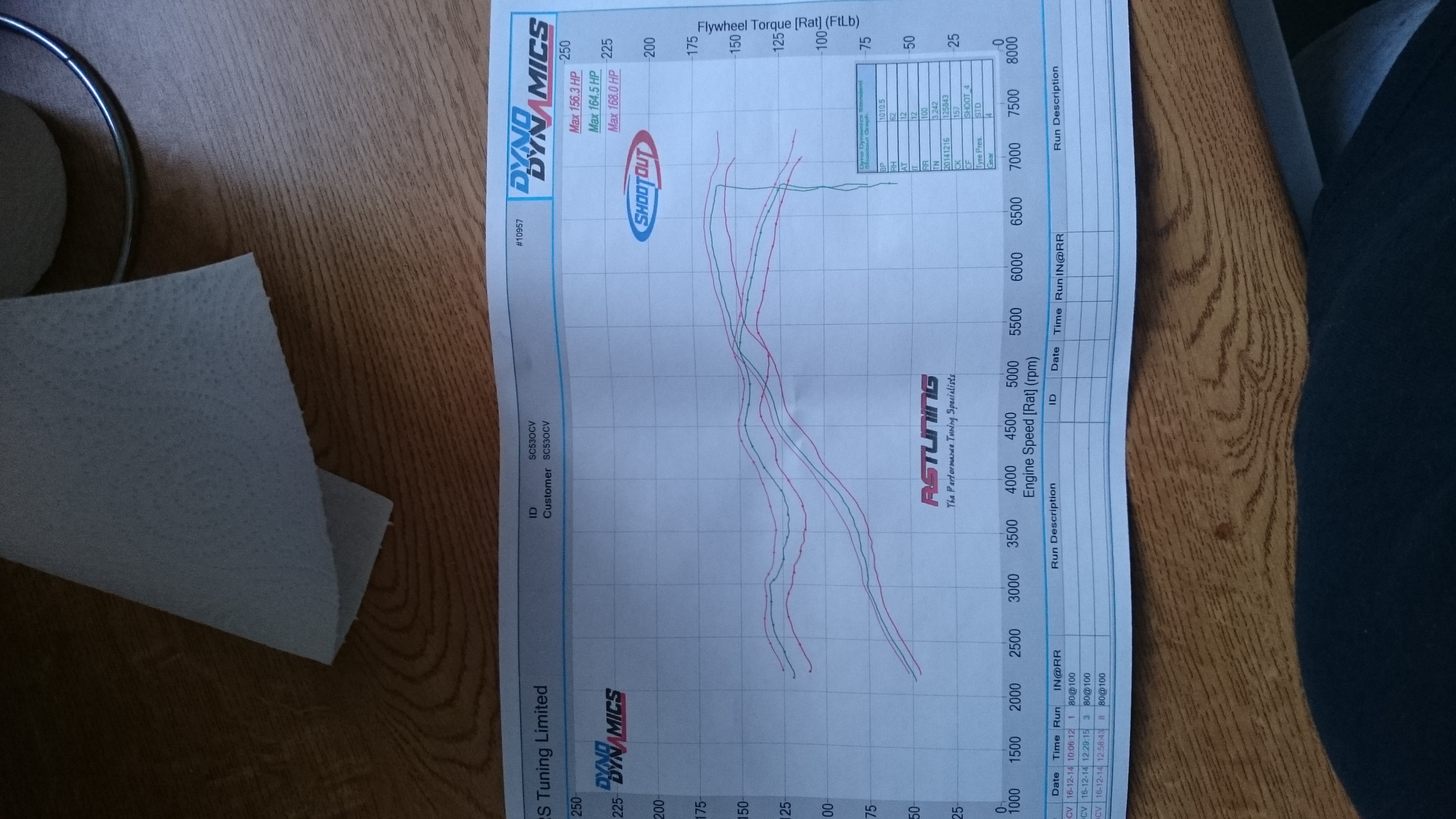

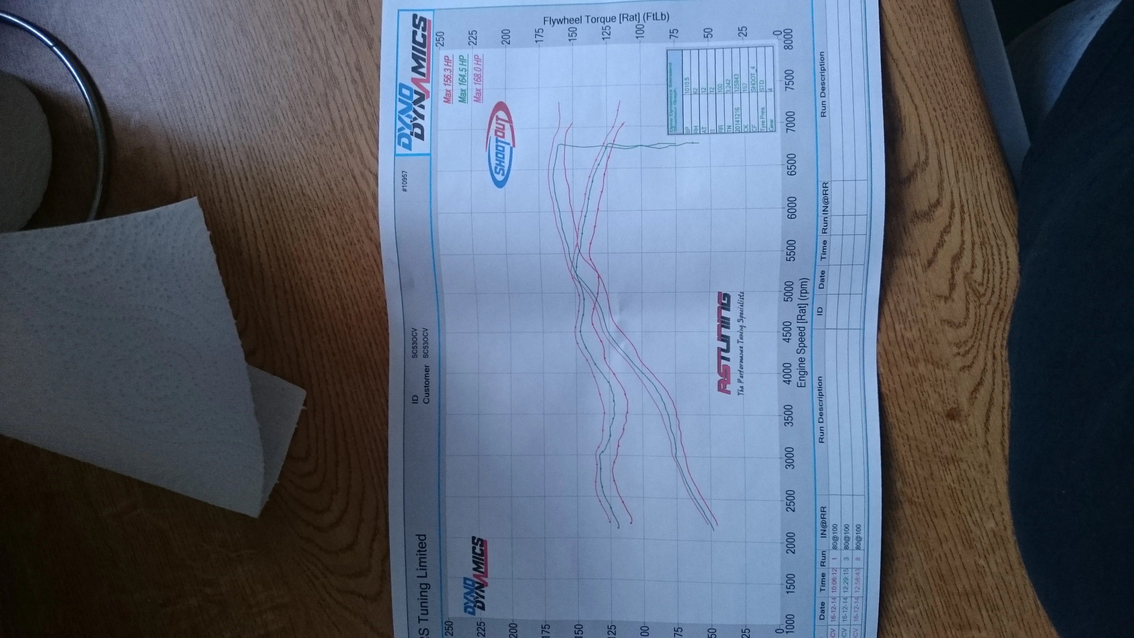

Yep I think you are all correct, forget bhp, and throttle bodies, concentrate on handling and driving, although with Pauls map I did gain just over 20lbf of torque, so that's quite a bit,so I'll see how it goes at Blyton on the 28th December, my wets are being fitted :-)
Not sure how to read this graph it just p all said it gained lots of torque

Power across the rev range you'll be using is the most important bit. Having a nice peak is far less useful than having a good solid figure over a couple of thousand rpm. How long do you spend in the taller gears trawling from 5000rpm-6500rpm compared to a spike at 6800 or so. I spent a good chunk of money farting around with twin Weber chokes on my XR2 and the ones that gave the best peak power were the worst on track due to the steep power curve. A size down that gave a good combination of grunt and power including noticeably more power up to the bigger chokes peak and suited my gearing were the ones I settled on. You tune an engine to your needs not to figures.

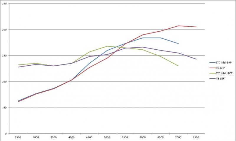

I overlayed my results a while back. The engine has cams and headwork, 182 manifold, sports cat and twin silencer exhaust. Before had matched inlets and ITG filter, after with with a KTEC ITB kit and my custom angled trumpets.
Tom that looks bad, and made me think leave it alone, less torque, and only better hp after 6,000 rpm but less power in the mid, hmmmm sell up next summer and buy a megan 225 lol
Ideal for a track car though. More power and torque from 5500rpm onwards and you can stay in a lower gear for longer. The standard car is pretty much out of steam at the point the ITB setup gets going. Being able to stay in 3rd for another 1000rpm and it be pulling hard makes a noticeable difference. Only in the odd low speed 2nd gear corner is the ITB setup gonna lose out. You can play with setups to change the curve depending on your needs. I miss the CRX VT I tracked for a while. No torque at all but it never felt lacking once it was happily nudging the limiter at 8200rpm despite less than ideal gearing. If a good solid shove is what your after then a turbo is the only way.
Lol! It's faster where it needs to be. Overall area under the curve is greater with ITBs and that makes it faster. If you want power below the point where you use it on track why not just buy a diesel....
