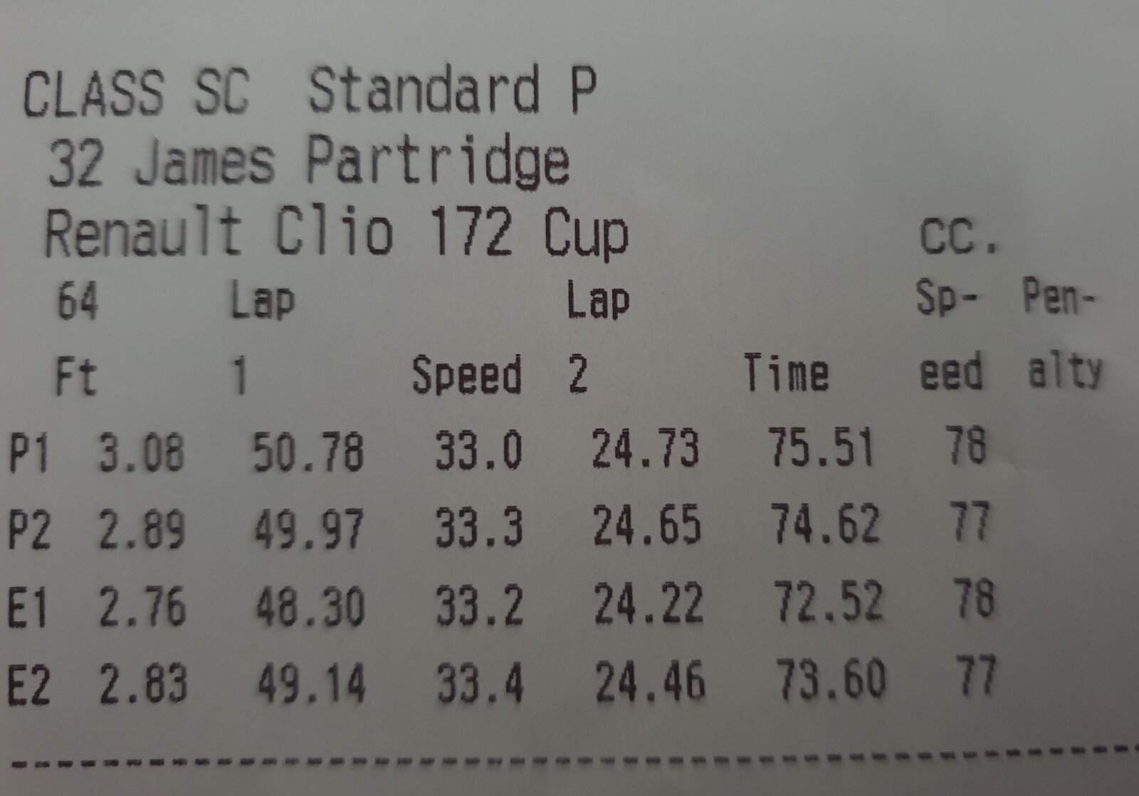

Bright sunshine all day and I got a new PB 72.52 seconds so 1.6 better than last race, happy with that. Timing shows how critical first corner/first lap is. Lots more time in the car but all steps forward. I came 5th out of 7 in class. Top 4 all 200 Cups and a consistently well driven Fiesta ST.

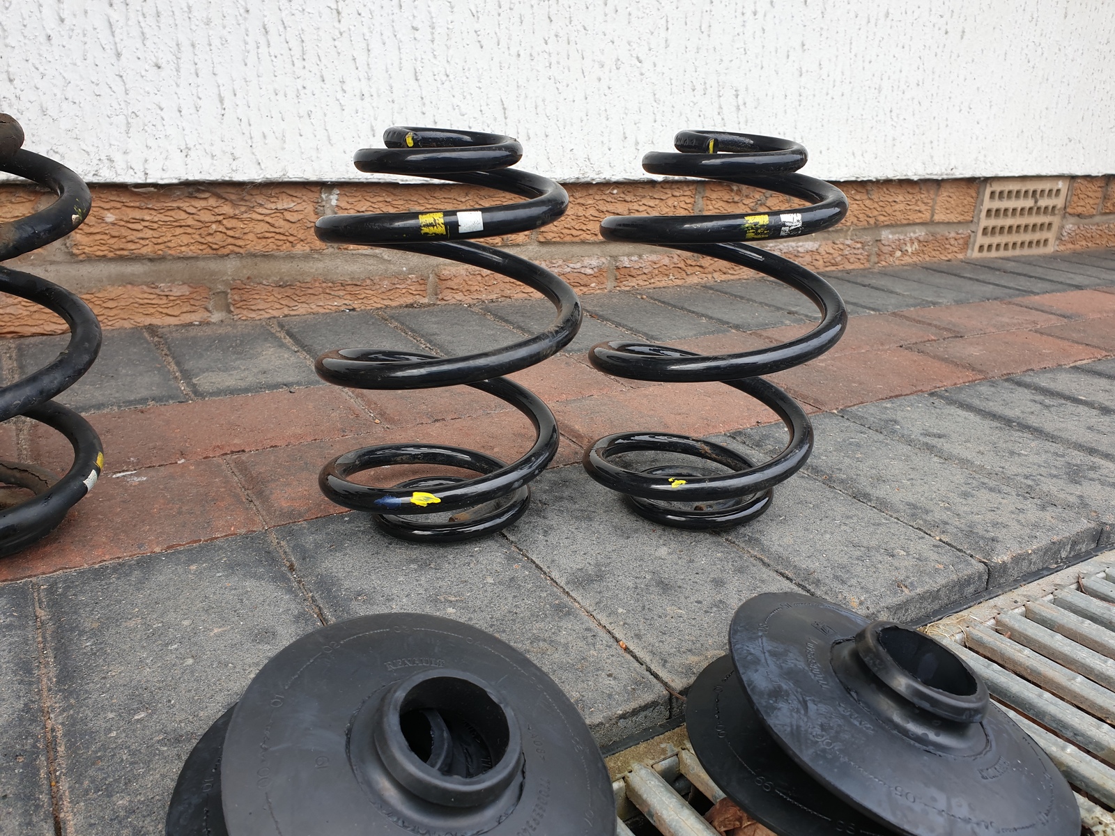

Thanks to Ant1 on here just bought a full set of original 172 Cup springs from a car that had only done 30k and never driven in rain apparently, look like new from pictures. So finally I'll have 4 matched springs instead of a mix of random pattern and original.

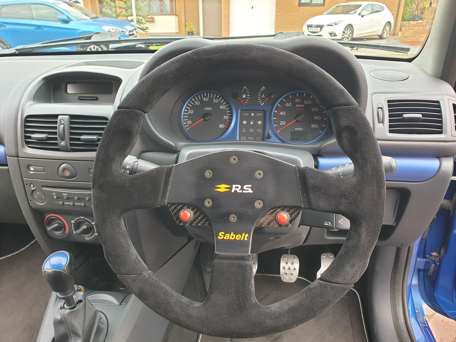

Also got Christmas present for myself a Sabelt wheel went all black to match seat, and Volantech carbon horn panel after getting email from MSUK confirming aftermarket steering wheel is permitted in Standard Class (will print and take with me for scrutineers).

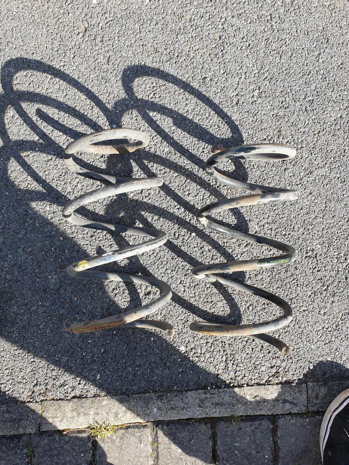

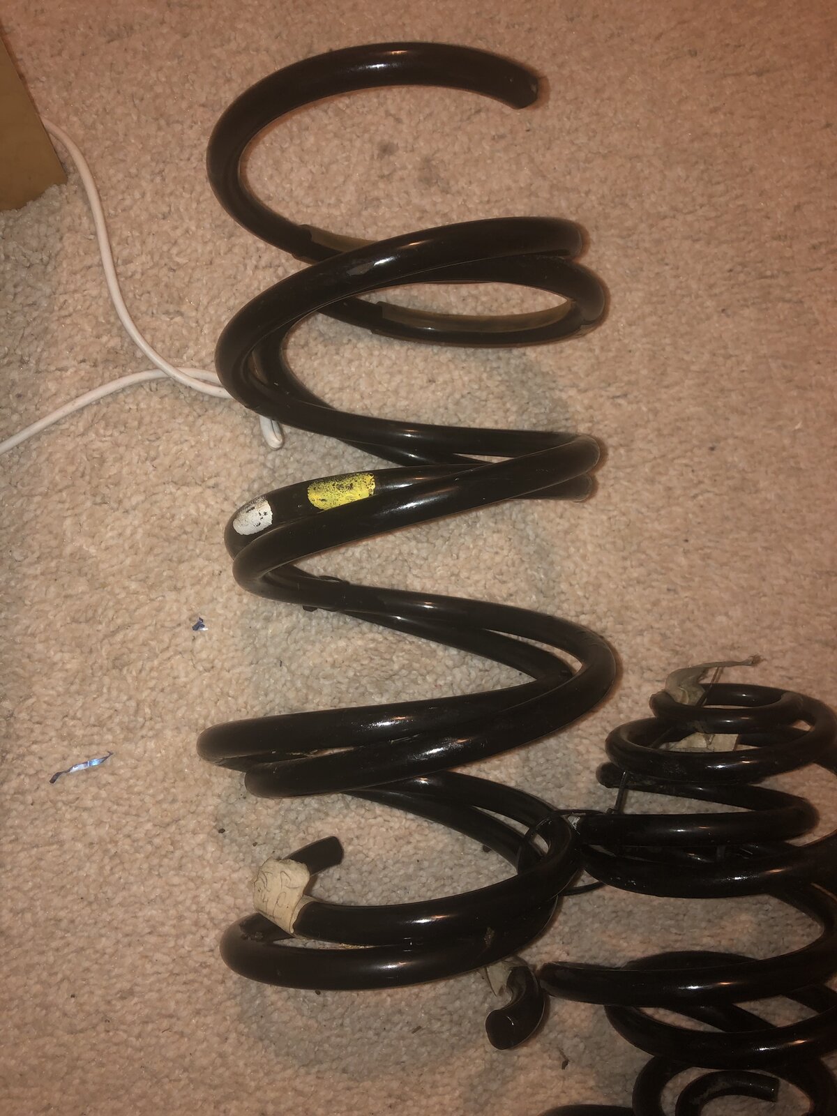

The big one wouldn't even drop out when I fully dropped the rear beam, I was sat there laughing after forcing it out and putting them side by side! Think can see its curved as was too big.

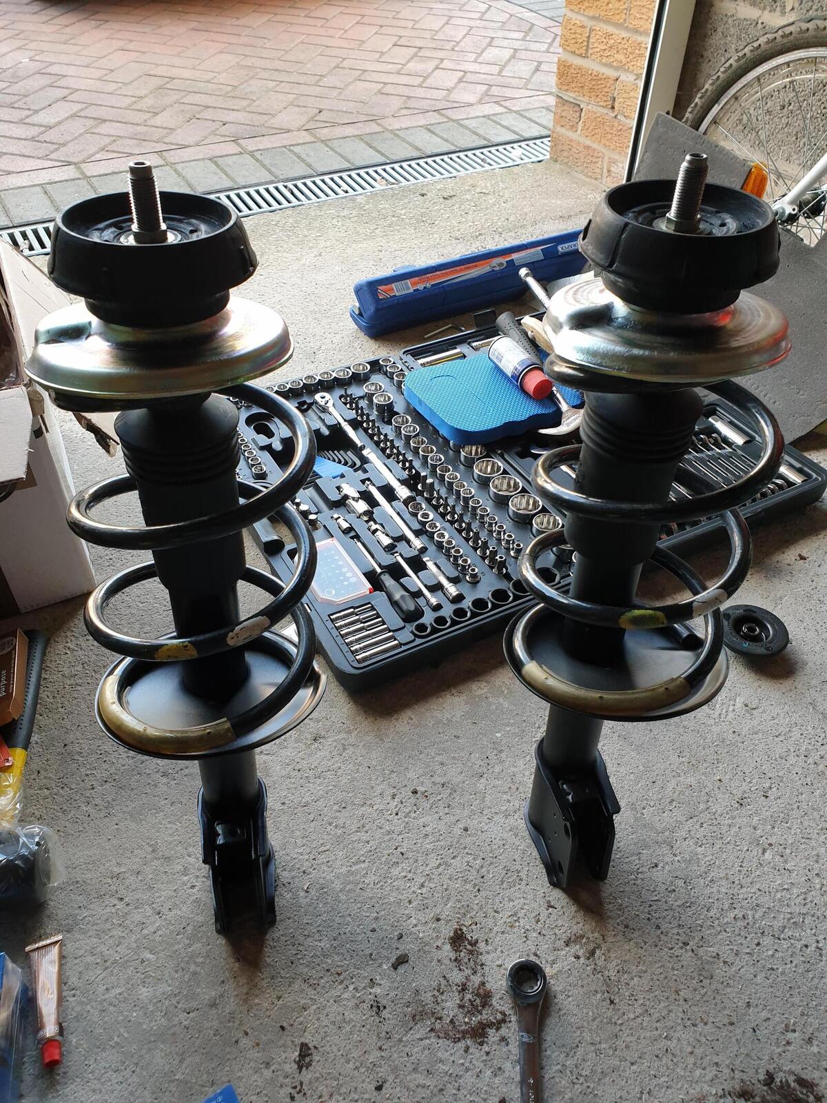

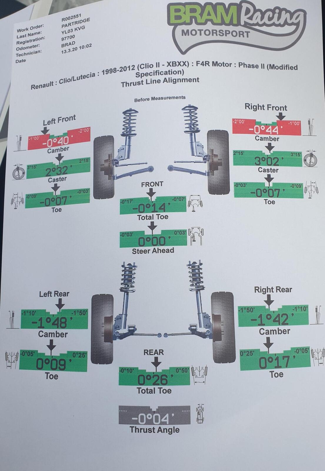

Got round to fitting all new OEM front suspension, struts, springs, top mounts... again mismatched front springs though at least closer than rears. Then went to Bram to check alignment and all good, Brad's a good guy will go back again once got used to new setup. Car feels completely different to last year, never knew this is what it "should" have felt like!

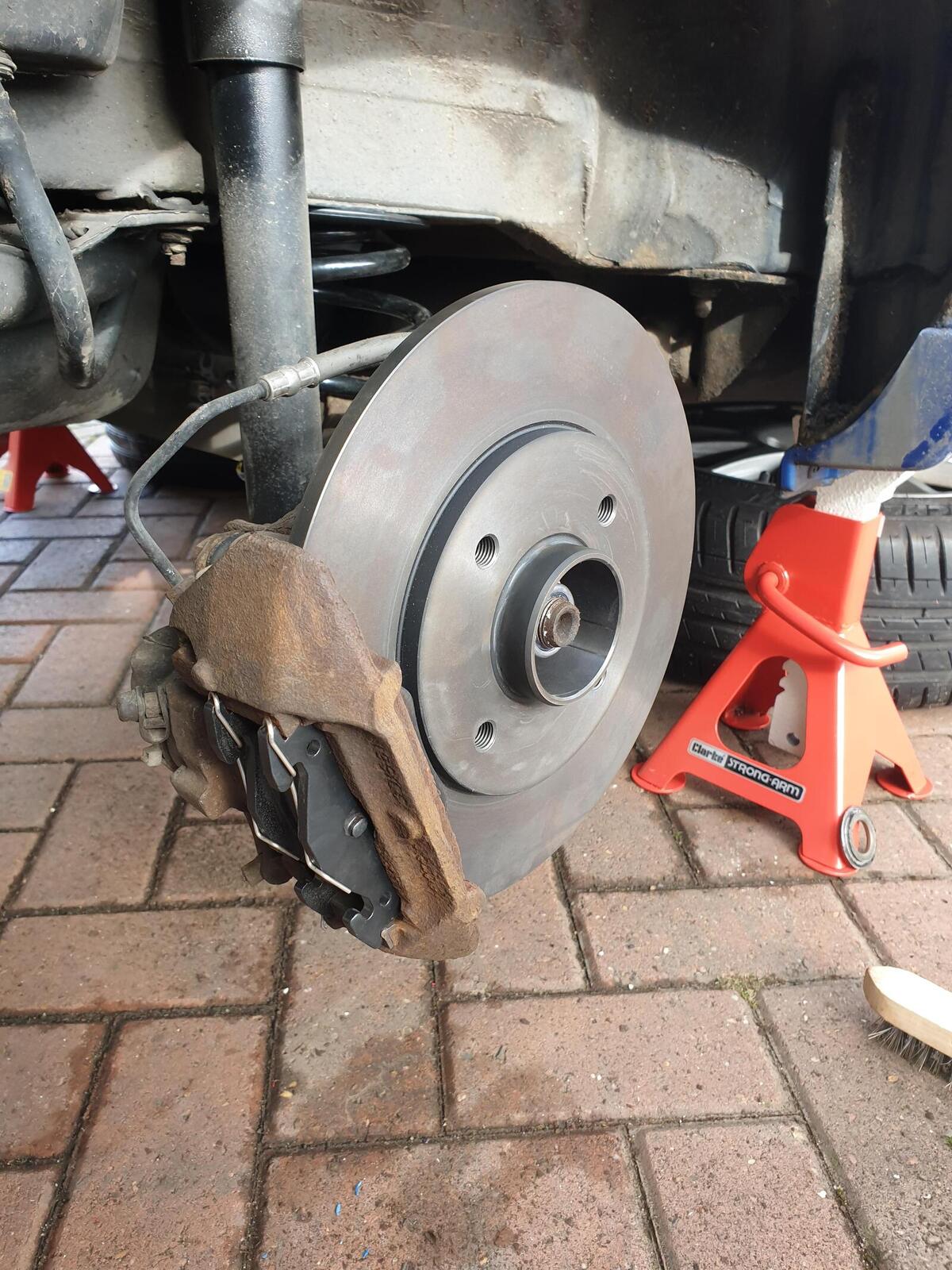

New front discs, pads, seat and steering wheel to go then I'm ready!

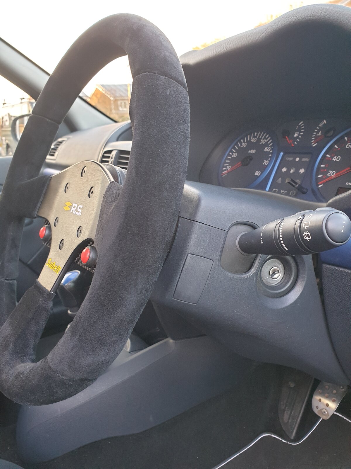

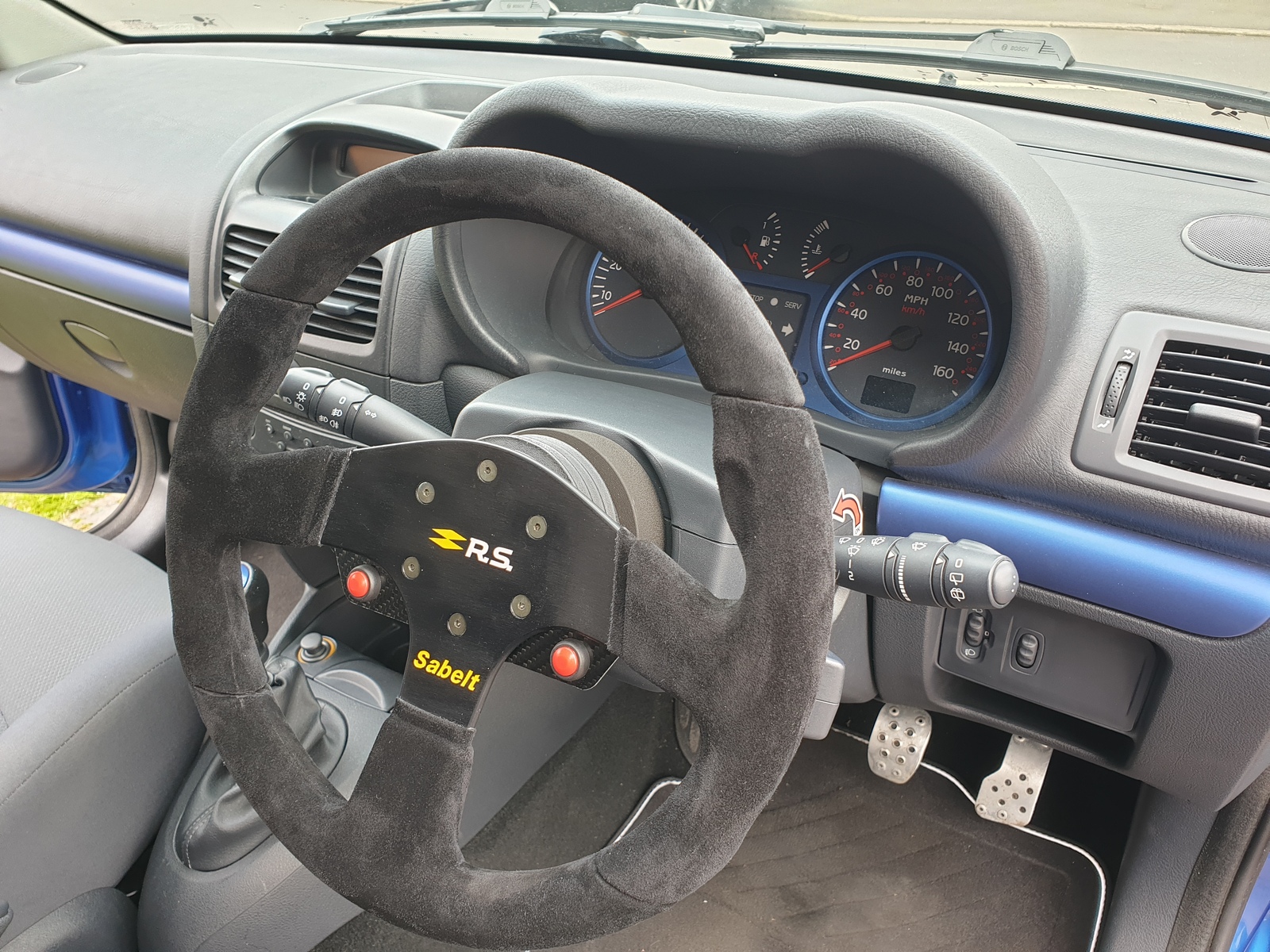

Fitted steering wheel today feels great though think I need to adjust seat back slightly cramped.
Also fitted Volantech carbon horn panel to be a bit different and all then matches seat. Its similar price to a Ph1 horn stalk anyway.

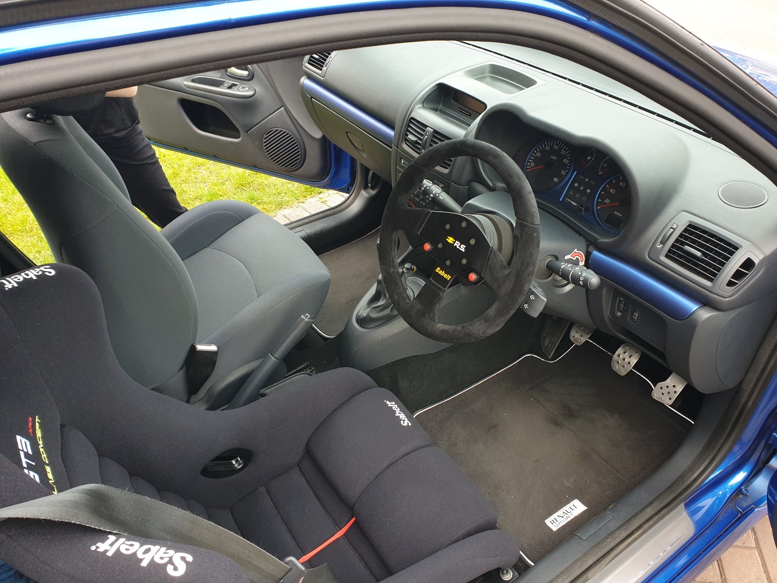

Really nice sitting on my drive going 3 foot forward and back! Not able to go for a proper drive yet with lockdown and working from home. The seat is slightly offset right of steering wheel compared to standard with the Jon Foz XLow subframes that the Sabelt side mount bolt to but not enough to bother me. Steering wheel feels just right in size.

Are you allowed to adjust front camber? I assume not as you havent?
Cheers Greeny, not allowed in standard class unfortunately (only optional changes allowed are safety gear, cage, seats, harnesses, steering wheel / air bag removal, pad material, list 1a tyres) otherwise is got to be as it came from factory so camber as shown above is stock. Brad had suggested ideal camber given the larger amount of OEM suspension travel would be somewhere between 1-2 degree rather than bigger camber run by cars on stiffer suspension (hence why its showing up as red).
