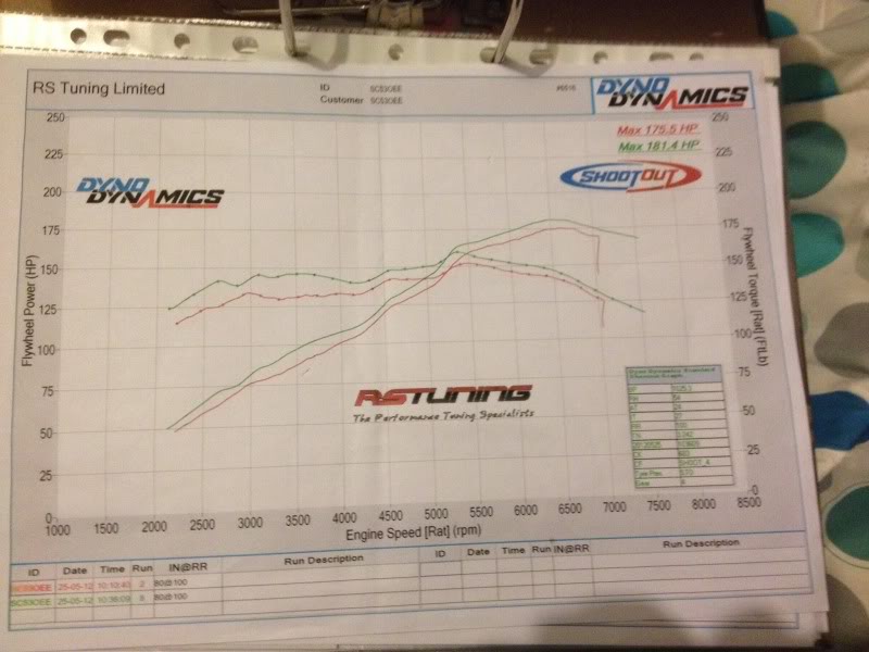

I don't know what others have made at rs tuning with itbs but a lot of other rollers overread.
When people say they see 210-215 ish with just itbs and 421 cams imo that's a bit optimistic, you'd be looking at around 200 on the rs tuning rollers I think. Which is realistic considering it's still only a 2.0 with fast road cams.
I have read in a few other threads now that 438's really don't work well with bodies :(
I think if you really want over 200bhp you're gonna have to flog them and get 421's instead mate
Thats gonna be the plan in the long term I think but I'm happy with it at the moment regardless. Ill probably consider doing this when the belts get done next time...
That's just speculation, cams don't work like that though.
The 438 will work fine with ITBs no differently to any other camshaft.
421 have a longer duration and slightly different cam timing to move the power band up the rev range a bit, hence making more power.
Ph1 Tom
421 won't do 215 at rs tuning. 200-205 realistically.
Headwork, 422 and pocketed pistons (keep the standard ones imo) will see a genuine 215. And they don't lose out too much low down like the 423 do.

Errrr how is it speculation. Several people including Jim here have now tried 438's with bodies and aren't getting decent power out of them.
Cam's don't work like what? You've just said that 438's have a shorter duration (probably to avoid valve overlap on a standard inlet) so will never make as much power as 421's
Also are people actually talking about 428's? Catcams don't list a 438 for a clio
Will 438 work as well, yes, but differently. Will they make the same peak figures, no.
You're talking a few degrees of duration and a slight difference in overlap due to timing. But more so that you get with the standard cams.
So will 438 work better with ITBs than standard cams?! Define better. They'll make higher peak figures if that's what you're after.
Its just another profile among many. Saying one works better than another isn't correct.
E.G Are 423 better than 421. In my opinion no. Because the 423 lose out on torque below 6000 rpm and then only make more peak power over 7000rpm.
I'm so confused by you it's unreal.
He's posted his rolling road graph, its virtually identical to mine. He hasn't gained any mid torque or mid power, the peak power isn't much higher. So ermmmmm they don't work lol. I don't know how you can say you don't get the same gains but that doesn't mean the cams don't work. That's surely the point of fitting cams?
Anyway putting those weird comments to one side - the car looks absolutely awesome. The dark wheels suit it well!
Different rollers. Reckon you'd do 194 on the RS Tuning rollers?
And as they are 428 its only a slightly better inlet. What makes me laugh is how people claim they get around 215bhp with the 428s and ITBs...
